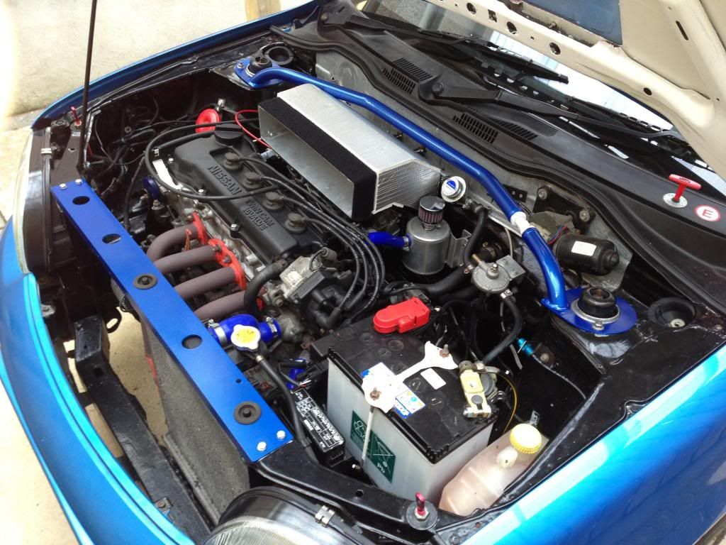

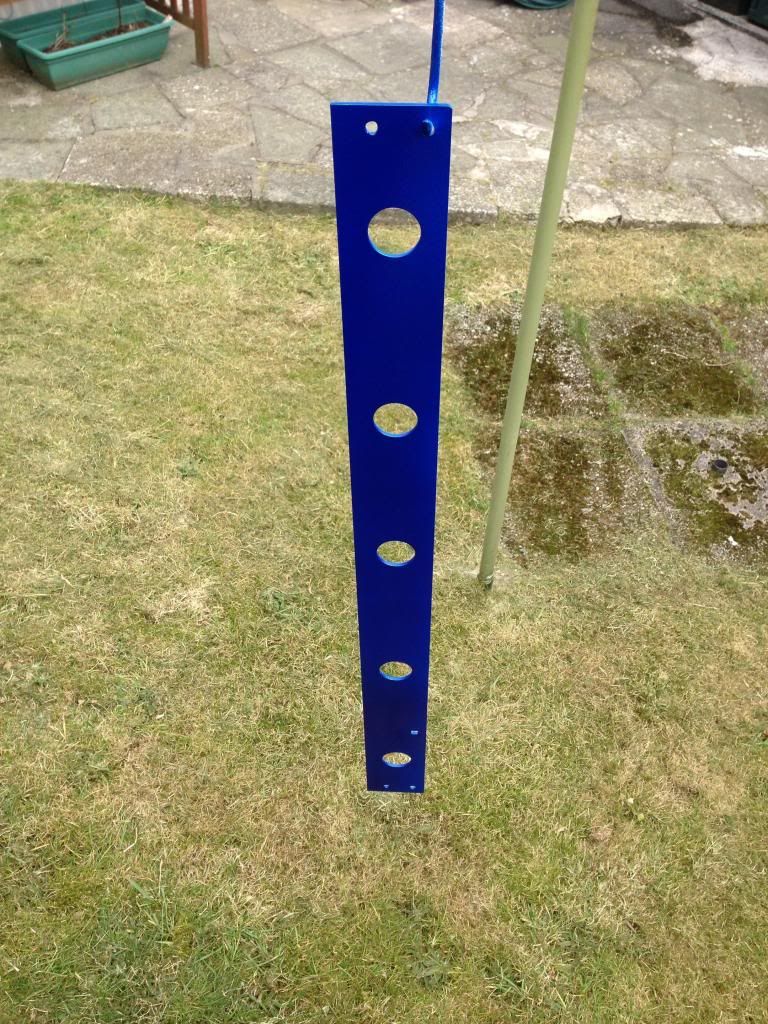

Little bit of painting today while the carbs are off awaiting jets , slam panel & strut brace drying at the minute

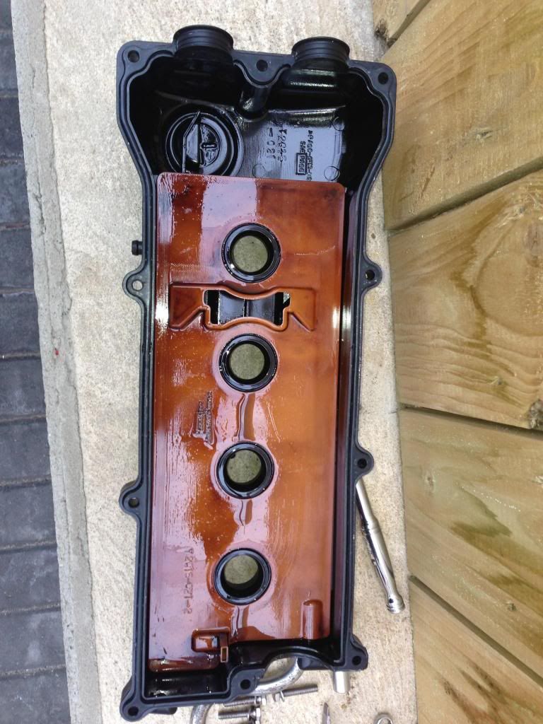

Correct rocker gasket fitted, big thanks to Stani
