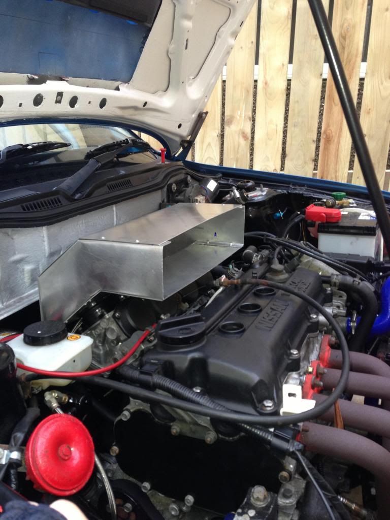

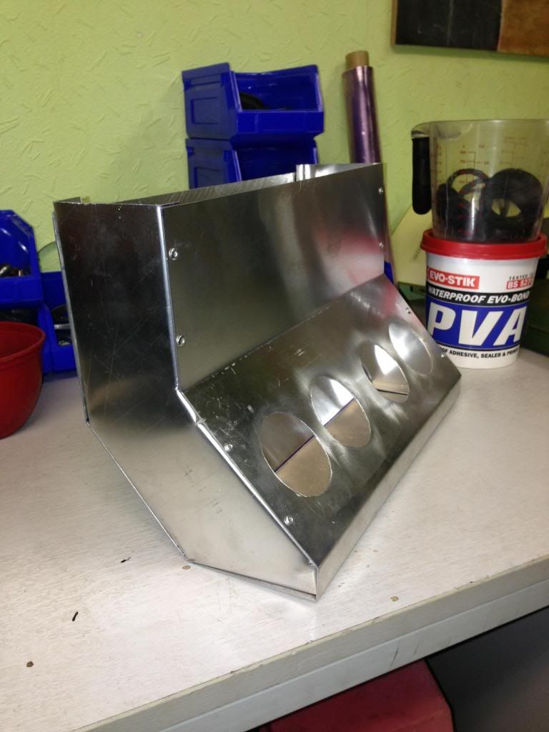

Part one of the airbox finally done only two to go :)

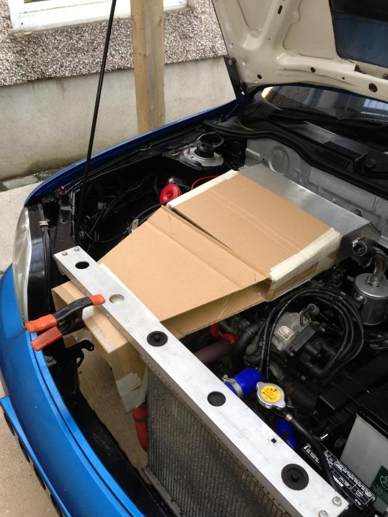

I see why you probably replaced that front top member I had the bonnet latch and central suport bar off mine today and found that rad suport on the top is pretty flimsy on its own so I may be asking for measurements at some point mate
No problem fella, yeh once I went to bonnet pins there wasn't much strength just on its own. More than happy to help mate

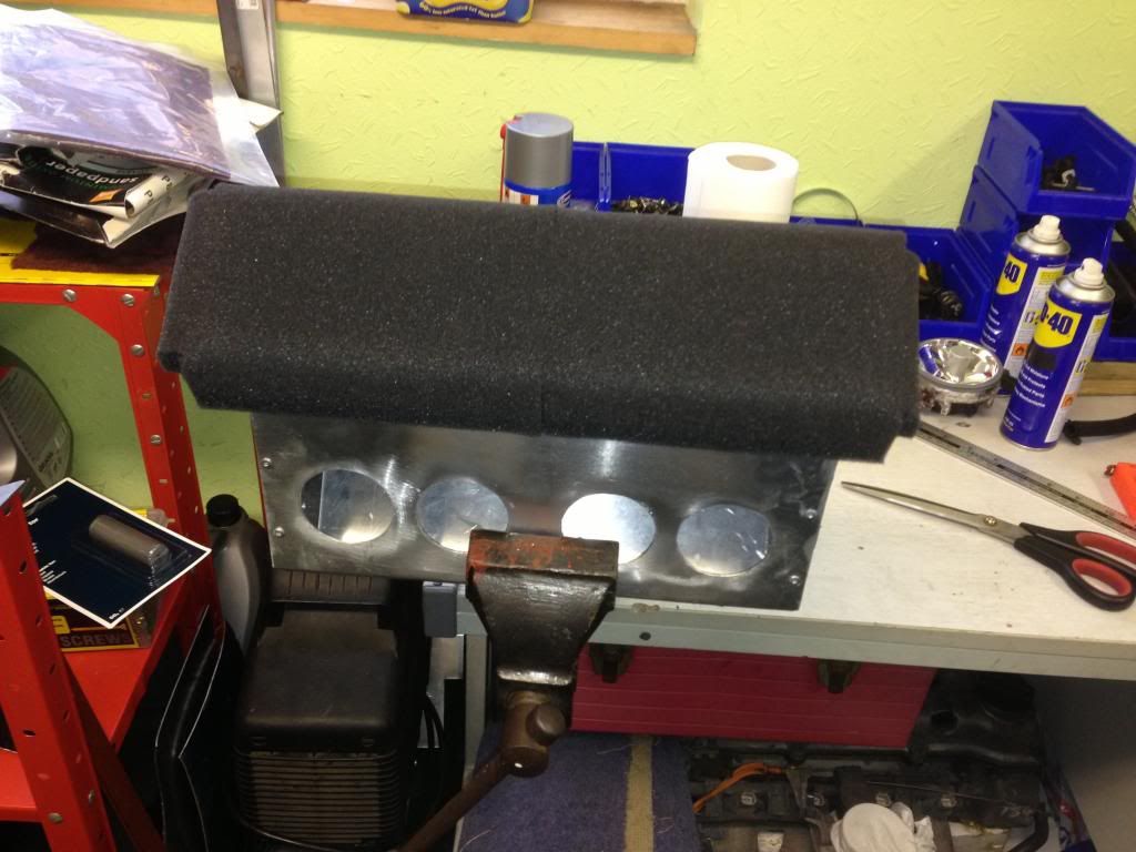

Looks good Paul, how are you going to make it air tight?

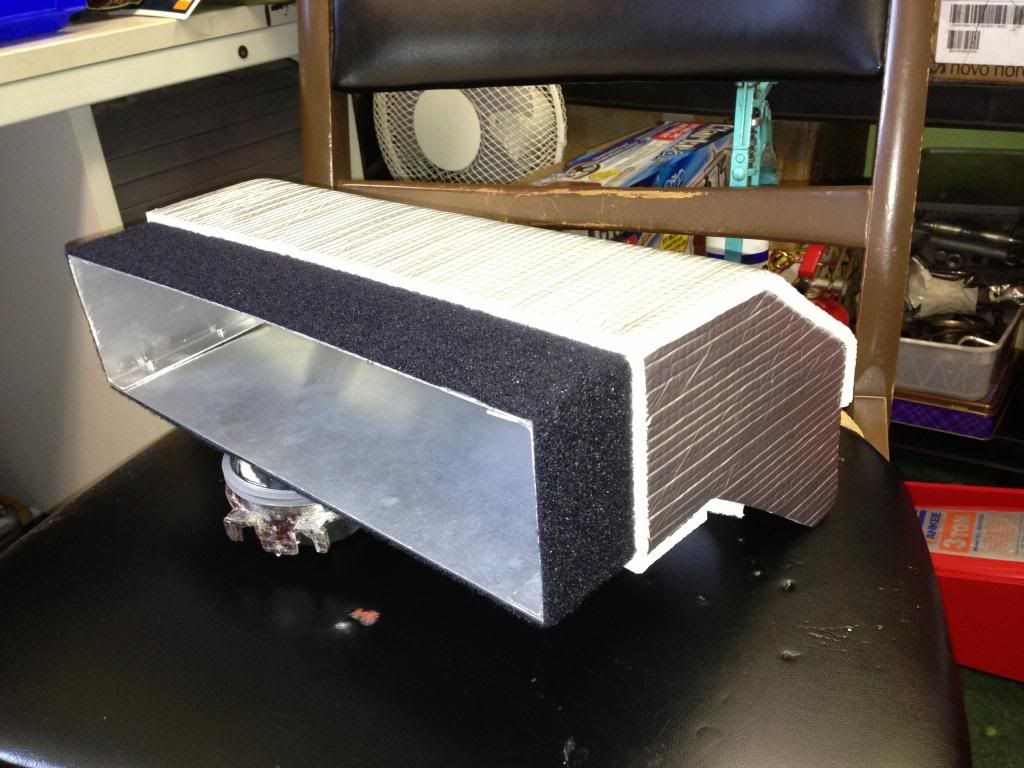

I'm going to metal fill all the edges and sand them back smooth mate, where the front piece joins above the engine will have a rubber seal around it so the front piece can move a little when the engine moves around :)
Looks nice, plastic rocker will defo help stopping heat transfer to the box
I would worry more about the heat off the mani.
Might be worth considering some heat protection in that area? Even just reflective tape? Think I would double skin that bottom section with insulation between:)
Looks really good though!! Very pro!
Cheers mate :) I was thinking that very thing I've got a shield I made from Nimbus grill it's really good stuff! That should help and I've got some heat reflective mat that's for bonnet I'm going to put on the underside all the way along the underneath...
Shield might need a bit of a tweak
