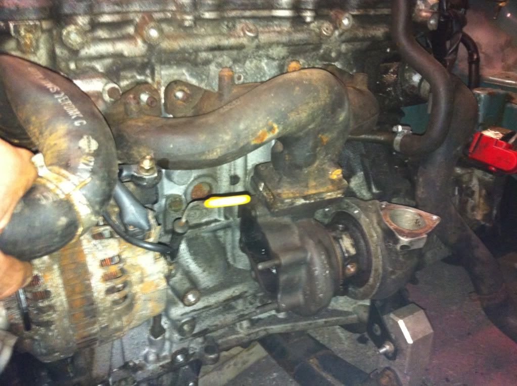

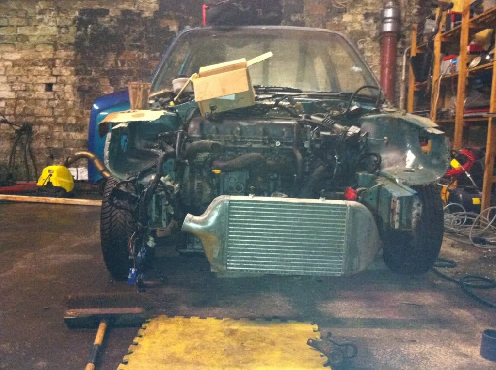

But farting around last night
Free intercooler FTW!

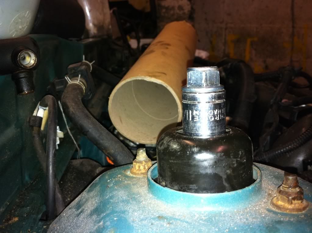

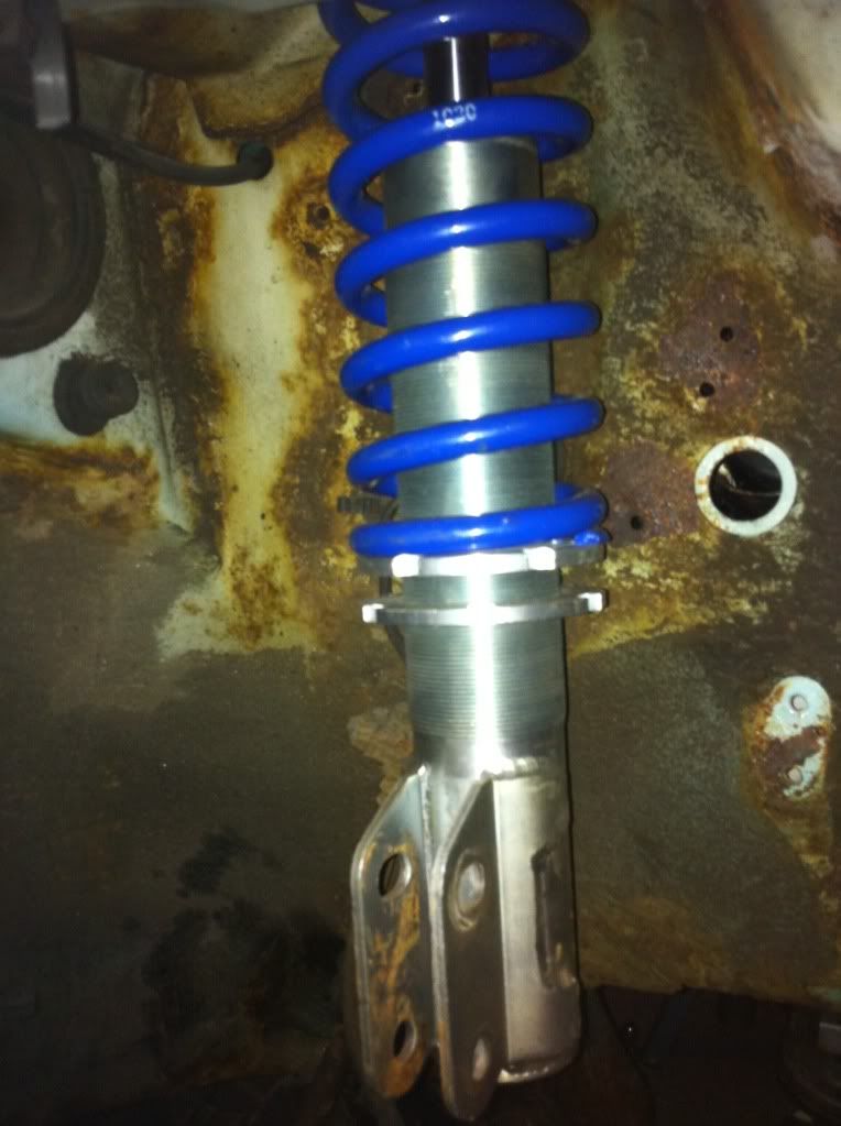

So today we played about with the Corsa coilovers.
After initial fitting, we realised that the actual coilover was knocking. when under load.
So out it came to be stripped down. Once stripped down, the helper spring on the bottom was removed, and the coilover wound up as high as it would go... which is still pretty low...
In order to space out the top mount, washers are required. But since we didnt have any...
A quick ghetto fix until we can get some washers.

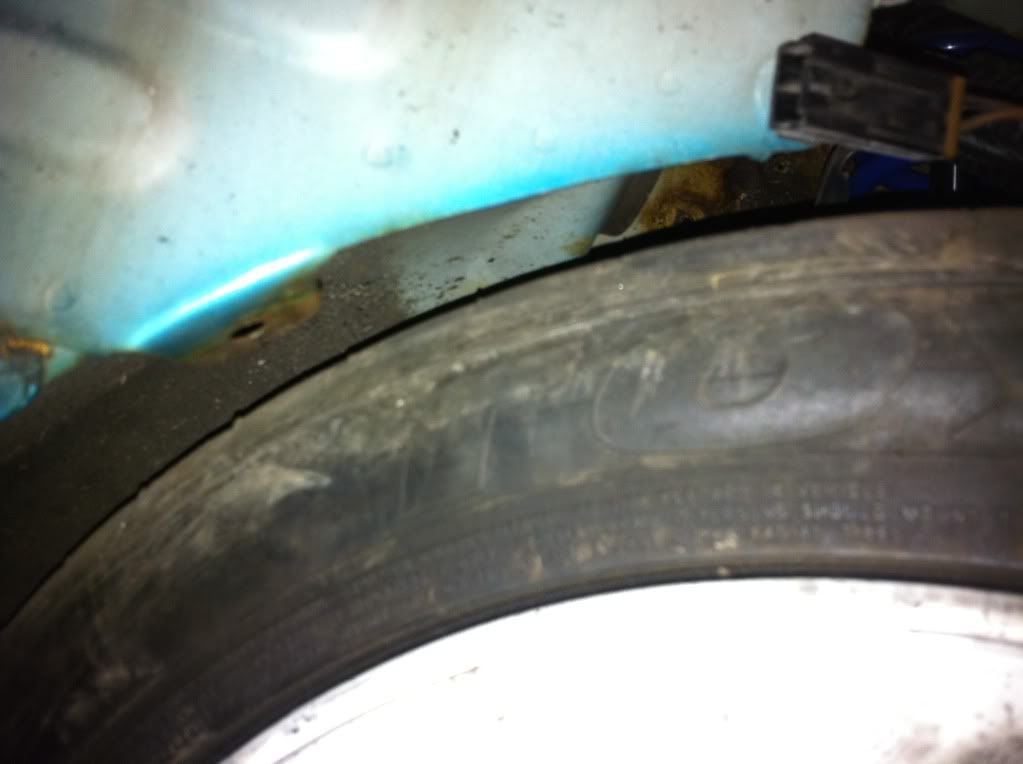

All put back together and fitted onto the car. O.M.G it is so stiff. Standing on top of the chassis rail and jumping up and down, the car just wont move. And after some calculations working out at 18kg springs, I now see why.

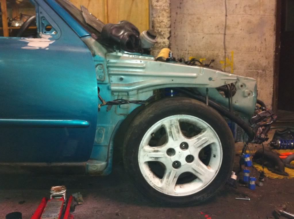

So coilover put on and wheel tightened, car lowered means ;
As you can see there is very little clearence between the top of the wheel and the bottom of the chassis rail. May need arches rolled once the wings are on.
Also with the 15 inch wheels and fat tyres, the wheels are colliding with the inner arch. So hopefully when our current plans of modifying N15 and K11 hubs it will sit further out and clearance shouldnt be an issue anymore. Possibly some 20 or 25mm spacers aswell.
So thats one side done, will finish the other side tomorrow.

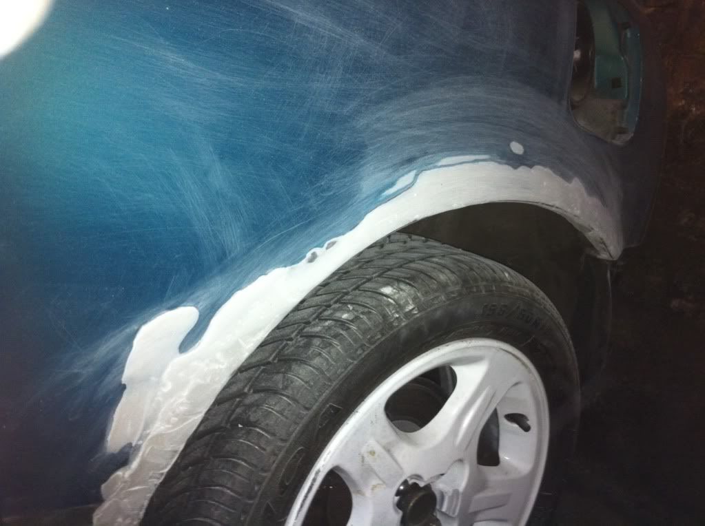

The rear arch still needs welding. Some welding in the floorpan. and ive started sanding down all the filler on the other rear arch. Aswell as starting to sand down the whole car for its respray.

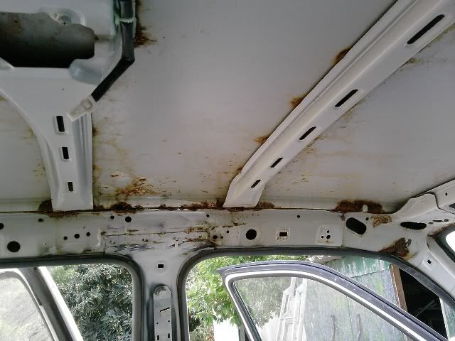

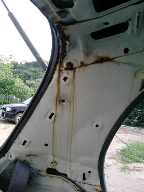

Are you just cutting the rusted metal and replacing with new sheets? Or removing the rust and patching the holes?

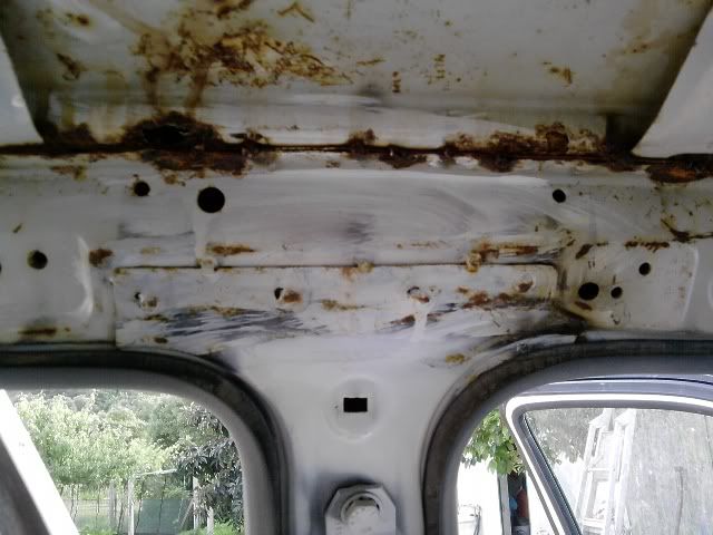

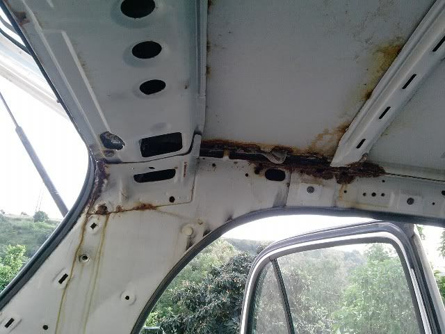

I need to replace the sunroof on a Micra, but the surrounding metal is rusty too, do you have any technique to do such job?
In some areas the rust is being cut out and new metal welded in place. But thats only if its a strucutral damaged part of the chassis. Such as the floorpan, arches, chassis rails. Mainly the stuff that it could fail its MOT on.
But in some areas it is just surface rust, so that is just ground back and filled and painted.
For your sunroof, it all depends on how bad the rust is as to how much work is needed to rectify it. Best thing to do is grind it back and assess if the metal is still strong or grown weak. If its weak/has holes in it then it would be best to have some new metal welded in.
If its just surface rust then, grind back with a flapwheel disk on a grinder, and treat it with some kurust gel thative used on our rust further back in the blog. Let that work its stuff for an hour or 2, wipe off then apply some filler to the area, sand it back, primer and paint.

If your gonna cut the roof off that and weld a new one then make sure you brace the chassis before cutting (Y)
And when finished, go crazy with the waxoyl :p
Thanks for the tips mate. (Y)
Seems that now i know what to do:
- Take all the damaged metal panels
- Remove all the rust with a drill, wheel disc, sanding paper, etc...
- Use some phosphoric acid to clean the surface rust
- Install new metal panels
- Apply some self etching primer filler and leave it to dry for 24h
- Sand the entire car
- Apply normal primer to entire car
- Apply paint (epoxi base, for extra strength and there is no need for using lacquer)
- Apply Waxoyl on all cavities of the car
- Done (and enjoy the car :p)
What to you think about it?
with the roof being of a structural nauture...... i would unfortunately say that, that micra has got terminal cancer and you cannot opperate. i would just not risk it...

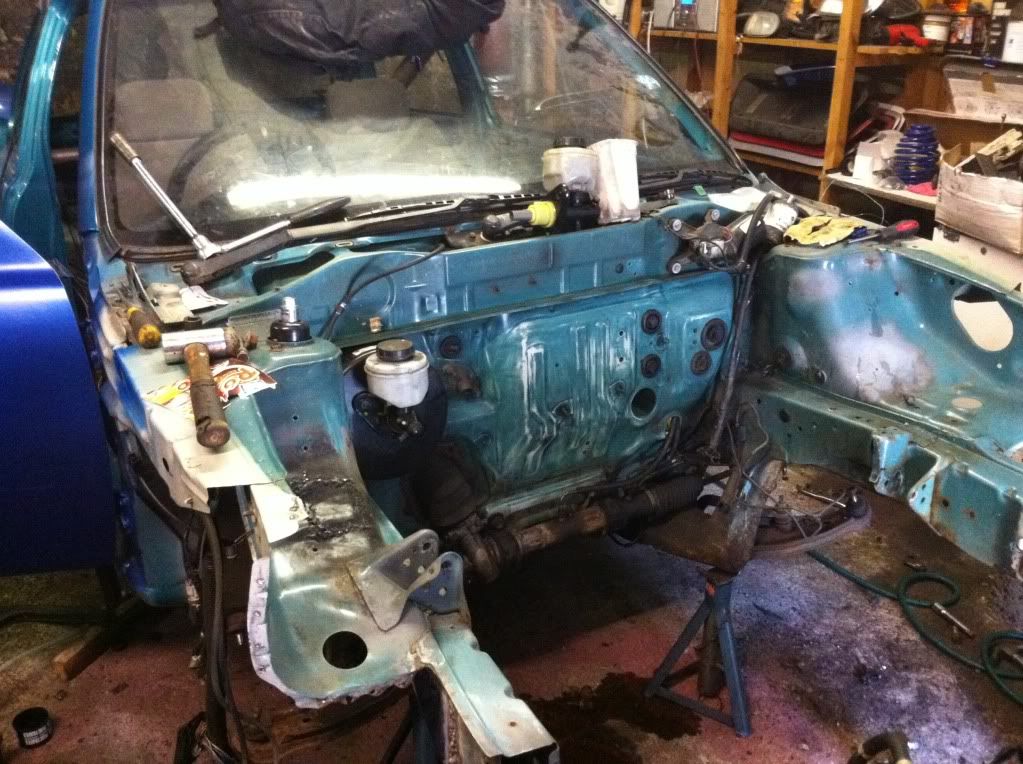

So todays first task of many was to remove the hubs so they can be sent off for machining, making a hybrid hub from N15 and K11 hubs.
Hubs unbolted from strut, Brake lines removed, Track rod cut out ( it was nackered anyway), hub unbolted from the wishbone and hub removed.
Although because of the thread on the ball joint wrecking itself, we are now in need of a new wishbone aswell as a new track rod end. Not that expensive, but cash is tight.

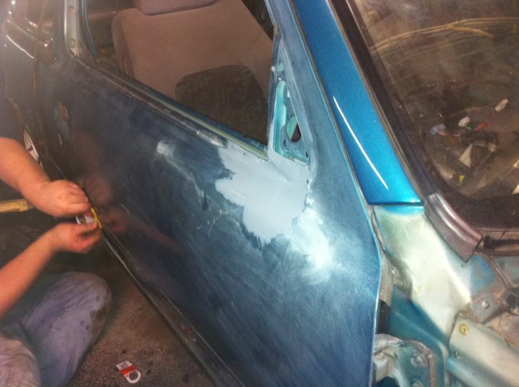

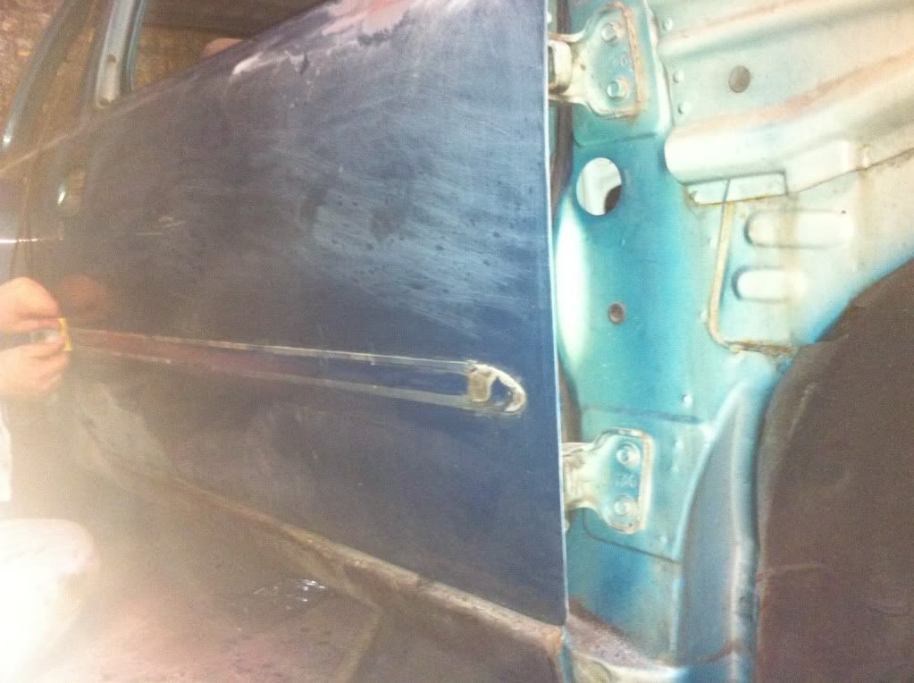

So with that done, moving onto the next task of bodywork. I continued sanding down the rear arch full of filler and ross continued sanding down the drivers door.
And anti rust primer on the wing mirror area ;
Bumpstrip removed ;
Then out came the compressor and paint,

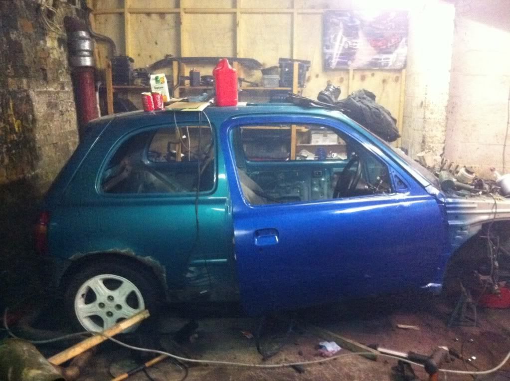

Yes its only the door been painted for now but the car will eventually all be in this colour. Nissan BS7 Blue. We had a lot of paint left over from previous work.

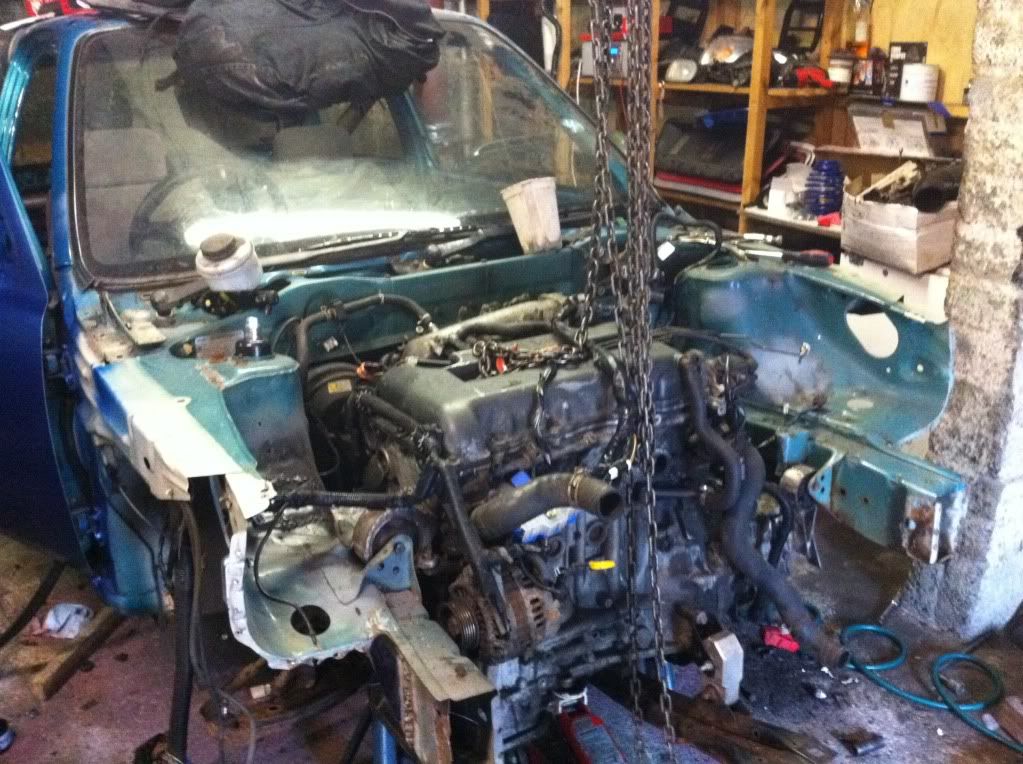

With that done, time to drop the engine again. Fuel lines disconnected, wiring pushed through the bulkhead. Engine loom disconnected from interior loom. And Engine hoisted out.
So with that done we now need to purchase a driver side wishbone and track rod end. Anyone got one spare? Lol

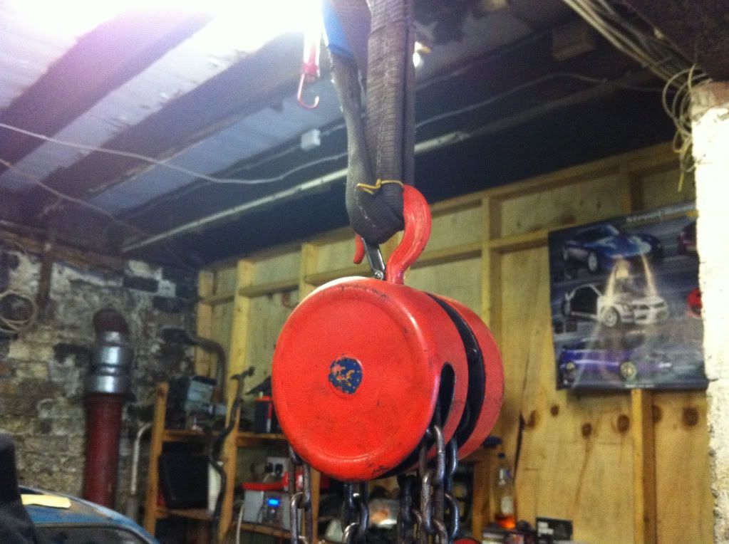

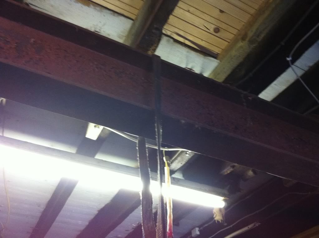

And incase any of you wanted to know what we use an engine hoist ;
Structural beam of the building ;
And a lifting chain connecting to this steel beam via a heavy duty lifting strap and another connected to the engine,
