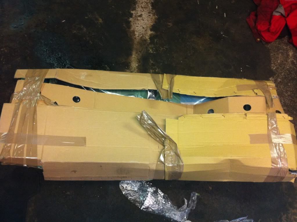

Facelift was decided upon finding a facelift bumper laying in a carpark... win
Got one of them off but the second one is shot let me know if you want just the one and I'll get it sent off asap
Looks good and you really shouldn't scrap it no matter what reason, cams came today aswell.

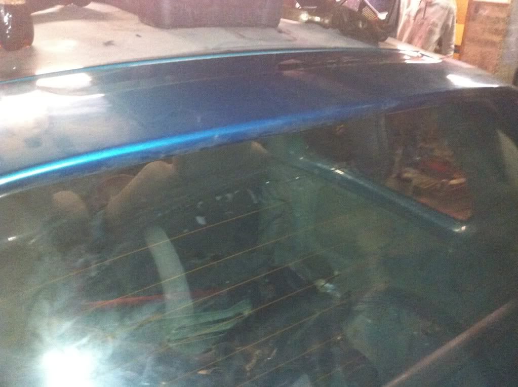

with the roof being of a structural nauture...... i would unfortunately say that, that micra has got terminal cancer and you cannot opperate. i would just not risk it...
+1 scrap it and buy another shell/micra imo. Replacing roofs properlys costs a fortune and i doubt you can do it yourself unless you have the proper tools/equipment to do so.

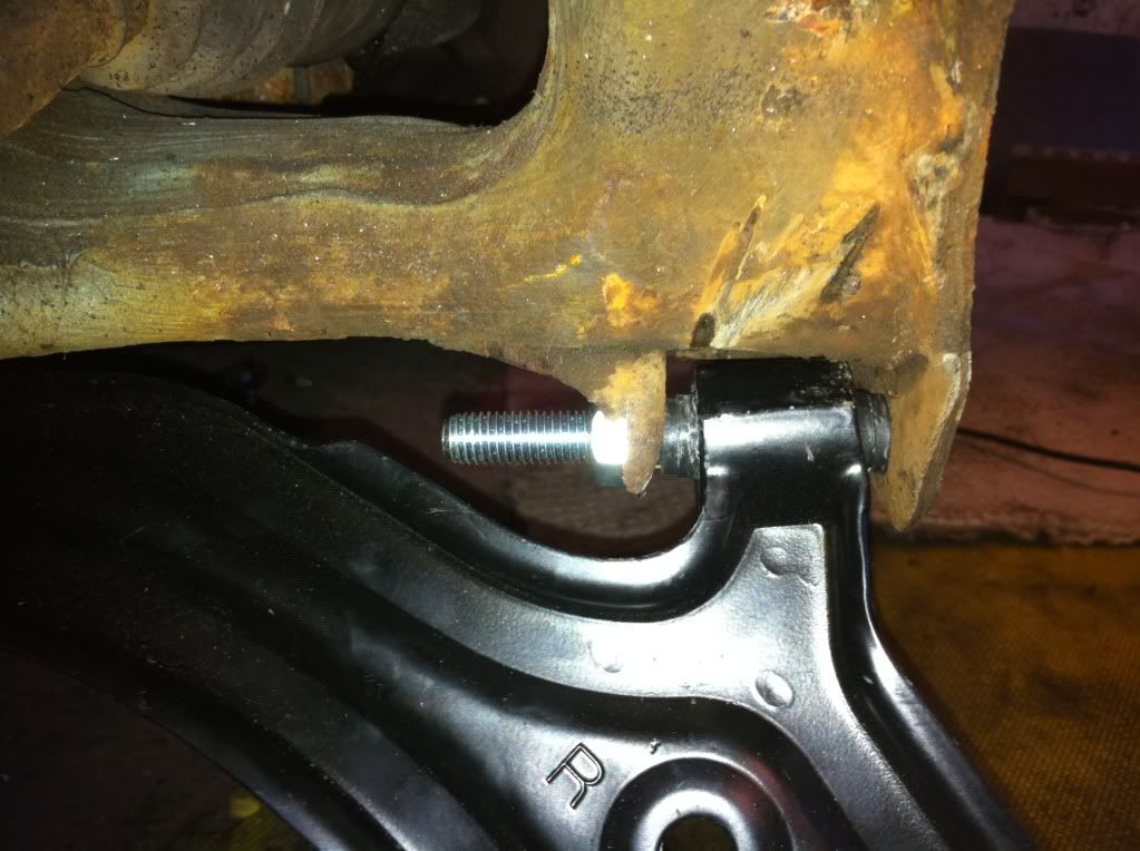

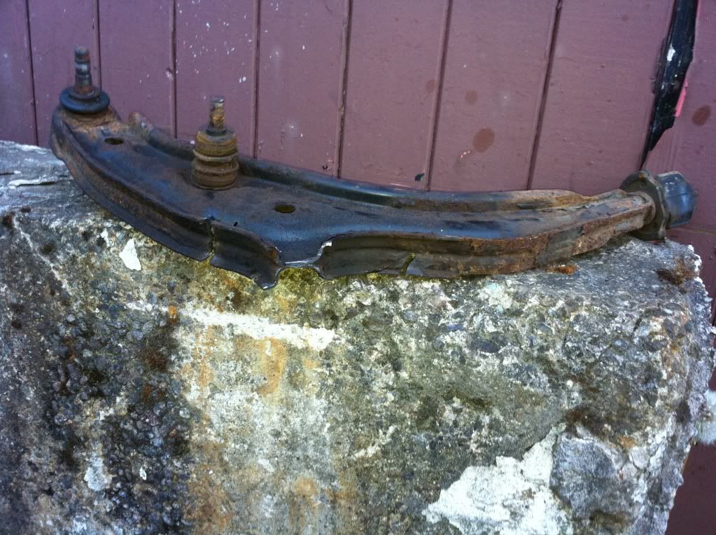

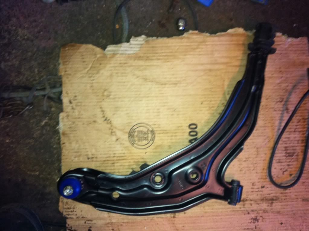

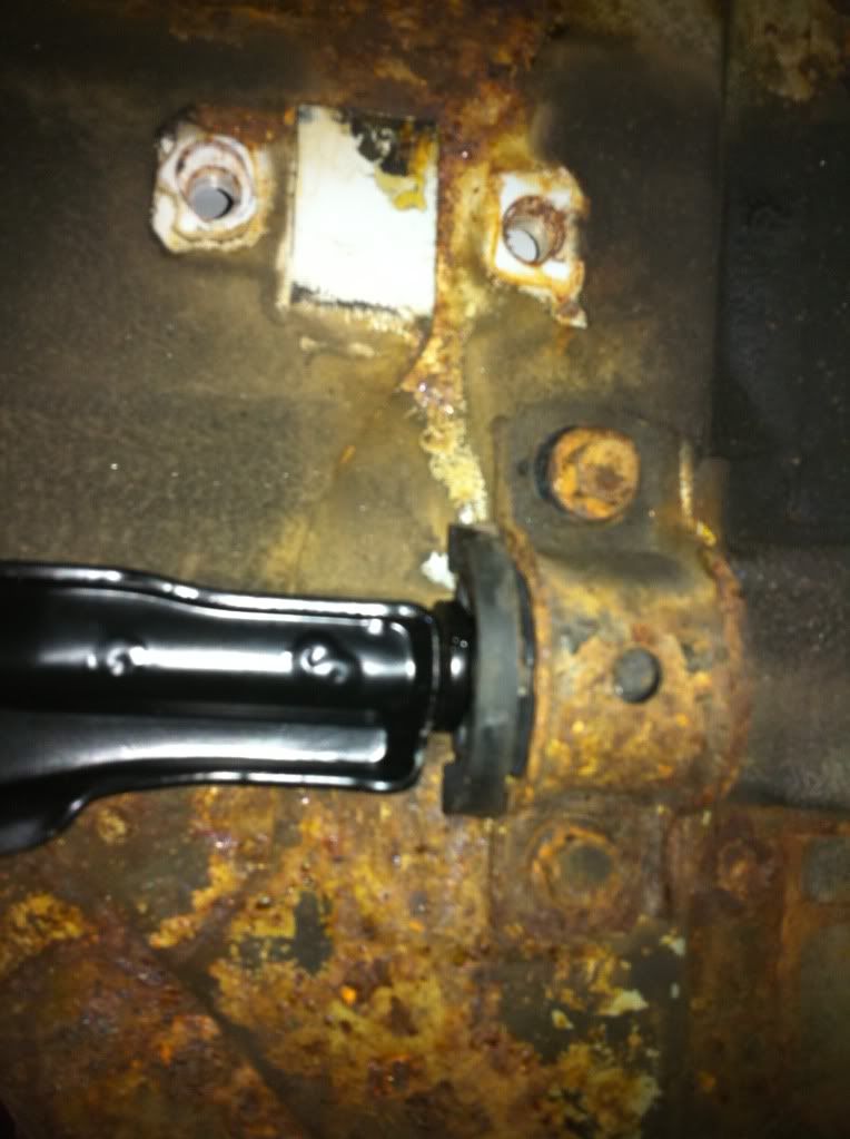

Took delivery of a new wishbone yesterday and started to fit it tonight.

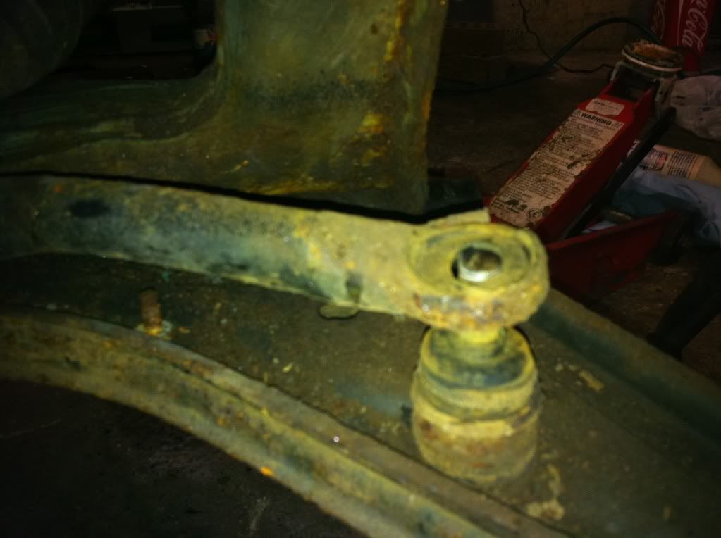

ARB droplink grinded off (gonna be ditching the ARB anyway)
Back two bolts holding the bush in place removed and stored (no pic)

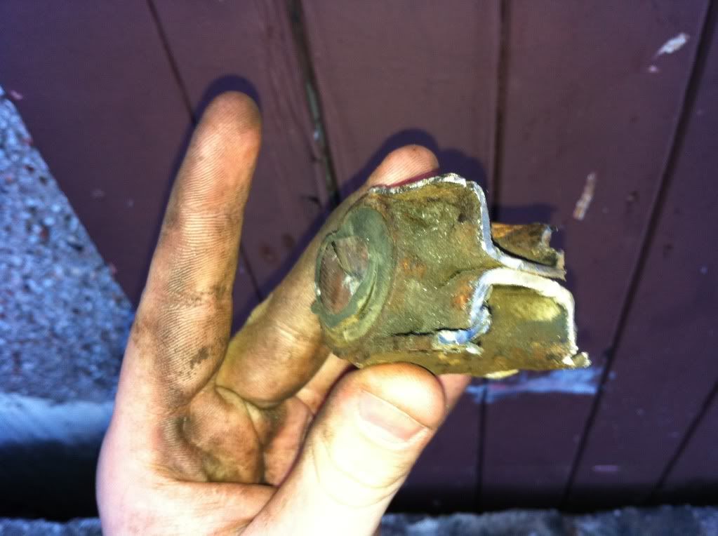

And big massive bolt holding it to the the car....snapped. Great.
After much hammering and WD40 I gave up, will try again tomorrow.

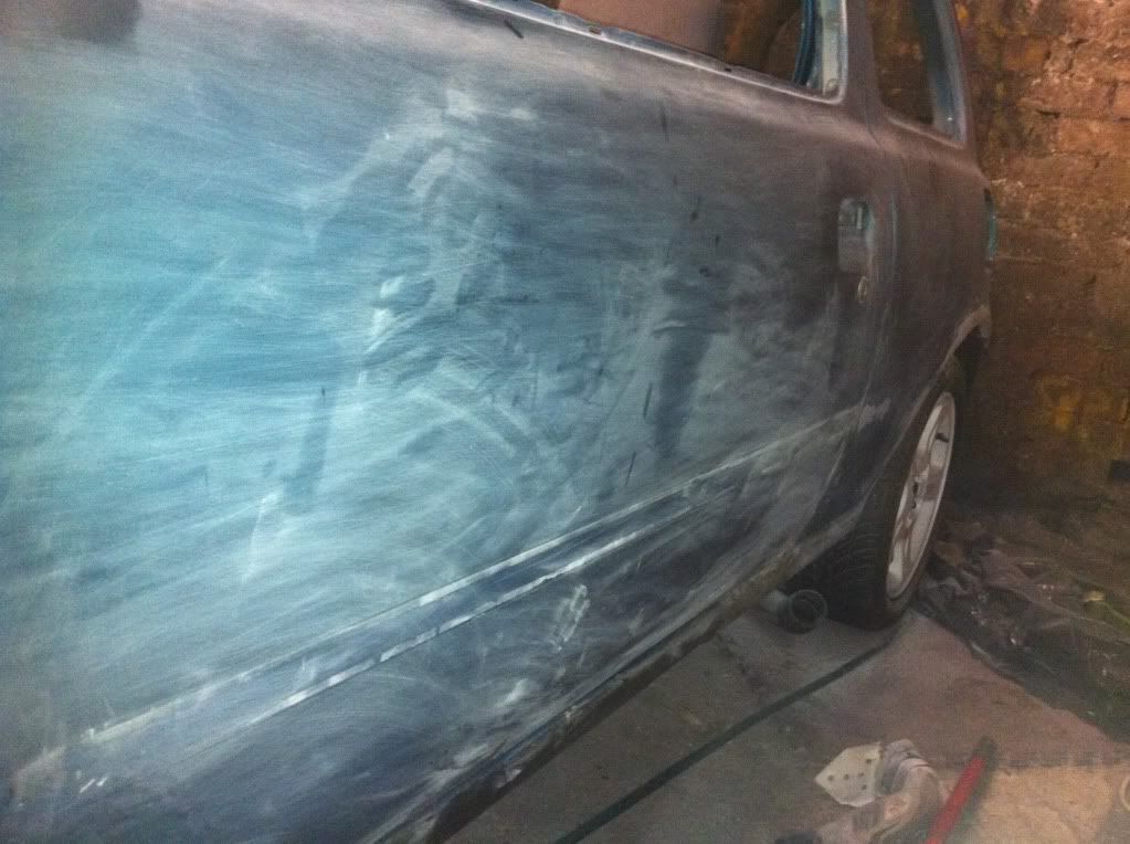

Also the whole passeneger side has been sanded down, bumpstrip removed, door handle off ready to be painted.
And ROSS (not Rick) managed to crack the windscreen yesterday. So need a new one of them aswell.

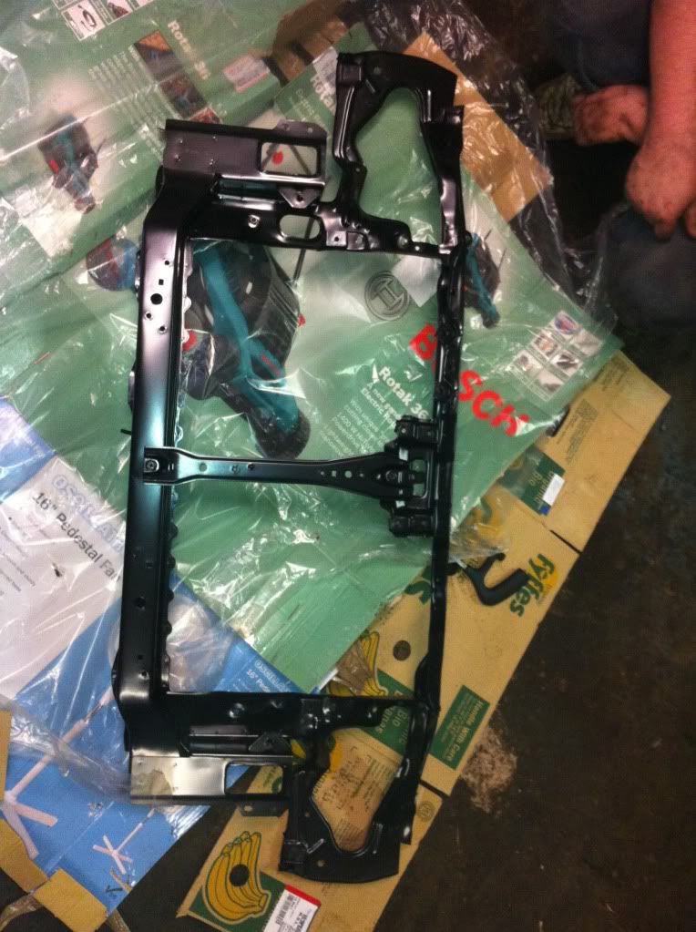

New front panel has been ordered. Hoping it to be delivered tomorrow.
So Mr Grinder was introduced to Mr Wishbone mount tonight, They got on well i would say.
Although he went a bit far....
That took so much effort. First grinding the end of the nut off which still wouldnt come out, to then grinding the whole wishbone off, still nothing. So jamming the grinder in the mount soon solved it and out came Mr wishbone.

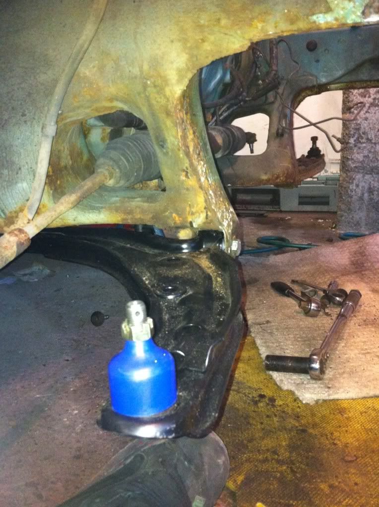

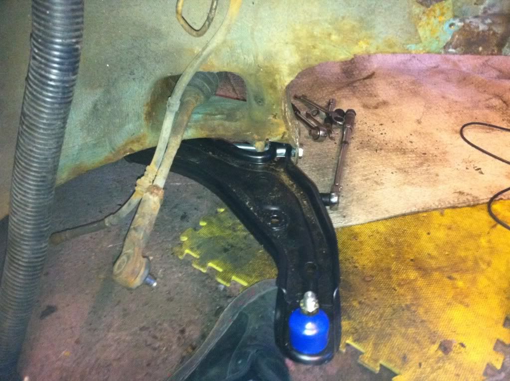

New wishbone :
Put into place with biiiig bolt.
Bolted up to chassis
Then all tightened, Main bolt torqued up to about 130 lb/fts.
In place ready for hub to be fitted,

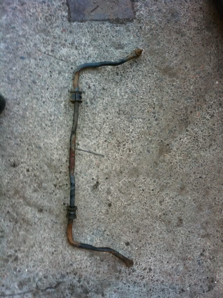

Then I removed the ARB,
Toothpick comes to mind, its that skinny....
If it is gonna be refitted in the future it will be painted and added with some fresh ARB droplinks and possibly some poly bushes.

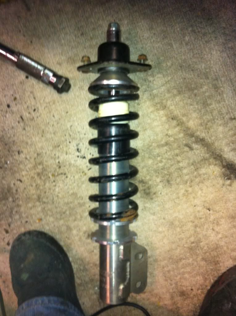

Also on the coilover front. Delivered today were 2 Daiyama 63mm springs. 5kg springs from N15 Coilovers, straight fit and alot softer than the original corsa ones. So hopefully these will soften it up a bit and no longer need the helper springs but can also let us keep our spines intact.
One fitted :
Other side still to do.

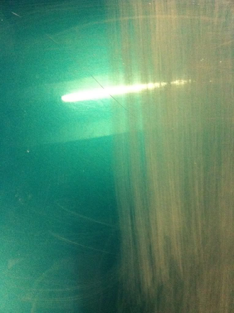

Also the whole passeneger side has been sanded down ready for painting.

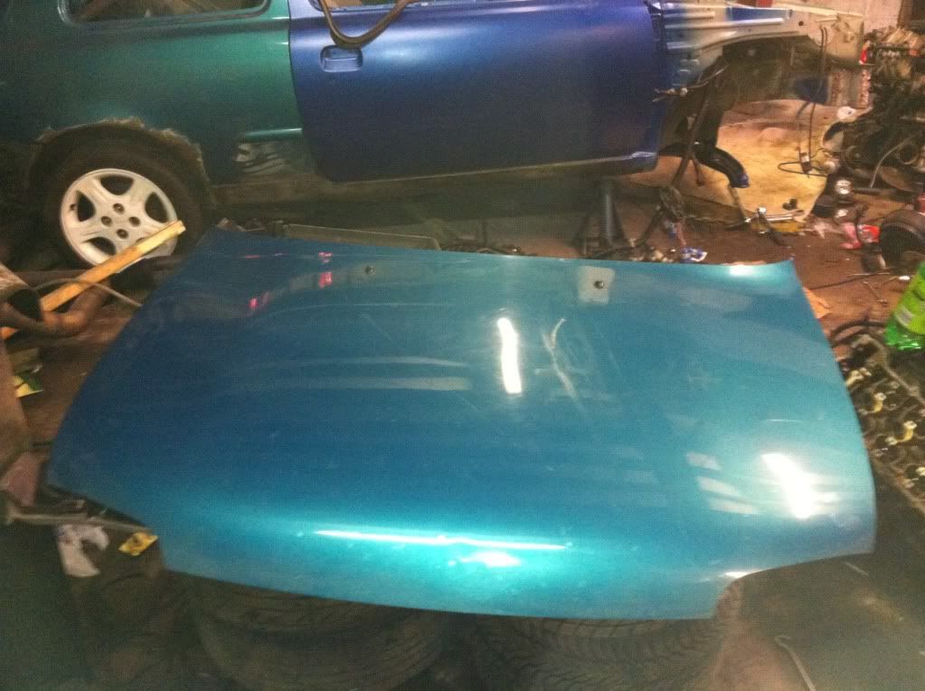

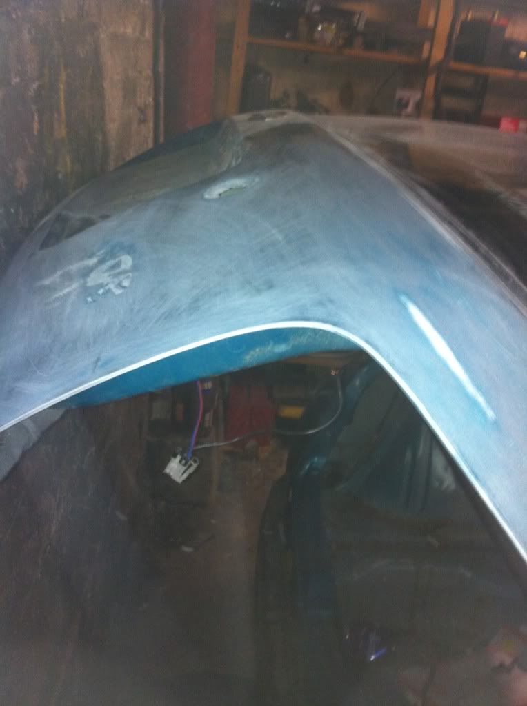

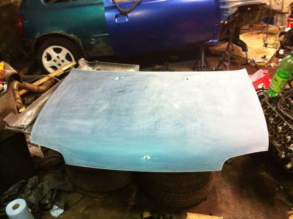

Also started on sanding down the bonnet.
Start ;
Halfway ;
Finished ;

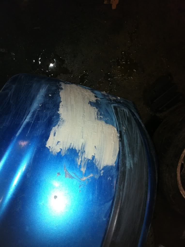

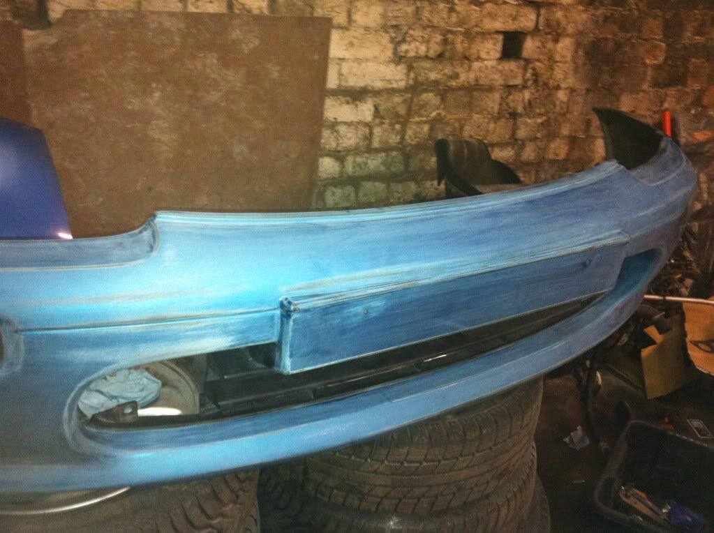

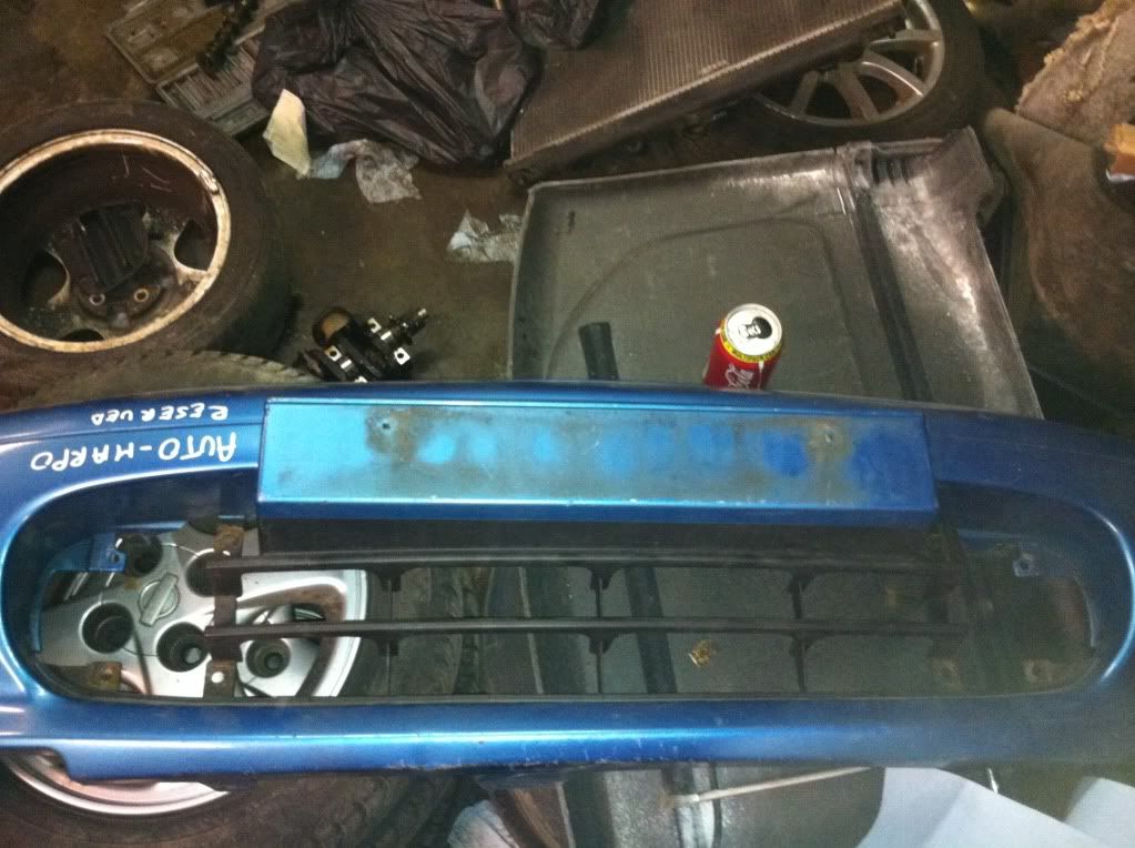

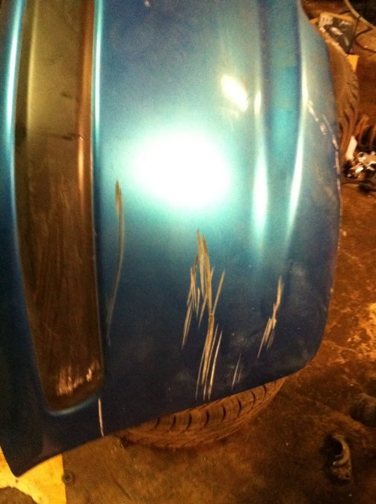

And then started on the front bumper.
Start ;
Washed down of oil and dirt,
Fog blanks removed ;
And the deep gouges on the edge ;
Sanded down and filled ;
Left to dry until next time.
Will finish sanding down bumper then tailgate area next time.

Bumper sanded down more and finished ;

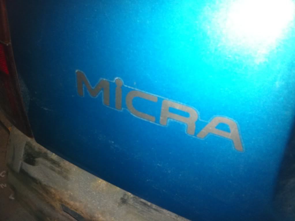

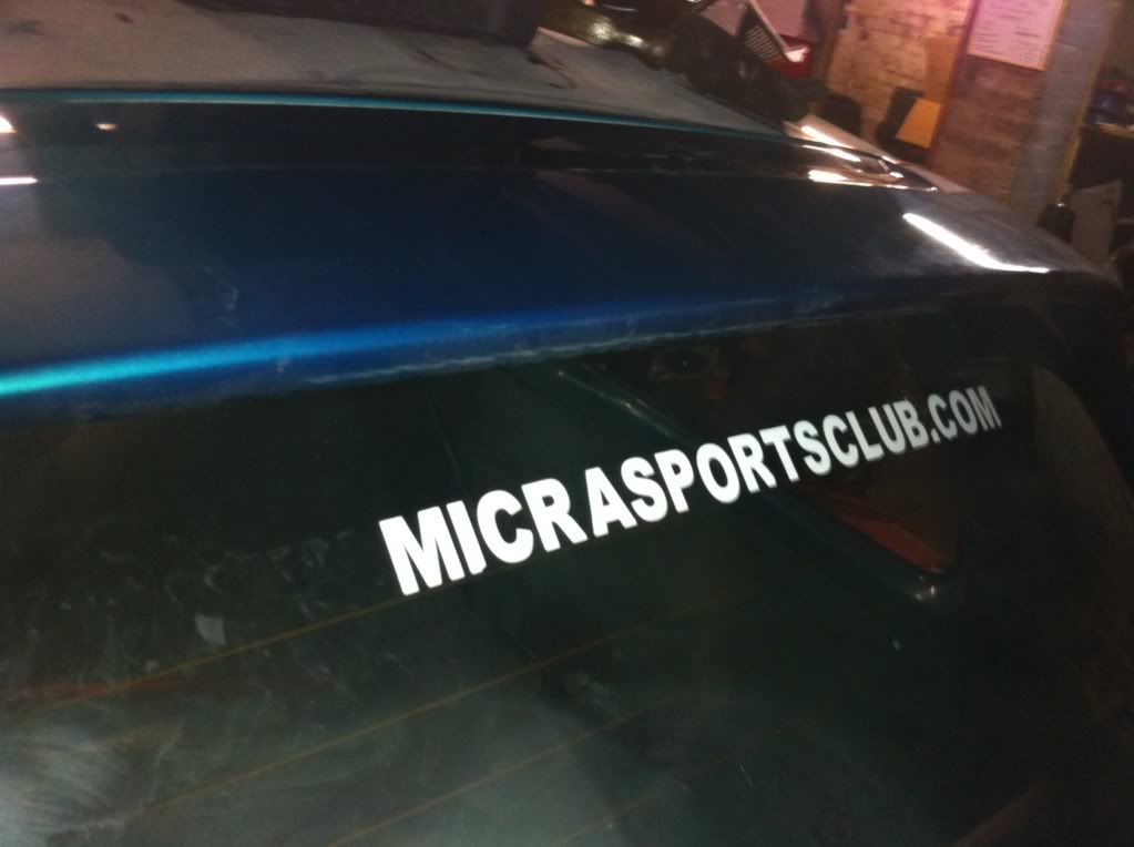

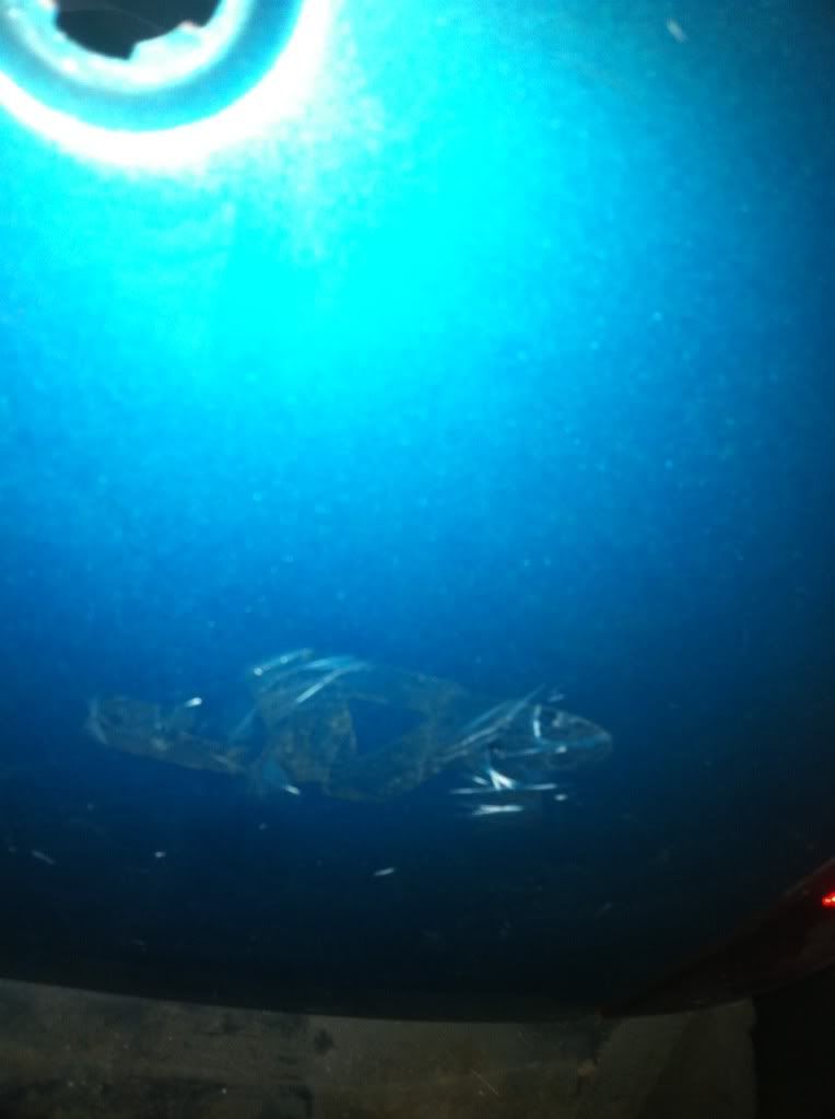

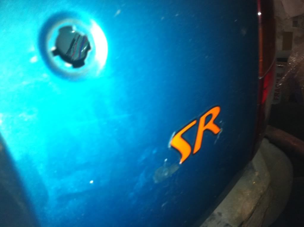

Then moved onto the tailgate and removed all the stickers ;
Sticker on rear screen
Gone :
SR sticker,
Gone ;

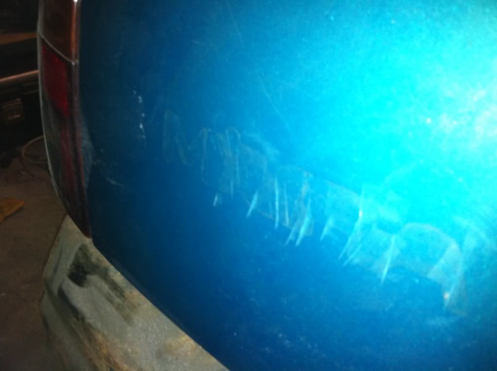

Micra sticker ;
Gone ;

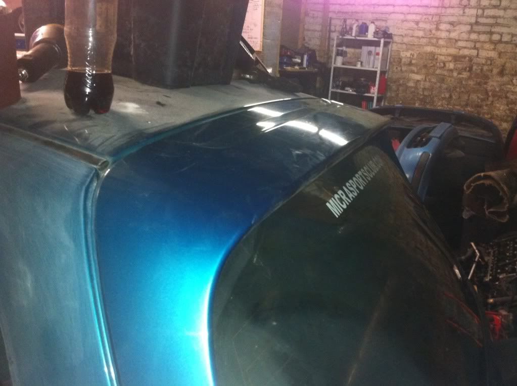

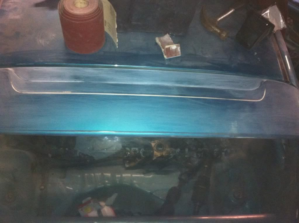

Then started to sand down the spoiler/tailgate.

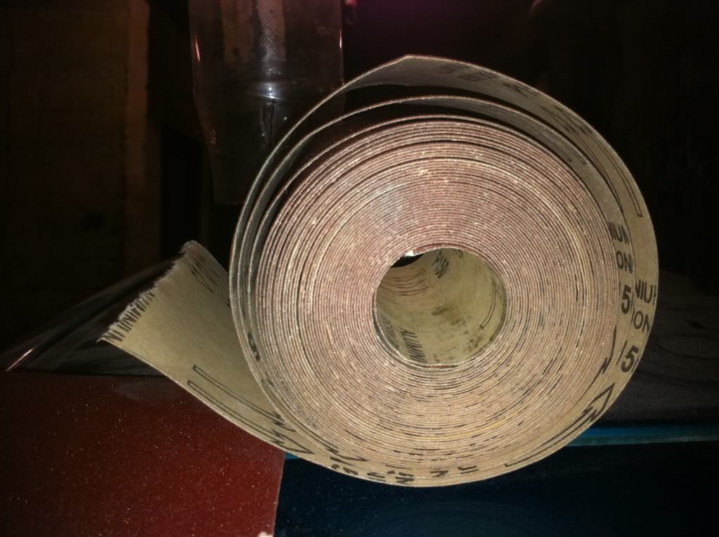

Lotsa sand paper!
Before ;
After ;
And continued down the tailgate.
will continue with the rest of tailgate tomorrow, still got to sand down the roof, A pillars and rear drivers side arch once the welding has been done.

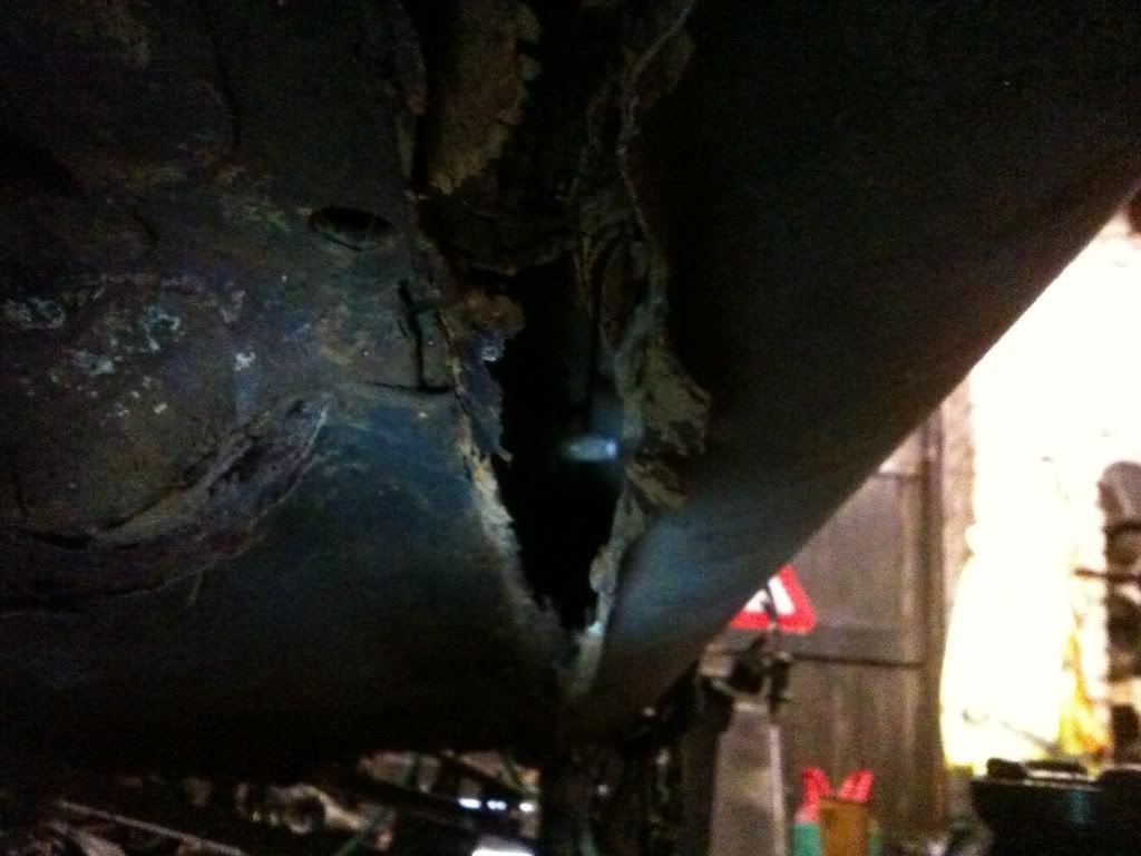

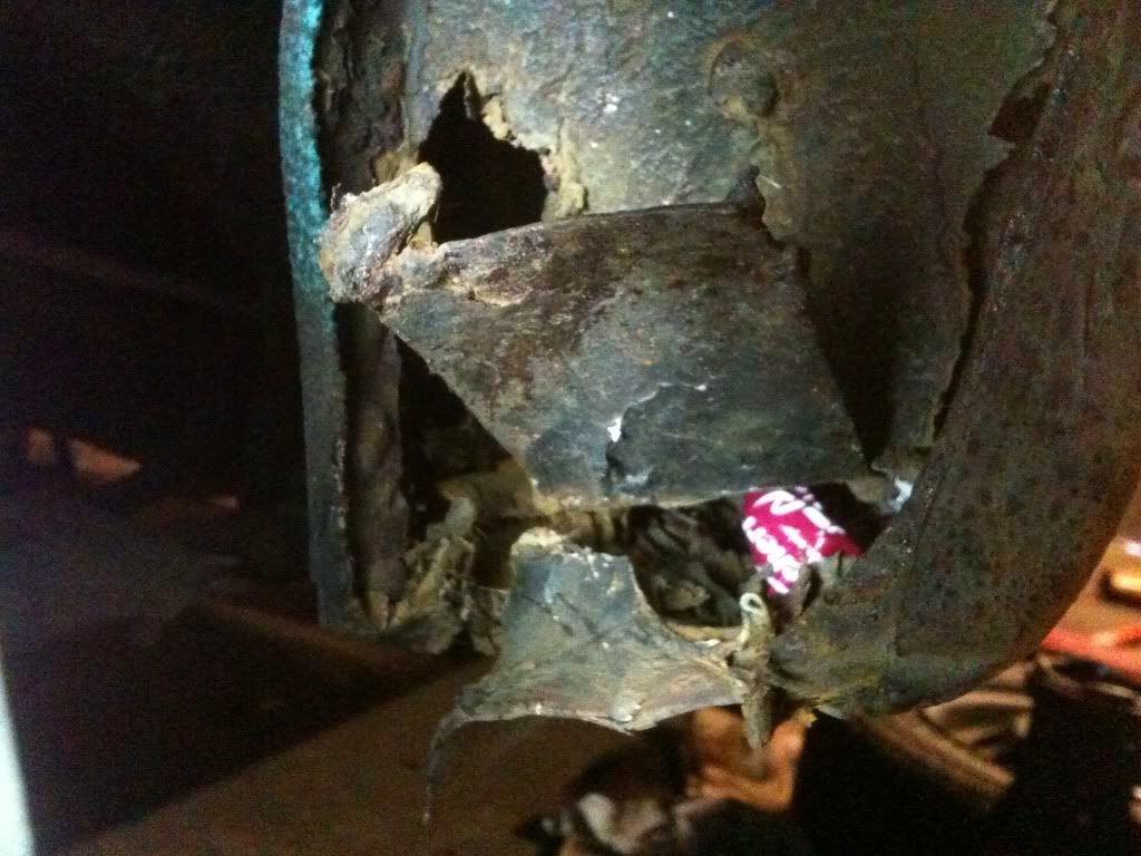

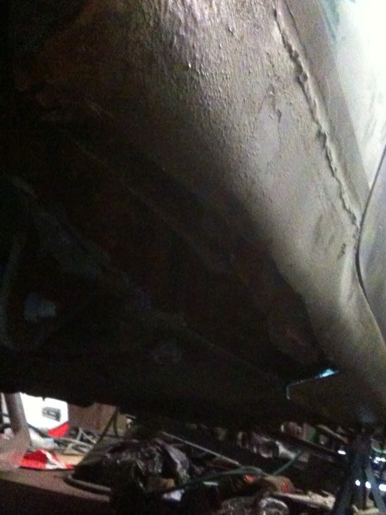

i went to get to work on welding the rear arch tonight in high spirits of completing the final welding job of the project!

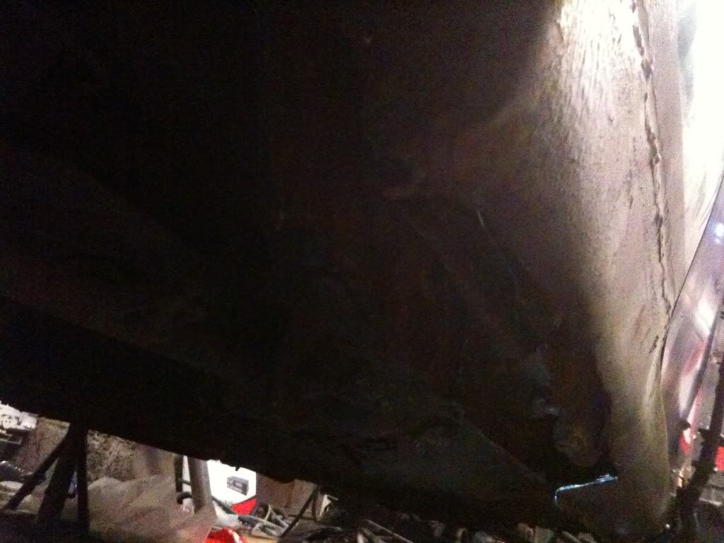

my spirits were short lived when i stuck my hand under to feel for the jacking point and felt a hole in the sill. no matter, ive welded teh sills on both my N15's! just a little extra hassle! but no
turns out that whoever repaired the sills previously did a bodge job of it. the replacement panel was welded along one edge and seam sealed/siliconed/glued on the other 3 sides. not on its own a major issue but the fact it was badly repaired on the end cap has lead to it becoming a mud trap... i easily removed 3kg of caked mud from the sill when i cut it open.
unfortunately due to the extent of the rot, running from the rear arch along the sill to the middle of the door me and rick took the joint decision that repairing it would be false economy. yeah, i could weld it. but there was so much missing inside the cill that there was no structure left in it. so if weld it and we take a knock at knockhill it is likely to collapse. since it is a track car the risk of said knock happening is vastly increased and it is not a risk i am willing to take.
below are pictures, the second picture believe it or not is how it was before i touched it. it passed an MOT with this extent of repair...
the pictures are hard to make out but here you go :
