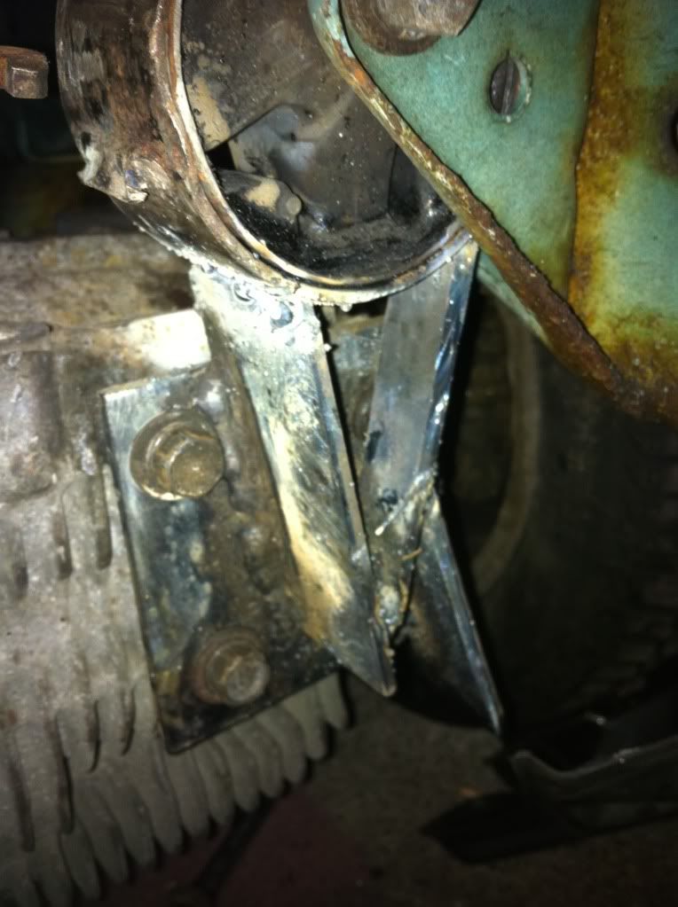

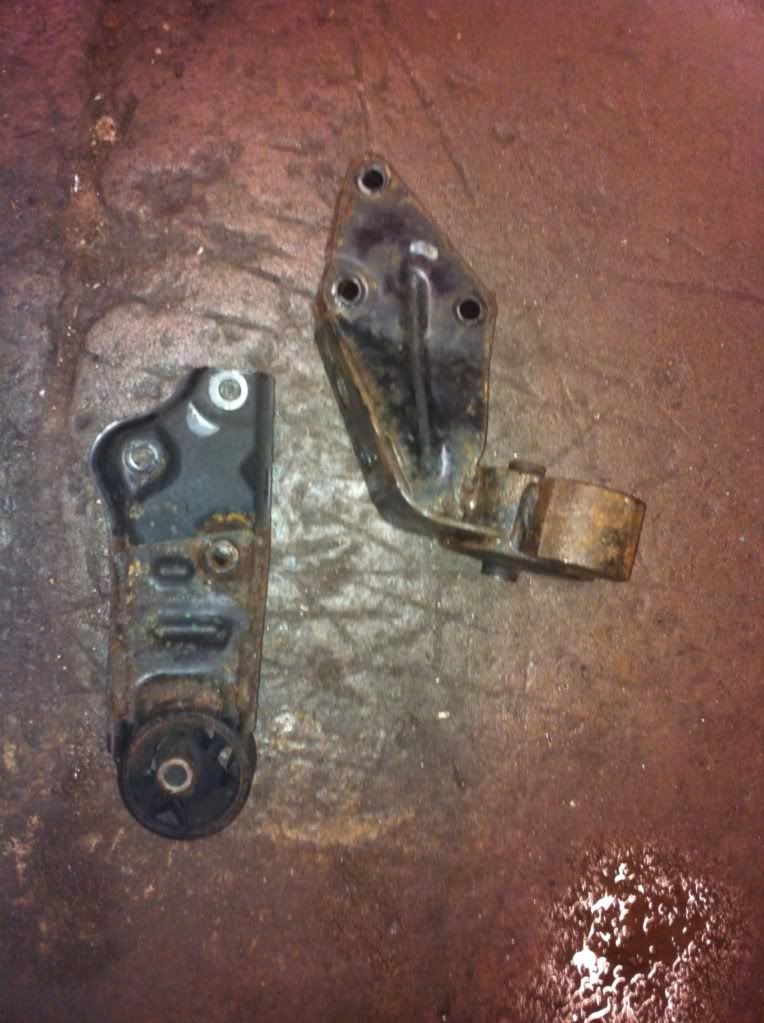

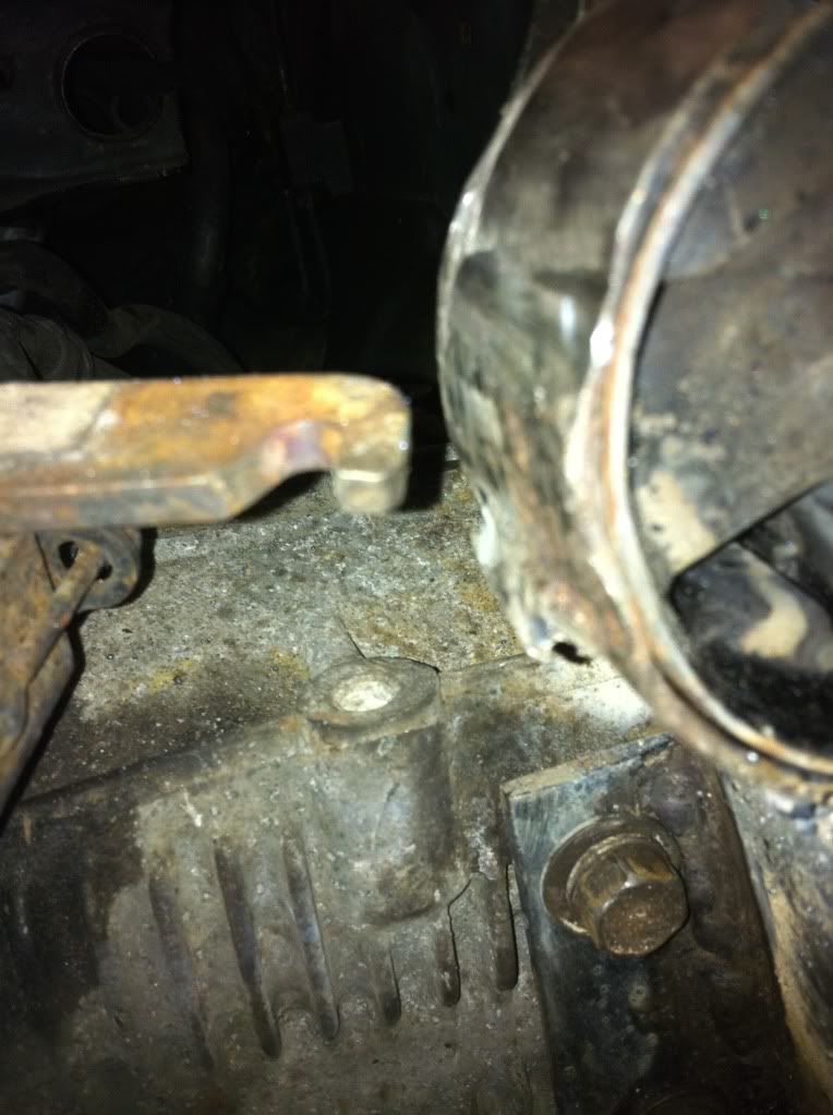

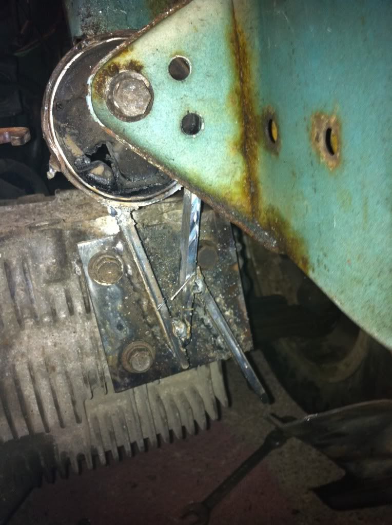

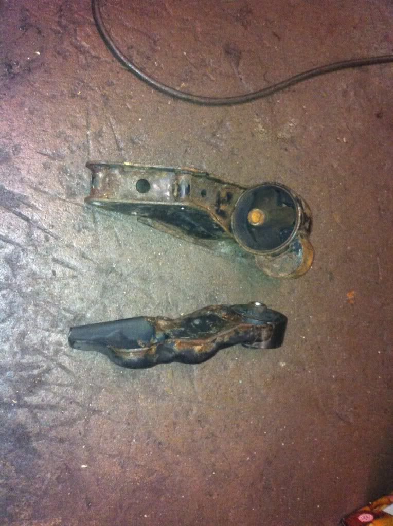

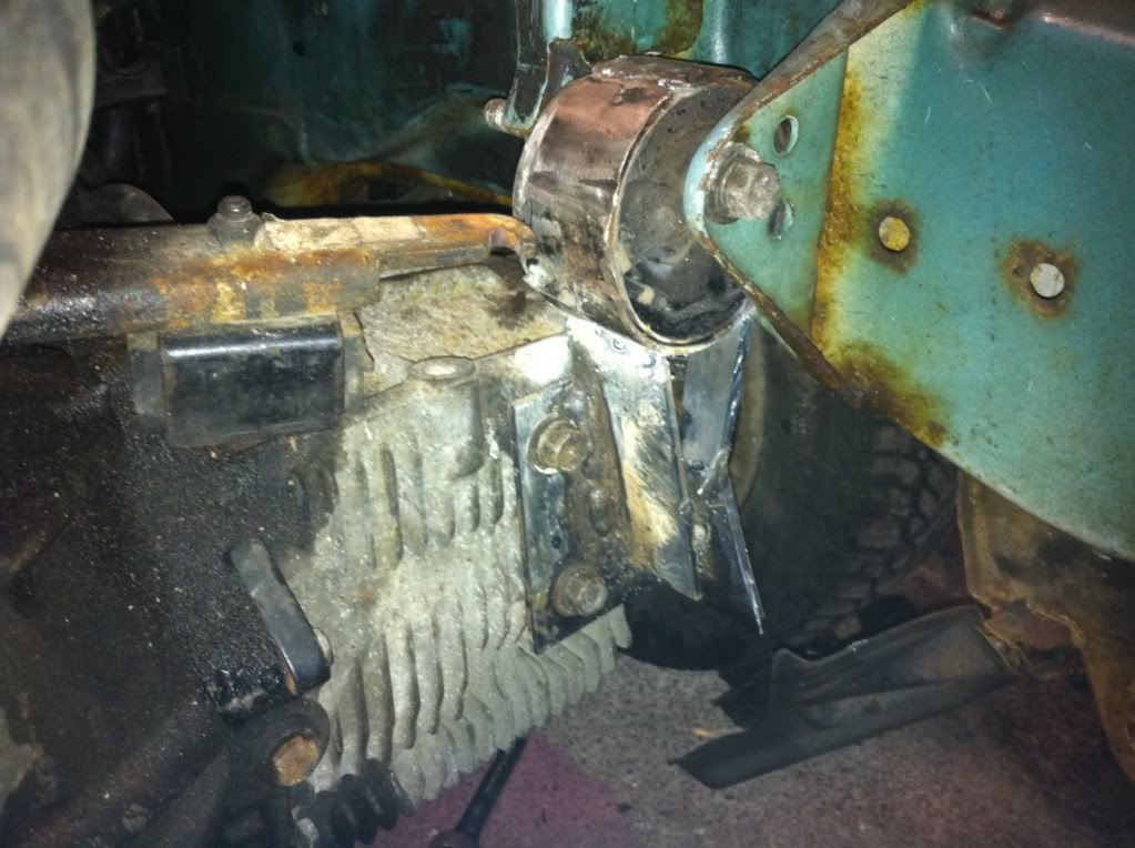

Tonight the gearbox mount was fabricated up. I removed the Gearbox mount form the Almera.
Almera GA14 mount is the one with the odd angle and the Micra mount is the relatively straight one.
So the Almera mount was used due to it being beefier than the Micra one as you can see,

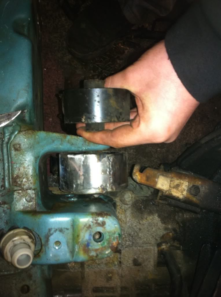

The Almera mount was cut up, The section with the bolt holes was grinding off and offered up to the mount holes on the gearbox. Unfortunately 2 of the 3 holes lined up, but one was a few mm out so the bolt wouldn't go in.... Back to the drawing board (or whiteboard in this case).
This cut section was then used as a template to make a mount from 5mm thick steel. The steel was cut and the holes on the original mount were drilled through onto the steel and with a dremel, the offending small hole was bored out so it could be bolted up.
Once bolted up to the gearbox, the rubber mount and metal holder was cut from the remaining bracket and grinded down to fit into the current micra mount on the chassis. Once this was done, another piece of steel was cut and positioned using magnetic clamps. It was tac welded into place and then removed from the car to be properly welded.
The mount was then giving some extra bracing for strength and fully welded up then bolted back onto the gearbox.
Then slotted a bolt through the mount and chassis and tightened up.
End product of the mount :
Its quite close to the clutch arm, so this may need to be rectified later on once a clutch cable has been fitted
Which resulted in this :

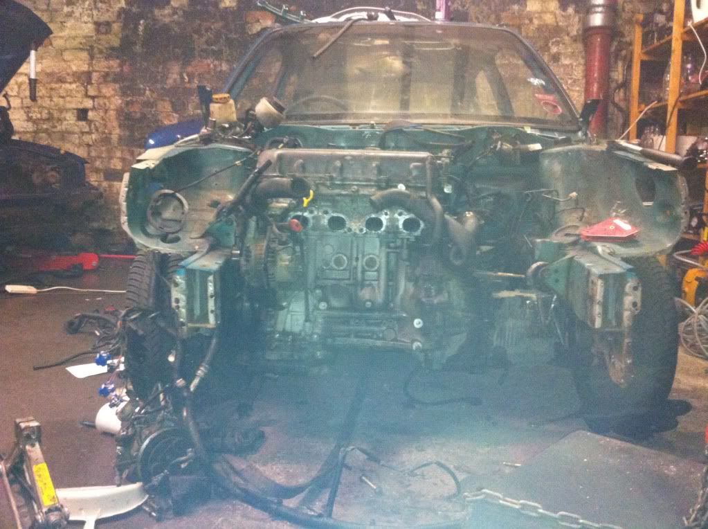

The engine is now sitting in place on its own, no engine hoist, nothing.
It will be left for a few days to see if the mount is strong enough (which it should)
So 2 mounts down, 2 to go. The next 2 shouldn't be too hard (Y)

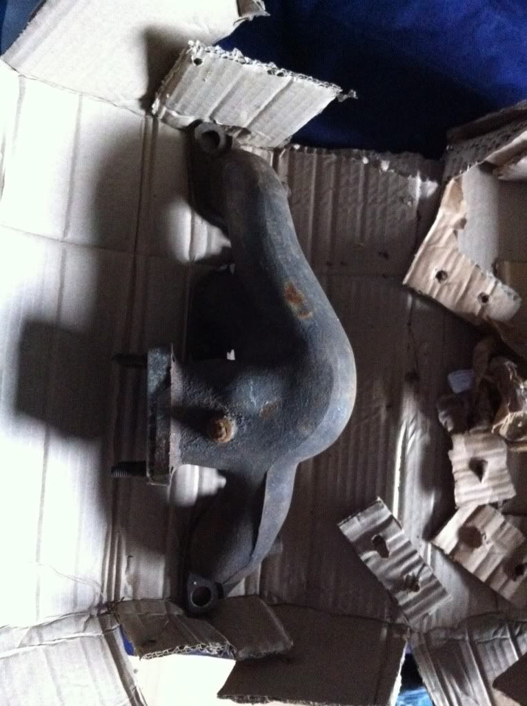

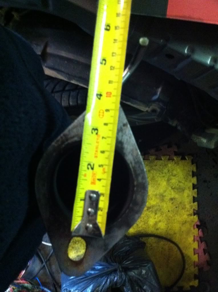

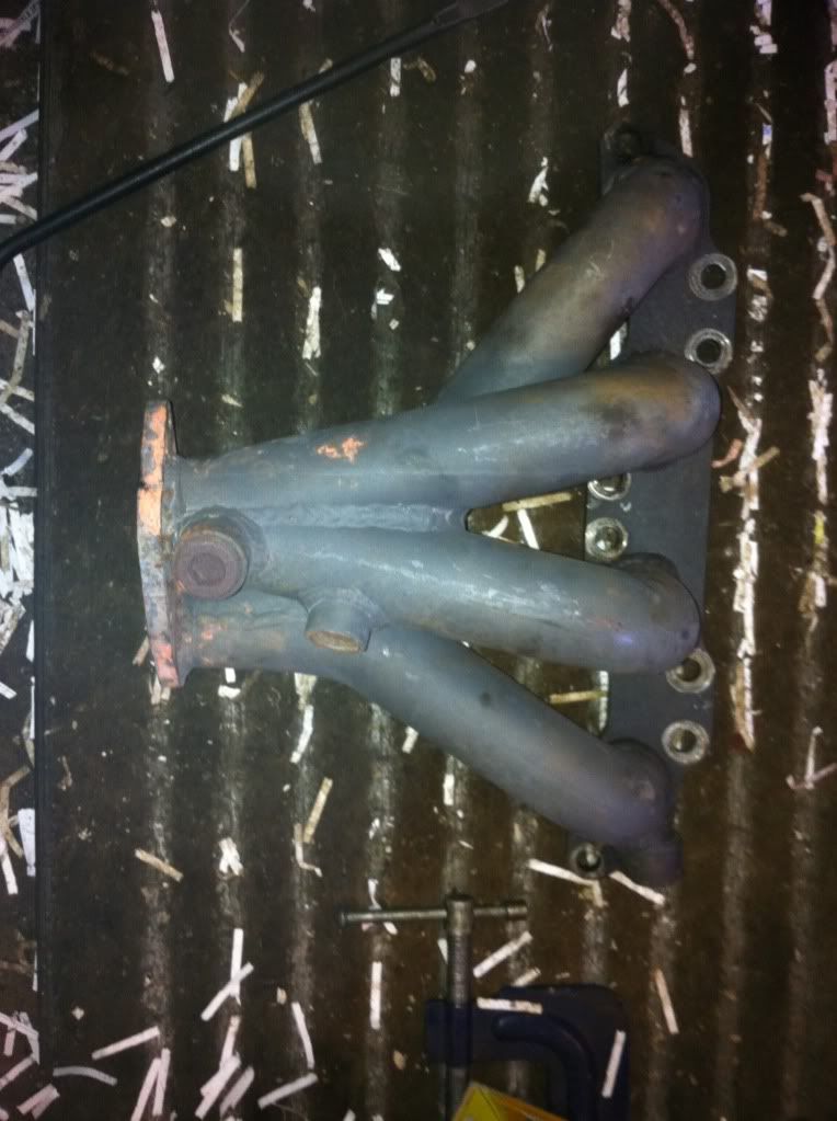

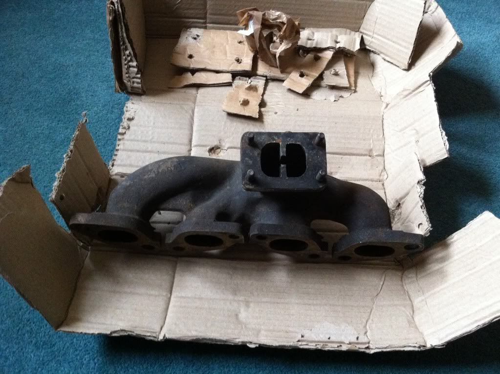

Next piece of the puzzle was delivered today, in the form of a Hotshot gen 5 exhaust manifold...
Primary runners of 1.75 inches.
And the downpipe : with a bore of 2.5 inches (Y)

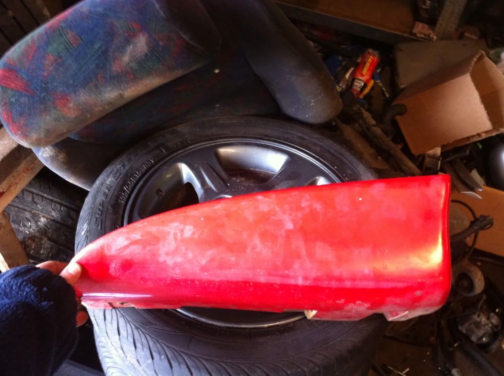

And also on a scrapyard jaunt last weekend, i picked up these :
Mazda MX-3 skirts/spats from a US import model (I think)
These are prety much a direct fit onto the micra (no pics as i couldnt get it to stay on and hold camera at the same time)

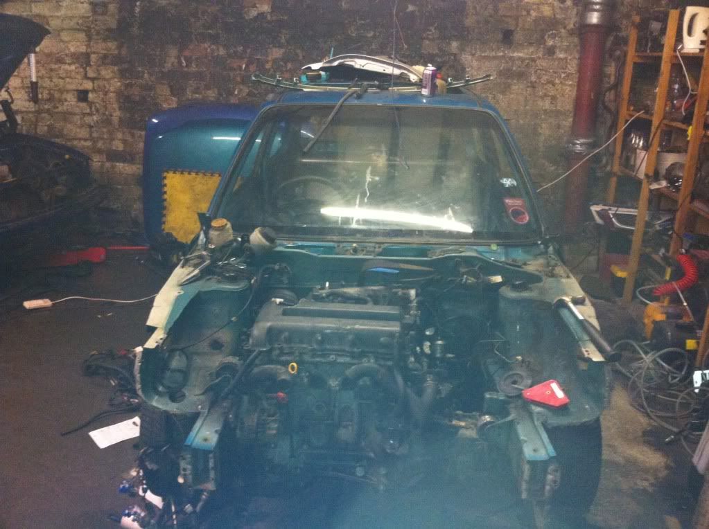

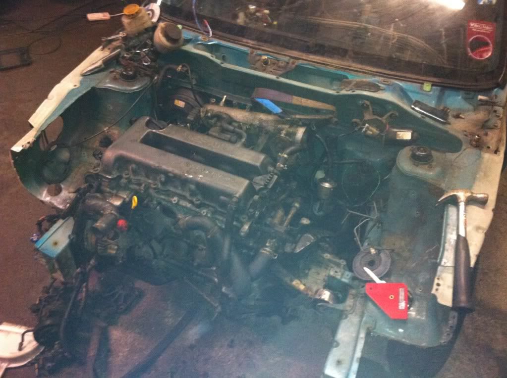

So tonight was mostly spent on wiring and adding some stuff to the engine.
So far on the wiring side of things all is looking good with everything from the front of the car pretty much working and a few things from the back like the rear lights.
The missing brackets were also put onto the engine ready for it to be put into place and the crossmember fitted.

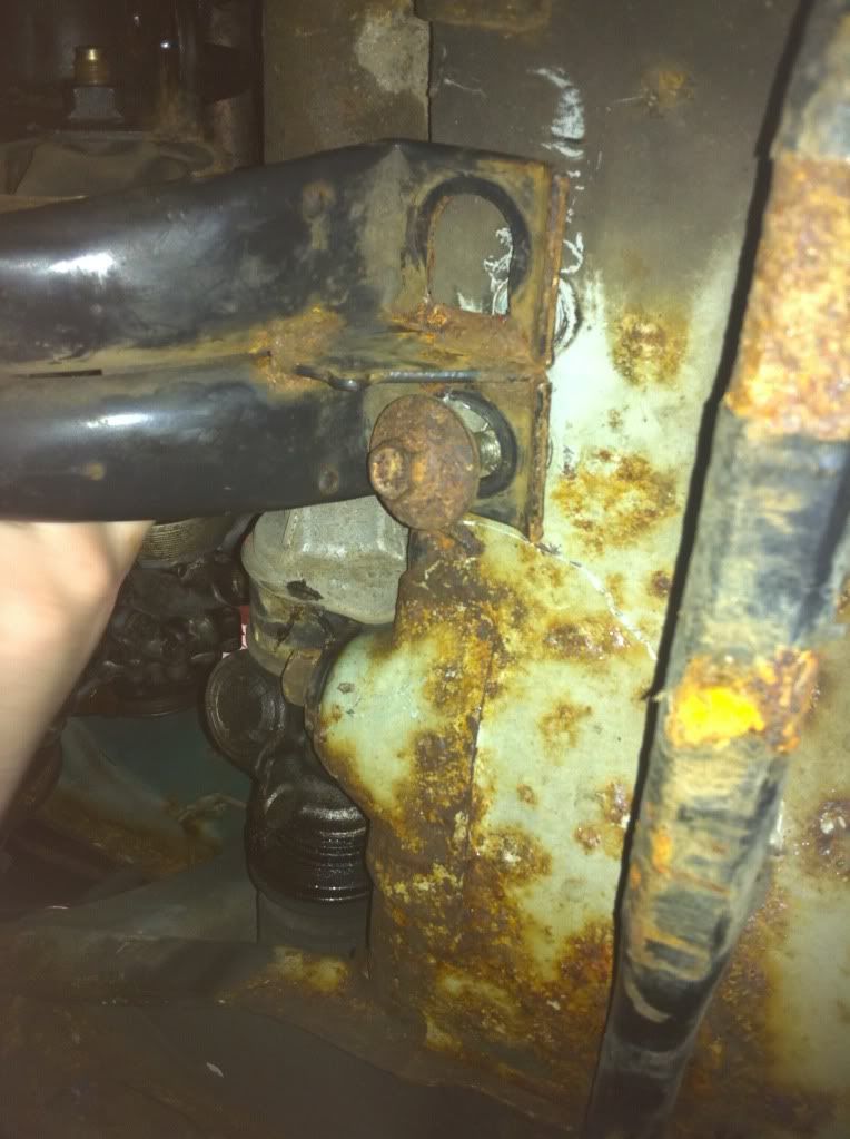

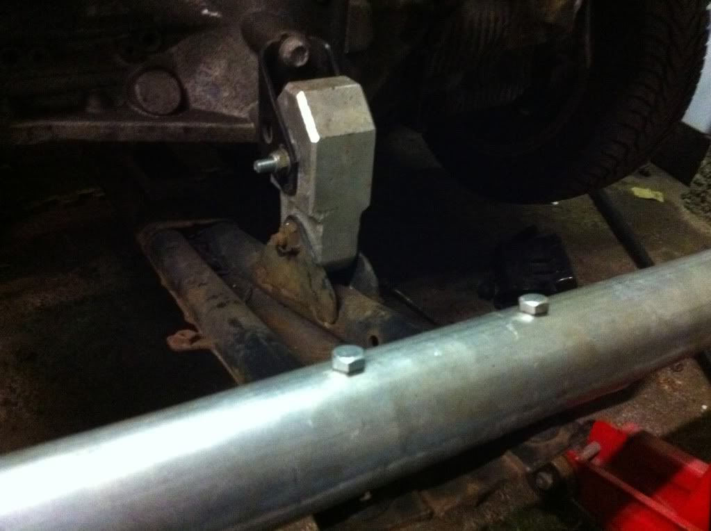

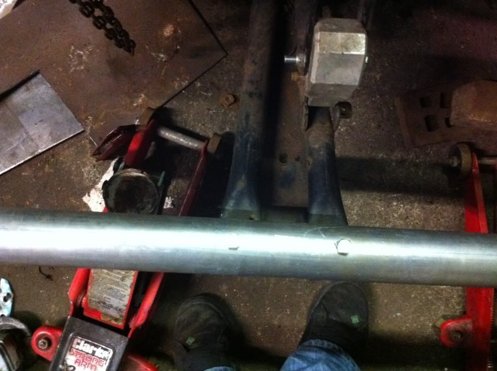

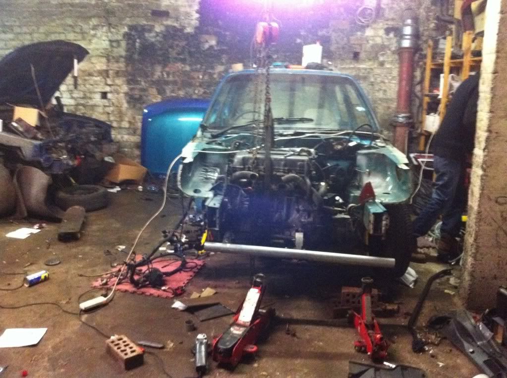

Next job was to start on the underbrace and crossmember. We have used an Almera 1.4 underbrace here with the SR20 mounts. The back 2 boltts line up pretty closely and only required the hole to be widened a small amount for the bolts to go in.
You can kinda see the cut in this picture ^^^
The original plan was to take the advice from Dave Bull and use the lower part of the almera crossmember and weld it onto the Micra to be able to use the front mounting holes for the engine. Unfortunatley, due to the excessive lifting on Ross's car during its many engine swaps, the crossmember has weakened, cracked and is a bit of a rusty mess.
It was then decided that if anything was to happen and the engine was to be taken out for whatever reason, it would require lifting the car off of the engine.
So to make it easier, a custom lower crossmember will be fabricated and welded onto the Micra chassis which we will then made unboltable for ease if the engine has to be taken out in the future and also it should hopefully be alot stronger than the 14 year old rusty almera one..
We have used 2 inch exhaust pole here. It had two holes drilled into where the underbrace will bolt into using nuts and bolts. It was then cut to size for the length of the Micra.
Pictures of crossmember progress so far...

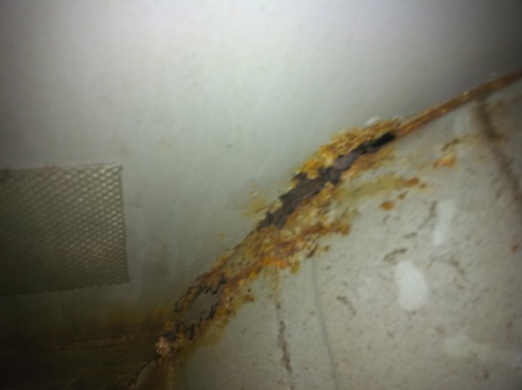

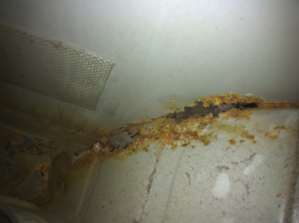

So tonight was mainly spent on De-rusting the Turtle.
Both Rear innner and outer arches need attention aswell as one of the chassis legs and under one of the wing mirrors.
So i set to work with the grinder and flap wheel on removing all the rust. I started on one of the rear arches which wasnt that bad. Just alot of surface rust. So with that grinded down I Put on some Hammerite rust remover gel.
And my paintbrush!

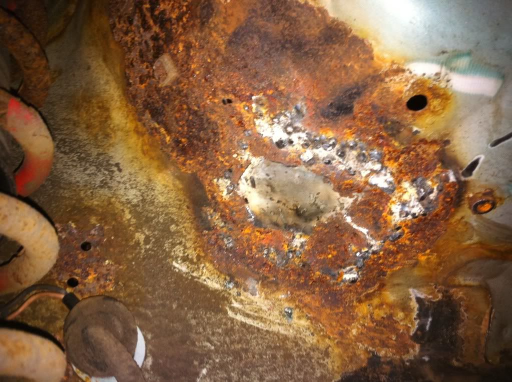

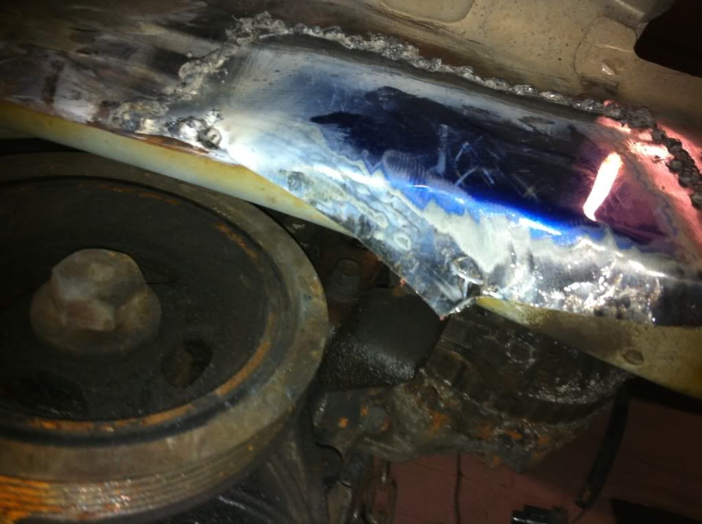

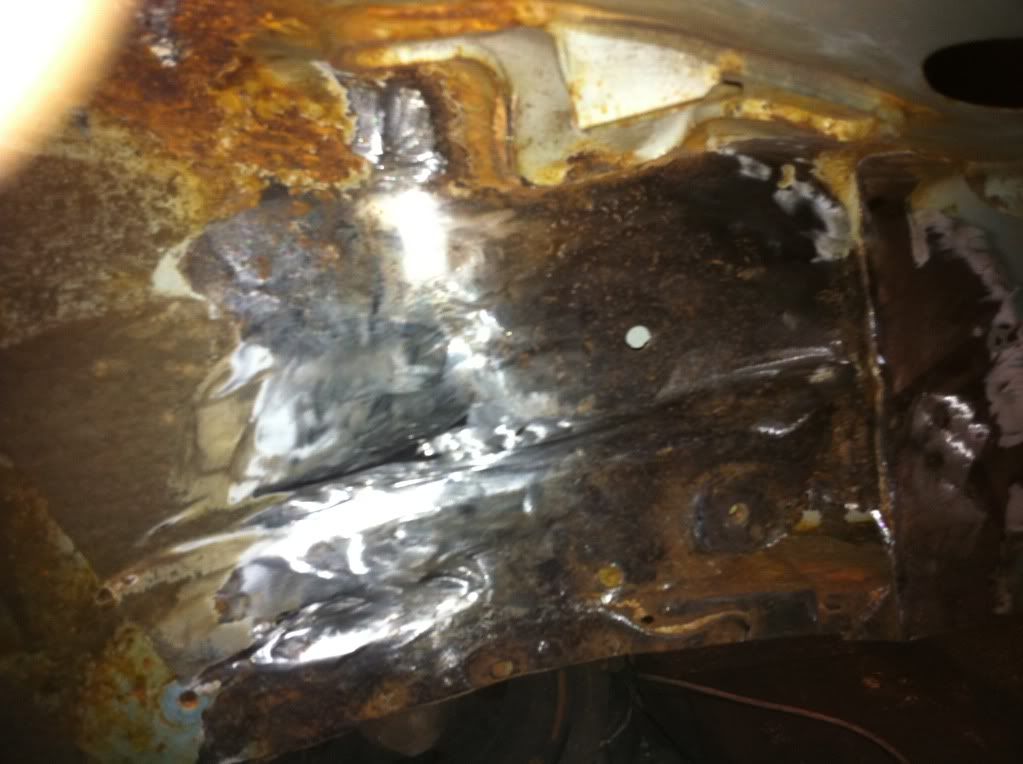

I then moved onto the front chassis leg which had a gaping hole. This needed welding... So grinder again to take back most of the rust for a plate to be welded over the whole.
Rusty hole with the metal resembling "biscuit". It was very thin.

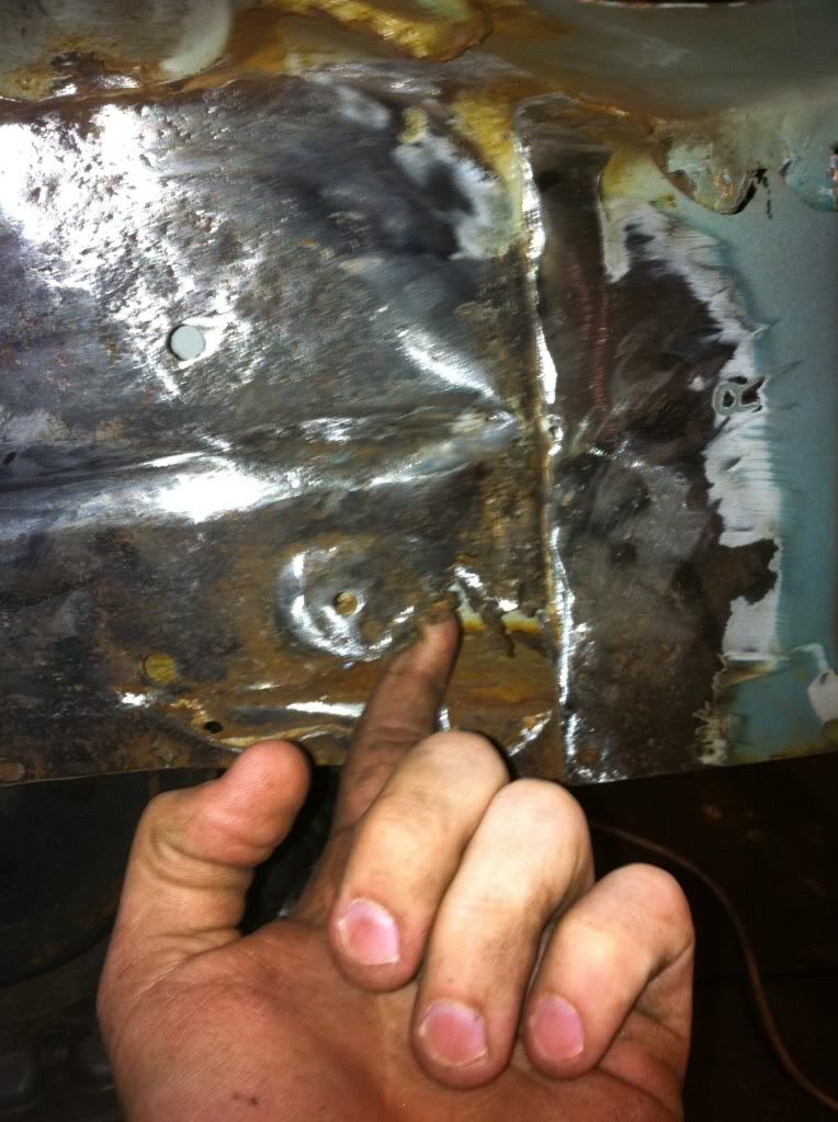

Once the Rust was grinded back, a template was made from the hole and a sheet of metal was cut from a spare wing we had lying around. Welder out and Ross welded the plate on. Yes the welder is sh*te
Theres still a bit left to do underneath, this will be done once the engine has been taken out again to have flywheel and clutch fitted.
Just needs to be brought round and welded up.
And some previous welding we done on the arch in the engine bay looking at it from inside the wheel arch. Not pretty but strong :

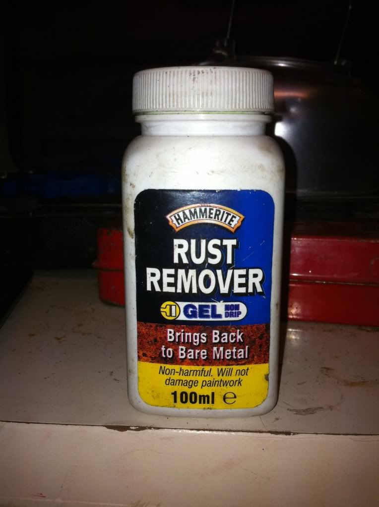

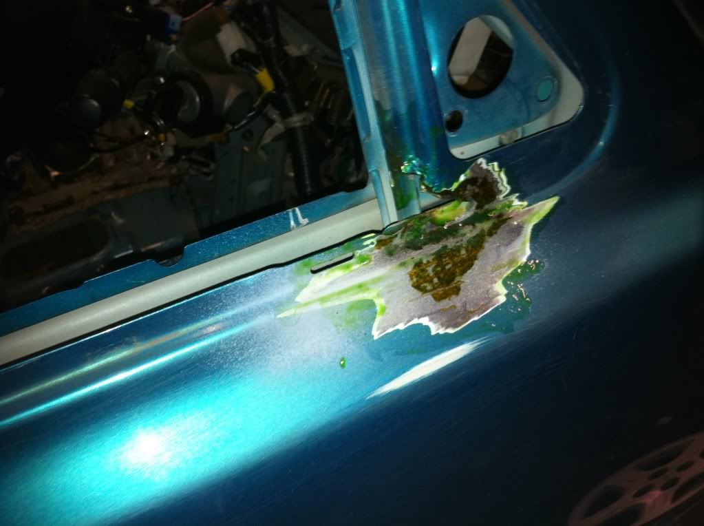

So with that done, more de-rusting on the door/wing mirror.
Rust grinded back, rust gel applied.

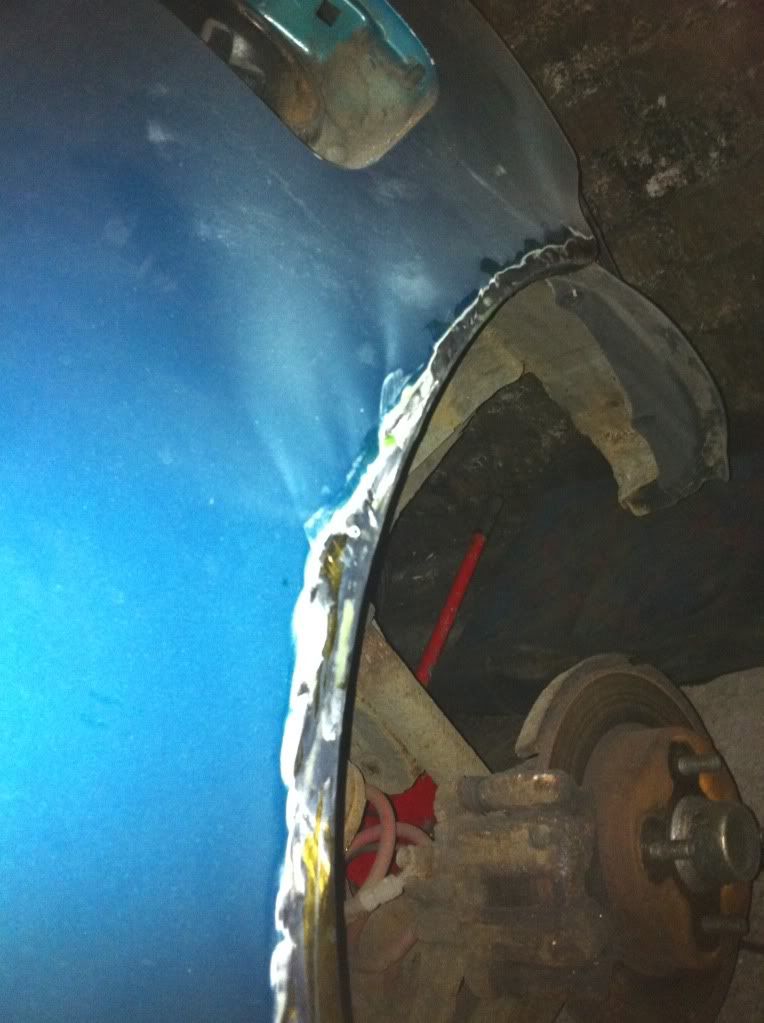

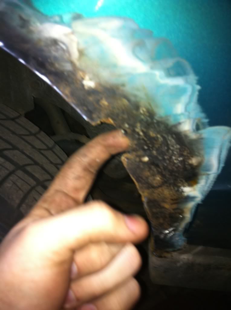

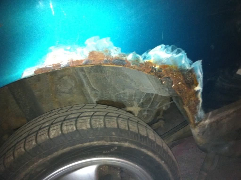

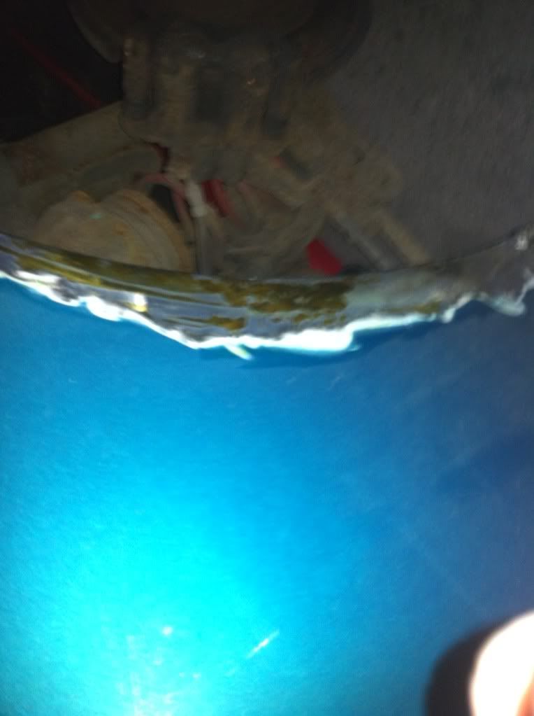

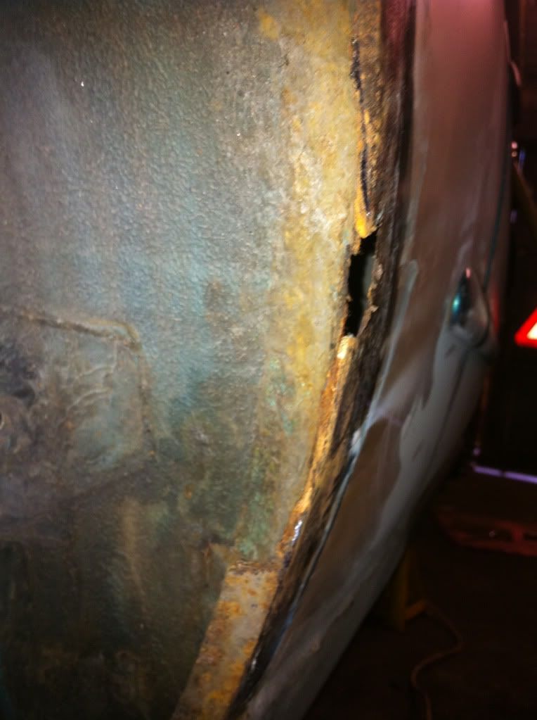

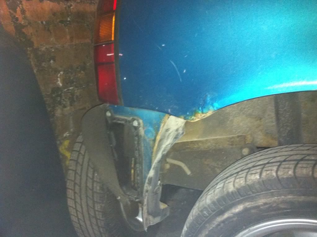

Then I moved onto the other rear arch... big mistake.

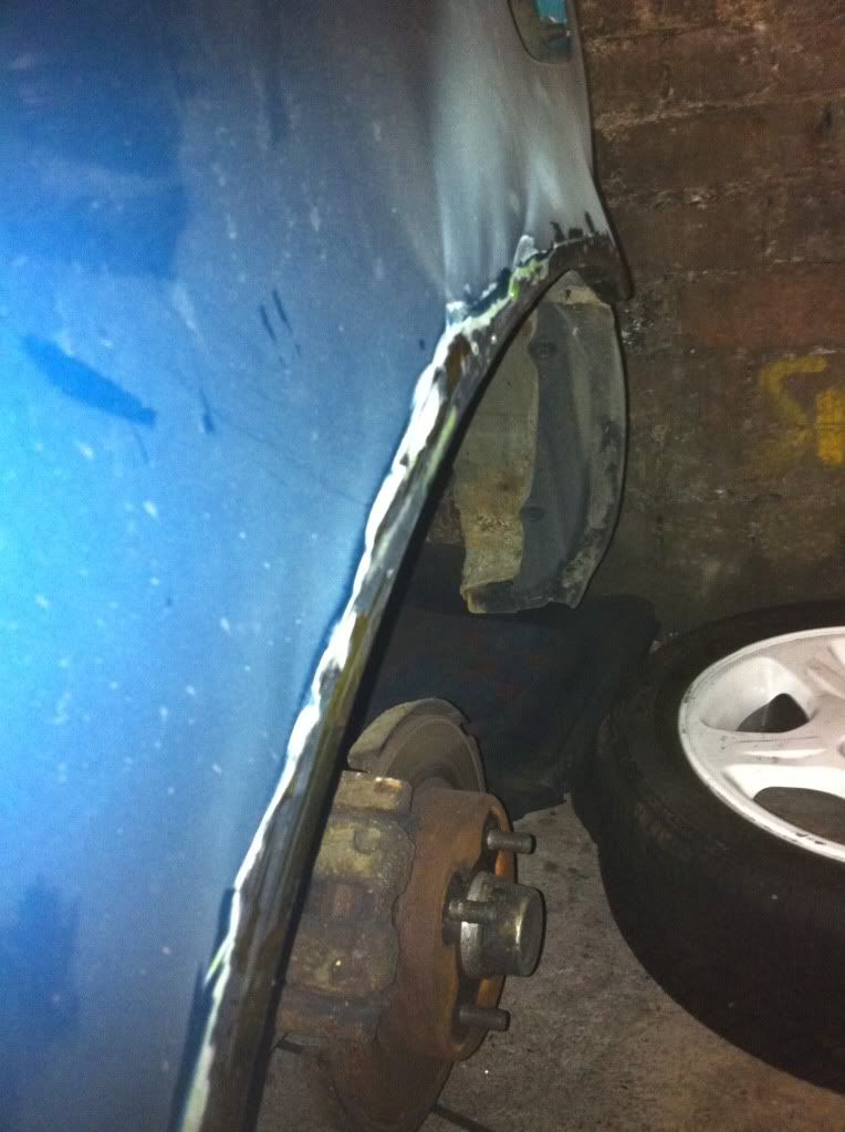

Surface rust grinded back along the arch and the arch lip. We knew that there would
be welding needed here but after a bit more inspection it was revealed that alot more was involved. First look showed a small gap into the inner arch. Ok cool a little bit of welding needed.
So after grinding back everything and poking the arch lip ( biscuit metal again) a larger hole was revealed (Thank you Rick...)
So now two plates will need to be welded in to try and regain as good a shape as possible to original.
More pics of rust and rust removal!
Thats all for the de-rusting just now. It feels good to kill the dreaded brown stuff.

Yeah its good stuff like. Just slap it on and leave for an hour or two then wipe off and sand back a bit more then fill.
