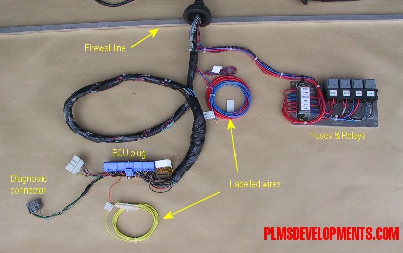

What does people mostly do with the wiringsloom when they swap an SR20 into micra's?
I'm dreaming of making a "standalone" wiring with parts of the original loom, like this one made to Datsun 510 SR20DET:
i think there is little difference between the micra and the GTiR loom, you may have to extend some wires and add bits but it shouldn't be too hard.
though i think a lot of people run an Omex system,
either way i want the little blue micra key!!!!!!!!
I am not sure if the GTI-R follows the same system, but it's possible to remove the ECU sections of the loom from the K11 and leave everything else in place. The only thing thrown in with the main ECU loom that runs to the engine bay is the intermittent wipers, but this is quite visible and simple to separate.
This is what we did when we fitted an Omex. We removed the main ECU harness sections from the main K11 loom in it's entirety and replaced it with an Omex loom. A very neat job but then again we used a fully assembled Omex racing loom, as it was the neatest way and practically plug and play with the supplied sensors. All it needed was earth, power, ignition, fuel pump relay and tacho to be wired in.
