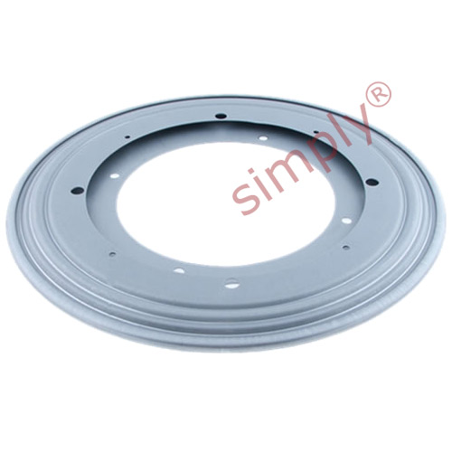

Aha whilst searching for roller thrust bearings i've just found out that what i actually needed to put under the wheel is called a "lazy susan turntable" usually used in cake making and in chinese restaurant centre turntables plus they're cheapas chips :)
A cheap option i used to get mine roughly right Paul, two biscuit tin lids ontop of each other with a squirt of oil in between them lol ;) good for bleeding the powersteering as well (when it was fitted)
Keep up the good work!
Indeed I've read of using grease between 2 sheets of metal/plastic, bin liners and I used to use 2 floor tiles with salt inbetween.
But i'm after a completely bindless pivot and a lazy susan seems to be the ideal cost effective solution without the £200 tag of a proper turntable

well tday the lazy susan bearings arrived, only ordered it yesterday :)
unexpectedly i got another package and its a k11 thrust bearing? I didn't order it. last time i ordered one seperately was for the 200mm helix clutch last year. maybe someone resent a completed order by mistake? better not have charged me, gotta check me card balance
in me bedroom I actually had this thick counter-top wood, perfect for supporting the wheels n keeping the lazy susan flat
since the surface is much smoother n harder than the current rough planks I used on the jig, may as we remake em
cut the big 3mm thick hardwood into 23x23cm tiles for levelling the platform height under each wheel
cut 23x23cm squares from the counter-top wood
just big enough to hold the lazy susan
marked n drilled the mounting holes
Mmm i luv precision
screw on the other plate through this inspection hole
2 lasy susan turntables
k place em under the wheels and although the bearing provides a low friction plate (any steering movement = tyre immediately follows without any stuttering) I noticed that unless the bearing axis was exactly in-line with the steering axis, the steering would just bind up or "spring" back from the tyre flex. grrr
tried shifting it in all sorts positions to find the steering axis where it won't try to slip or shift the body but was near impossible, like there's no single static steering axis. I did find through some testing that the castor trail is bout 15mm ahead of the hub axis
tried the greased plates, shopping bag and this tough rice bag below was the most slippery.
they're all fine for large fast steering movement but during slow movements, such as fine adjusting the trackrod ends, they tend to stutter n grab too much so the steering movement feels too elastic as the tyrewall flexes between each stutter
so the round "grooved" bearings provide smooth friction-less movement but the axis is too restrictive causing geometry binding.
while the slippery plate/bags provide unidirectional movement but to much friction.
what I need then is a unidirectional bearing plate (both rotates & slides laterally) like a bunch of ball bearings unrestrained between two flat plates. dunno if u can buy one so I'll make one instead, can't be that hard
