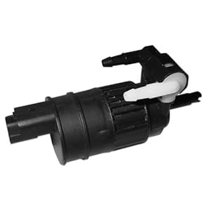

came here looking for some info on water coming in to passenger foot well and sat reading through the rebuild blog on page 1. Absolutely fascinated by all the work done and was glad to see pictures of what I hope is my problem - under the wiper scuttle panel. I had originally thought it was coming in via the heater blower resistor as I had it out to solder as the blower wasn't working. Haven't used it for a couple of weeks and it was like a swimming pool today. When I started her up I heard the water sloshing about (in the heater box?). Hope to have a go at it at the weekend! Thanks again for your step by step instructions which I'm sure will come in handy :)
thx for the compliment summerisle ;)
glad it was useful.
the motor and resistor card seem to be right in the firing line of any water ingress so prone to corrosion n failure.
important to check the motor is spinning freely and not too corroded first.
cos the water n dirt could eventually rust/seize up the motor bearings/bushes etc, which reduces cooling airflow through the card, increases loading on the resister card, both which rapidly heats it up till it burns out thus repair or place card.

my washer pump have always been getting weaker and the rear jet leaks when I use the front jets.
think the motor's getting submerged in liquid again and the 1way valve is broke so need to replace.
thing is that a pre-face k11 washer pump on ebay is least £17.50 (of unknown reliability) but a trip to halfords I see what seems to be a facelift plugged pump for just £17 new and I'd rather get a new one tbh
my question: is this a facelift connector?
if so, then I'll cut off a connector plug out of a facelift in the scrappy and solder it to my loom
I can get you a pic of the back of a facelift pump if you like Paul i've got one sat in the garage (dont run screen wash)
for verifying the connection that'd be gr8.
actually will u ever be using the washer system on that chassis/loom?
abit cheeky request :p but just wondering if you'd be willing to sell the pump and snip off the loom connector if it'll never be used.
Your welcome to the pump Paul I'd just like to keep the connector incase I went back to screen wash for rallying, I'm pritty sure I have a spare preface lift washer pump as well if that's any use to you
just thinking, selling the pump plus postage will prob cost as much as if I buy that amazon pump eh?
ah I think the original plan of buyin £10 amazon pump & snip a facelift plug from the scrappys prob my best bet.
better to snip a connector of a k11 thats gonna be crushed anyway than a k11 that's still in use
