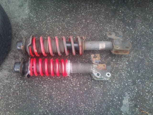

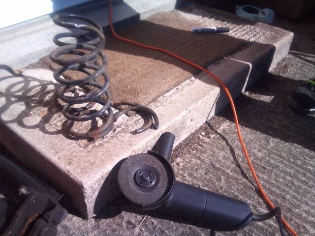

but look at the difference here, about 3 inches between the corsa coilovers and the bilstein shocks with -50 springs fitted
rears were fitted but we decided to to let off another half coil
like so

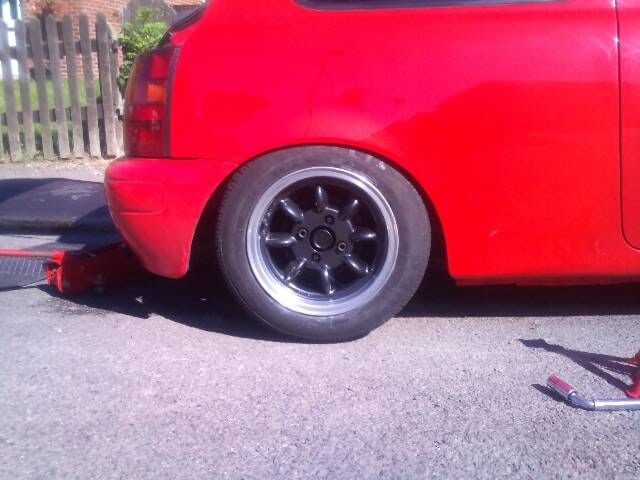

in the mean time let the car down and let it sit on the jack fully lowered and the jack still woulodnt come out lol
that is indeed sitting on the jack! lol
and the final result here, but obviously it hasnt been driven so the susp will settle a bit more

the rear have been fine no scraping with the weight of the tool box, jack and bits in the boot! and the panhard needs to be adjusted still so that should be fine! illl try getting my parents in the rear or some mates and see how it goes! if im dragging the bumper along the floor ill either add the coil back in with my other springs or add the other bump stop i have to force it to keep its butt in the air!

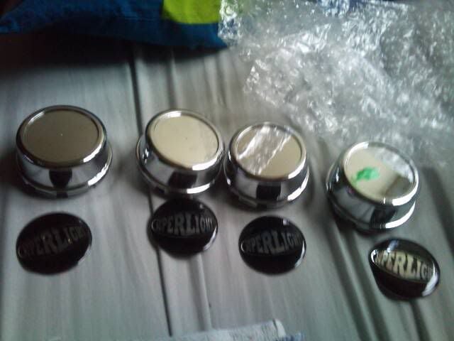

centre caps came today but very annoyingly there too damn small ffs

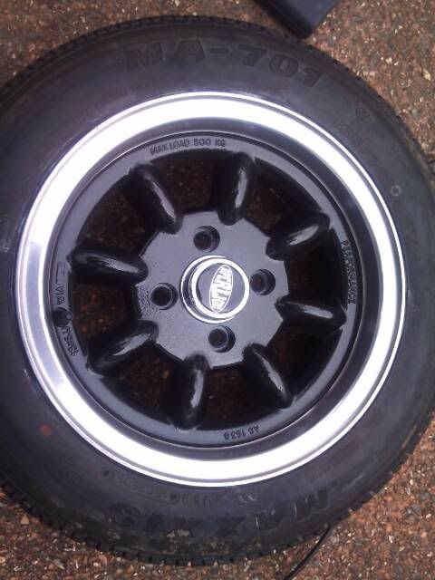

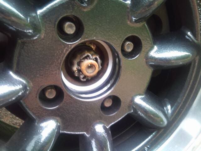

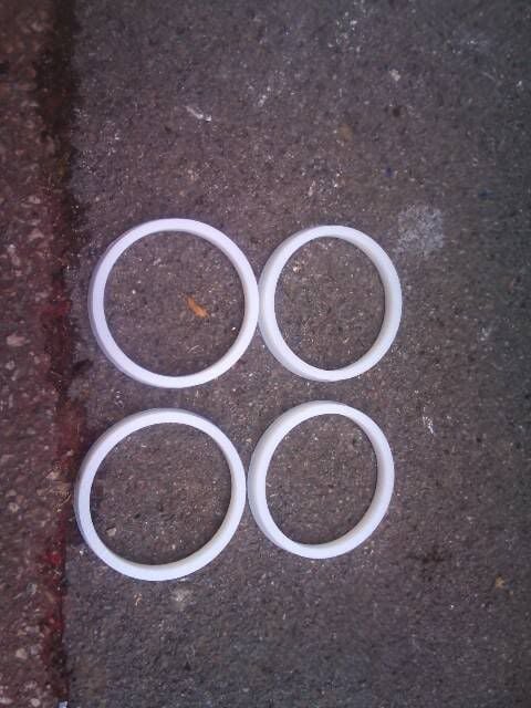

also because i now had spigot rings and centre caps i went about getting these on
the rings
test fitted
although 2 dont fit which is like wtf so maybe there machined badly but im going to file them down when i get to it!

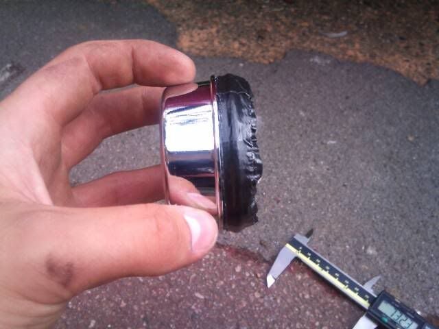

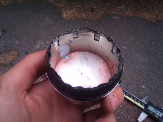

and the centre caps... were slightly too small but that was fixed with some duct tape
the caps!
duct tape
centre superlite badge fitted... looked too tacky all silver
test fitted

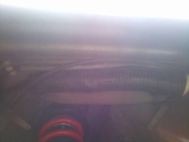

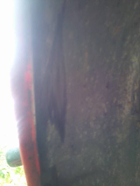

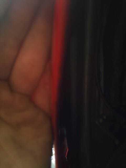

next was to sort out the front arches which rubber on cornering fast and hard haha which i solved with a rubber malet...
before how the wheel afected it
and then bashed back with a heat gun and rubber malet... dunno how good these pics show it

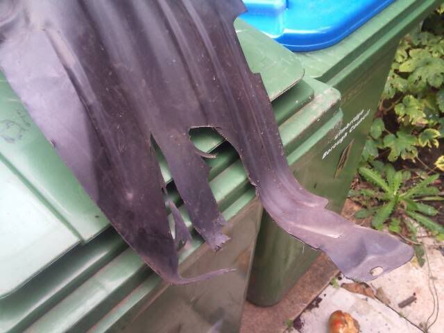

a long time ago when i gad my compos on and i had refitted my bumpers after colour coding i had left out a bolt and damaged the arch liner :glare: so i changed it today with one steve gave me!
the old one

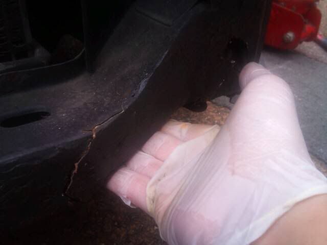

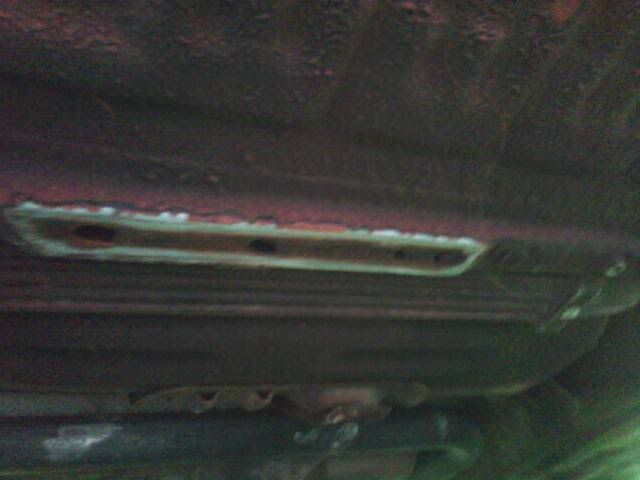

today i went to straighten out the front bumper to make it look more presentable... done this by jacking up the front bumper mount which worked! must hae been bent as there are signs of it from damaged paint on it from the bends!

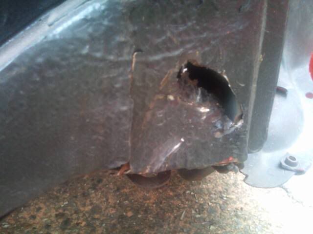

but from jacking it up my dodgy cosmetic repair on the x-member failed badly!
i got bored and jabbed it

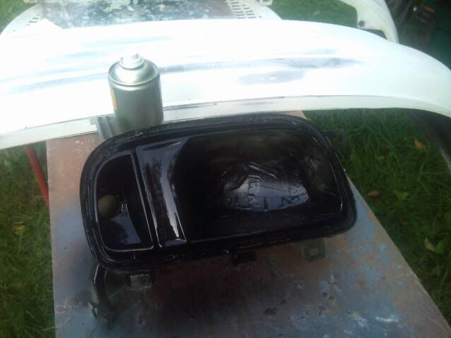

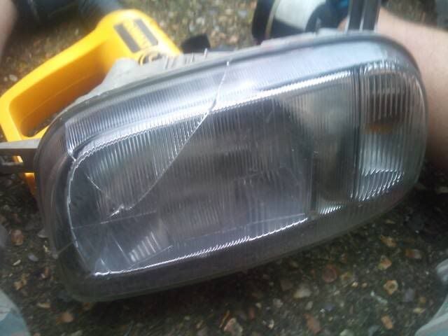

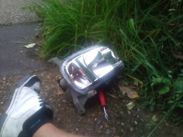

then while i was at it i thought id do my lights which went kinda wrong... basically i wanted to paint them black!
first one stripped well
second one i ####ed ffs i need to go scrappers and get one tomorrow
masked and painted
also removed most of the sealant and used black sikaflex instead and refitted it!
ill do the other tomorrow when i get a new one!

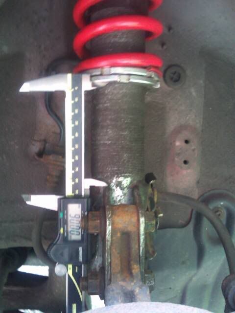

camber is done by slotting the strut on these corsa coilover shaun! and we just measured the distance from the edge of the strut to the hub in a certain point which was a hundred thou out which wasnt bad!

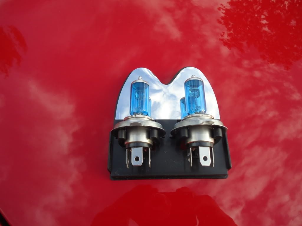

new exeon bulbs much better now can actually see!

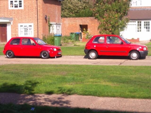

this appeared down my road today and i thought the original micra was haunting me! lol
but bit of a transformation eh!
Well the red and black goes really well (Y). A bit more colour coding would look good too (Y). Makes me miss my K11 now :down:

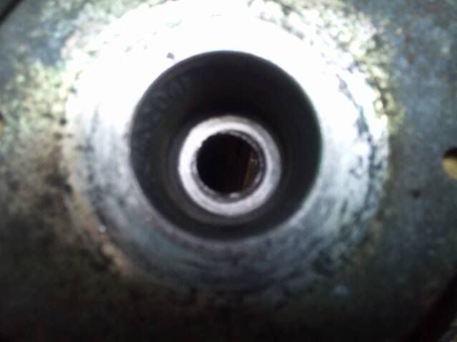

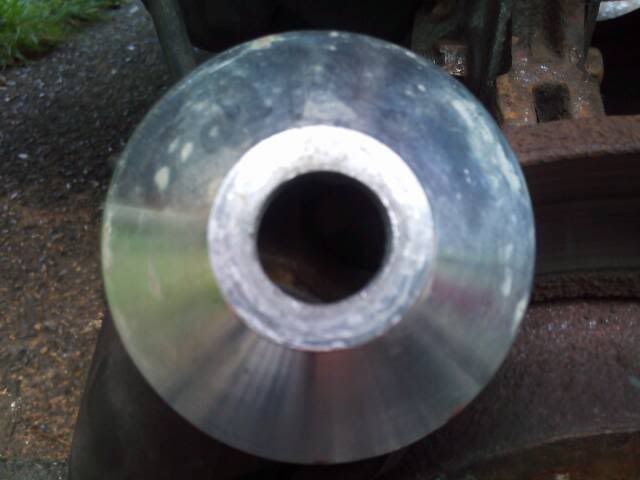

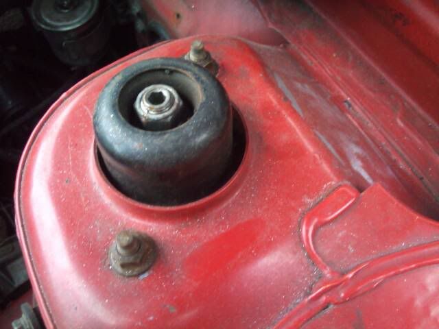

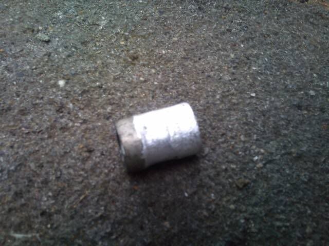

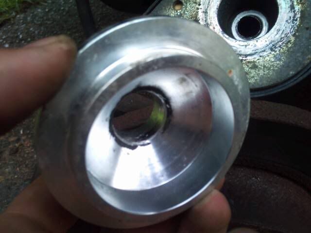

took a disturbing look under the bonnet today and found some metal filings on top of the suspension mountings
on the side it has been knocking!

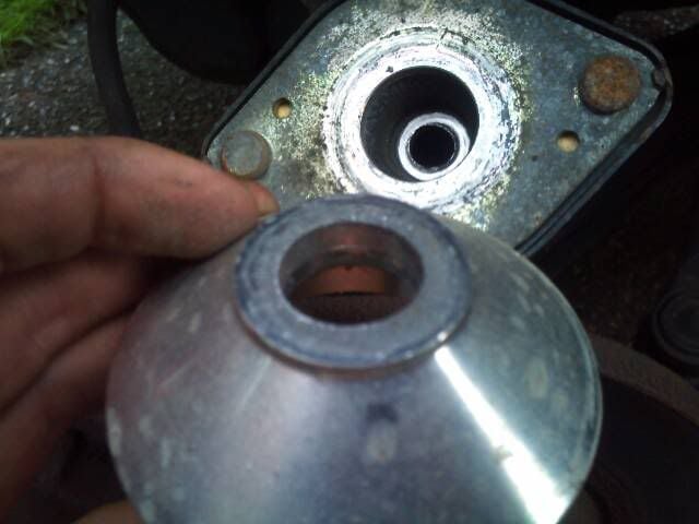

took the top mountings all apart! and the sleve which was put in there has been well worn away and very thin in places!
and has worn out some of the surronding parts
lots and lots of metal fillings on top of the mountings
deep gouges on top of the cup!
so when i reassembled i packed this
with duct tape and fitted it all back together with plenty of copper slick and hope it holds out till i find a better fix!
