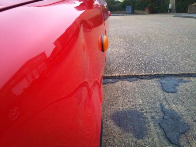

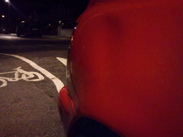

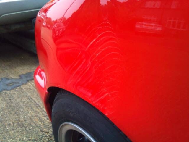

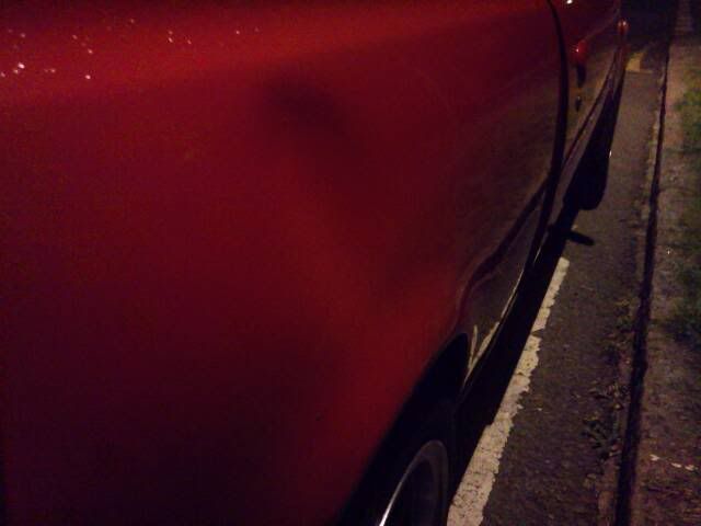

well no it was deffinately someone kicking it as untill it rained there was a nice boot print on the side of the car.... luckily it on the same panel as my mate damaged that time... but still what #### does that?
and its not a small dent either... luckily no paint damage so hopfully it can be pushed out

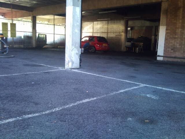

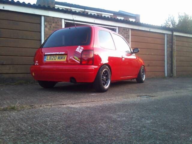

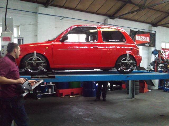

well heres the car on the ramp doing the tracking again! much better!
and the damage

dent is out simply used a suction cup..... and a push from behind with the fat end of a screw driver.... all thats left is a small shopping trolly sized accident
me 1 - 0 pikies
me 1 - 0 pikies

since i had the tracking done the steering wheel has been a little off centre... we both agreed it must have moved when they clamped it!
however today i noticed that over 45 or on power (accelerating) i have to correct it a little more as its pulling to the right ffs

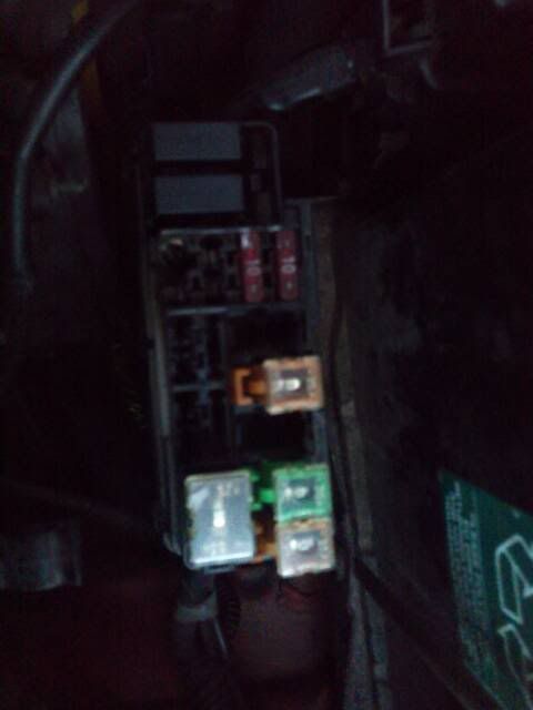

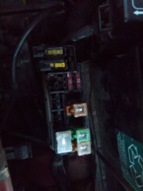

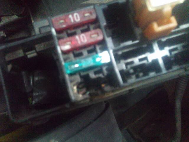

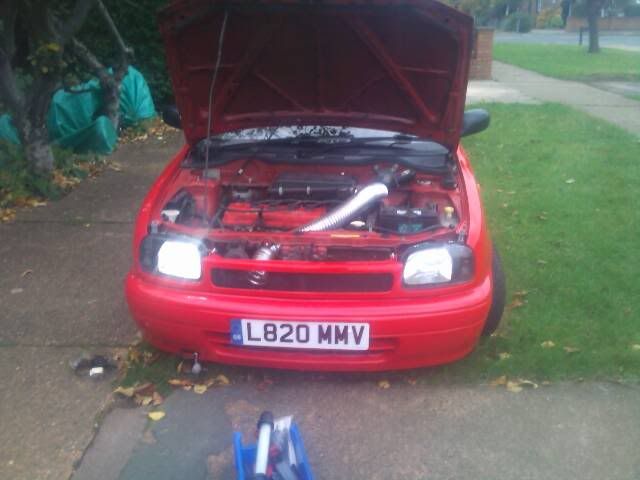

and then today i had to repair the head lights, some time ago my connectors on the rear of the lights had melted, and i replaced them :) however there was damage to the fusebox and wedged a new fuse in at the time, however over time this has failed miserably and been with only 1 headlight since about JAE, so today i went about the fix!
the problem
the cuase
2 fuse holders solderd together, the main is solderd together and then the other 2 are left for each feed for each light
well hidden inside the fusebox where the abs actuator would be if i had ABS
and bodged with 20a fuses as i had no 15's
hopefully it will last and not set my car on fire haha

mmm indeed im getting tracking redone for free tomorrow because when they last done it creased the hell out of the gaitors and thyve ripped themselves to shreds, so ive replaced them both now anyway!

other stuff going on... when i had the tracking done they screwed up the steering rack gaiters and it ripped them apart, so fitted new ones and had the track done for free!

i hate that, they do laser alignment to get your tyres pointing in the correct direction...... then leave you with your front camber .6deg out.
if it was a race car you could gain some serious lap timeage with a propper adjustement.
my mr2 was done at bush tyres and they just left it and said "yeah, that will do mate, its as close as we can get it"............ my reply was £30? well.... £20 will do mate, thats as close as i can get it" !:p

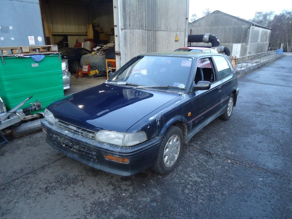

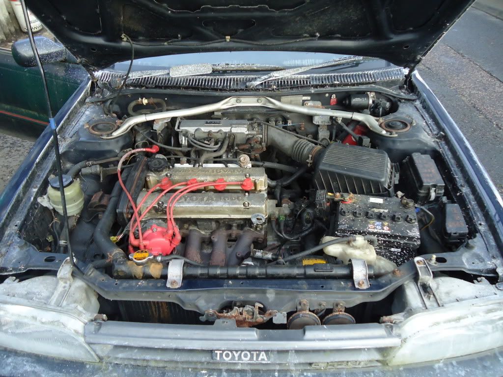

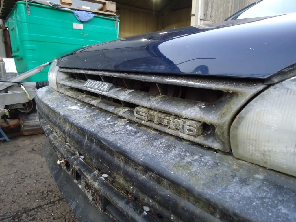

basically i bought this car a AE92 toyota corolla GT-i
this will be my main focus for the forseeable future
i drove it around the other day and loved it from when i sat eyes on the car, drives well just needs a gear box and clutch....

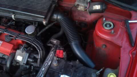

sorted the cooling by sorting a new air feed and replaced the metal plate at the front of the bay, enables the engine to heat up much quicker

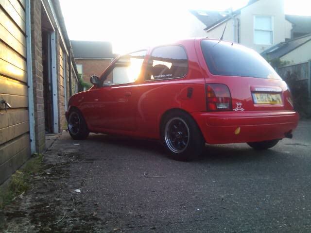

raised the rear for these wheels as they were catching
properly set the camber today and tightened the panhard rod!
