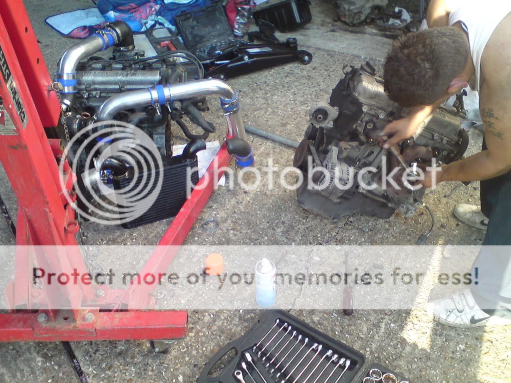

Started the day today by removing the turbo sump :)
Then off to meet the donor car ;)
Scopez and myself got stuck right in removing its heart and getting the low mileage beauty out!
Frigging auto boxes are actually the most annoying thing on a Micra so had a helping held ;)
Can you see it yet??
Yep pure pikey styley!!
Back home started swapping bits
And my new second hand helix :) :)
Everything swapped over from old block that needed to, gearbox on just using the crane to get her into position
Been a long long day, big thankyou to scopez , much appreciated bro

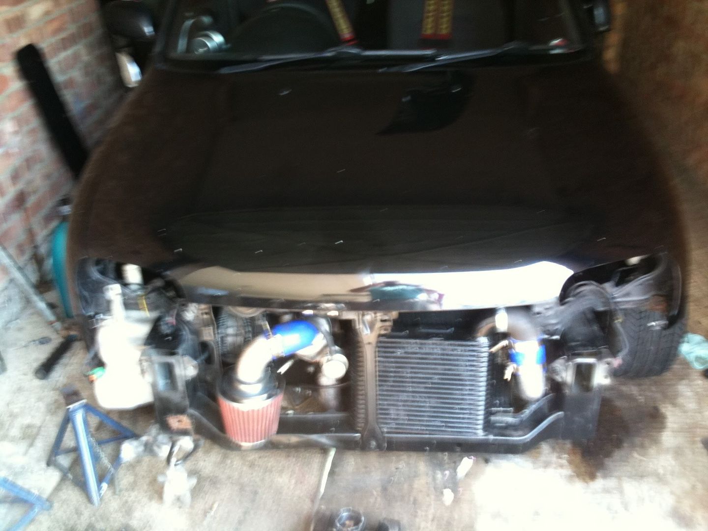

Few pics
And no smoke now :)
