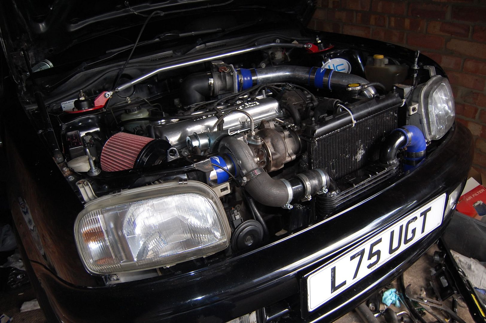

Why the battery relocating? or am i just being dumb :down:

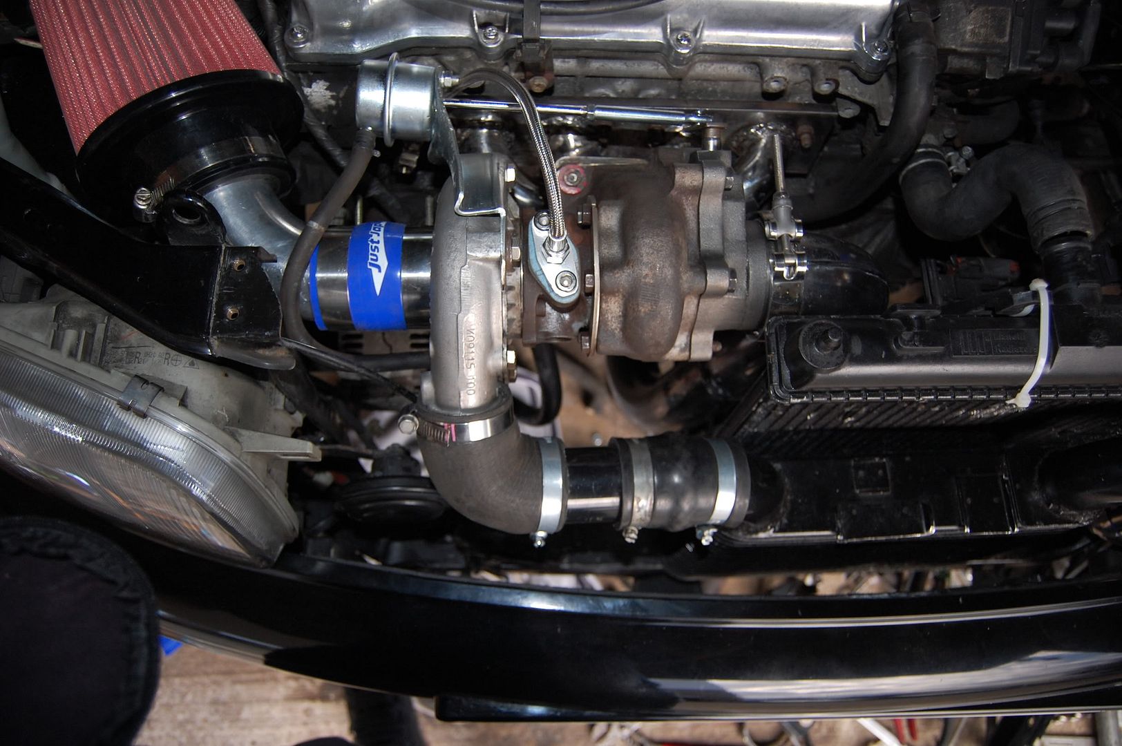

Congratulations sir! I hope it all went well. Really sorry I couldn't make it!that new mani looks really good! Really makes me wonna get my car back on the road.

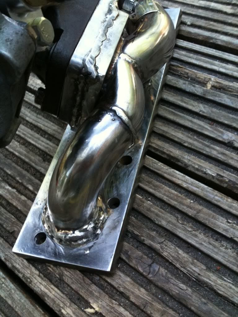

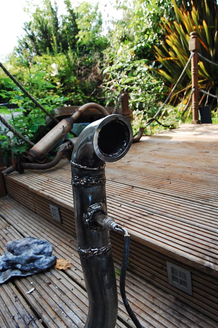

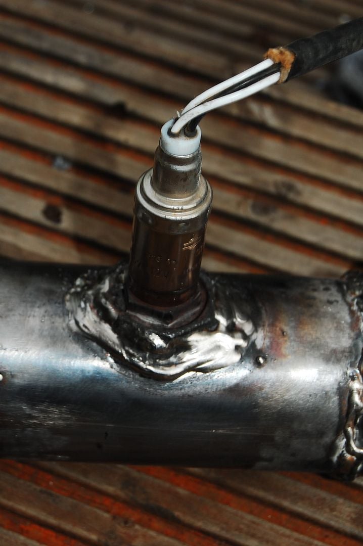

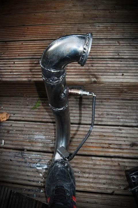

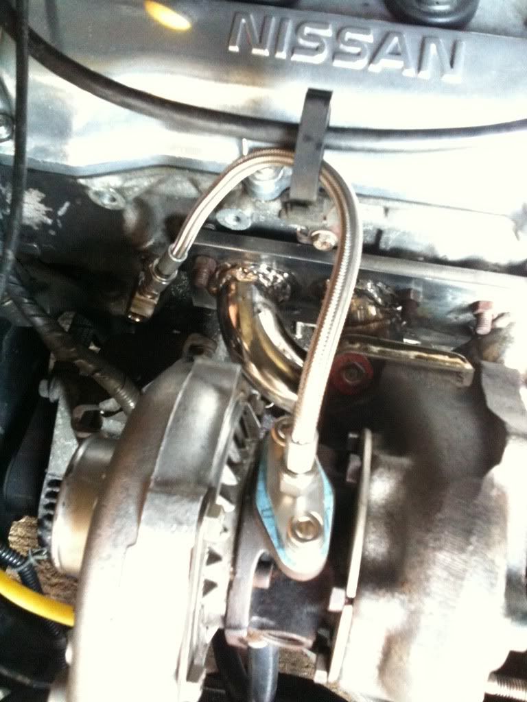

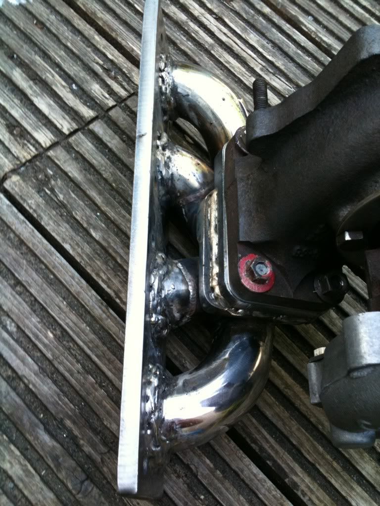

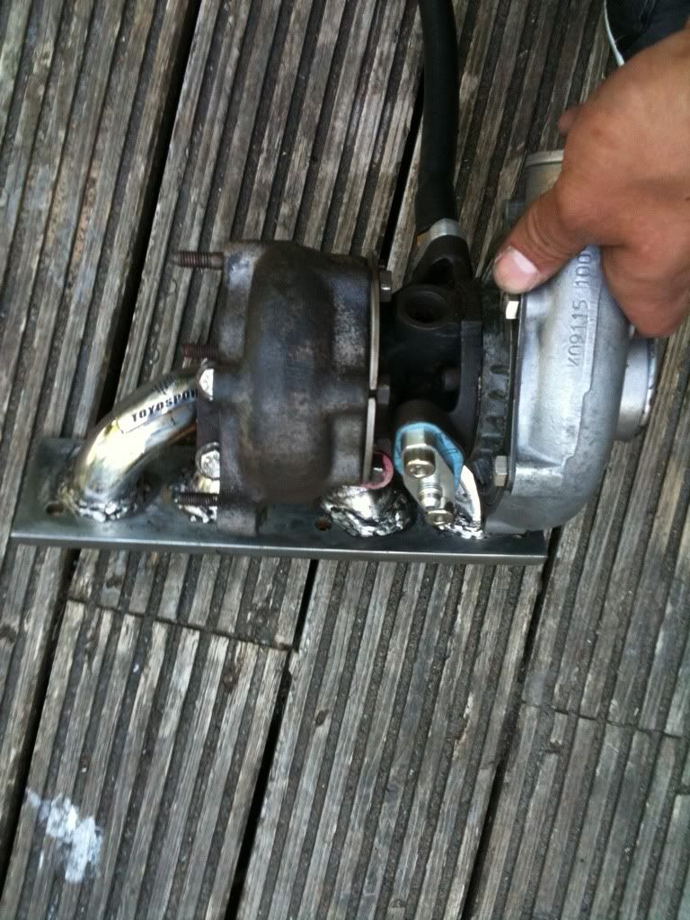

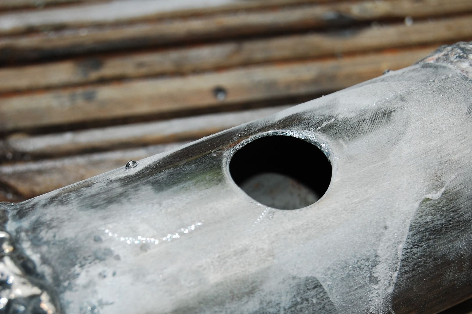

Looking great but you need to put a bit more heat in the welds, it's blobbing like that because it isn't melting right into the base material fully. Awesome build though (Y).
dunno about getting the hang of it, when joining two pipes i have to zig zag at around 25 amps to get some weld on there otherwise it turns into swiss cheese metal!!
after that another pass at 35-40 amps to fill in, and finally at around 60 amps (which is fun!!) which lays a load down but really penetrates and seals everything, getting there but its not pretty
still im a shoe string budget and cant pay anyone anything so have to do it myself, may get a mig for christmas although i like the simplicity of the mma inverter( as does frank!)

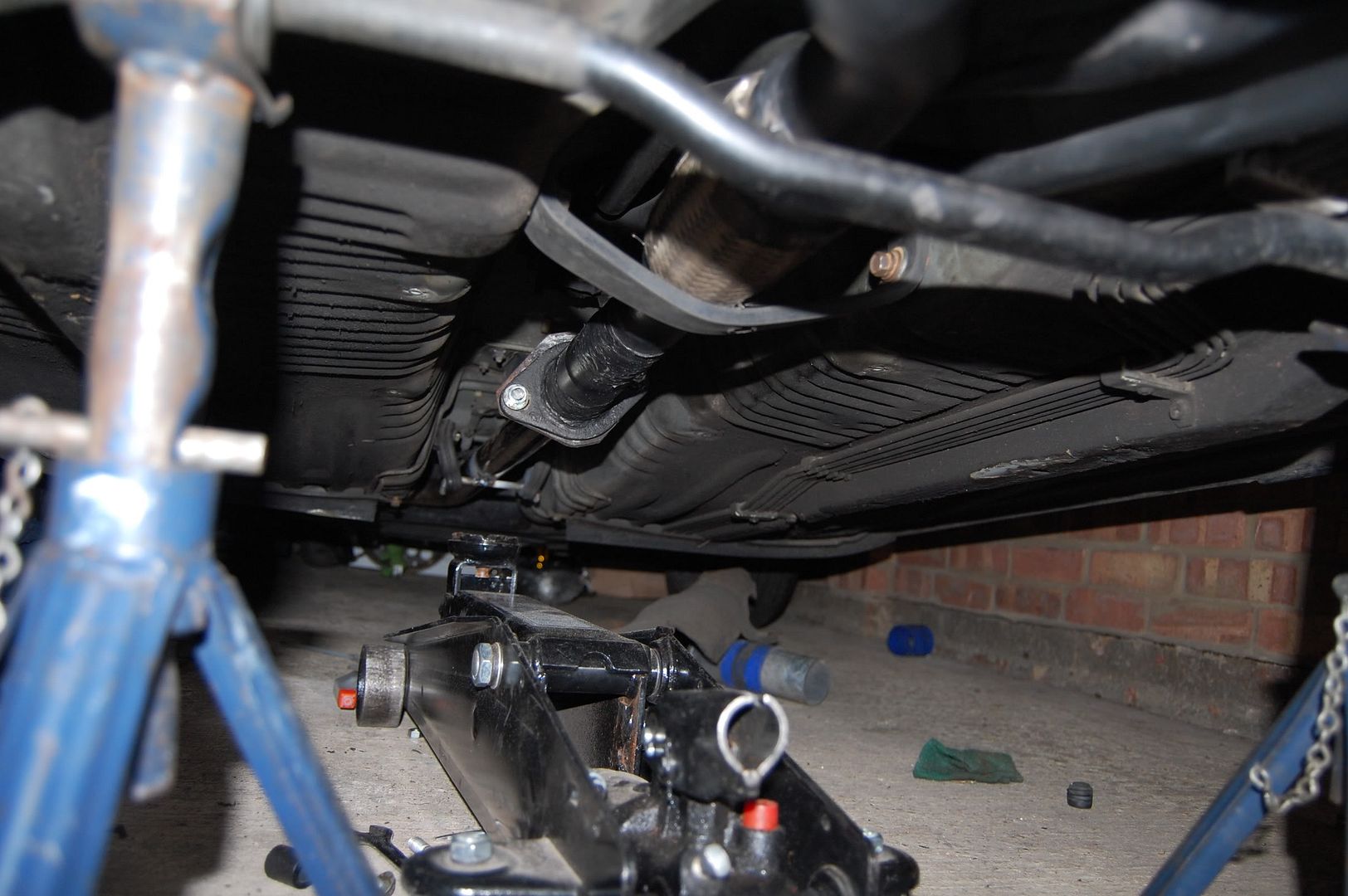

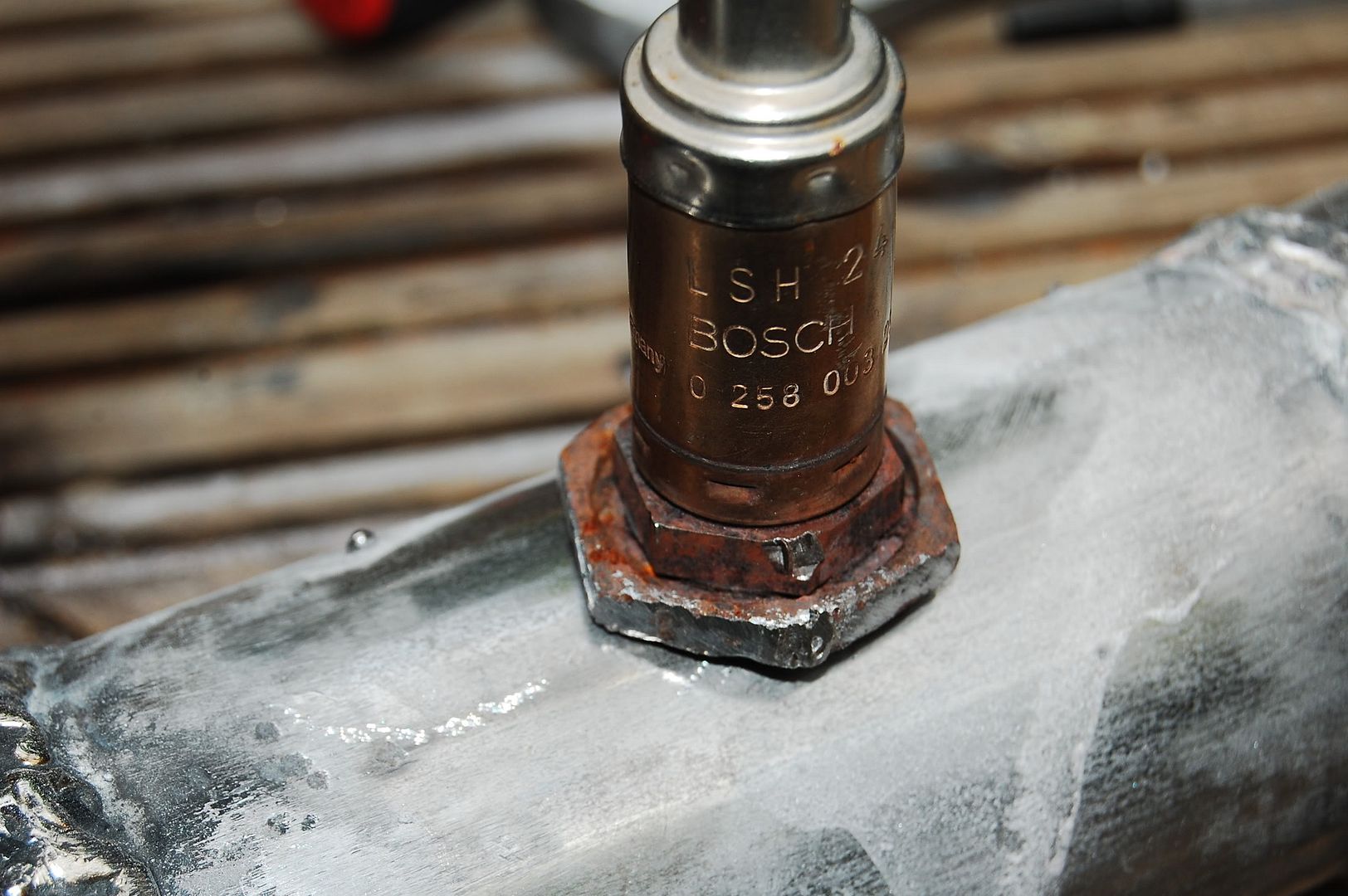

heres some pics of the budget spec downpipe and lamba fitted, please excuse the welds, there horrible but its super strong and most of all cheap as
60 amps buttery weld
more soon![]()
