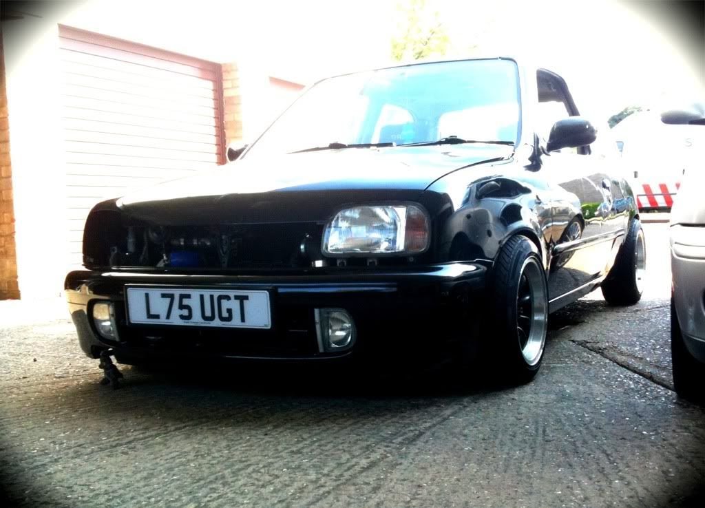

Martboy21s new Black Super s
Don't remember you saying that, Sod it it can stay as is, Tis quite loud though? Put loads of lube on my shaft ;) ha ha
I won't be driving anymore just for pecs of mind I wanted to see it boosting, gotta love 2nd gear though!
Thanks again for your help as always mo :)
yeah remember I said to you that on mine it did make a noise but only when clutch aint pressed and thought it might just be the bearing needing a little lube..if its as loud as you say then dont think its what I had..Ill have to have a listen when I pop down, but nothing to worry about mate, hows the clutch holding now compared to the stock?
Oh she's good man, no slippy sloppy slip yet :)
Well chuffed with it mate apart from my new noise ....
Yeah when you come over you can hear it mate
Just hope when boosts turned up and mapped it holds,

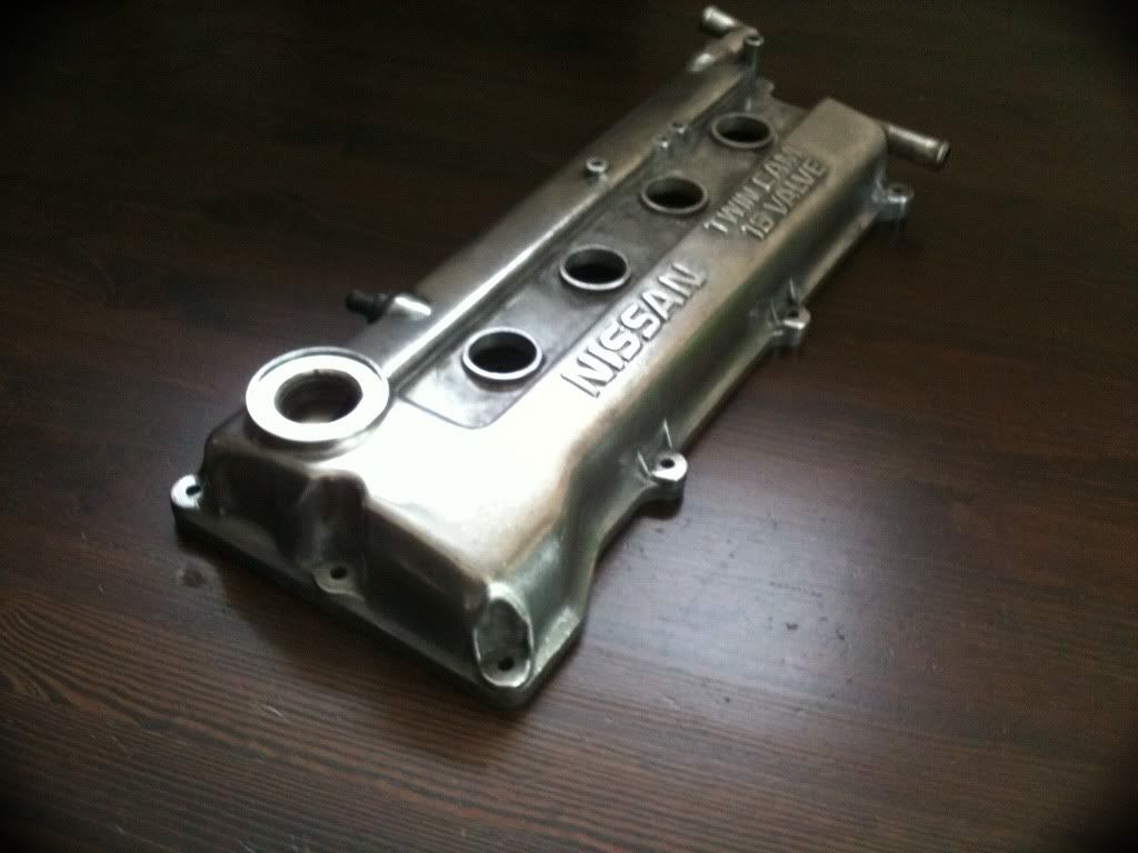

Been re durning bro in-laws SSR wheels for him so he's getting me uprated fuel pump to say thanks (I hope) :)

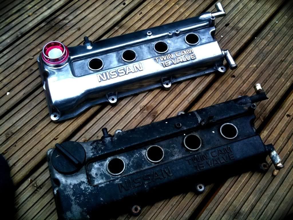

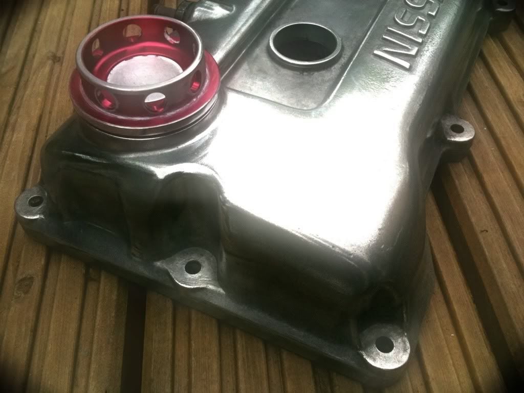

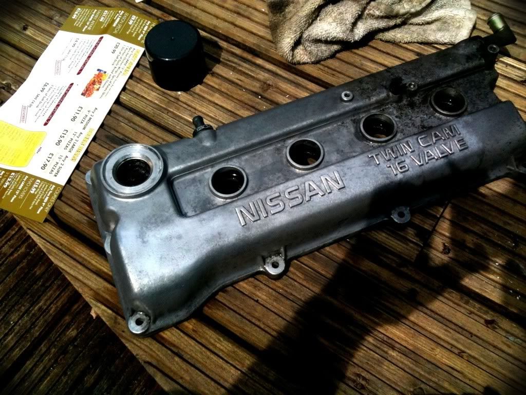

I've always wanted a polished rocker cover since I've ever owned a car
My local "machining shop" wanted £100 to return it in a mirror finish
Waaaay to much money I thought

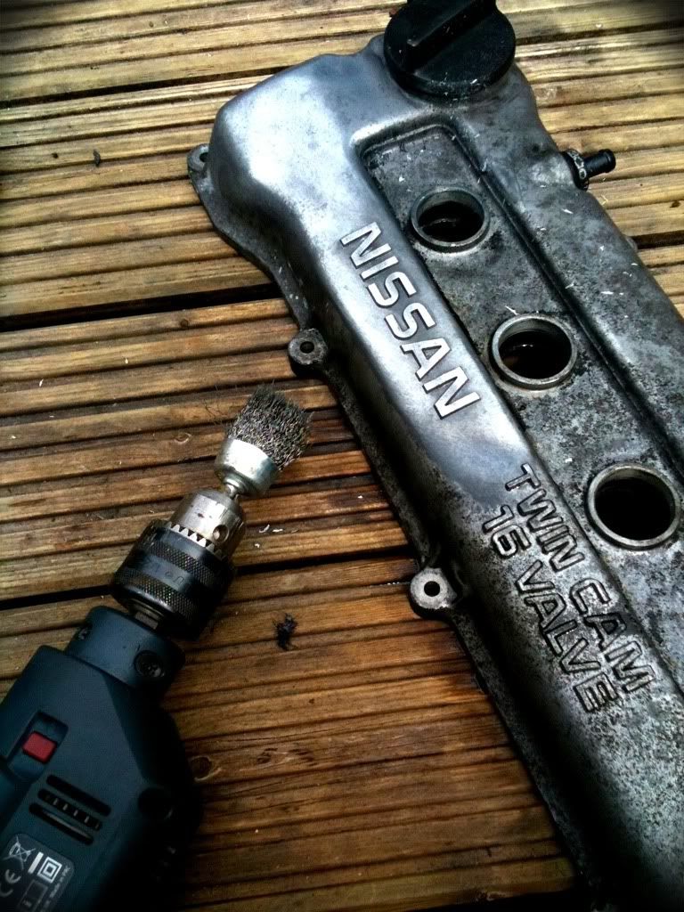

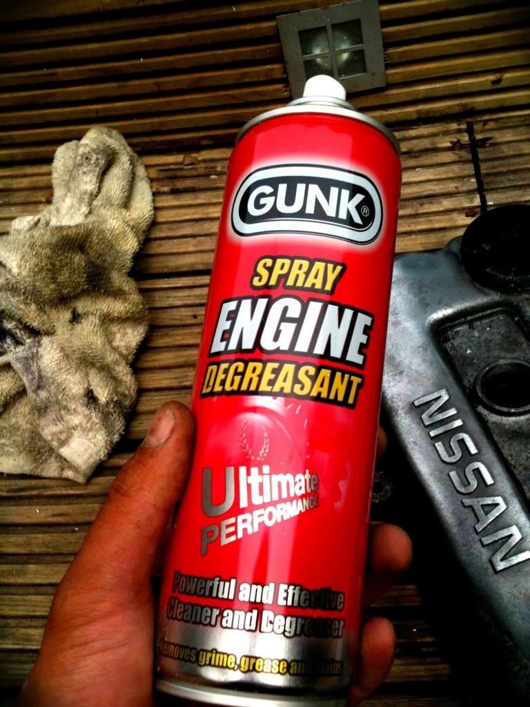

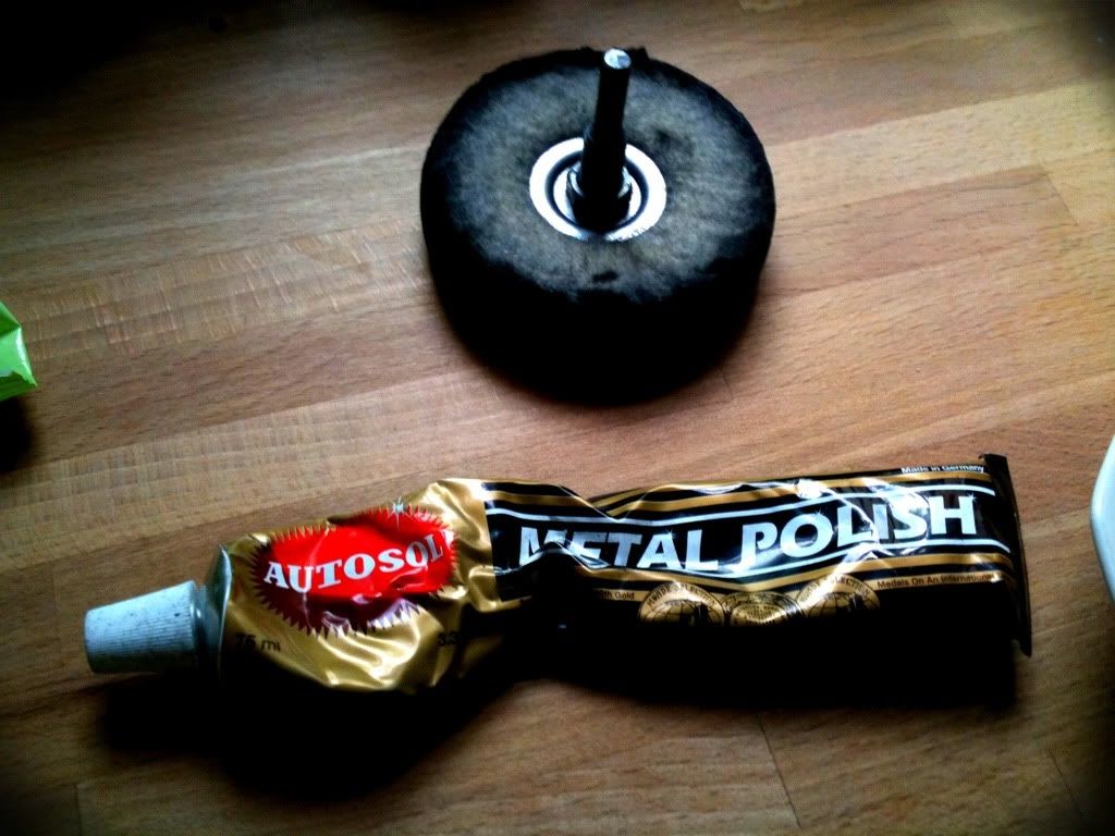

So with sone bits I had lying around I've done this today
Started with some gunk I had left over
And cleaned it with a wire brush on a drill
It came out pretty well from just that

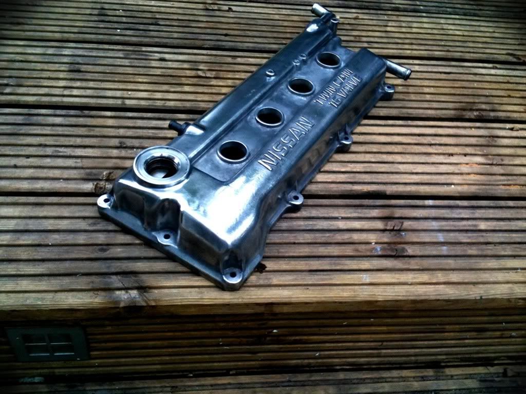

After that I used an old polishing wheel and autosol
Started to come out really well, onto the other end
Finished product (almost)
Looks pretty awesome!!
Old versus new :)
Will fit later with pics
Looks good.
I know i started doing mine ages ago, but quickly gave up. So i antiqued it instead...its got a kinda gun metal look to it now. Dizzy looks the best though as it still had the corrosion on it. A win for laziness, even if i do say so myself lol.
Be sure to put some polish on it when you've fitted it, should help cut down on the corrosion / oil staining / various crap that reaches the engine from the roads, stealing the shine.
Looks good.
I cheated as I used the drill, dont think it would have worked by hand aswell, I finish off between the letters later with a tiny dremel polishing wheel
I think you just got to go for it, Tis bloody boring though!
On too the block next lol
What sort of wax Shaun?

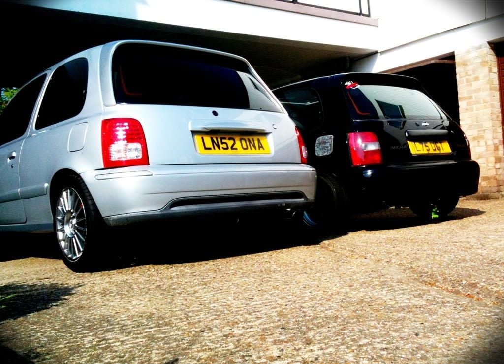

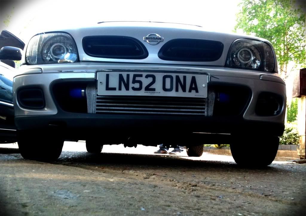

That looks mint kris :) when you can get a further away front shot, I find it funny how same car, same engine etc but different paths take you to complete different setups and looks!!
Would be cool to have all boosted micras in one place for a photo shoot :)
Oddly enough the cam cover should look better, if i seriously corroded it then reapplied the polish.
I've been meaning to take some pics of the car, theres a few floating about from local meets and on random peoples mobile phones haha...but everything i've taken is just a quick pic.
Funny you should mention having all the boosted micras in one place, i was thinking about that the other day...as i'd been looking over the chatter on MSC meets. Wouldnt mind having a spy of the different setups.
Cool definitely be up for a boost meet, somewhere where we can actually do something so maybe pod? Long way of for me though as I need mapping, mot, tax and insurance

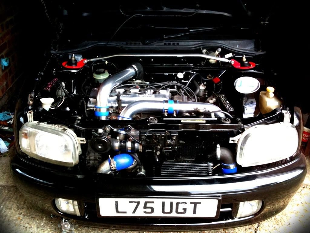

Here's the pics
Looks pretty neat :)
That looks really shiny haha. The black will be helping enhance it aswell. (Y)
