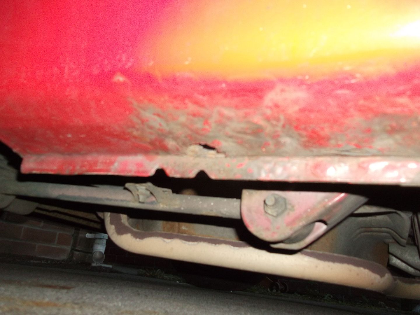

The MOT went as thought, a refusal for issue of an MOT certificate was issued.
Front Brake pads low - Replacements bought (Disks were advisoried too so they are getting replaced as well)
OS Number plate light - Replacement bought before the MOT
Exhaust Substantially louder than original - No surprise there then - stocker to go on before re-test.
Corrosion within the prescribed area OS outer sill - Looked something like this:
With a little tickle with the flap wheel,[
[/SIZE]
And then some attention from the slitting disk,
Hmmm, seems some more is required,
Then I took the children home for tea. I went back to my folks and got the inner repair panel cut and shaped, but ran out of light before I could get it welded.
This is the first time I've done anything like this so am pretty much making it up as I go along - wish me luck and any comments on my technique gratefully recieved!
If you radius your corners its a lot easier to weld than a square corner.
Also, if you can get hold of a joggler you can do a flush overlap repair :)
nice job mark :cool: you can tackweld the lower flange eh (preferably with the outer skin removed first) but all the other joints have to be seam welded eh :)
