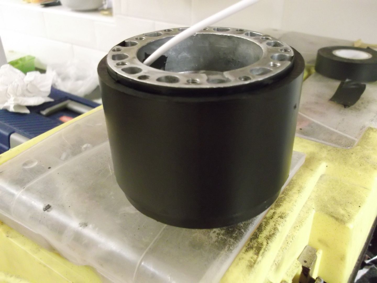

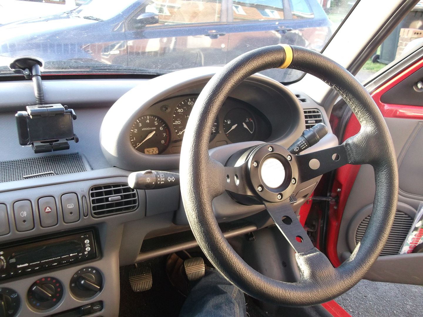

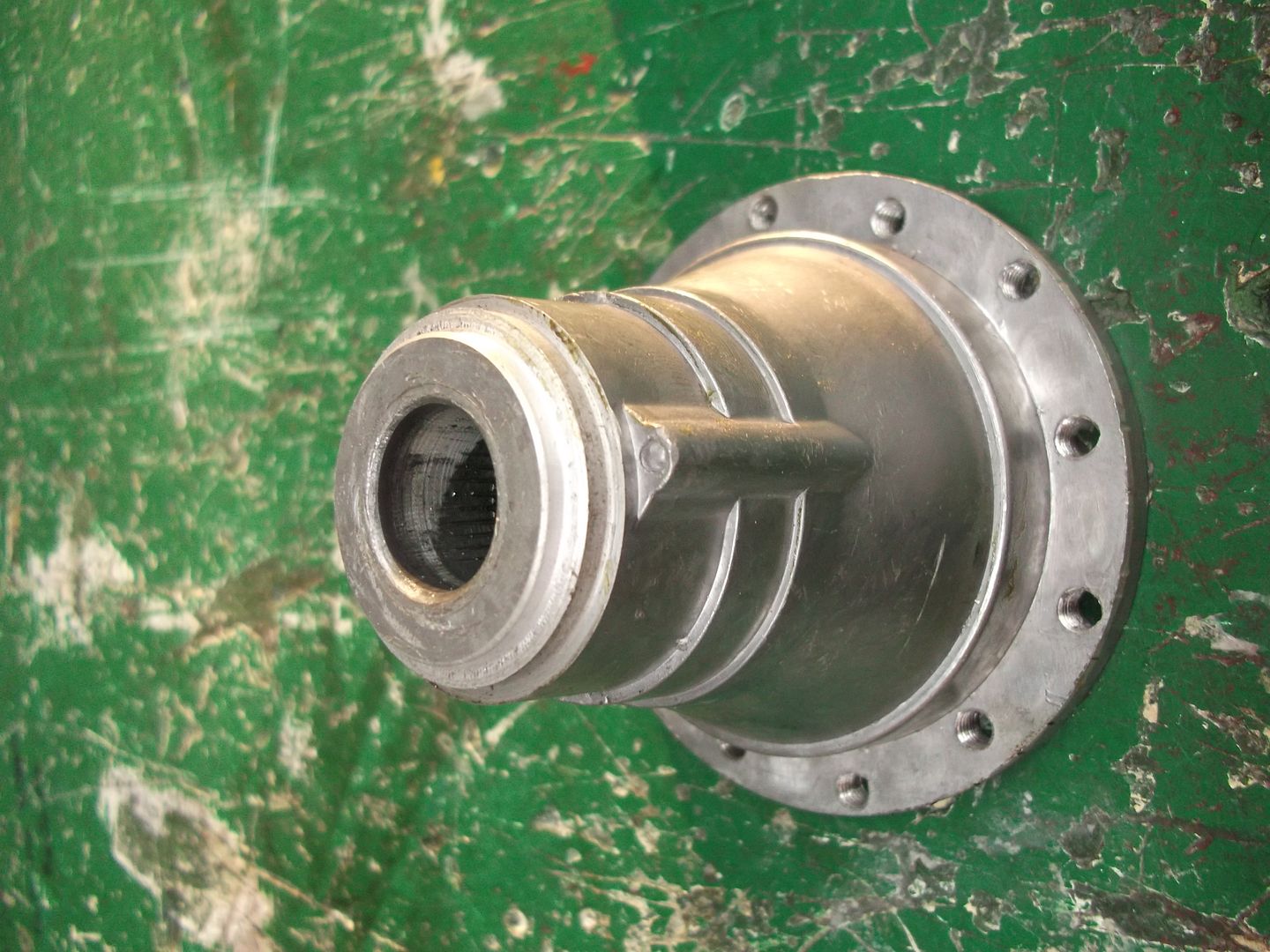

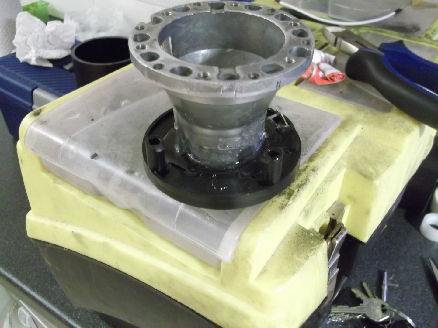

I've been getting an ebay cheepy deep dish steering wheel on over the last few days. One problem I had was that the horn ring on the eaqually cheepy boss was in the wrong place to cancel the indicators. I came up with a plan to use an OEM ring from a stock micra steering wheel.
First I had to turn a spigot on th end of the boss - this fitted into the moulding of the horn ring.
The interference fit was pretty good, but I re-enforced it with araldite.
Then tidied up the outside with some plastic pipe covered in matt black vinyl.
I've also fitted a tow strap.
There will be some more yellow at some point.
The wheel has still got it's sticky pad on the horn push. It's a bit too large a diameter for the fruit machine button I thought I could stick on there, so I'll have to think of something else.

I've never tried to bend my biatch, she'd clobber me back. The wheel does have some flex though. Hopefully if I crash it'll bend out of the way rather than knocking my teeth out. The boss will do that job.
Lol fair enough! tbh tho mate.. it does look smart, for that money i might try bend my mrs aswell! ;)

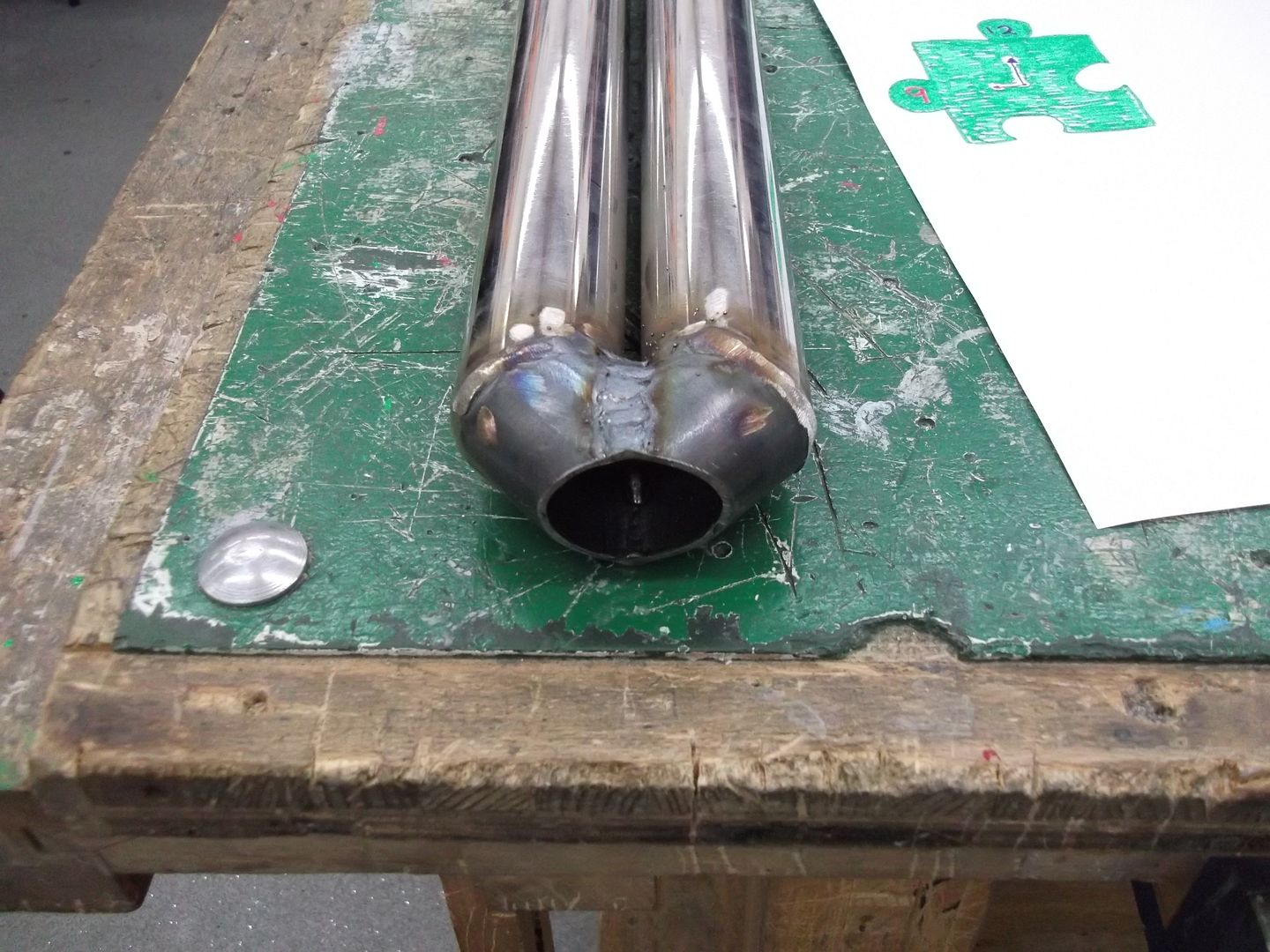

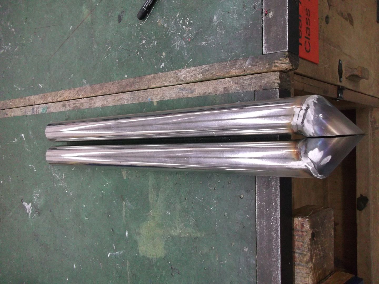

I mentioned that I had some pics of how the pipe came together, well i finally got my camera out and uploaded them.

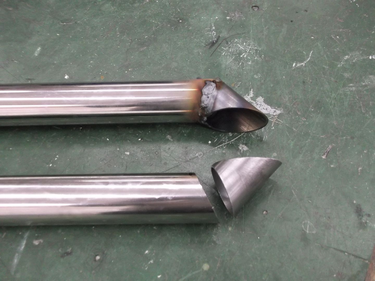

First off the stainless pipe ends were cut at 67.5ish degrees, and two short sections of mild were cut to 67.5 one end and 45 degrees the other. This meant that they could come together in the middle.

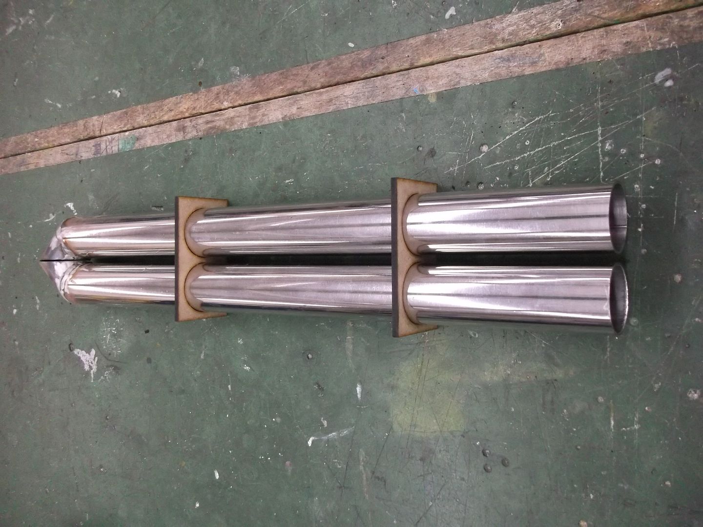

After the angled joiners were welded onto the lengths of stainless pipe I laser cut a couple of jig pieces out of 4mm MDF to hold the pipes parallel while the end pieces were welded. These were joined on the top and bottom - but all the way down the v of the join couldn't be welded at that point because the nozzle of the gun wouldn't fit.
Once the splitter section was welded the end was cut off to leave a circular-ish opening for the inlet pipe. This opening was also used to gain access to the inner part of the v so that the join could be fully closed.
After a quick trial fit to check the angles the over axle pipe was welded on. This had been extended because with the original back box the inlet is near the top, and outlet near the bottom, the extension meant that the pipes would be positioned in about the same place as the stock tail pipe. A lot of this was very lucky guess work because I just didn't have time to keep going out and test fit.
This is just before I welded up the remaining join on the extension piece. I then welded on the original back box rearmost hanger bracket - but upside down so that the V shape dropped the pipes down slightly. I didn't get a pic of this because I was rushing to get the exhaust back on the car and it was about 15mins to the start of Y10 parents evening!
