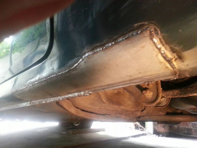

I've been told elsewhere Frank that even the lower flange would need to be seam welded, even though it was spot welded in the factory [/confused]

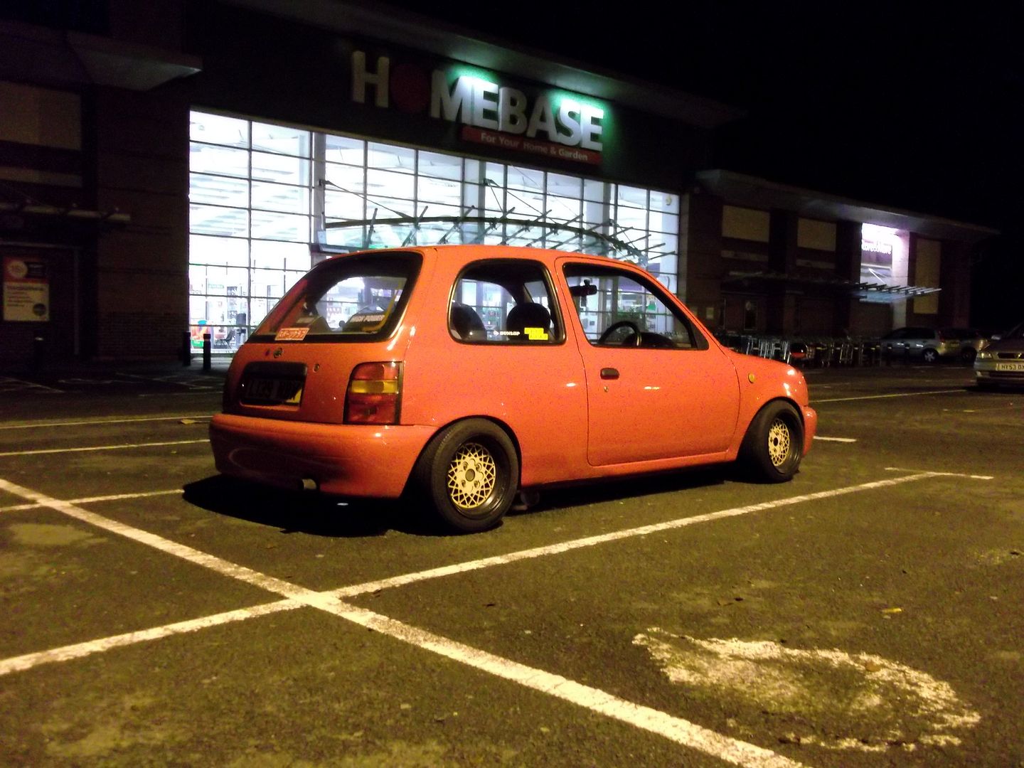

Have another picture of my car (not looking that much different from all the others - and not even showing the repair) in celebration.

I've been having a bit of an experiment with some wheel centres this week. They are 3mm think high impact polystyrene sheet, laser cut in a lattice pattern. This was then stood inside a wheel off the car, with a weight in the middle, and then heated with a hot air gun to soften the plastic and achieve the dish.
It needs some perfecting, particuarly around the valve hole, but I think it might be do able to achieve a bit of a change of look without having to buy new wheels. It obviously doesn't stand up to close scrutiny, buy I think looks alright from standing a little way from the car.
More experiments:...
BBS E30ish. MDF this time for a cleaner cut. They need a good thick coat of gold paint. This centre sits on the next shoulder down on the wheel, so i think they are a bit less useable with the trim rings. With a fivers worth of socket head bolts for round the outside, and a second set of wheel nuts to hold them on I think they'll look ok.
