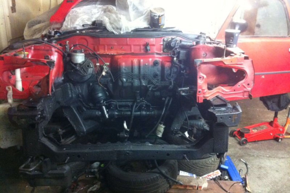

Progress will be made this wednesday and thursday evenings as ill be working on the car getting engine in position and redoing all the engine mounts. pics to come
We cut a piece of steel like a box shape which can be folded to make a box lid. Then we recessed the lid in and welded all around it. We have doubled the strength this way. We only cut a layer out and replaced it with thicker steel and stronger
We cut the chassis due to pulley keeps hitting the side. This has happened on two of my micras now so we have cut it out.

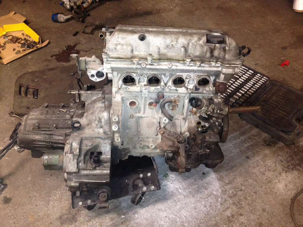

Slowly getting there. Working on it once a week
Engine ready for painting
Engine bay painted
Engine going green
