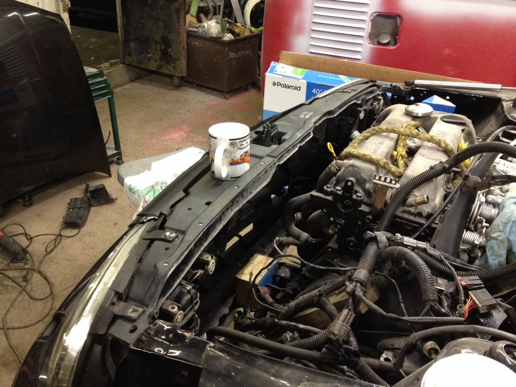

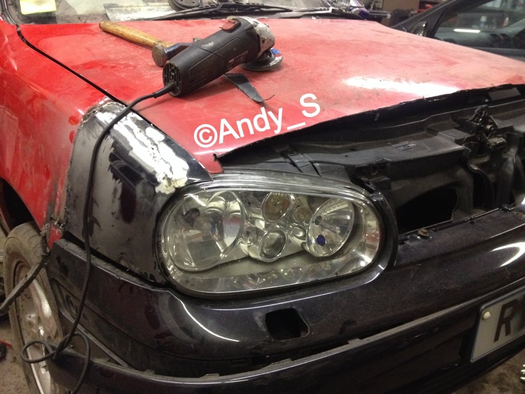

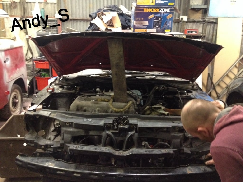

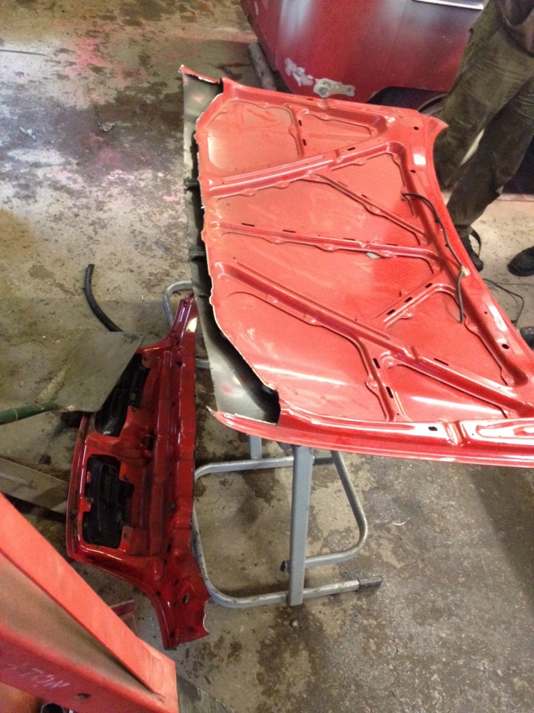

cut bonnet front end off
The master at work getting creative

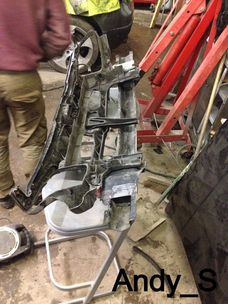

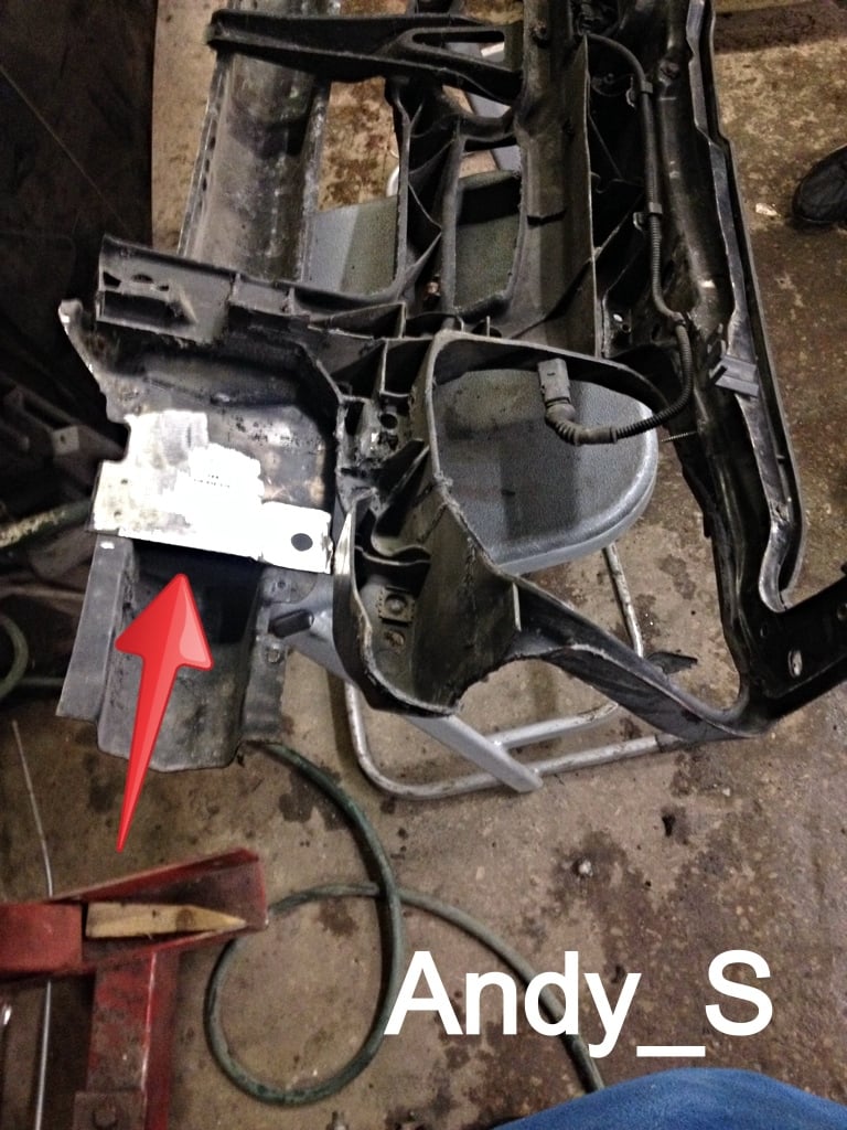

Grinding down the golf front slam panel rear for welding bolts to it to align up with Micra holes

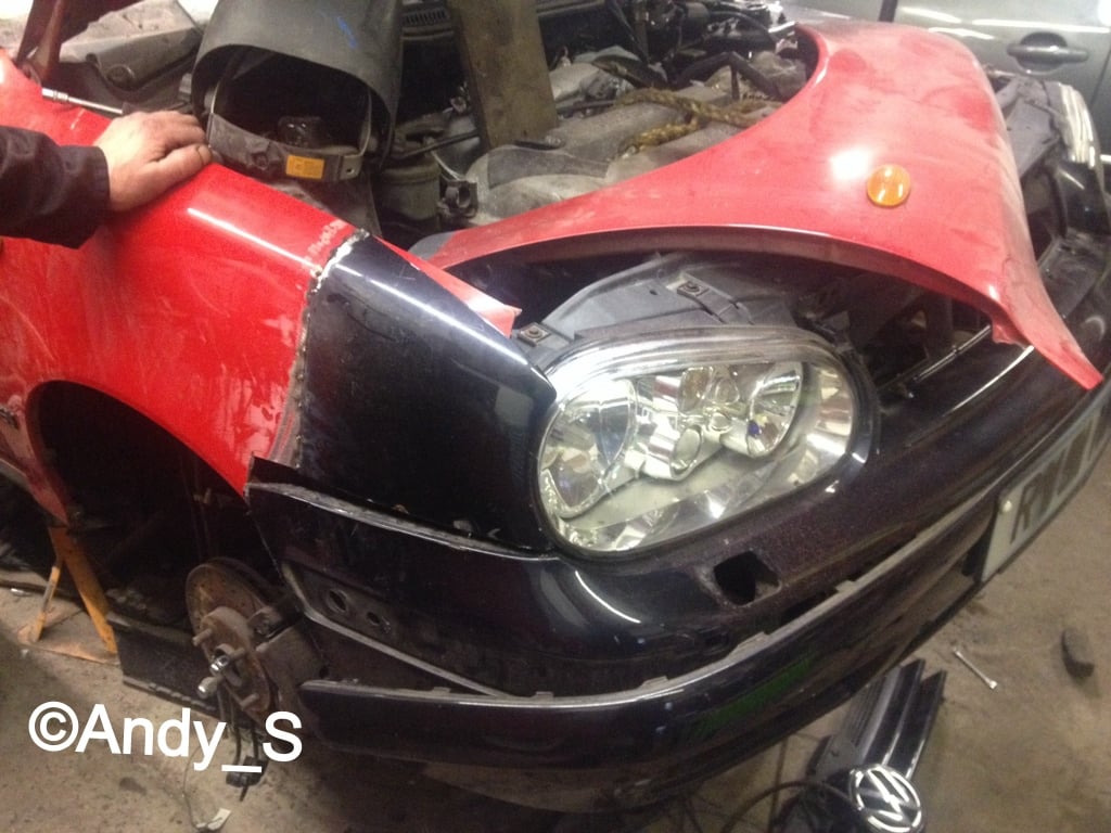

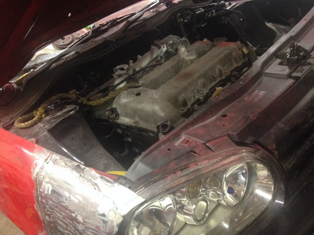

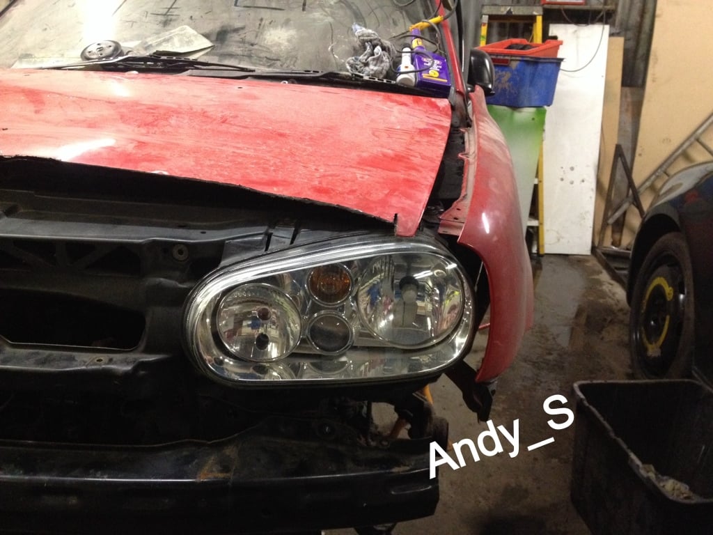

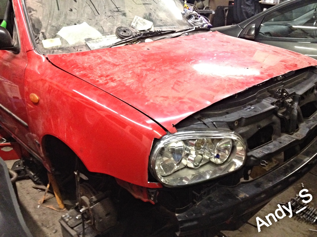

bonnet refitted, wing trimmed to fit but needs a bit more cutting back and incorporate golf wing headlight section.
We had a idea of using the golf bonnet as it is which is 2" wider each side therefore we would have to bring the wings out making the front end look wider, however I doubt that would happen but here's a pic of how much 2" wider would be.

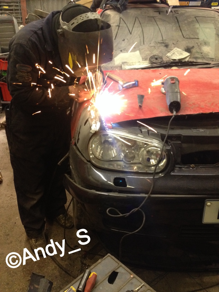

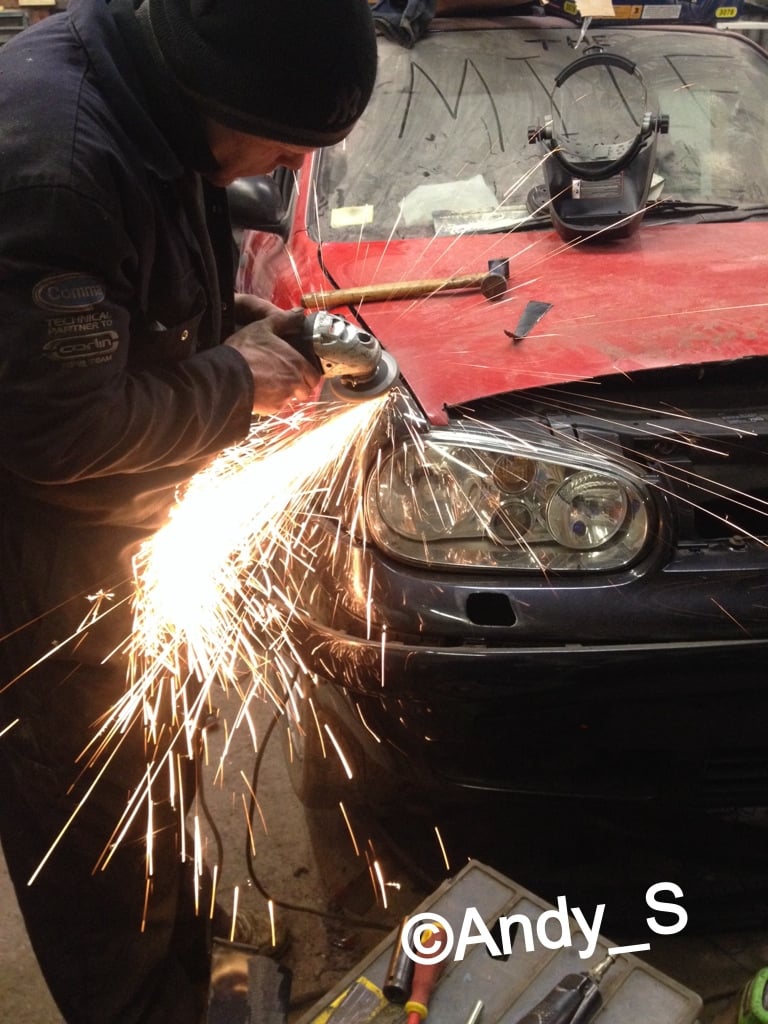

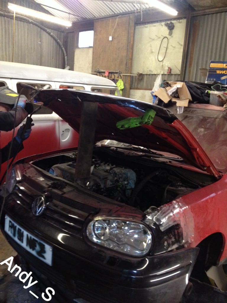

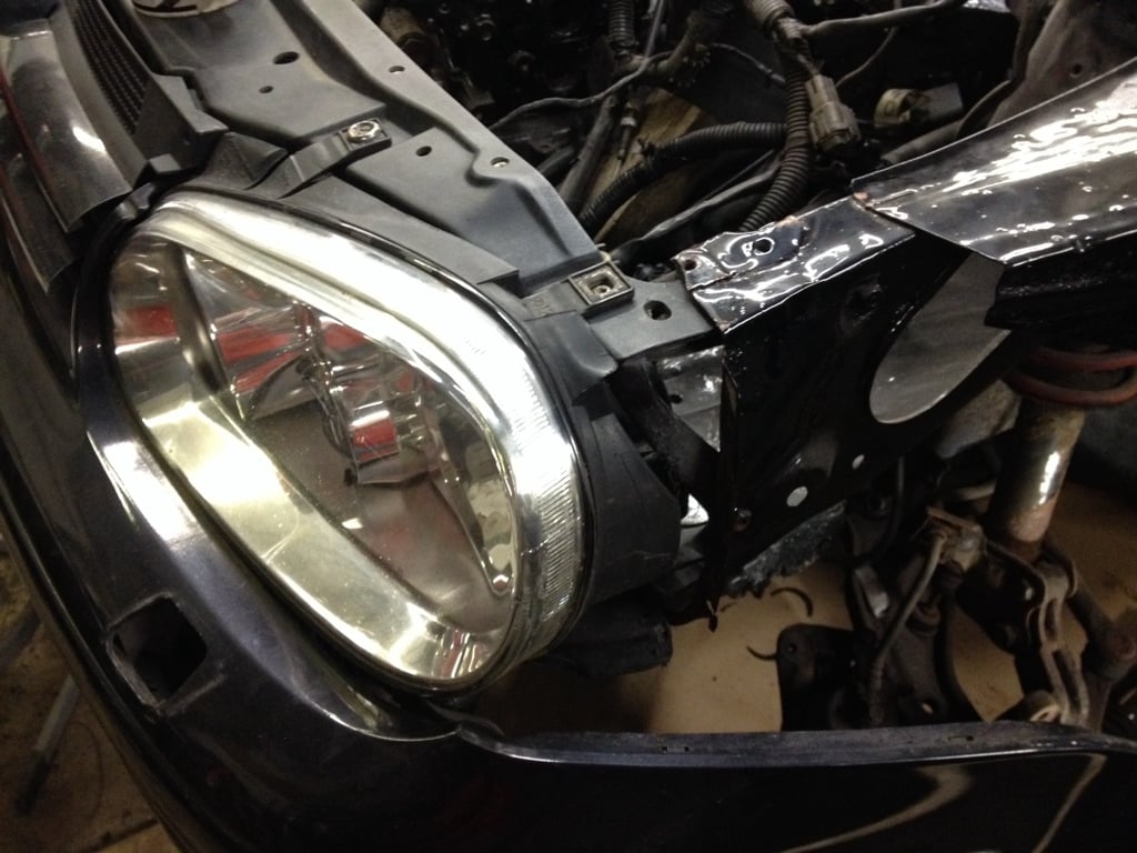

My mate doing more work to the wing cutting both Micra and golf wings and welding together. Gonna be awesome when done. My mate is in his element at the moment.

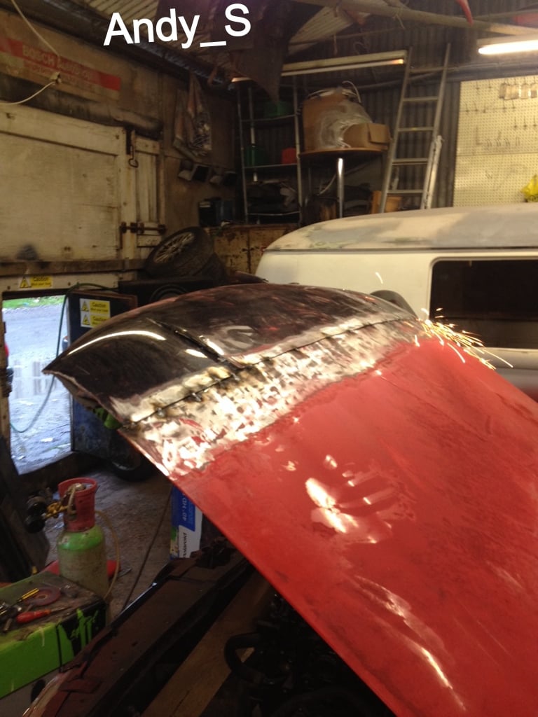

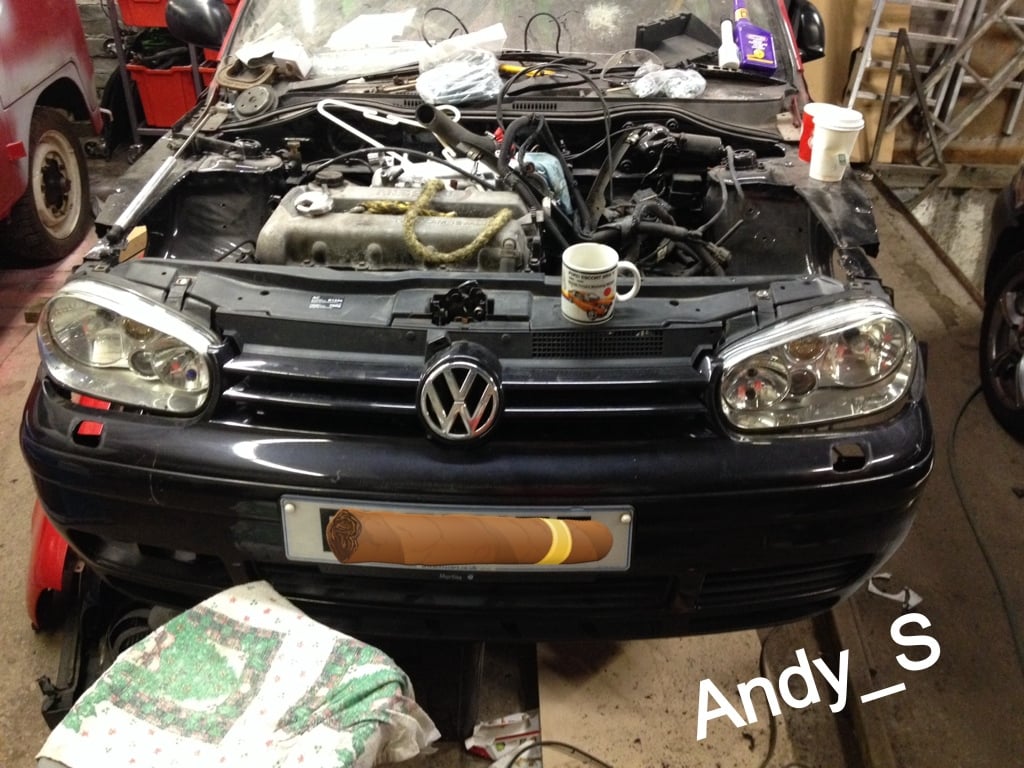

Anyhow progress pics
Then added bit of golf bonnet
Lyniching (spelling) down the welds so it's smooth
Bit more welding

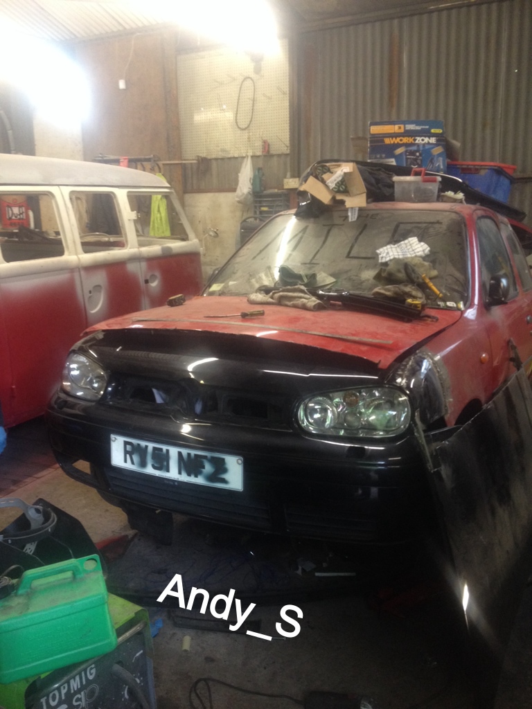

End result for today.
Spent about a hour and a half on it tonight as was stripping the black Micra

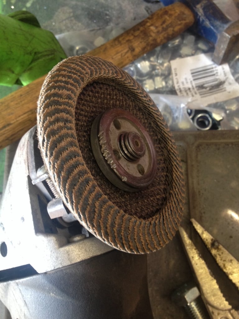

Well yeah the grinding disc has a different texture on the bottom which looks like sandpaper to me but for metal. I'll get a pic of the disc
