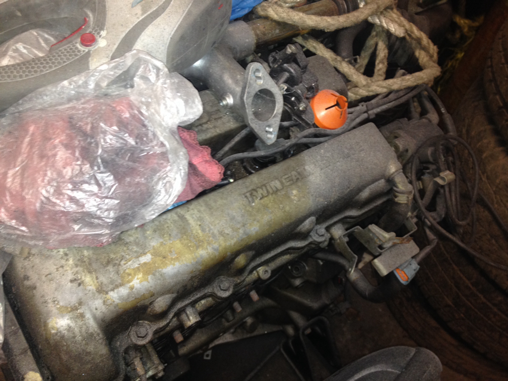

Before

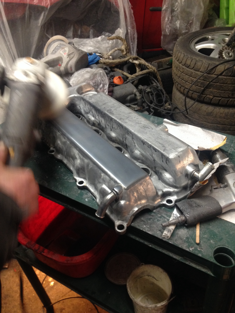

Half done grinded off the lettering and give it a polish. Hopefully have it done in a few weeks (spending about 2 hours per week on it) the colour scheme of the rocker will be green with polished metal on top and black were spark plugs area is. Pics to follow.

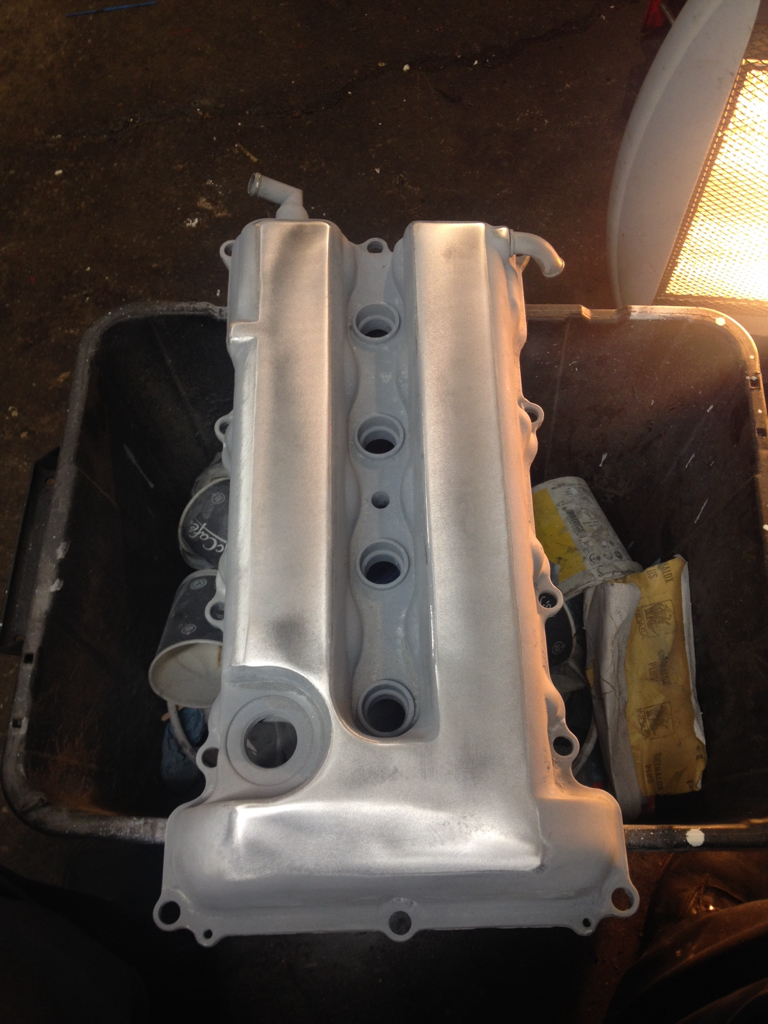

Rocker cover primer'd in grey and we sanded down the top to a smooth stainless finish. Need to g3 polish it to make it shine!
