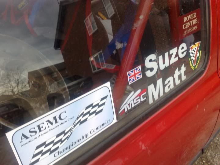

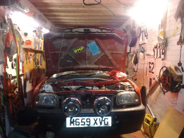

Few jobs done this weekend including fitting bonnet pins and changing the brake pads. Also added my MSC stickers:
