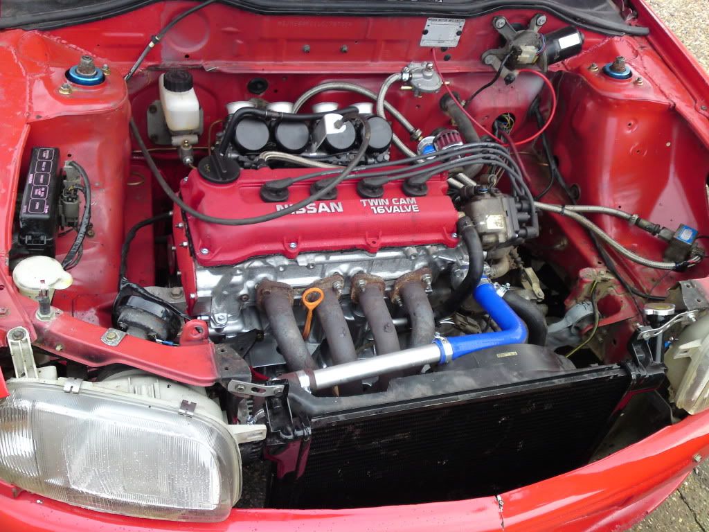

Looking to have the bike carbs set up on the car ready for this rally, with dogbox and AP clutch fitted, and AP front discs.

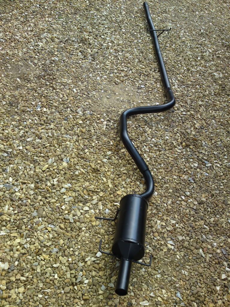

On another point, our exhausts we ran a standard 1litre micra on the rollers last week, it was putting out 50bhp at the wheels, with our exhaust system on and that being the only change it went up to 58bhp at the wheels!

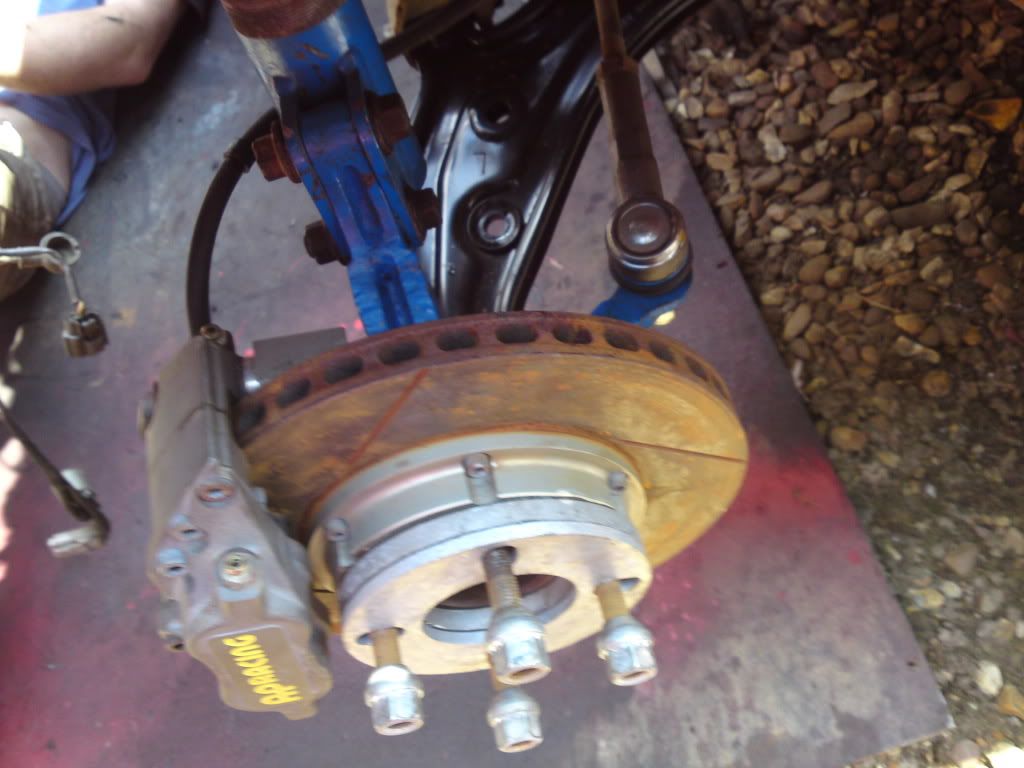

Here are the links to the two videos I took tonight of it, dogbox fitted, AP calipers and brakes, Ants new built engine, light fly wheel, running bike carbs and our own exhaust.

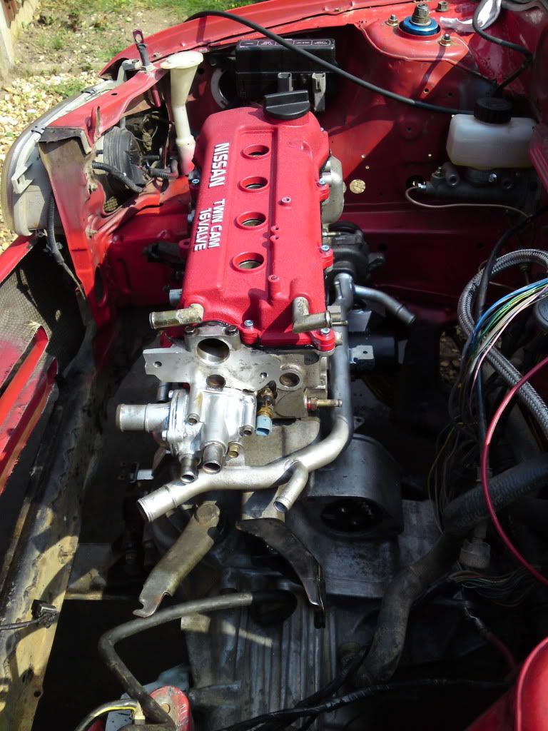

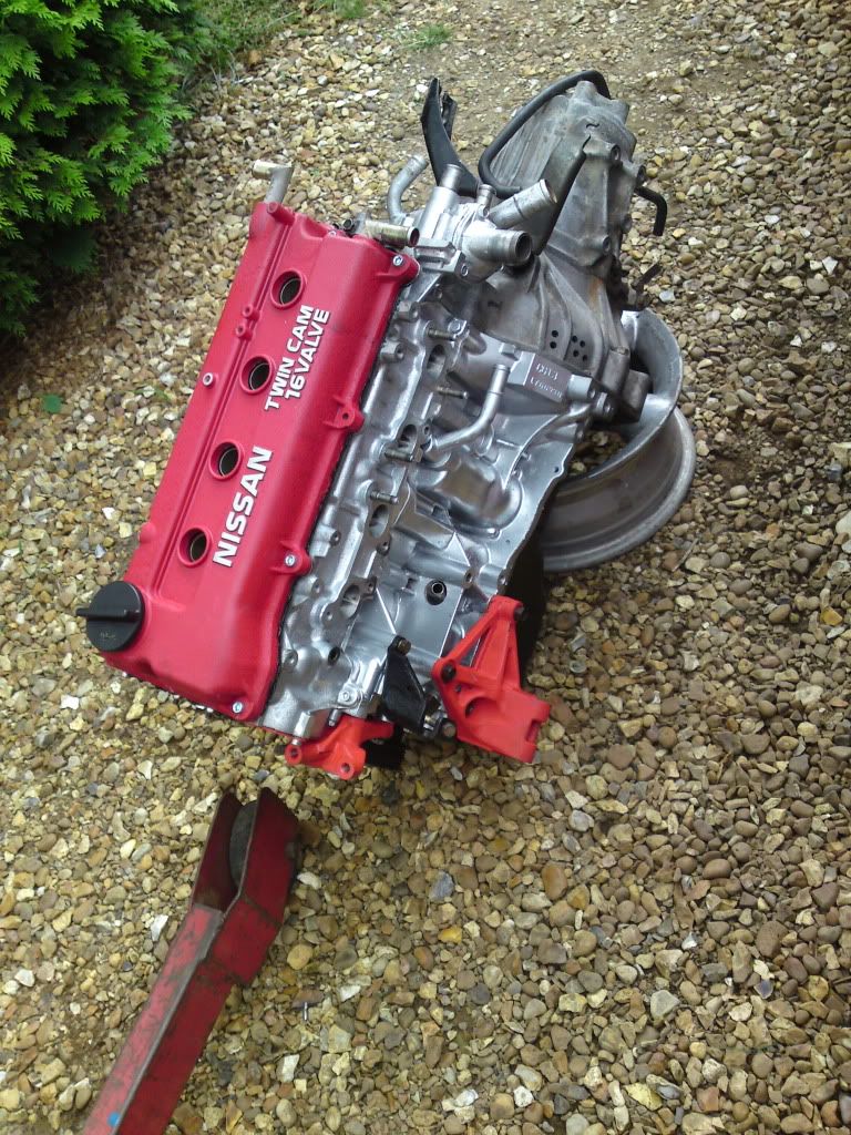

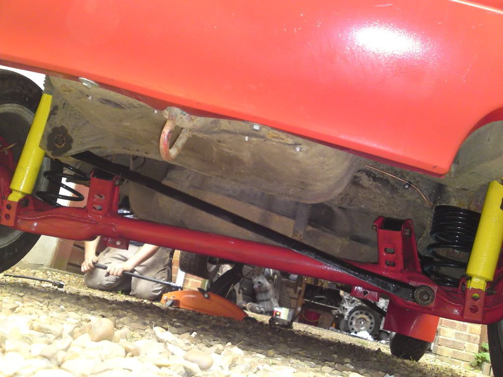

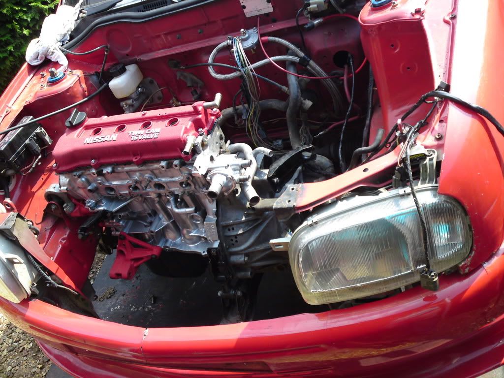

The pics are of the engine, the engine going in, the car with rebuilt rear,the AP set up on the front, our own exhaust, bike carb set up and how it looks now.

I love the clanging of the dogbox as it ticks over. And the AP brakes makes it stop like its hit a brick wall.

PS guys... all the part on the engine are genuine nissan parts purchased from matt humphris, i cannot big this guy up enough. anyone contemplating building / rebuilding a micra engine, speak to matt, he will show you the way.

the engine should be making as much power as a brand new 1300cc engine on bike carbs and racing exhaust can do..lol there will be no oil blow-by in the cylinders, the compression should be excelent due to the refurbed and machined cylinder head. i would say its gonna probebly make around 110~~bhp at the flywheel. with racing cams probebly more.
Ant you are not far off the mark, just got the call from the setting up on the rollers, first run and this is with the carbs just put on the car no set up time 91bhp at the fly, with a little playing and adjustment the final bhp is 109bhp.
As you know this is a bog standard engine, if it was running things like racing cams, skimmed head, pistons, light crank etc I would say in the high 120bhp- 130bhp.
The power at the wheels is 87bhp, as we are using a dogbox so hopefully the car should be right in the mix!

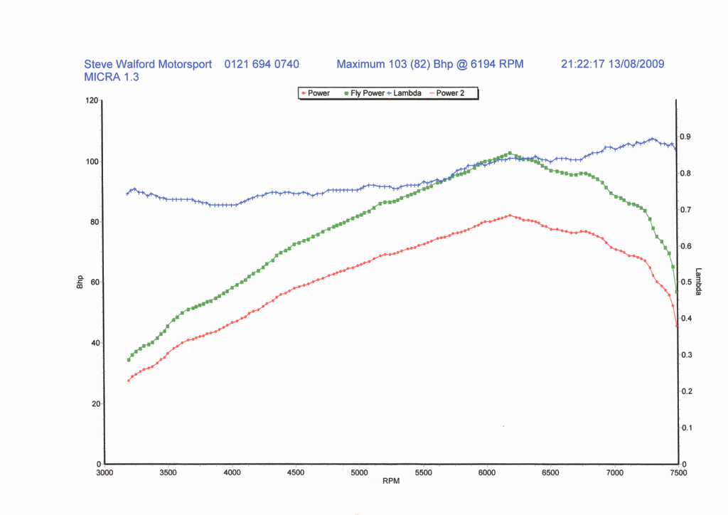

87FWHP where? What's the rpm and what's the effective powerband like? Any plots to show :)
Hi mate and everyone,
Here is a scan of one of the runs, by the end of the day it was about 10pm and we ran the car on race fuel and had another little tweek and it put out 112bhp at the fly and we ran up to the limiter which was 8000rpm. You can see the power band from the pictureas I said this is a print out from one of the first runs.

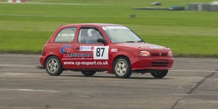

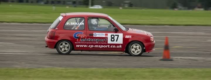

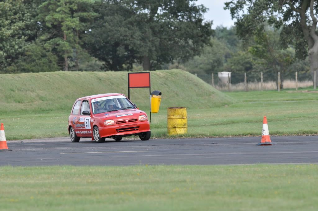

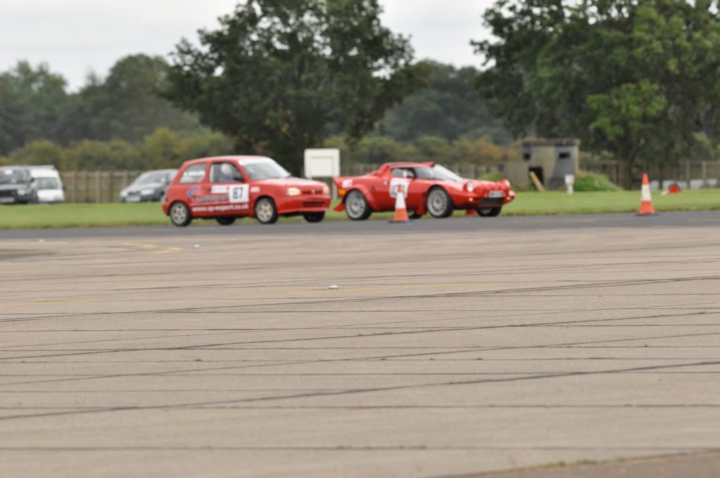

Hi all, yes thats right the rad hose blew on stage 6, I know we got to 5th in class and 40th overall out of 15 cars in class and over 100 entrys, but on stage 6 other cars in our class had problems which meant we could have got up 3rd.
The rad hose came off when I was going flat out in 5th about 8000rpm and the temp just rocketed off the dial and we lost all power. Gutted as the car was going so well. It tunred a lot of heads and got a lot of people talking about it,

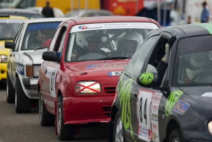

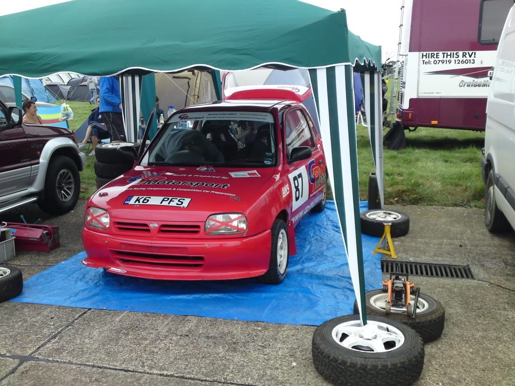

He is a photo before we started the rally, I did run an in car camera just need to download that and get it on here too.

You are both correct,

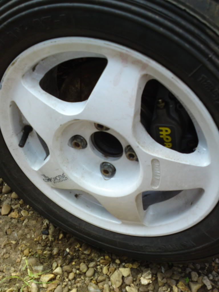

the Revolution RFX are on the car. Compomotive holding the gazebo down and pictured earlier on.
The Revolutions are 13" and the Compomotive are 14".

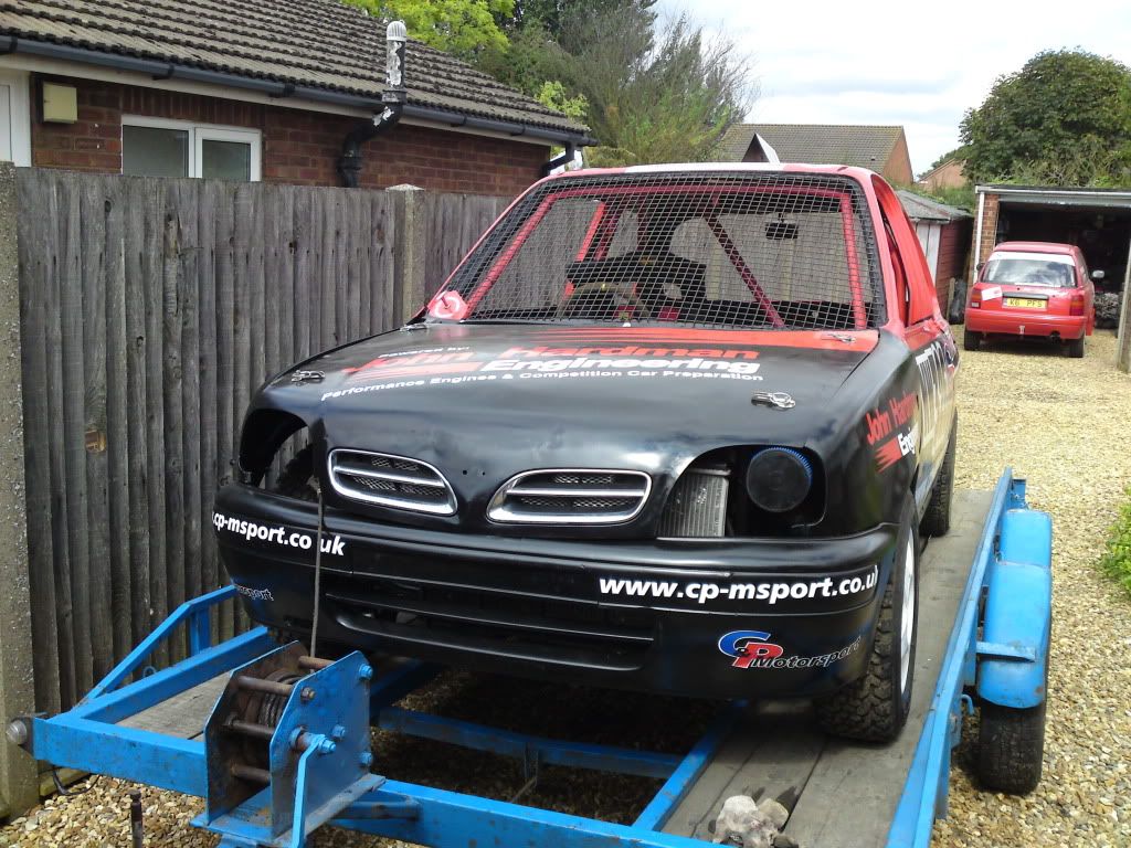

Chris is out this weekend in his grass track micra ill get footage of that and get it on the net soon.
here are some photos of his car as it is.
