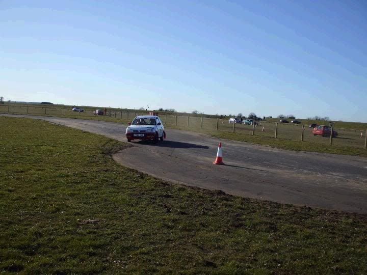

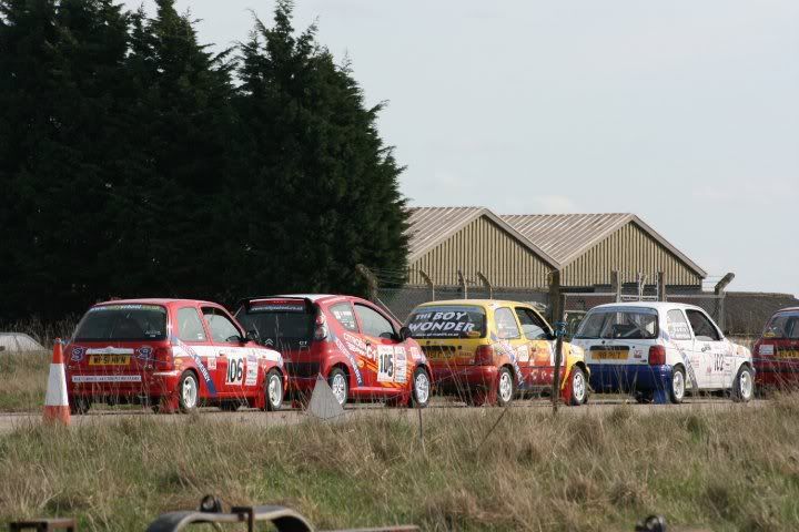

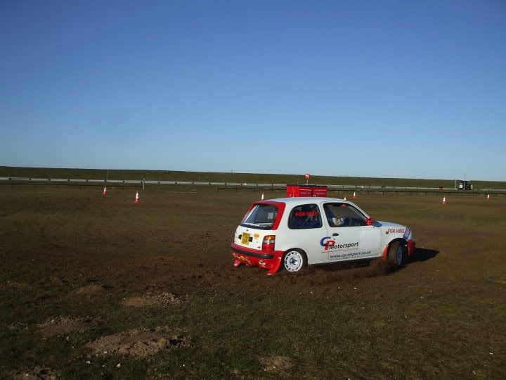

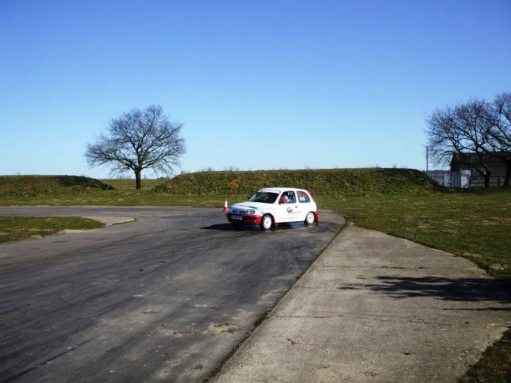

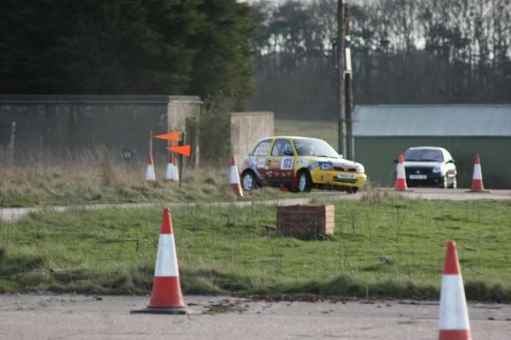

Also as promised we (Chris and I) went to Snetterton on Sunday to take part in Sccon's (www.sccon.co.uk) autotest. Here are the photos we took the hire car that is just about finished to give it a good shake down.

Here are the photos from the autotest;

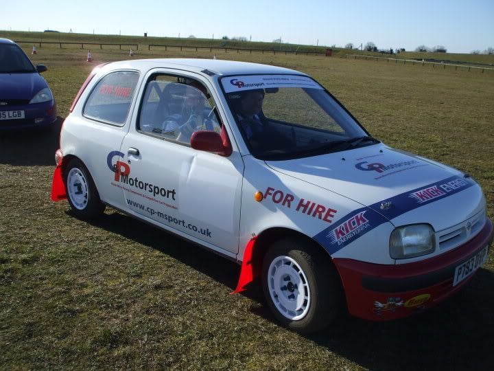

Got them from the guy who does our sign writing on the car, if you want some PM me.
like the red and white combination. did you give it a good spin?
Yes mate had a great day, yes went for a red and white combo, want it to look good as people can hire it out!
yes i see it says for hire on the rear quarter back window. how much you charge to hire im just asking?
Hi Manny, it going to be £300 per event, and then tyres, fuel etc on top.

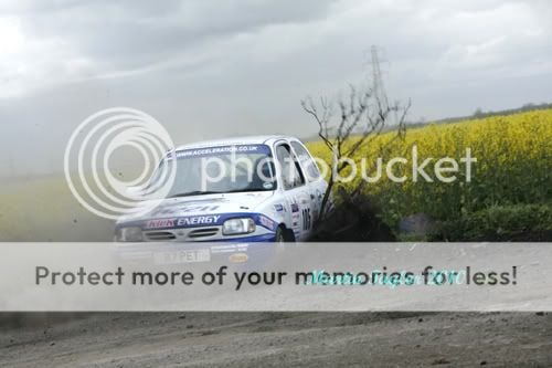

Cheers pjg1979, and yes the the car was on motors tv f1000 juniors. He did have a good year last year, but this year is even better, with first rally win! Last year Alex got as high as 3rd, but couldnt push on for the win, this year got the win in the bag, now for more!
The car is Alex's, we just look after it.
That would be me :grinning: yeah there was some great coverage on motors tv and some good shots (Y)

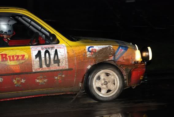

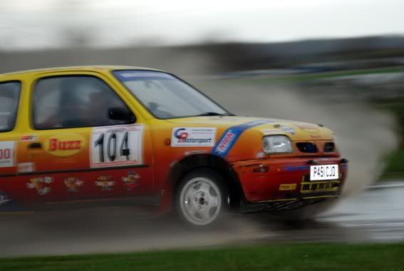

And my old car was out doing a rally last weekend on the Lee Holland stages.

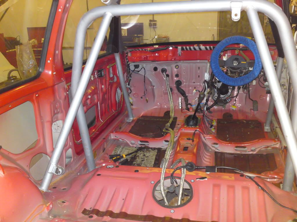

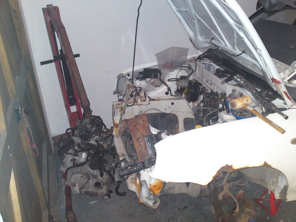

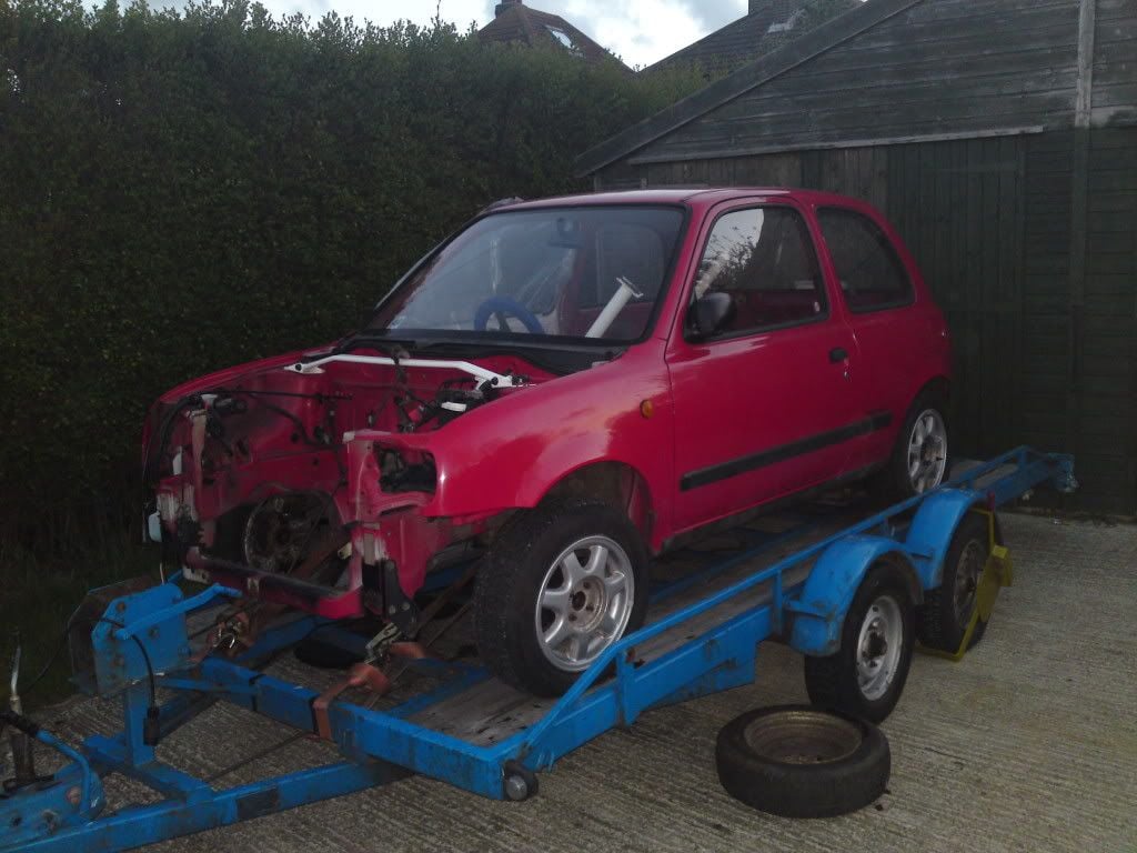

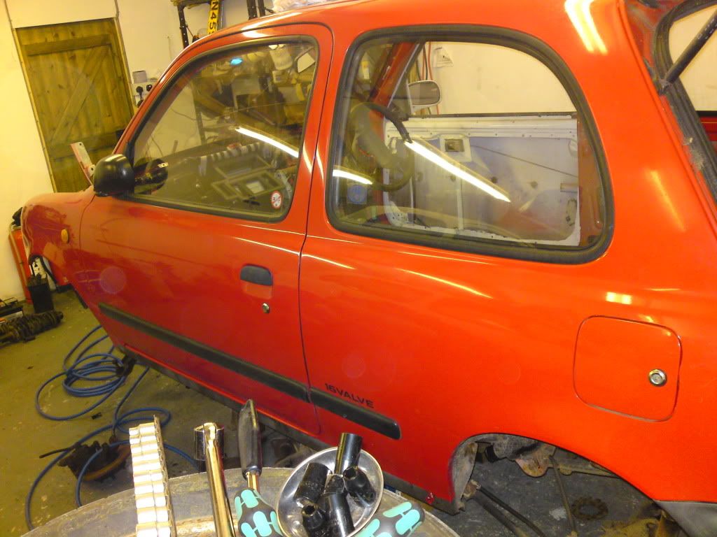

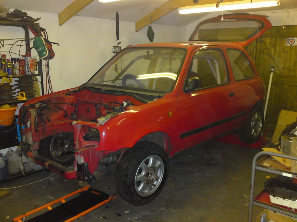

So I spent the weekend getting my car on its wheels as you can see below, its now going next week to have the roll cage fitted, and then back to mine to get the engine and rest of it built!
The cage I am going to paint white before its fitted, so thats a job for this week. As you can see from the other photo work has already started on stripping it so I can get the best most useable bits off it for the other car.

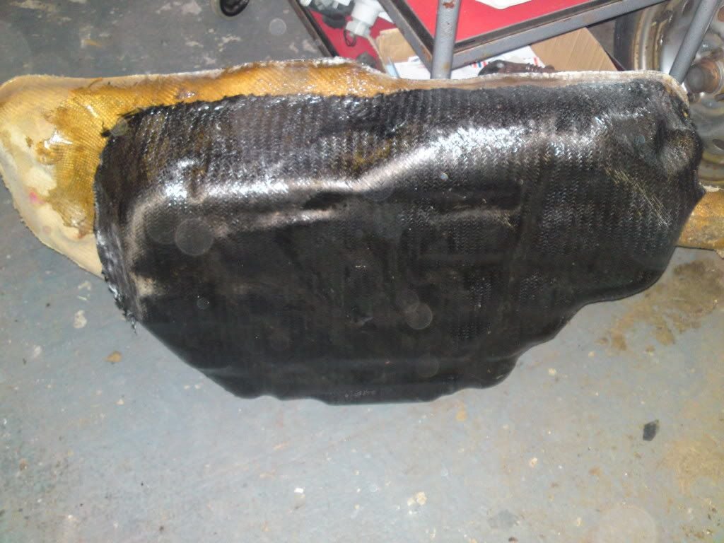

The other photo is of the tnak gaurd it had a big crack in the front of it so I I've covered it in carbon fibre cloth and resin and it looks really good.
Yes it is an OMP cage, its only for road rallying so all the trouble with the front legs etc wont be a problem. A harness bar is a good idea, Ive got one on my stage rally car.

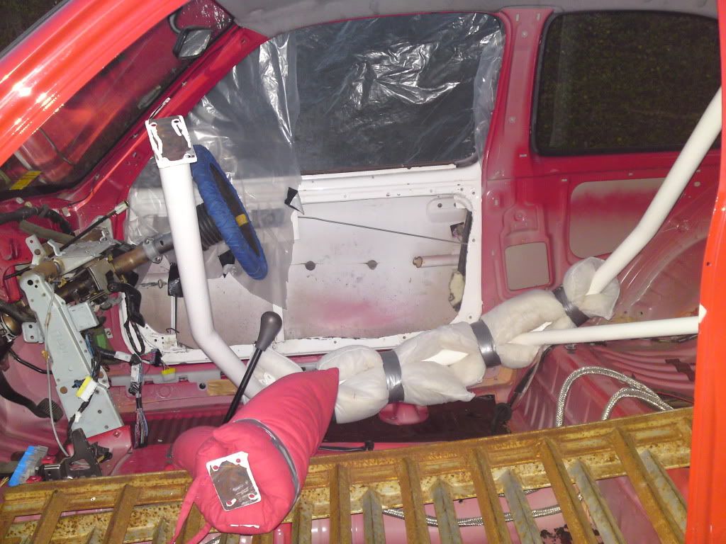

Right quick update, car is ready to go and have the cage fitted this week, as you can see I have painted it white, it was silver and that wasnt the best finish IMO, so its on the trailer and ready to go to the welders, he is also going to fit the seat bars for mounting the bucket seats that I have.

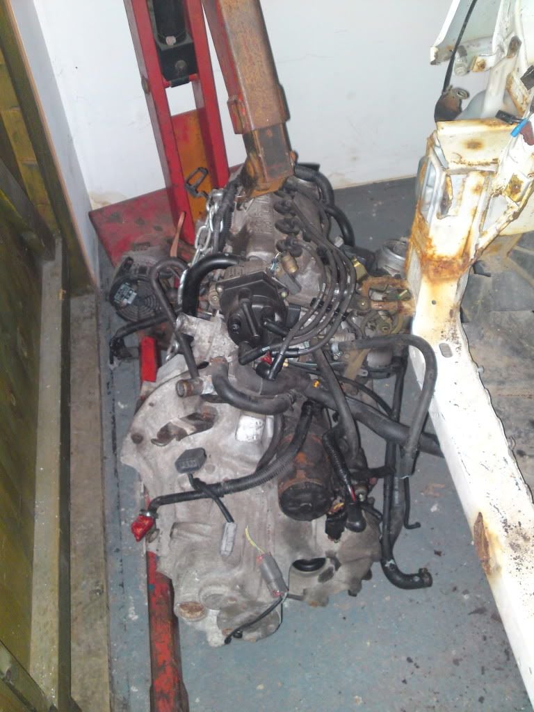

I also got the engine and box out of the doner car, the plan is to take the rest of the decent bits of the doner and then take it to the breakers yard as it is rotten.

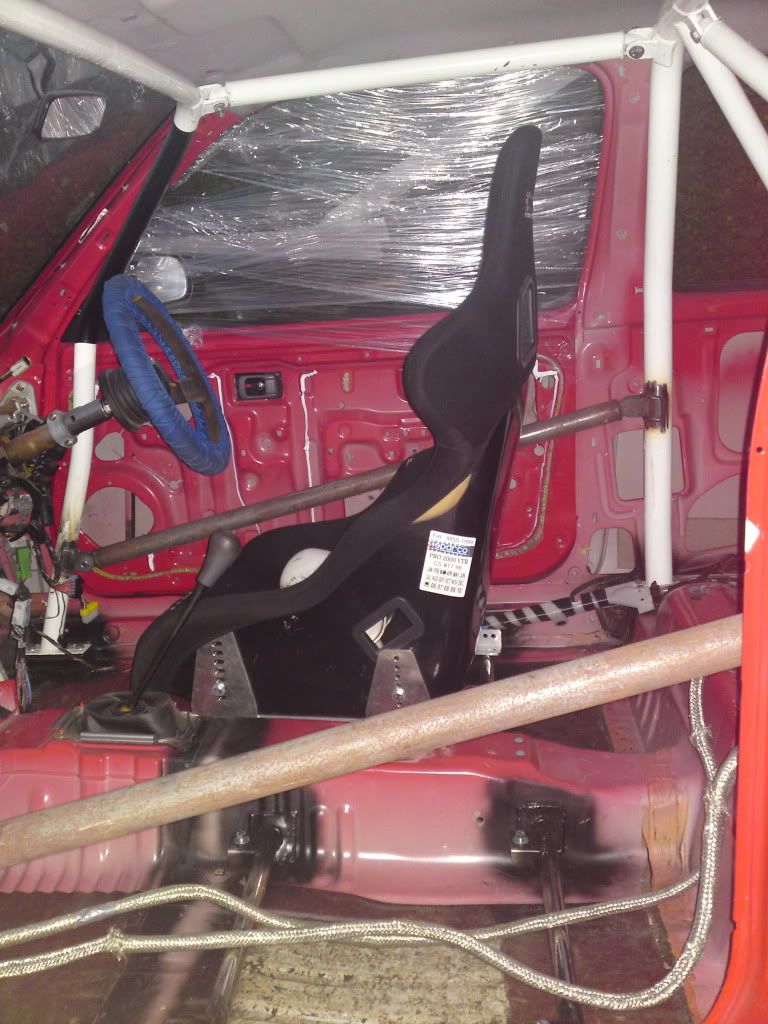

The cage is now fitted along with the bars to fit the seats too in my road rally car, just need to get on re-building it now, hopefully ready for the 12car season in September still not sorted what Im going to run engine wise.

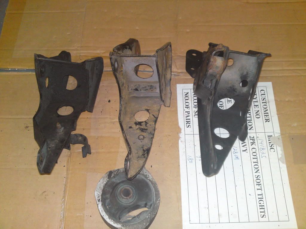

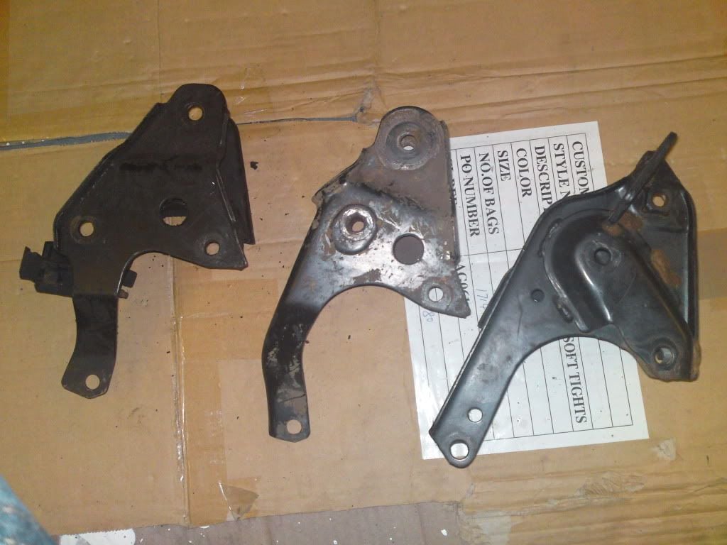

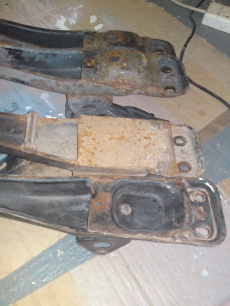

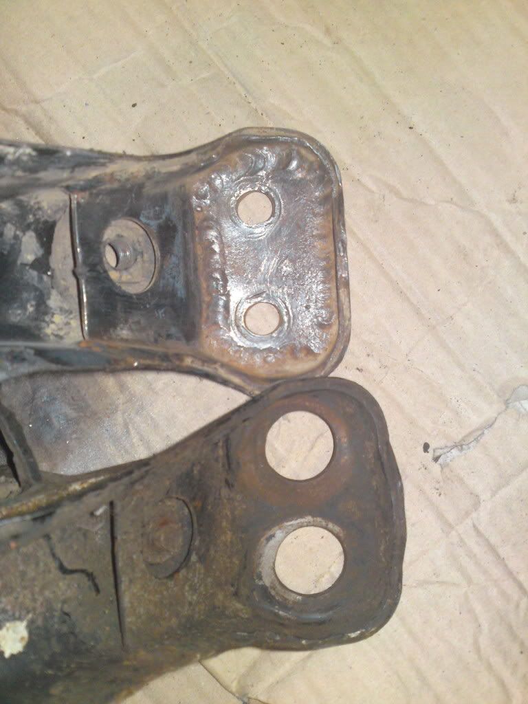

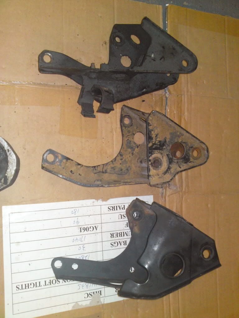

hi, just getting bits ready to build the car and thought I'd take a few photos of parts that I am going to fit to the car that arent standard,

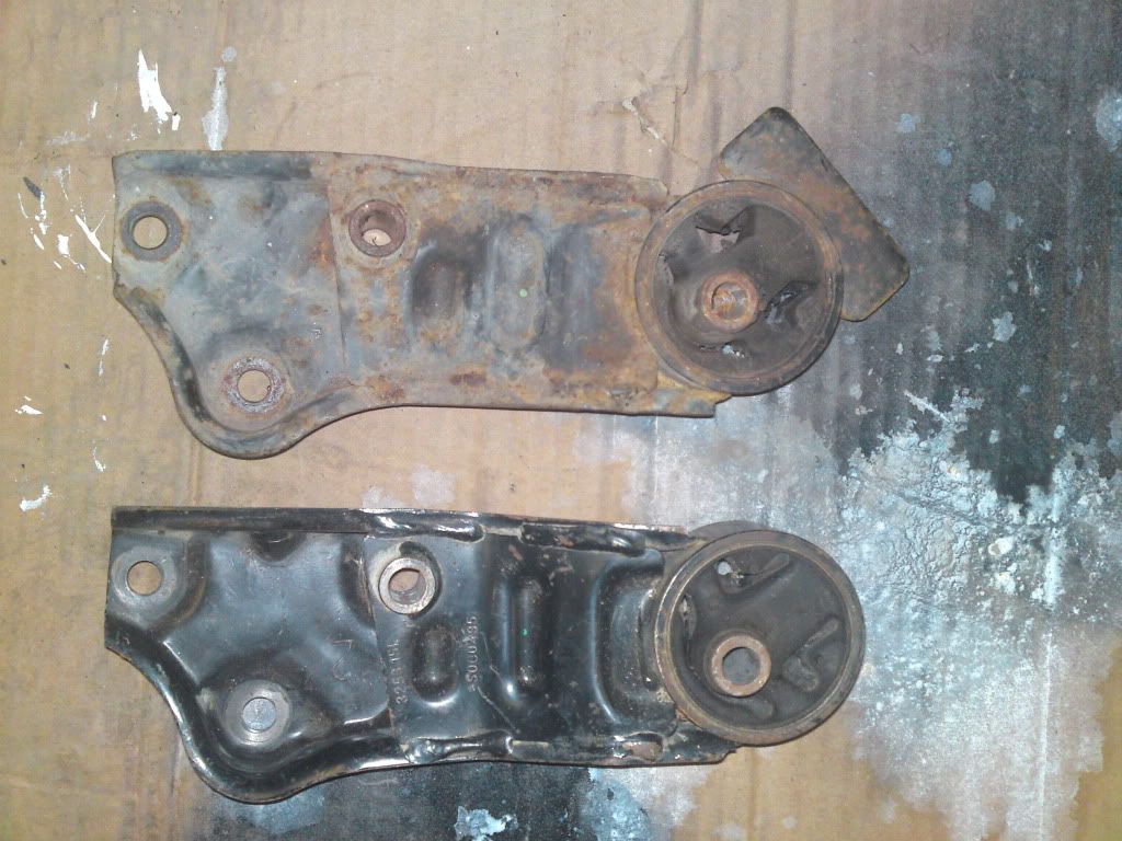

Its the front to rear engine bay subframe, as you can see from the photos, one is standard, and the other two are modified. One has a plate welded the other is renforced at the bolting part see photo.
The other photo is of the rear gearbox mount, as you can see one is standard the other two arent. The other photo is the engine mount from the gearbox, against a standard one. And then the last photo is all the mod'd bits painted and my disc'd works rear beam, my plan is to fit my rose jointed rear link bars and I am just fitting NISMO bushes to the engine mounts now.

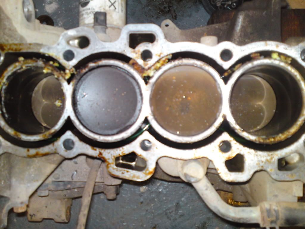

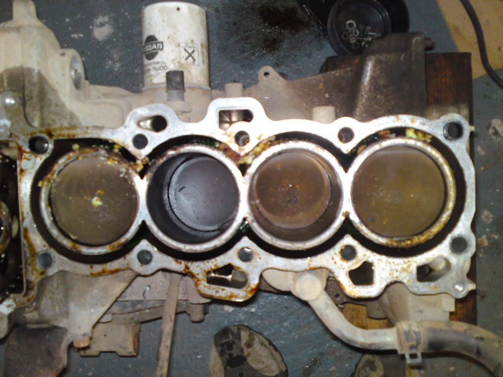

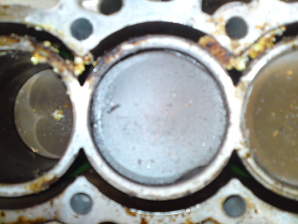

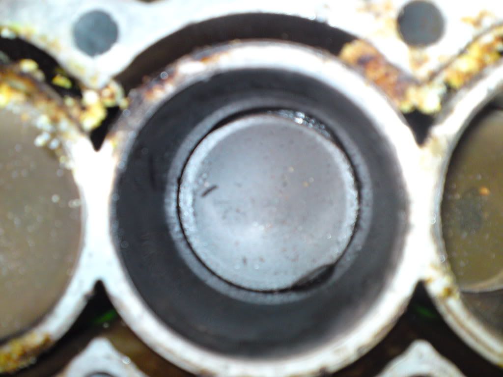

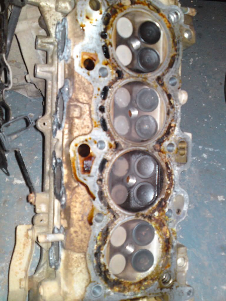

A bit further back in my blog you will see that I blew up an engine or two :laugh: in my road rally car, well this is the block from the first one that I blew up. As you can see piston is proper f*^ked! funny thing is it still moves up down ok! I thought it would have been all melted together. Do you think it could be used again, well its off to the breakers soon!

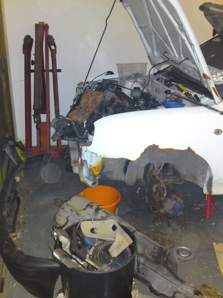

Well after a weekend of clearing out my garage I can now see the floor!!!
I have a micra shell full of bits that I am taking to the breakers tomorrow, about 6 flywheels, two engines and gearboxes that are knackered. Exhausts and others bits that I can get rid of.
But in tidying up I found a set of rear calipers for the rear beam below so my hunt for calipers have stopped! Yay!!! (Y)

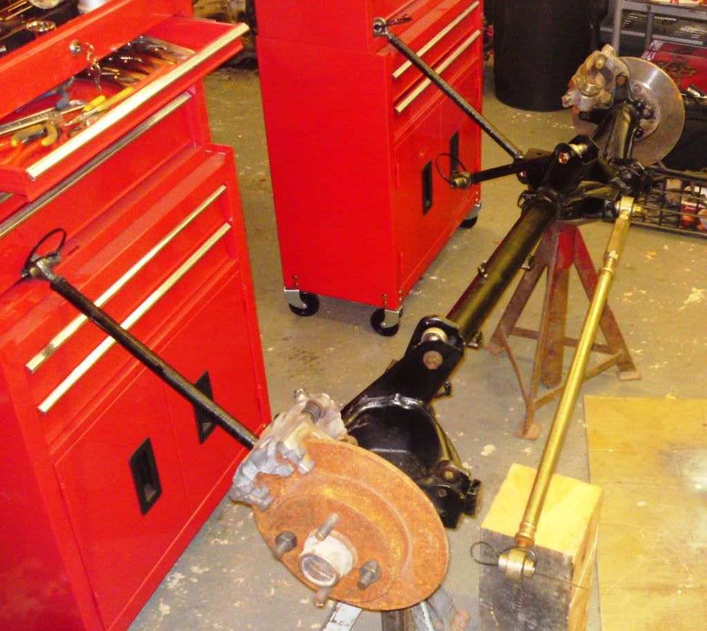

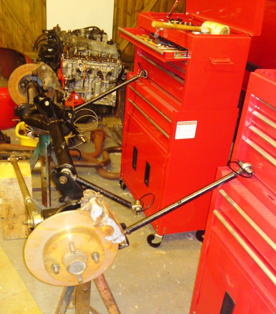

Now planning this weekend to finish painting the cage, get the car up off the ground again and start fitting this rear beam, rose jointed link bars, and Im waiting for an adjustable panard rod to arrive. Fit the tank with the guard and then start at the front of the car.
It will be running vented front discs and I have a set of calipers for that, and Im just finishing painting the front and the rear calipers now.
I'll be interested to see if you can get a fully spherical jointed rear end to work. Because of the way the multi-link rear is set up it relies on flex in the rubber bushes. If you replace the bushes with spherical rod ends you only end up with about 4" of suspension travel before it all binds up. We figured to get it to work means either refabricating the top links so they run parallel to the bottom links or doing away with the panhard rod.

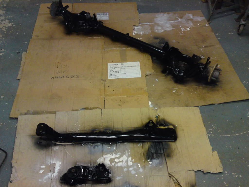

Rear braked axle ready for fitting now on the rally car!
serious skills
