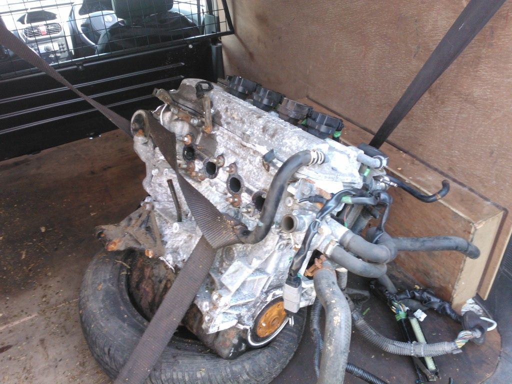

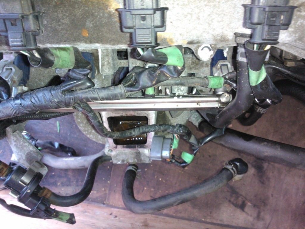

I'm deffo painting the rocker cover, manifold needs to come off as its full of water :/
Defo worth checking out the bores for water ingress. A lot of these engines are left outside by idiot breakers and can end left standing with water in the cylinders.
My plan was remove manifold and plugs and turn over by hand I might do it on my dinner tomorrow as the engine is at work
Fingers crossed it'll be ok. My CGA3 had water in the cyls, not that it mattered in my case, as it was the base for a race engine, but when you're wanting a drop in engine, it's a bit different. It's still poor practice, especially when breakers are trying to command a price for an engine :rolleyes:
i,ve had engines with a waterfilled/rusty bore too, the last one would only turn so far and hydrolock (got a good price reduction lol), short term wont hurt because the rings will scrape a light surface rust off, but going by that rusty crankface, i think i would lift the head and check first personally
