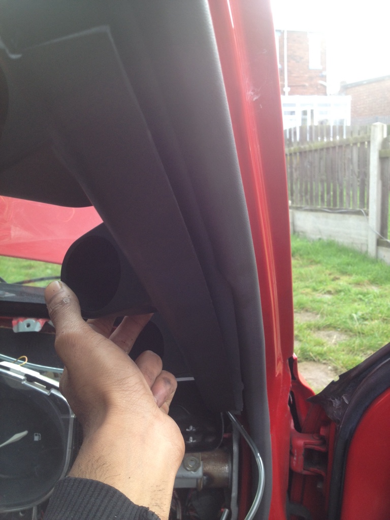

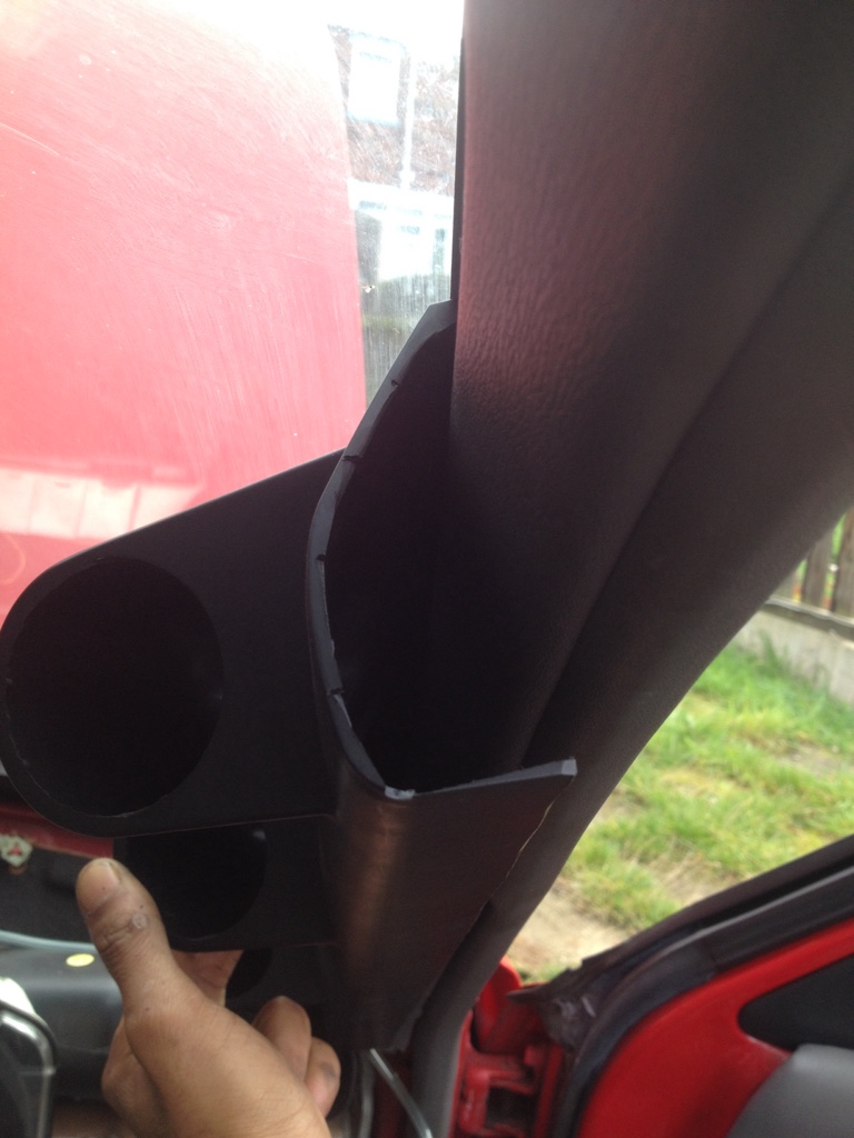

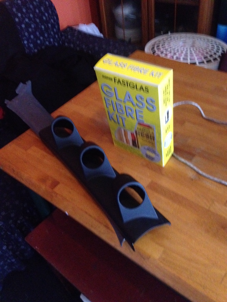

Azzy be carefull polyester resin wont stick to the micra interior plastics you have to prime the plastic with epoxy primer or glue the piece on with epoxy glue. Ive been there n tried thats why im.sayingStarting on my pod pillar gauge build, has come today and the pillar is too big
. So here is the hard way fit work hard and it will look great don't ask why I have 3 pods lol![]()
I have all that ready and good glue gun with wood in for stealth, can I use body filler over that ?Azzy be carefull polyester resin wont stick to the micra interior plastics you have to prime the plastic with epoxy primer or glue the piece on with epoxy glue. Ive been there n tried thats why im.saying

Tbh ive tried bodyfill and it doesnt really stick, but if you paint on a thin layer of cheap epoxy glue you can filler over thatI have all that ready and good glue gun with wood in for stealth, can I use body filler over that ?
