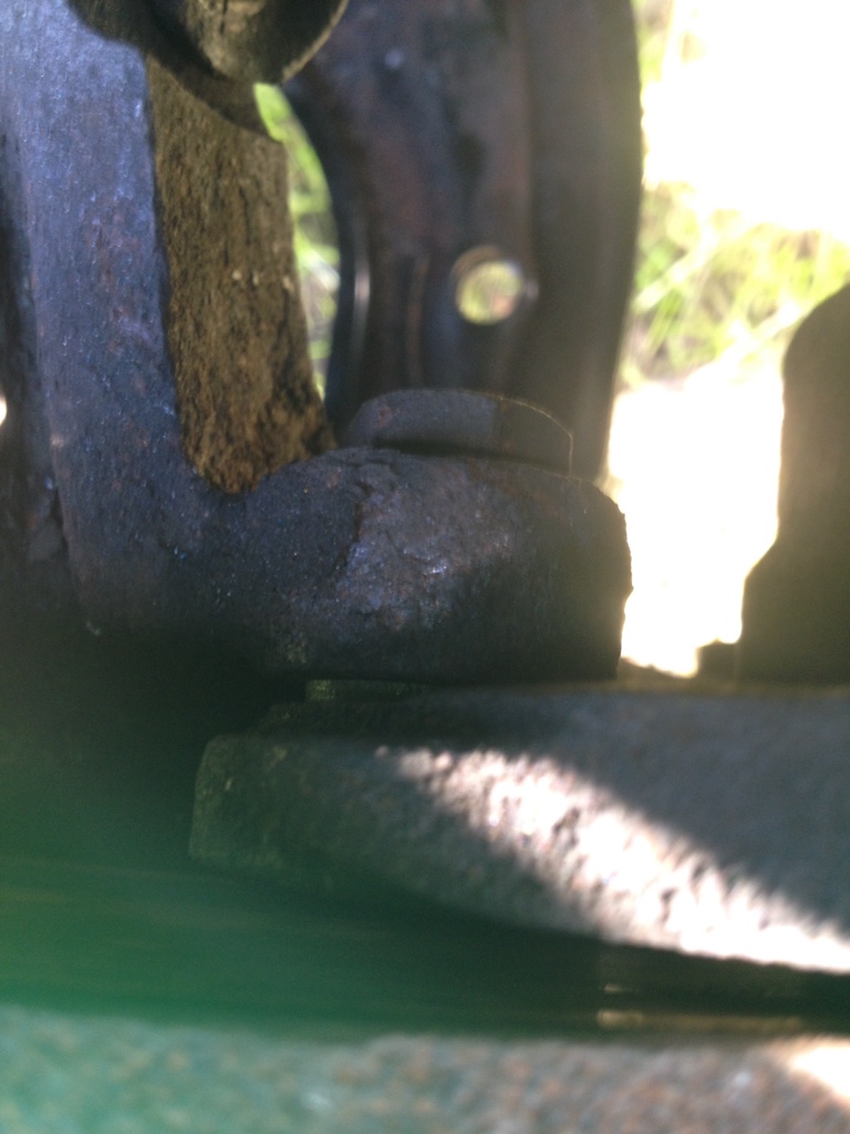

on the gtir brakes I spaced it with 2 washers Don't no how many mm I think they about 5mm and they are catching the pads so any help @pollyp
Right what I done was took the both 17mm bolts off then took the carrier off then used washers in then fitted the carrier over them then bolted it down, am I doing it wrong ? Any pictures would help thanks Pollywhat dya mean catching the pads?
the washers fitted between the hub & caliper carrier simply shifts the carrier out abit so that there's equal gap between the insides of the carrier & both sides of the disc.
the pads should slide smoothly on the chrome clips.
the guide pins should slide smoothly.
the bolt goes through hub mount hole > 1mm washer > caliper carrier cage thread
can't get any simpler than that
I have done it right ? But think my washers too bigthats the position azzy

Yeh I will go to 1mm which everyone uses and haven't got the spacers that size so Tommow is getting washers and try that, thanks Pollyadjust washer thickness till the gap on both sides of the discs are equal. vernier calipers would be useful
