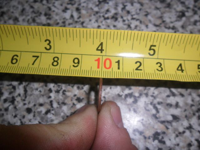

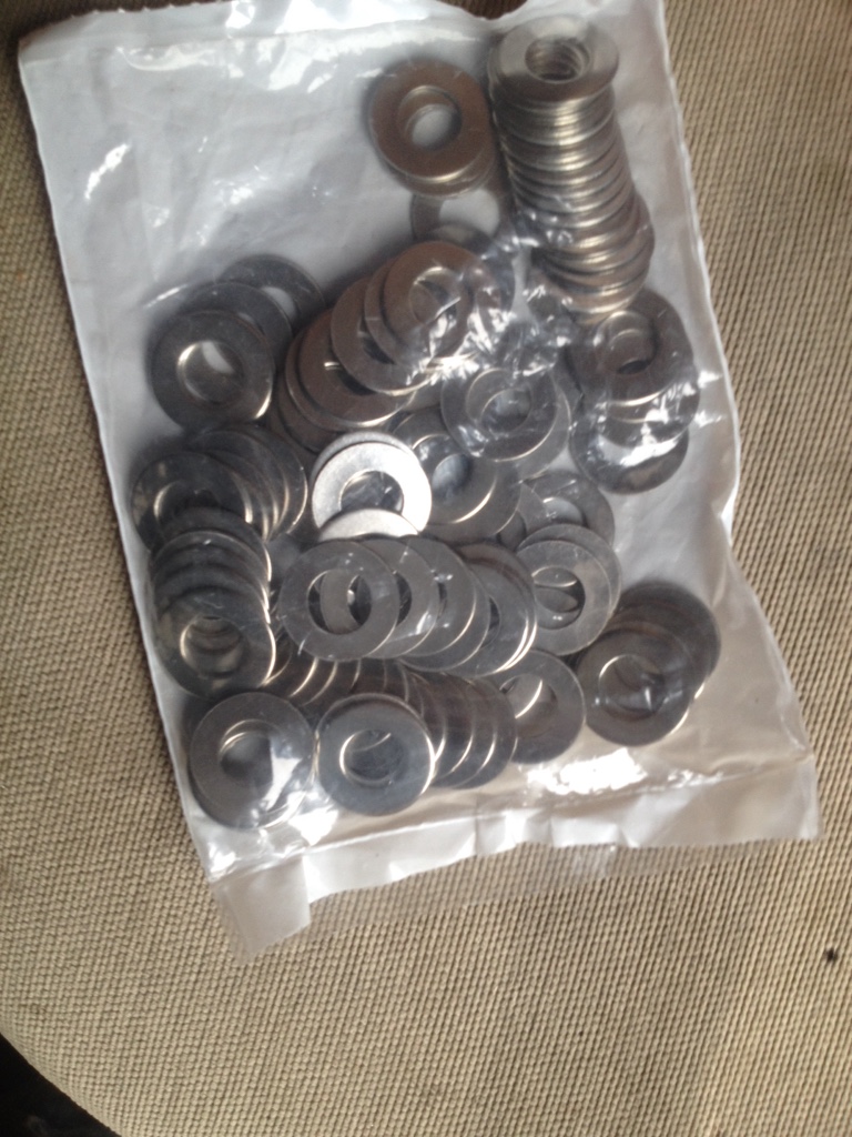

Right I have been to bulleyes motor factor and they haven't got 1mm spacers only 8mm and 10mm are you sure it's 1mm that is very thin ? Where did u get yours fromthats the position azzy
B and q ?just a general hardware shop!! packet of 10 £1
So I need 4 washers all 1mm each ?could do

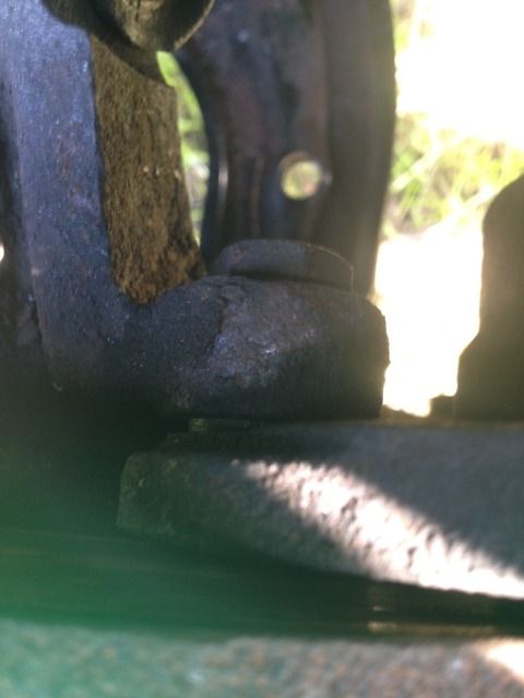

Not wheel spacers. To space the brake carrier from the Hub I thinkHave I got the wrong end of the stick here or are you guys actually using washers as wheel spacers?
When you use Almera,100nx calipers etc, you need the 1mm spacers in between the hub and carrier else the caliper is not centralised to the brake disc.Have I got the wrong end of the stick here or are you guys actually using washers as wheel spacers?
You mean the hub to carrier, not caliper to carrier don't you.yep as above av22s or gti /gtir need to be ever so slightly spaced from the caliper to carrier to centralise the pads or they catch you beat me to it lol
adjust washer thickness till the gap on both sides of the discs are equal. vernier calipers would be useful
