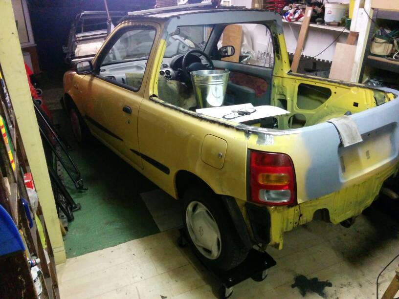

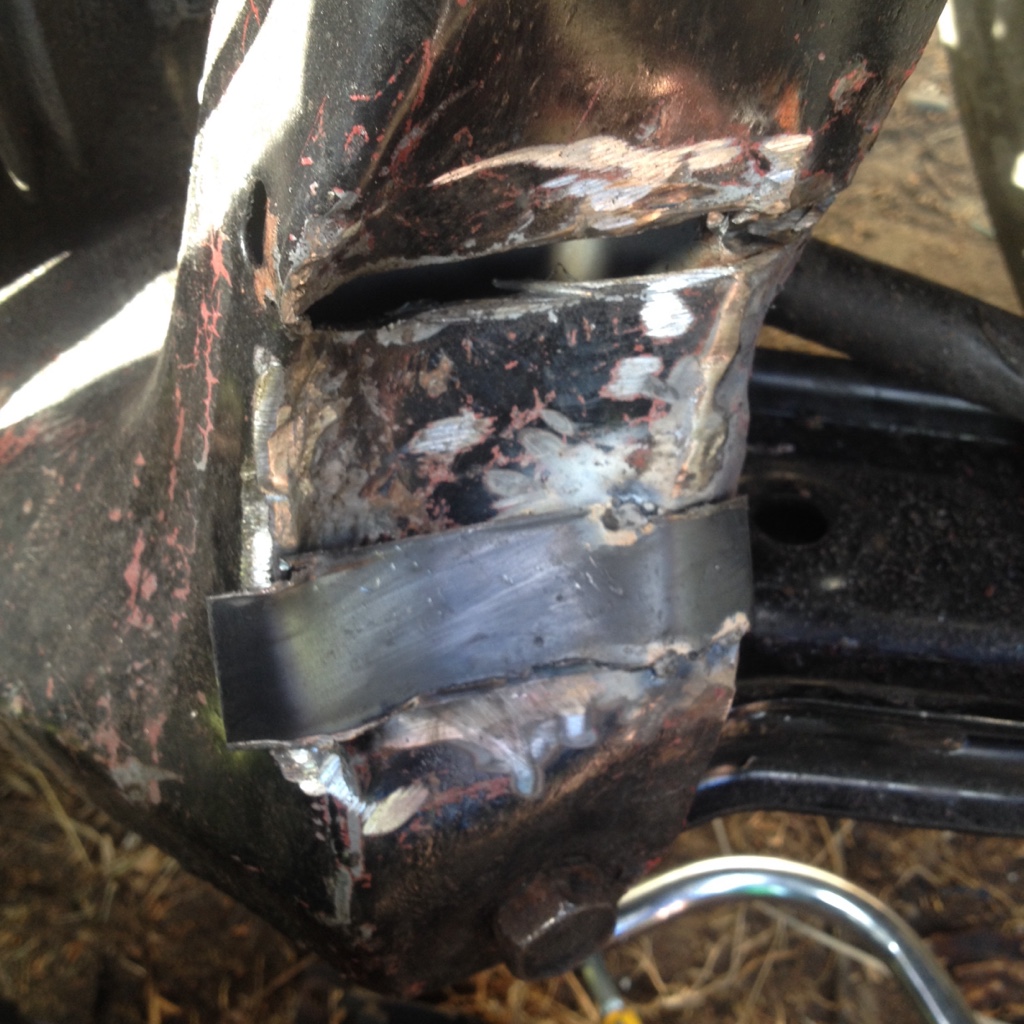

Thanks!!@mikebeal Nice work! Just had a quick look on your build thread as I would like to do this to my pickup project.
Any pics of the chassis cut / engine mount fabrication? I quite intrigued by the process.

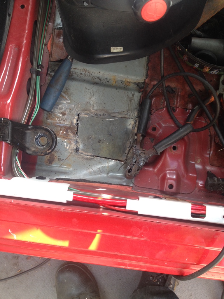

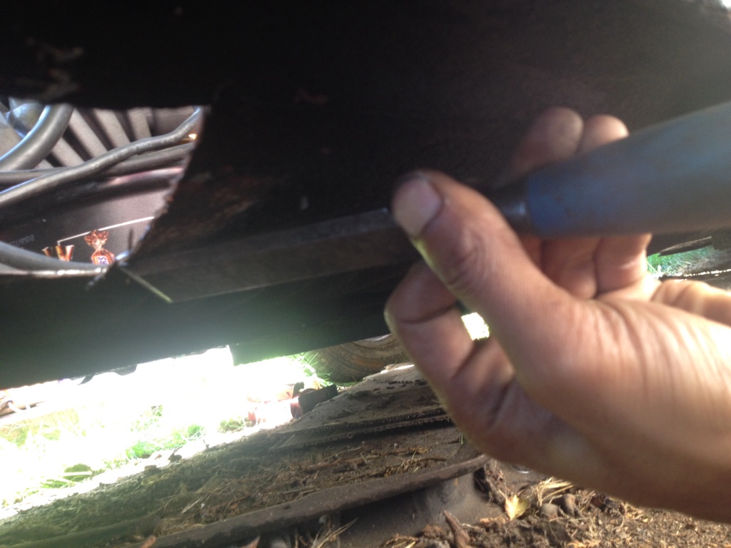

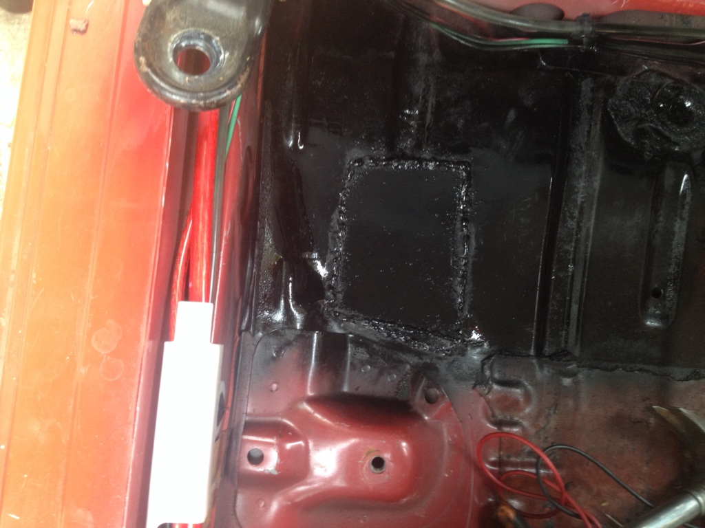

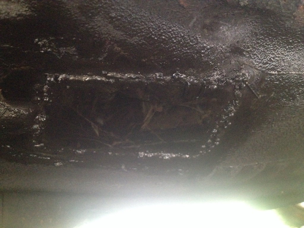

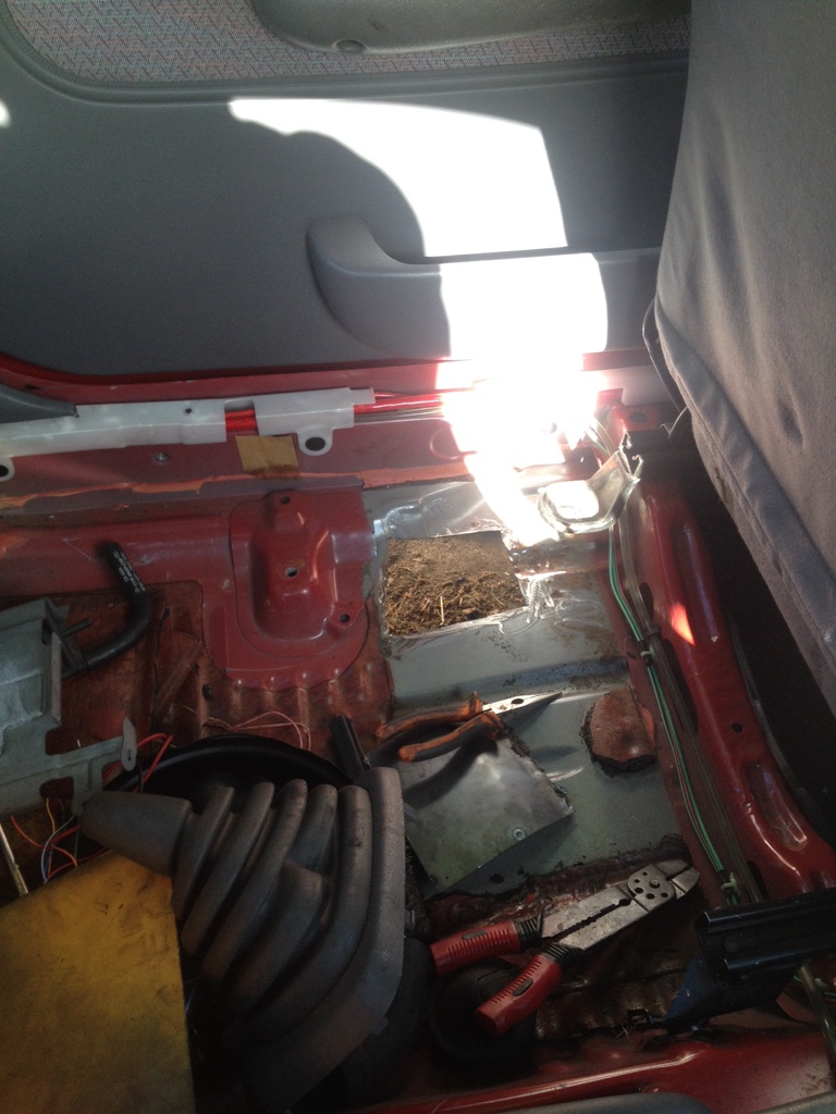

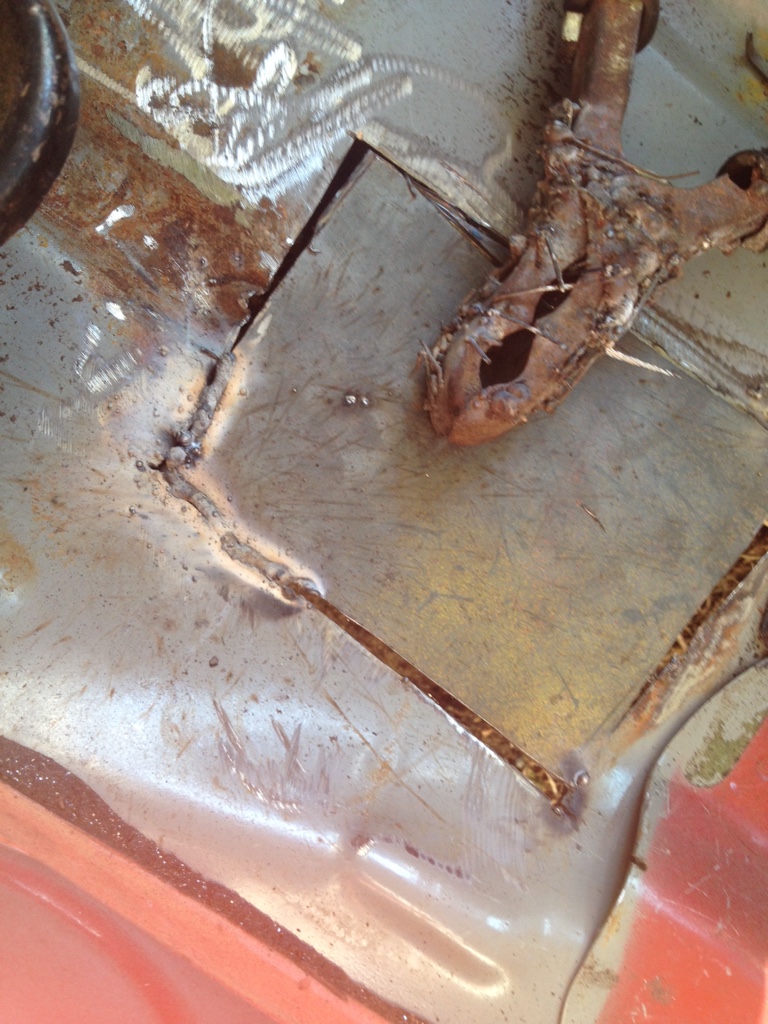

done passengers floor today cut the rust out and keep welding as @frank told me, I don't look at YouTube or Micra manual I listen to him, and now it's all done![]()

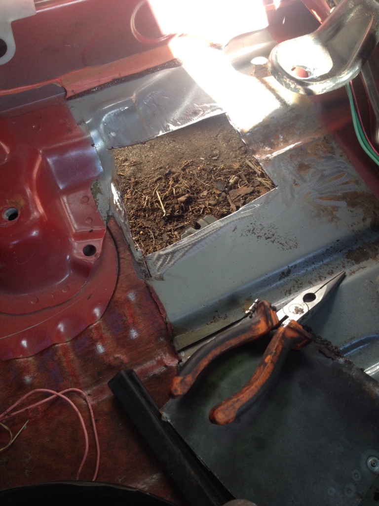

Took the under seal off the bottom so nice and clean when I weld, cut a shape out from 1.2mm sheet, and tacked in place then filled each holes my battery died for the final picture Whn it was all done,
without this mig welder I'll be lost as my stick weld wasn't like this it was burning holes on 1mm rods and my mig is 0.8 wire and it's fine,![]()

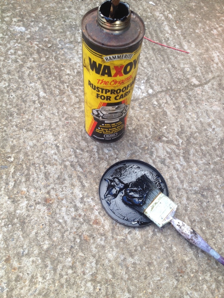

I welded the bottom as well so it's all safe need to grind and paint, then wax oil, am happy now no more rust,![]()
where you get your waxoyl azzy and do yopu know how much it cost?![]()
They about 10 pounds a can from halfords covers all the under carwhere you get your waxoyl azzy and do yopu know how much it cost?

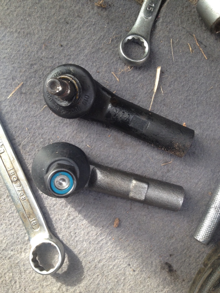

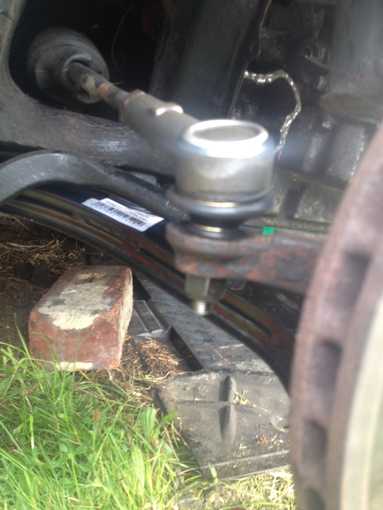

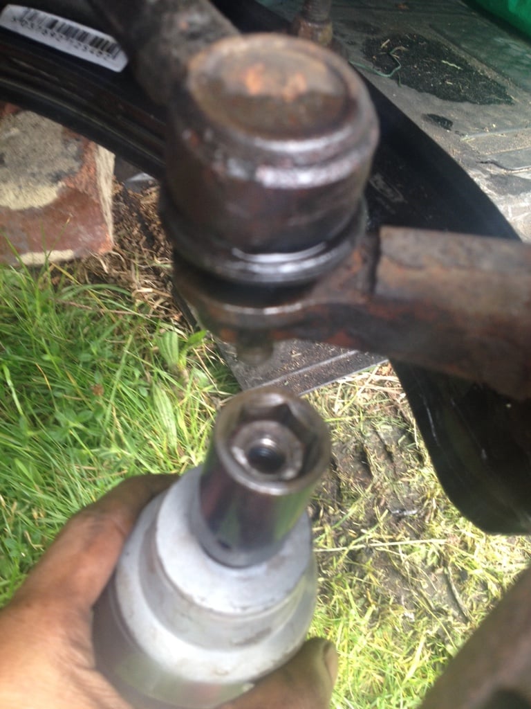

Brand new track rod ends fitted today paid 7pounds each
Tools needed for this job is 19mm spanner for the rod nut, and 17mm spanner for the rod end, take the wheel off on safety jacks keep wheels straight, now take the 19mm spanner and loosen the nut
so nuts off and 17mm off the rod, it should put out the hub carrier and then screw the rod until it's off but make sure the 19mm nut is marked and should move from where it was as the wheel will be to much off left or right. Now time to fit the new track rod
compare both and u can see Diffrent
fitting it back in screw the rod end then tighten then 17mm on the bottom rod nut, now u can tighten the 19mm nut now it's all done

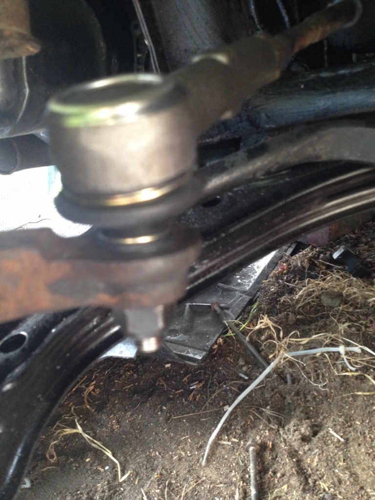

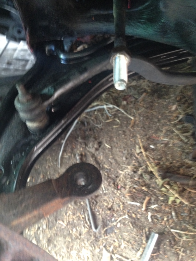

this is passenger side sorted![]()
Moving on the drivers side now

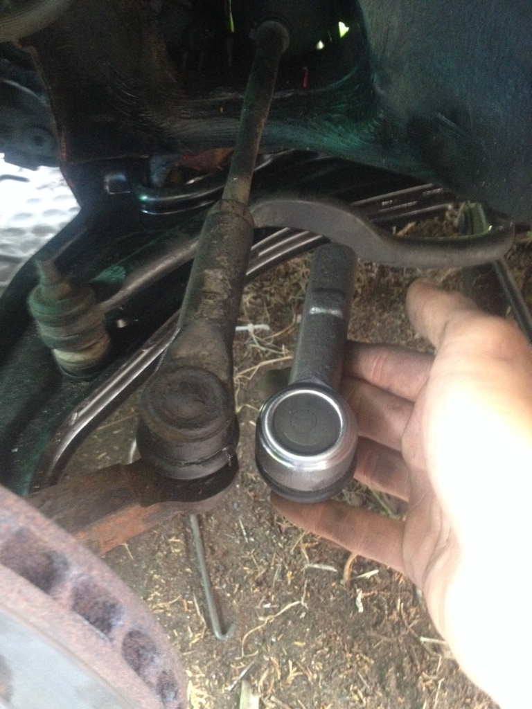

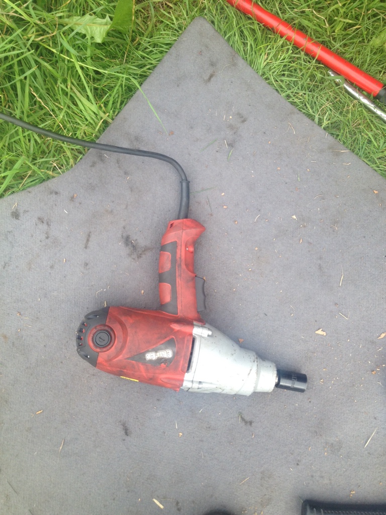

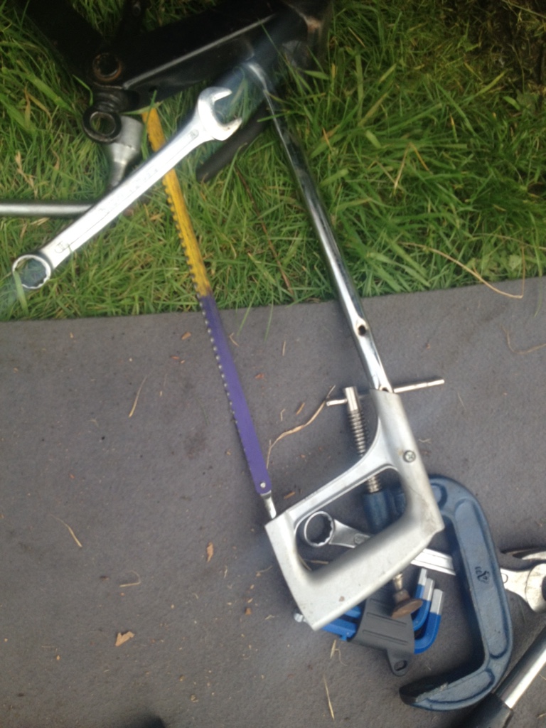

Same again wheel off loosen the 19mm nut first but make sure the nut is not too much loose so when u come to fitting it back in its nice and straight. Now this is the bit most ppl get stuck on the drivers rod end 17mm keeps spinning, u can try jacks, mole grips,or a hack saw, the answer is nothing will work and u be wasting time, since I have back up tools it took me 5 mins to pull this wrench out and took it off without a problem,![]()
when it was off I quick hammer tap on the rod and screwed it out and on the new rod end screw in and on the 17mm nut the tighten up 19m nut and that's all sorted
nice and tight
wheel back on and no play at all coz I have brand new wish bones and track rod ends,![]()
comparing new vs old not sure Diffrent are they geniune @pollyp any problems with theses,![]()
I haven't done a blog yet but soon have a build no ones done, thanks for commentLoving your project mate at this rate you will have rebuilt the whole car into a brand new one lol!
Haven't checked but have you a build blog if not these updates deserve one??
Keep the good work up!
