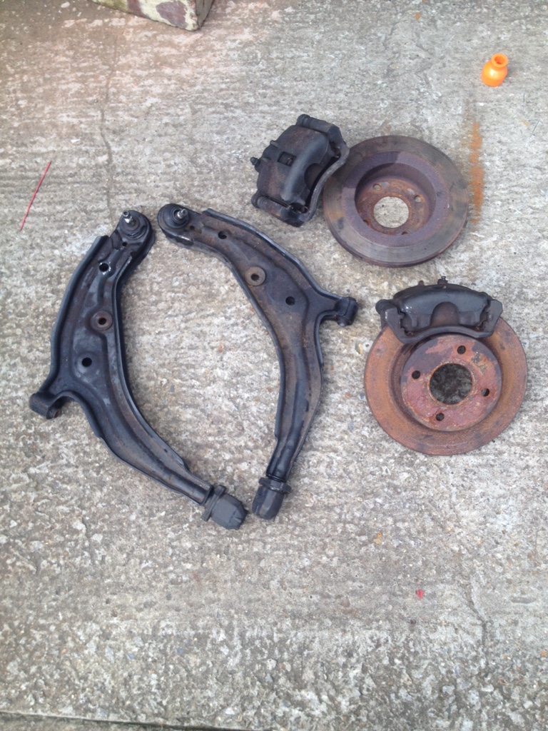

You don't have any pics of spot welds do? And how many bolts/spot welds are there?
There were a lot more than I anticipated, 24 spot welds on each side.

Yeh I seen what u mean Polly so was mines geniune on stock wishbones coz there is Diffrent in looks but same shape, weight wise there about same, your right it's a cheap weld job on the motor factors one, so you added more weld and it's ok now ? Can I mig weld it,doesn't matter what supplier they're from, the common cheap & fast design & weld quality of where the arm meets the rear pin is still fatally flawed for the potential stress of these brakes to break them.
technically they're fine for original NA spec but once you upgrade to GTIR with sticky tyres on fast tracks especially with turbo then it's no surprise the weak flawed welds eventually show up.
I've now reinforced mine with more welds all around that pin to reduce any stress points
