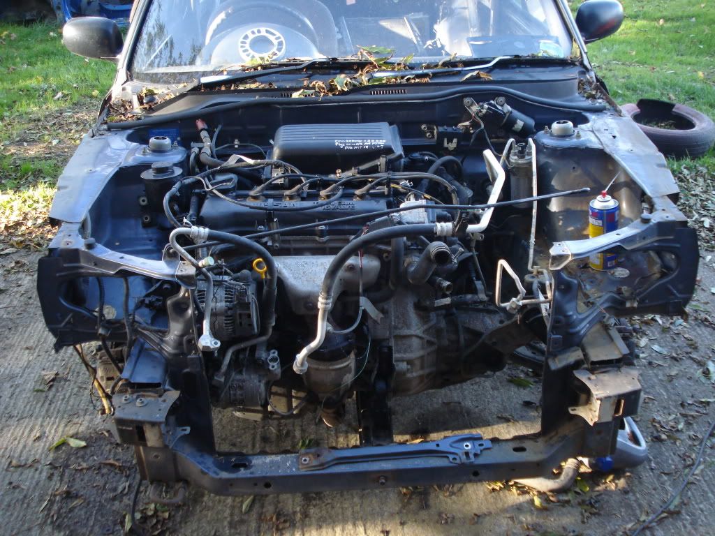

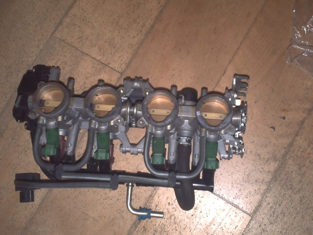

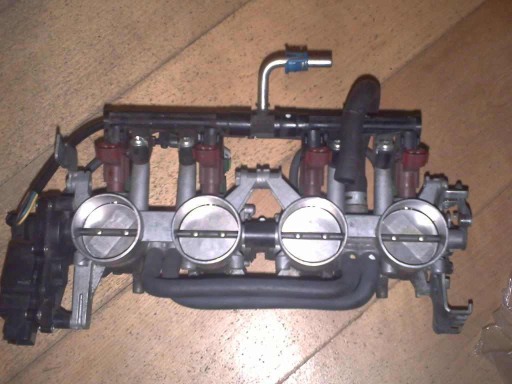

ive a 1.0 engine in the car (standard) and a 1.4 on the ground wil go for bike carbs, proper induction jomo made mani,straight through to a 2.5 inch tip get an ecu and properly cage and weld the car and use 2 subaru seats to start with (the ga16 is the same mount as the ga14if not correct me) so i can build a ga16 when running the ga14 and get its peak power and possibel go sr20 when i have alot more experience

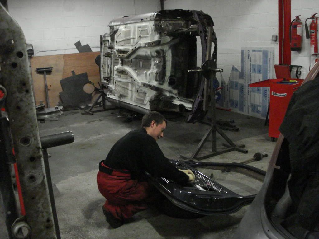

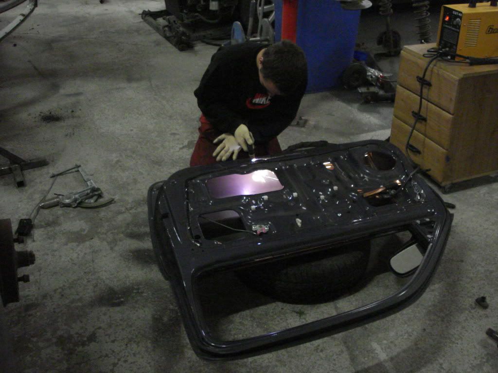

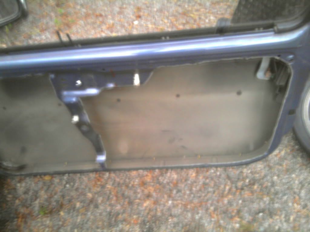

small update , got the plasma cutter out and took a door off the k11 :p was 24 kg got it down to 14 (Y)
how heavy is the glass? it wil be replaced with plexi (Y) but im curious :p and 1 strut is my idea too :suspect: , plasma cutter is the bosses :wasntme: il have a few good pics up asap and a view of the work shop (Y)
not sure, i cut all the way around and it went POP as i was cutting the last bit of sealer lol
and i just used a sheet of flat perspex :grinning:
once its lighter (Y)
glass is heavy :laugh:
only glass that will be left is the windscreen (its a rule :down: )
I ment to say perspex ha

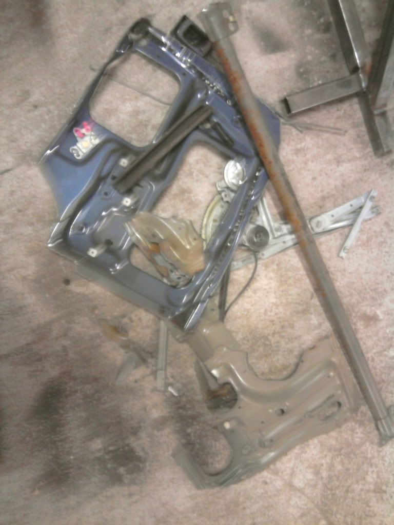

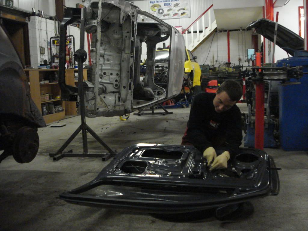

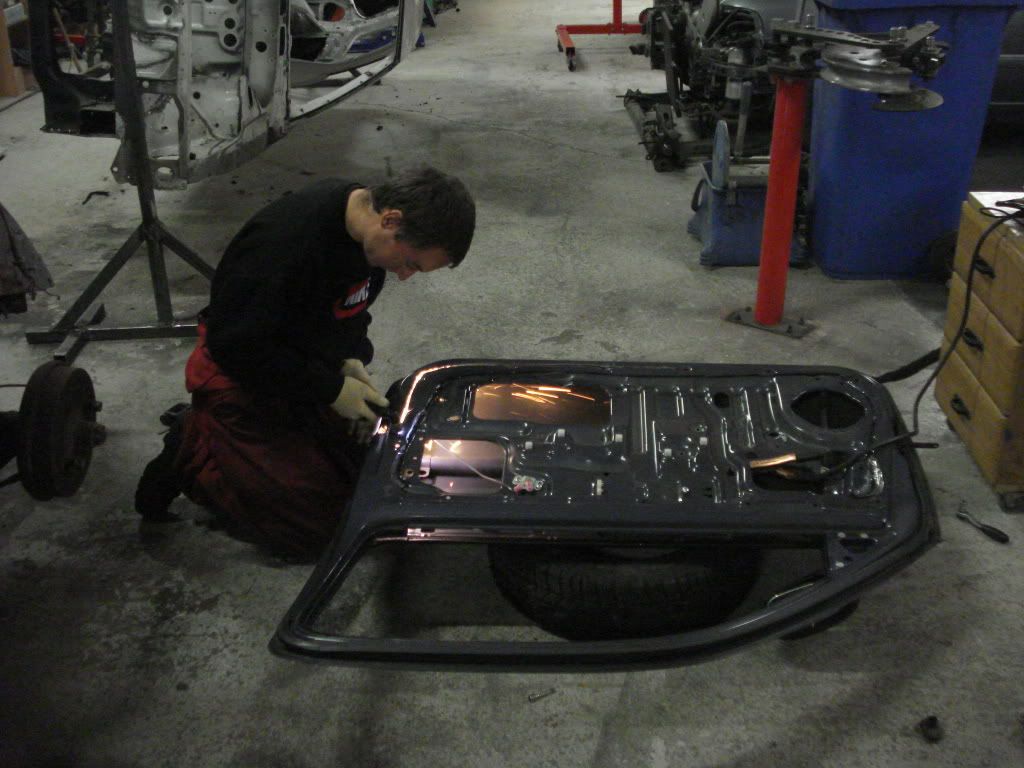

heres a few pics of the door being made lighter :p ,,and an insight into the jomo engineering workshop the cars are parked behind me in a position called parking jomo style (Y) :laugh:
and the plasma cutter :D luv it ha
luv this pic :p

inside skin behind the rear door cards drill holes where i cal :p the underseal is roughly 10 kg (unsure) bonnet wil get the grinder soon and all wiring gone and few other things :p

Ooh nice one (Y)
Are they a direct fit to the CG? Or are they for another engine and your gonna adapt it to fit?
were from somewhere in the UK :p
they will be a make fit :grinning:
engine is a GA mate :blues:
the rest of the build is slow because of the lovely constant rain :down:

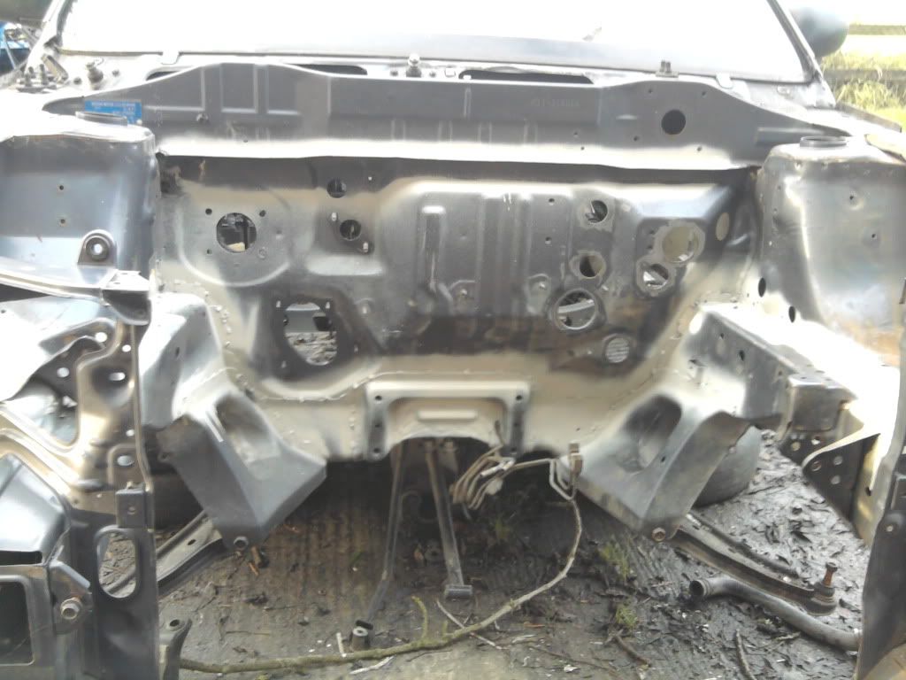

engine was in to make mounts ,left and right is fitting jus need weather to finish it fwn

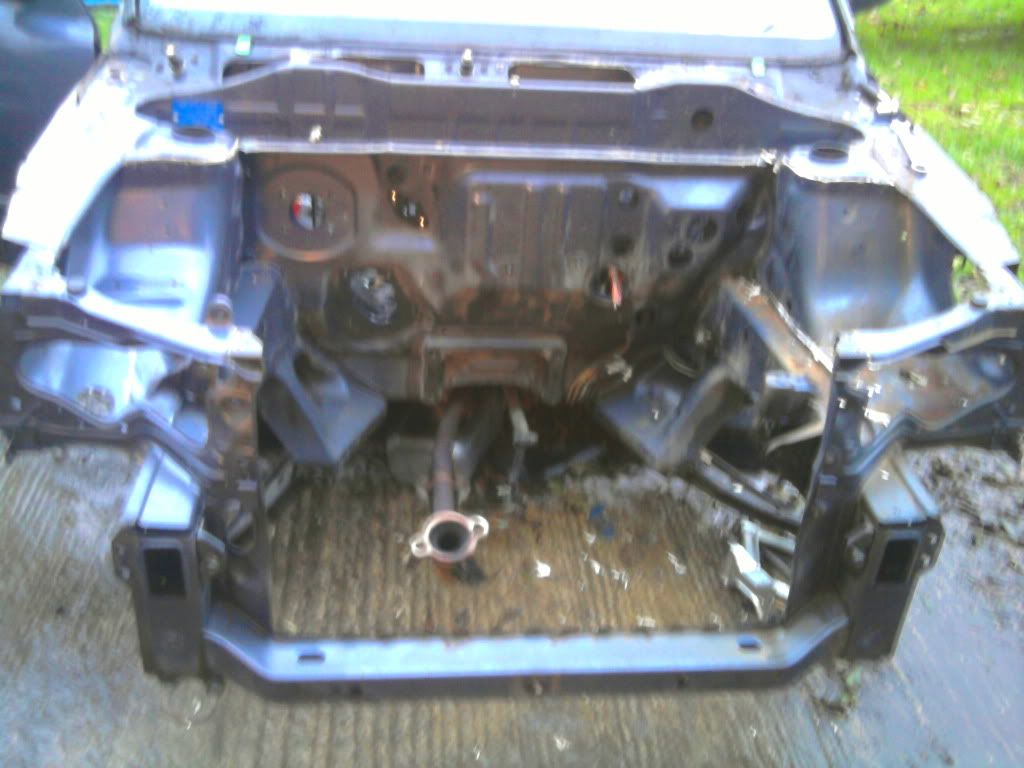

the cold out :laugh: some seams cleaned and waiting on some work to be done for my inlet mani..engine bay is welded up heres a pic after its etch primed
One question about the front bumper : the spots are factory or handmade (drill + spots fitted) ?
