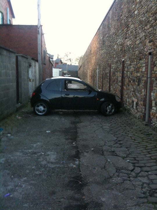

I saw that photo and immediately thought of this:
It wasnt far off that, the neighbours round there were all useless at parking and made complaints that my mates car was blocking the ally so I thought id take the p*$$ lol left it parked like that for the afternoon :)
