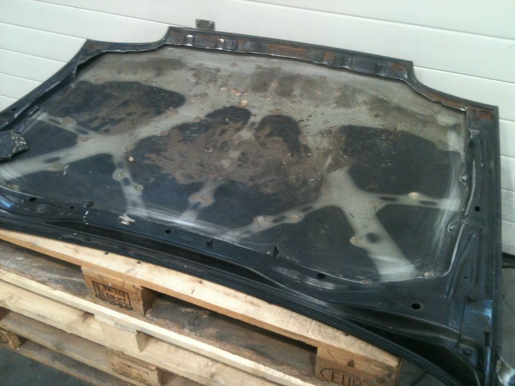

-We found the best and least painstaking method of stripping the sound deadening to be lightly heating it with a heat gun and using a knife to carve it off! This proved very effective.
-We lightened the Bonnet and boot and progressed to spray up some of the rusty bonnet with some matt black paint we had already!
The finish is ok for now but still needs a few ore coats of paint!
