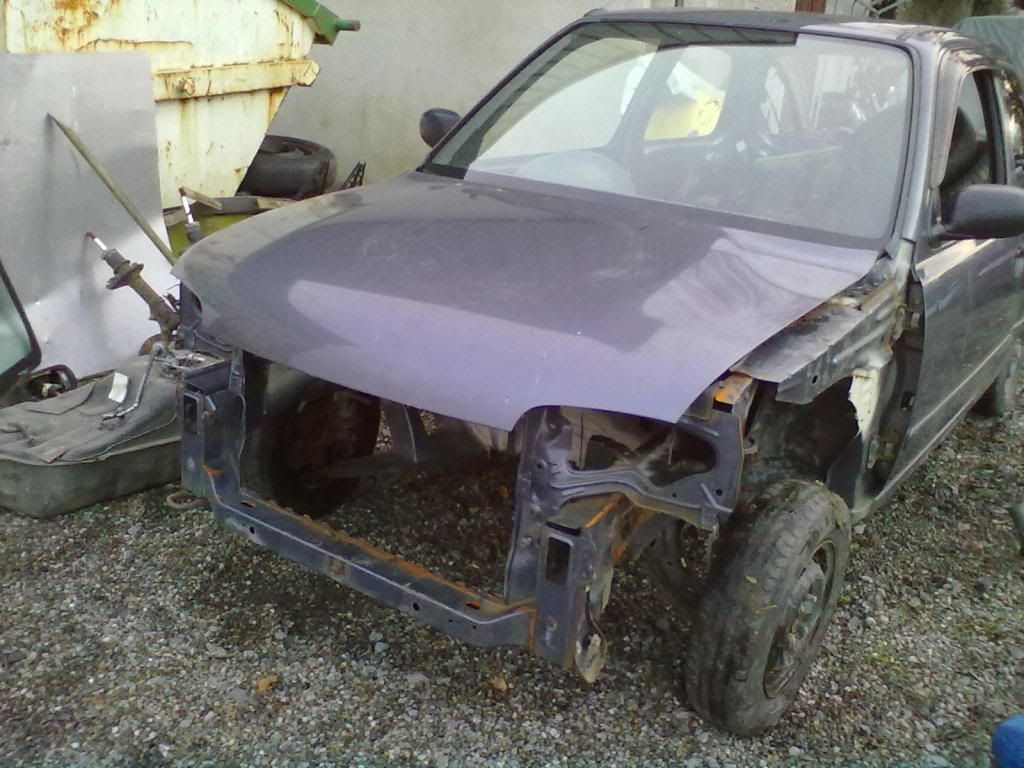

track micra :D
thanks mate :),,its on a slight pause as the frost and snow has arrived trying to get a few bits done with the road car for its nct before i concentrate on the track car,, mainly want it welded :p

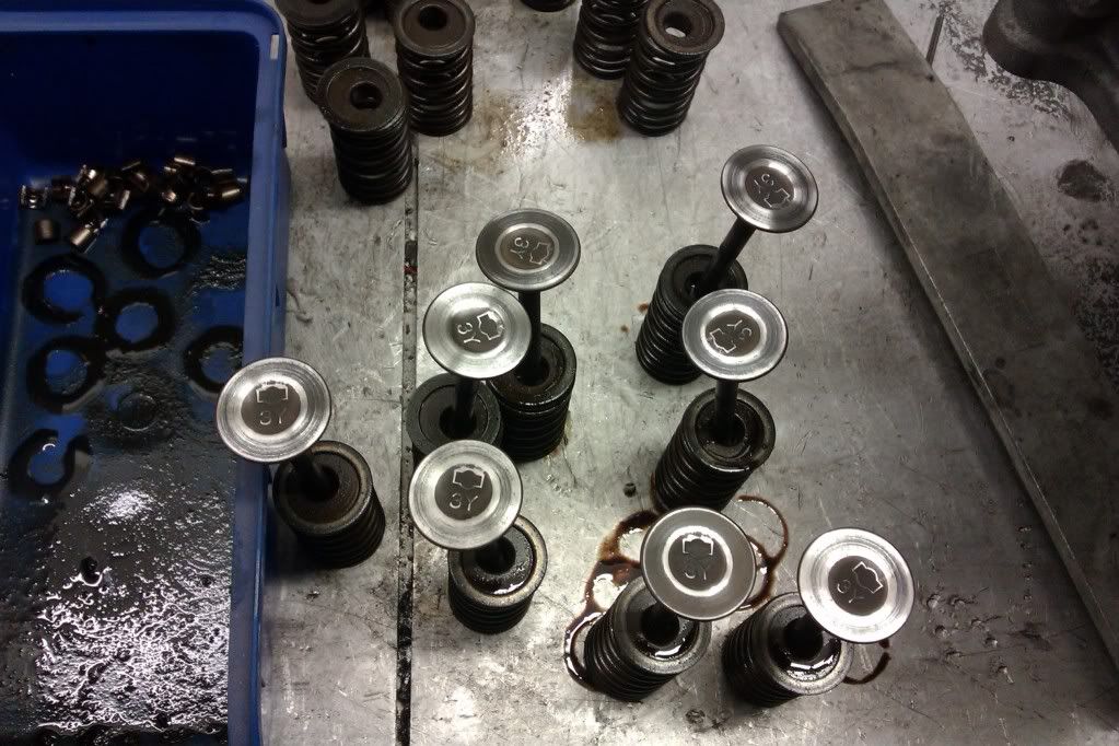

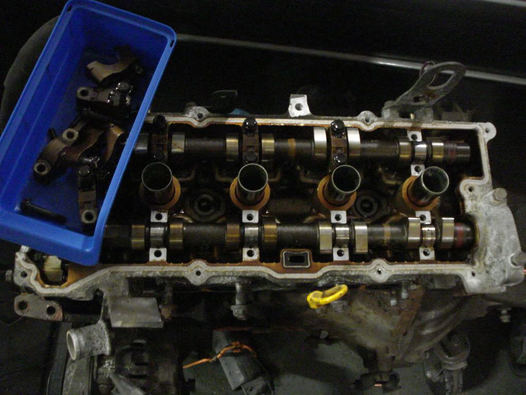

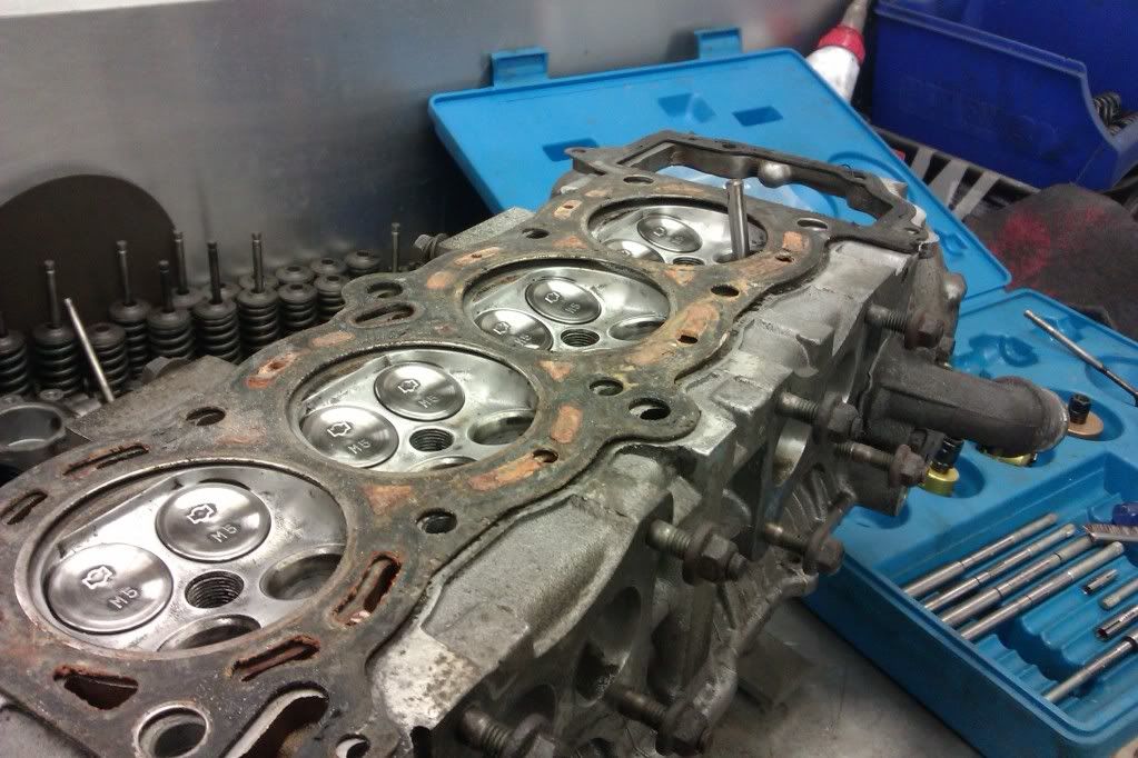

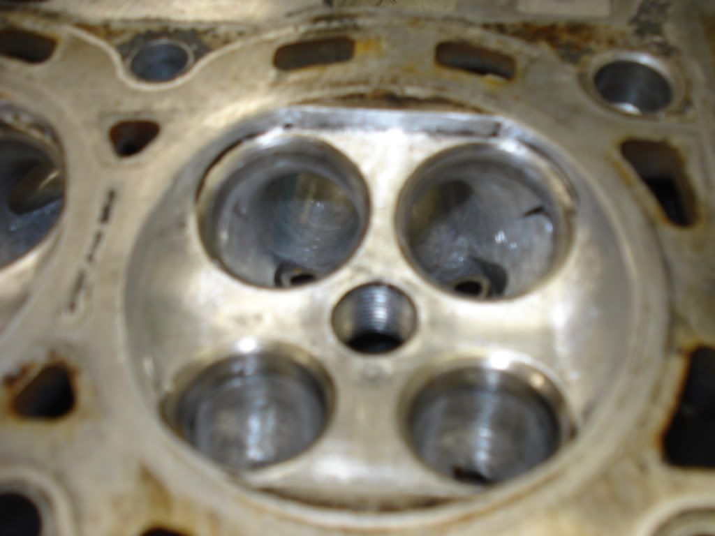

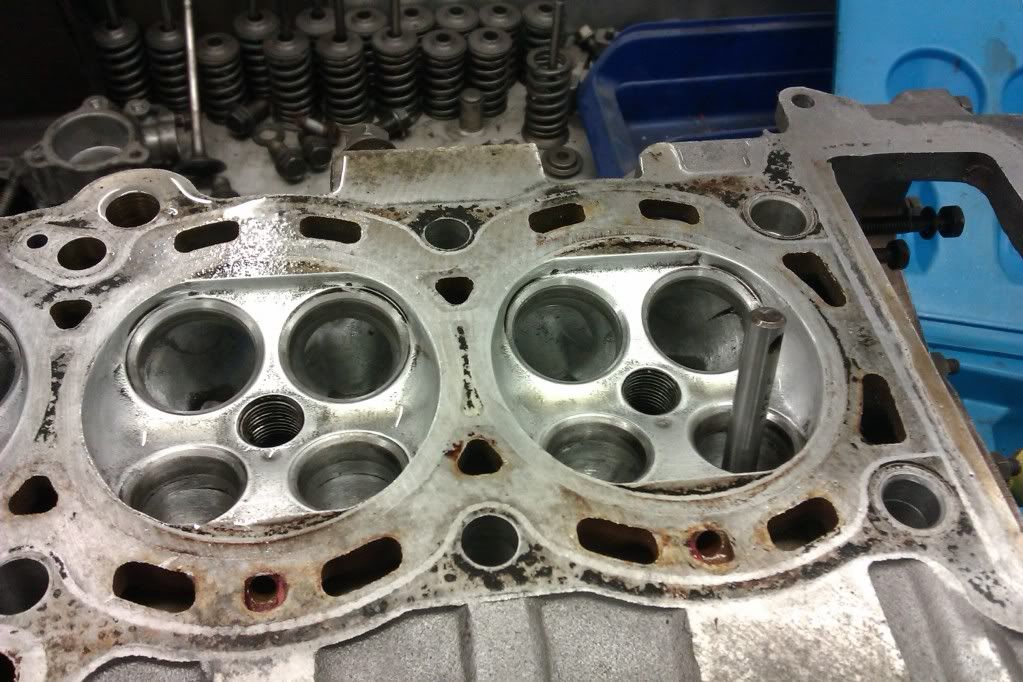

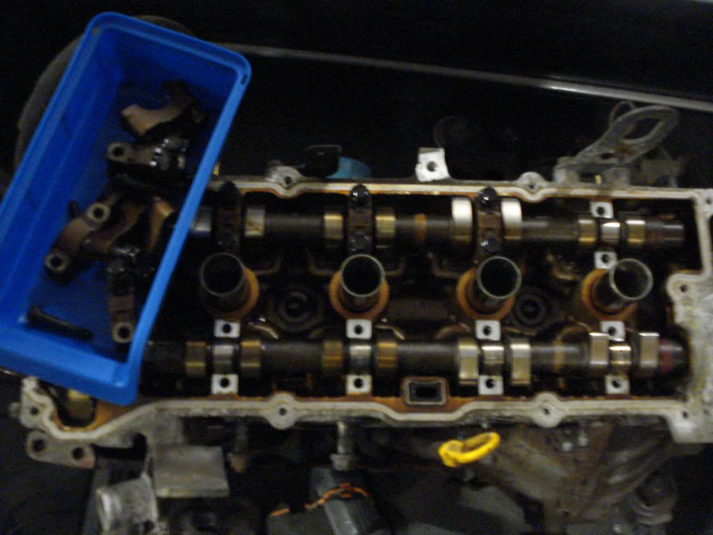

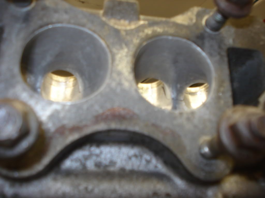

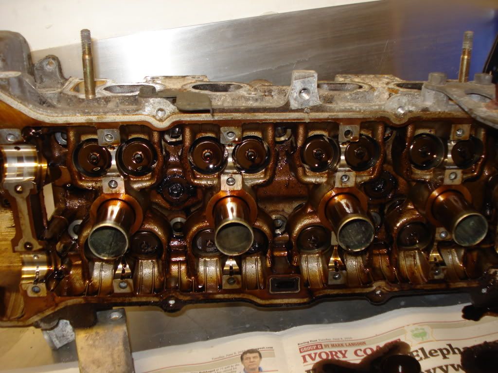

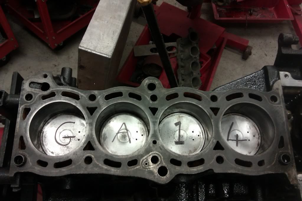

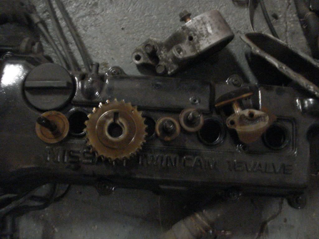

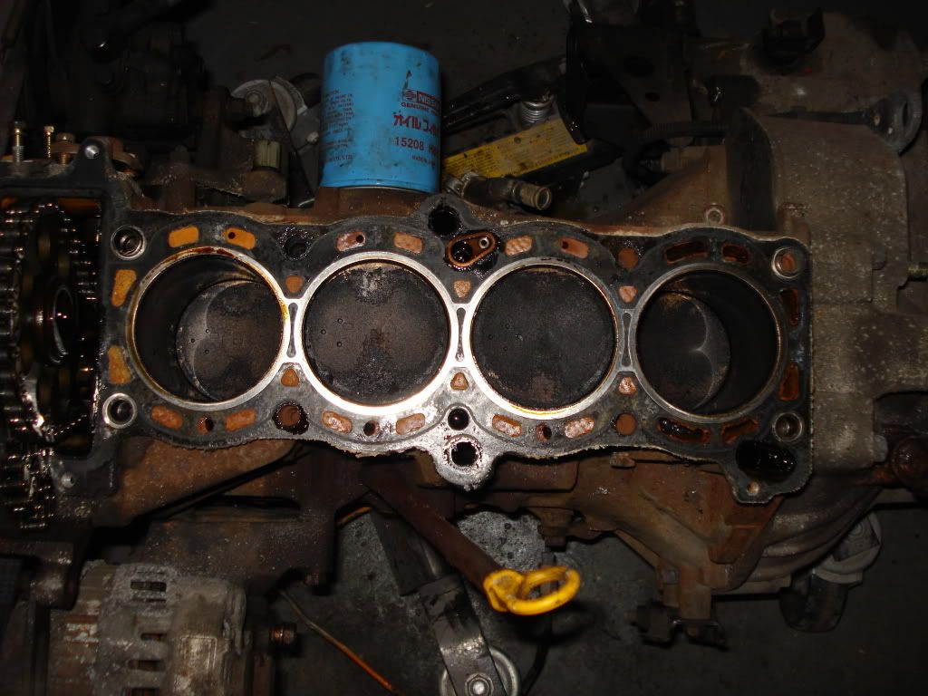

started some head work well got it stripped :p

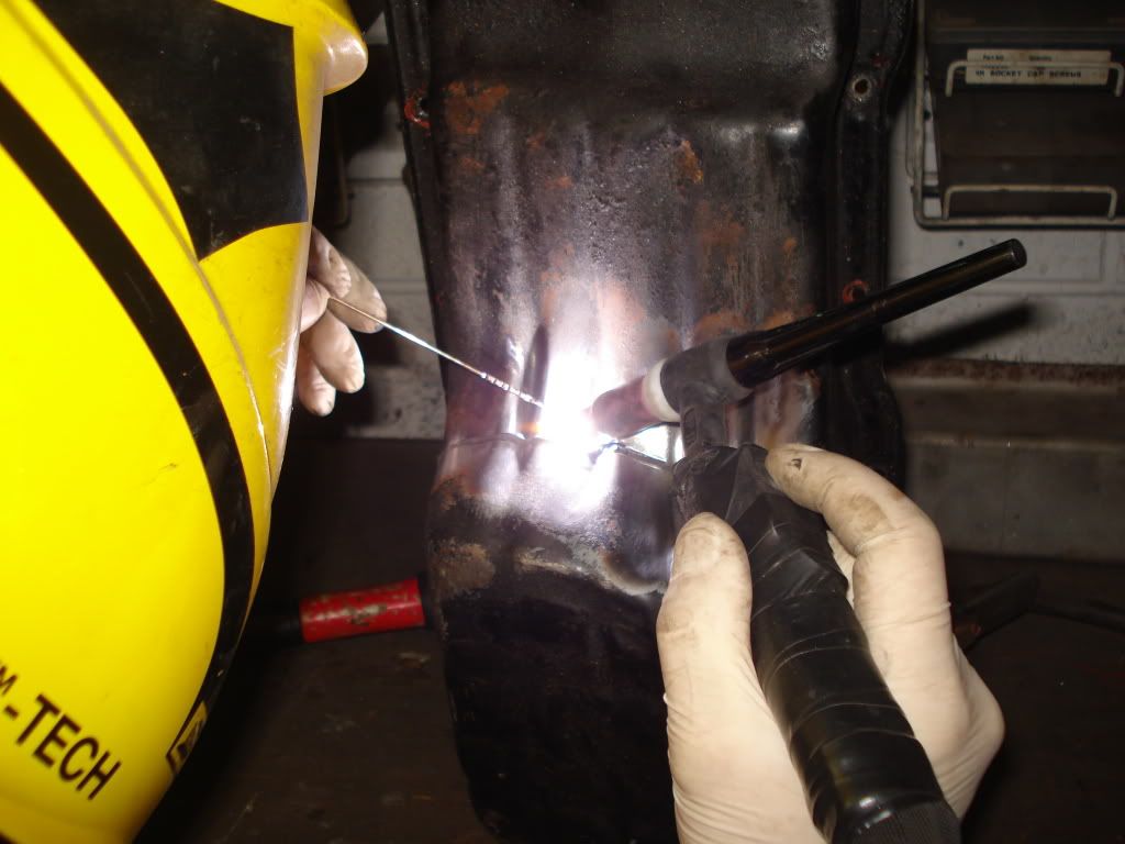

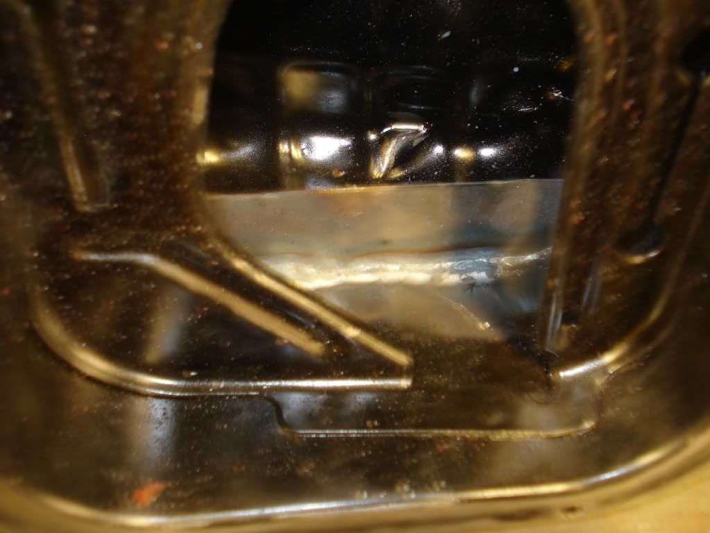

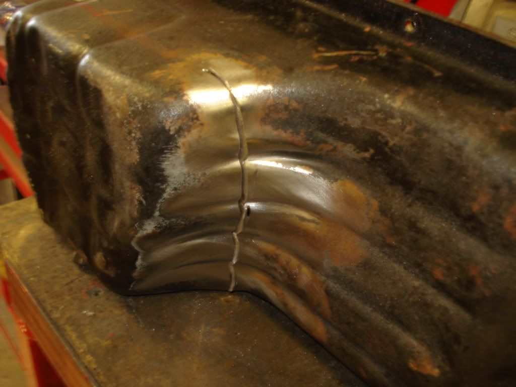

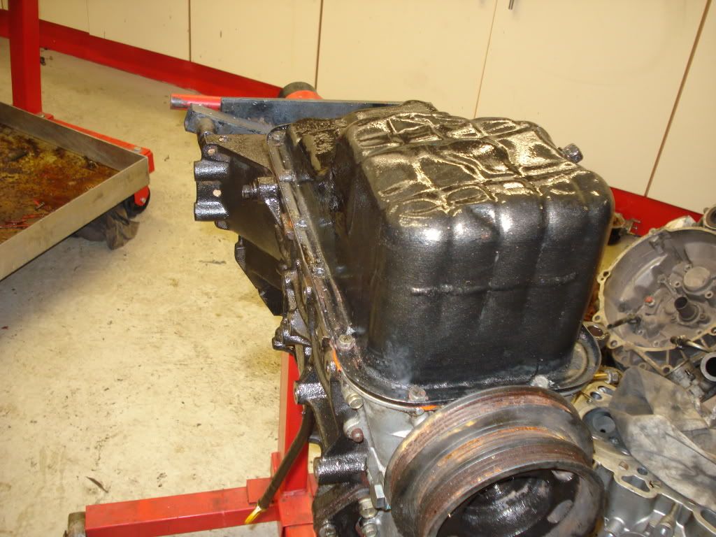

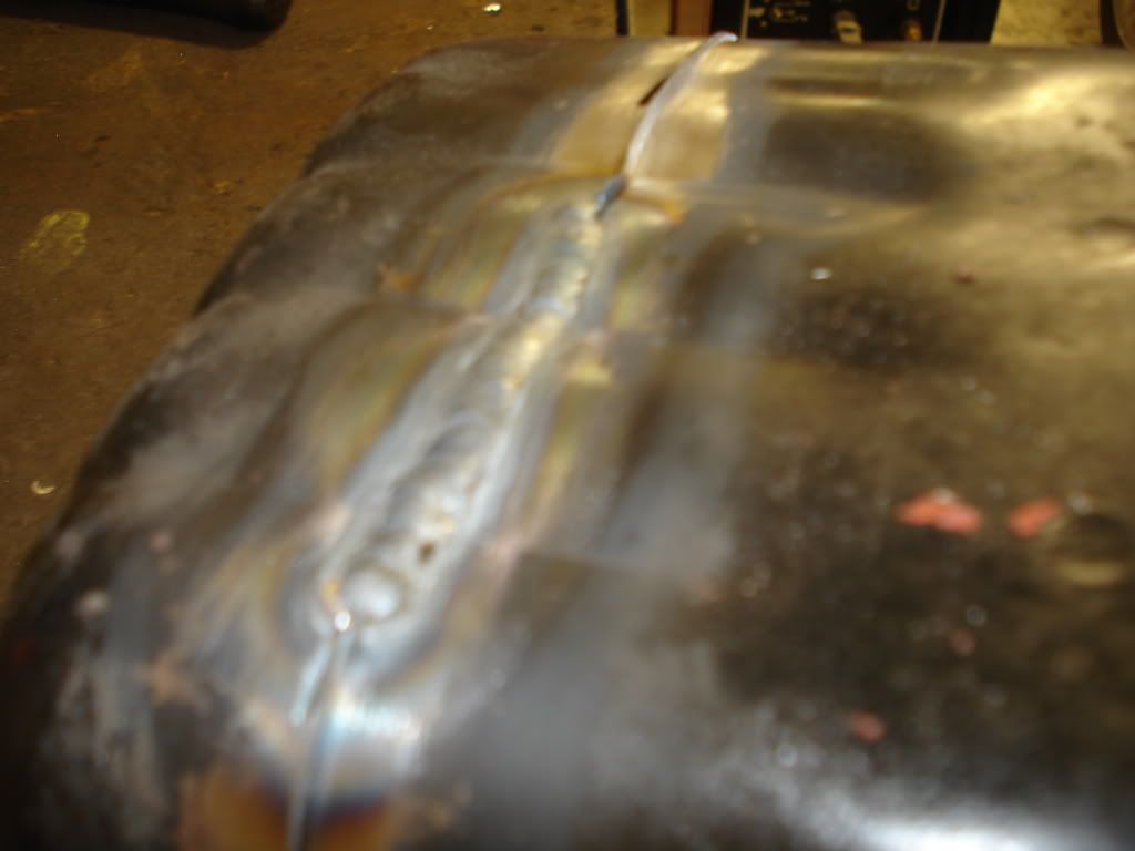

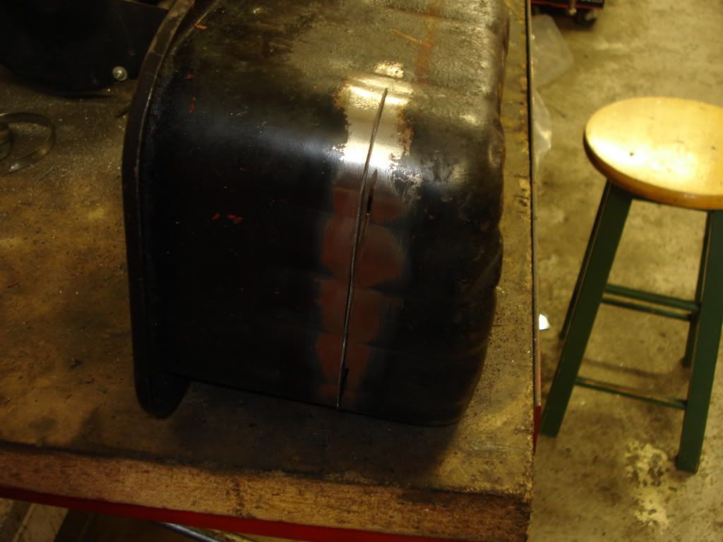

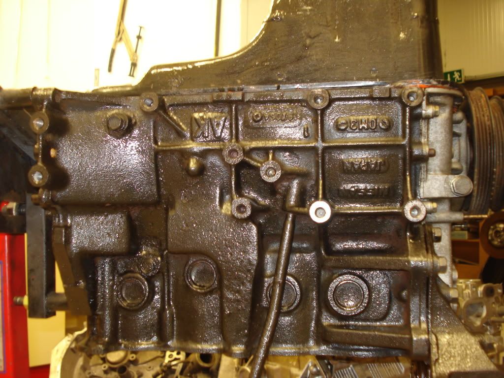

2 small baffles in the sump :)

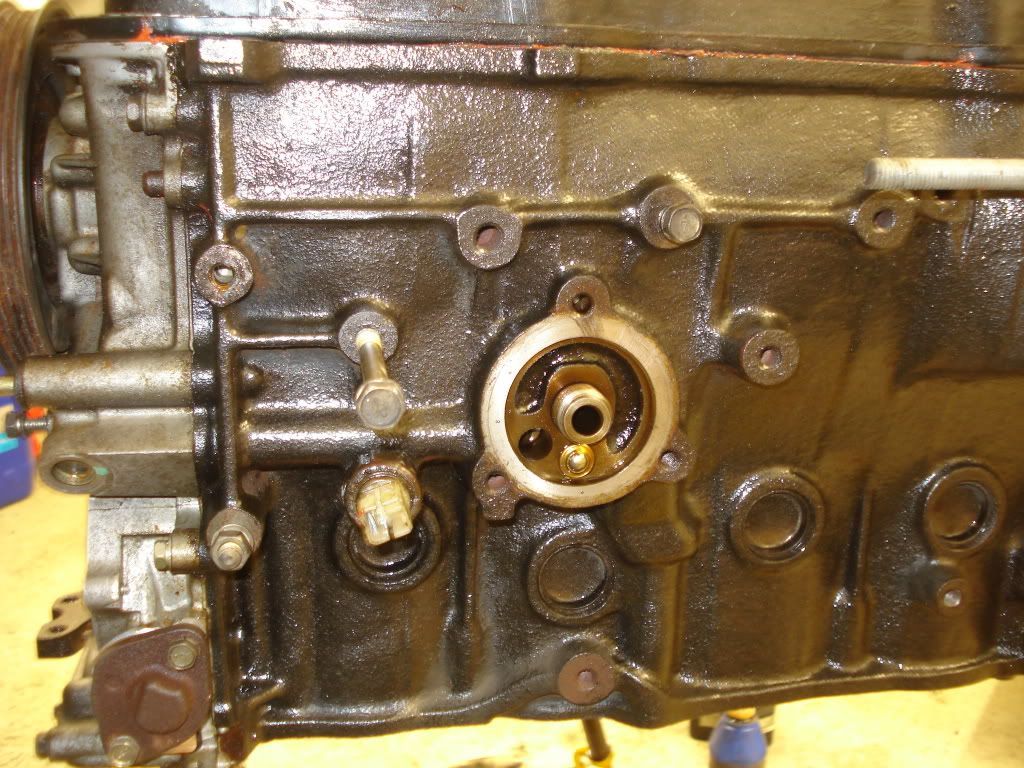

and the block and sump all painted up :)

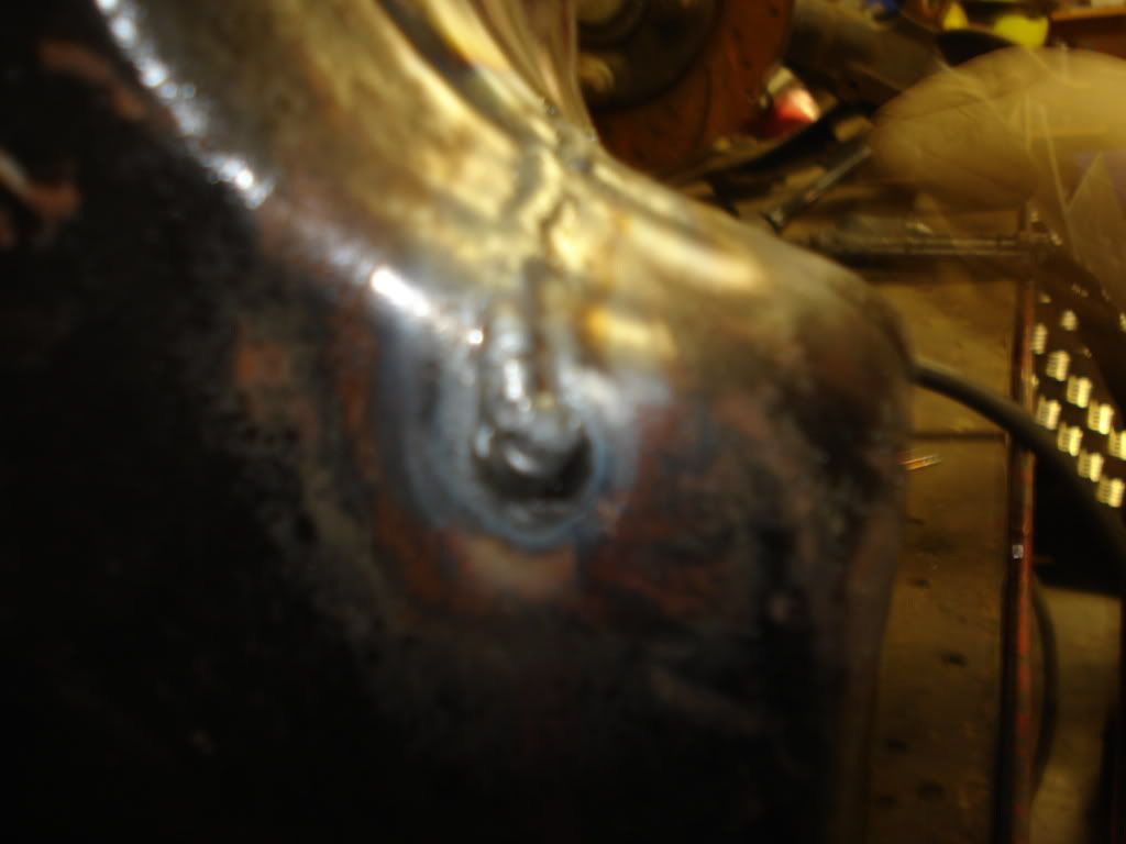

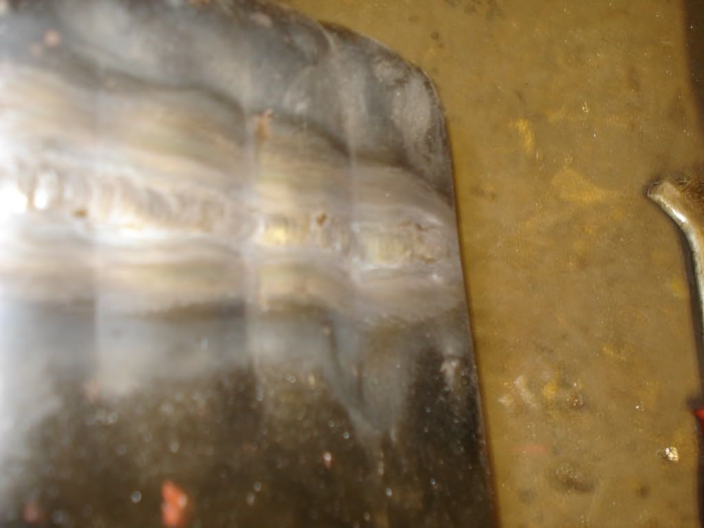

thats the bosses welding :p

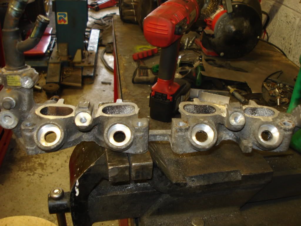

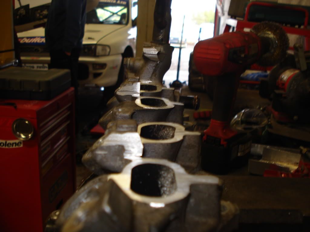

and the inlet mani all down to size and ready for itb's :D

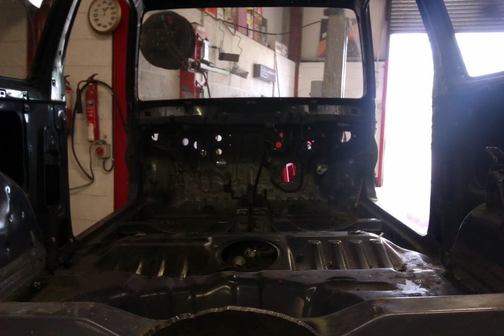

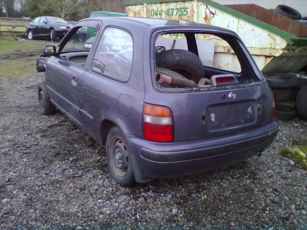

wheres the back window gone? is that for weight saving? lol

il be going plexi glass :p

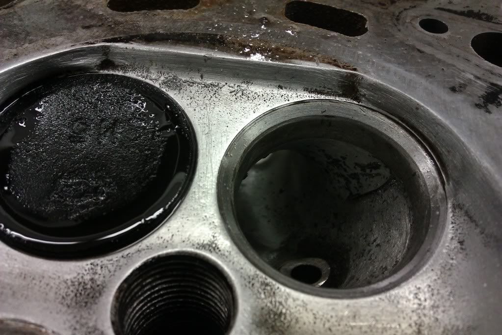

the GA is being rebuilt soon i got valve seals just need to cut the valve seats and get a head gasket ,then save for an ecu :p

two baffles coming in either side about 35mm and angled slightly up so when cornering hard it keeps oil down near the pick up pipe to prevent oil starvation :)

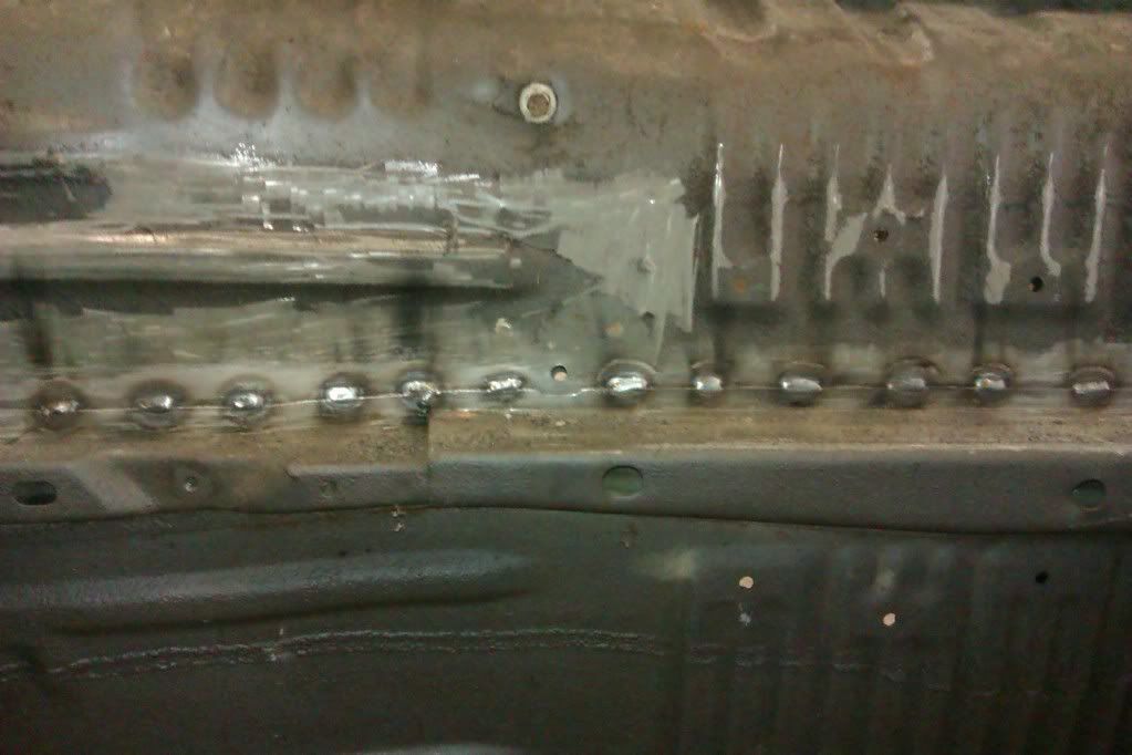

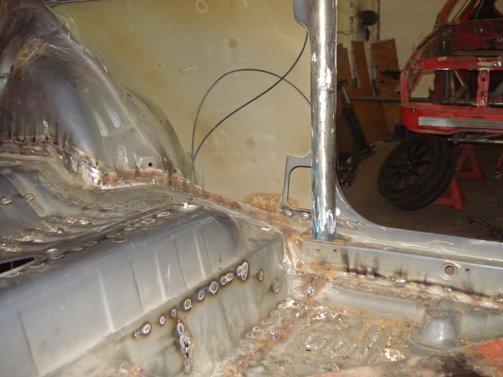

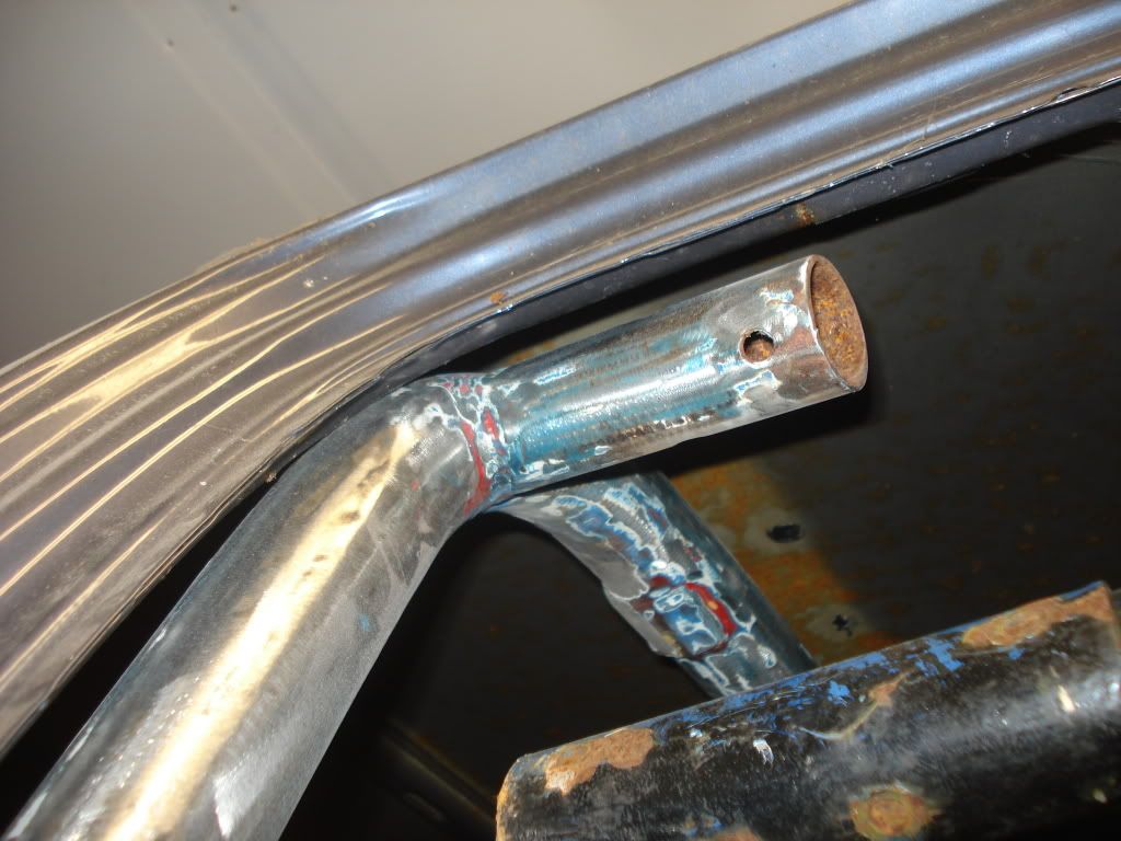

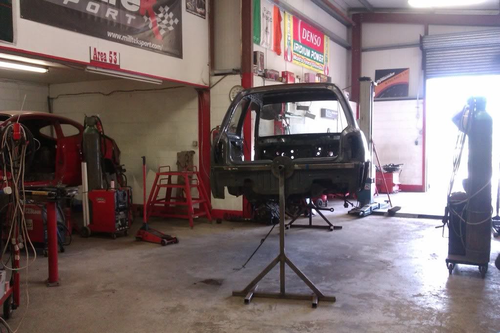

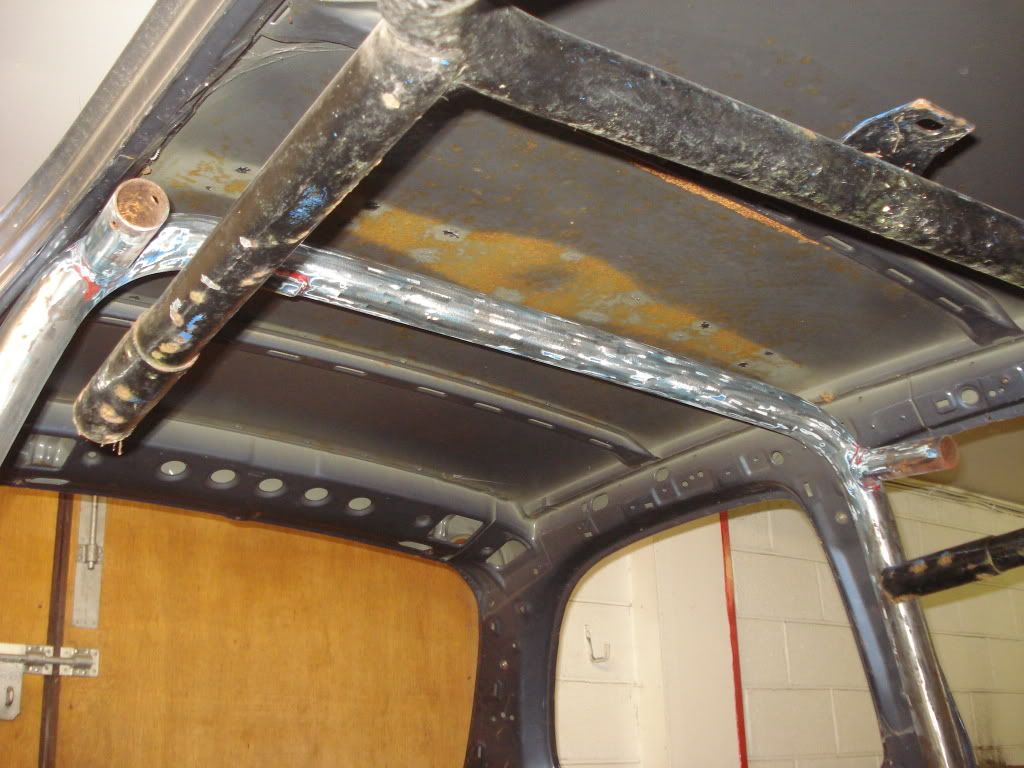

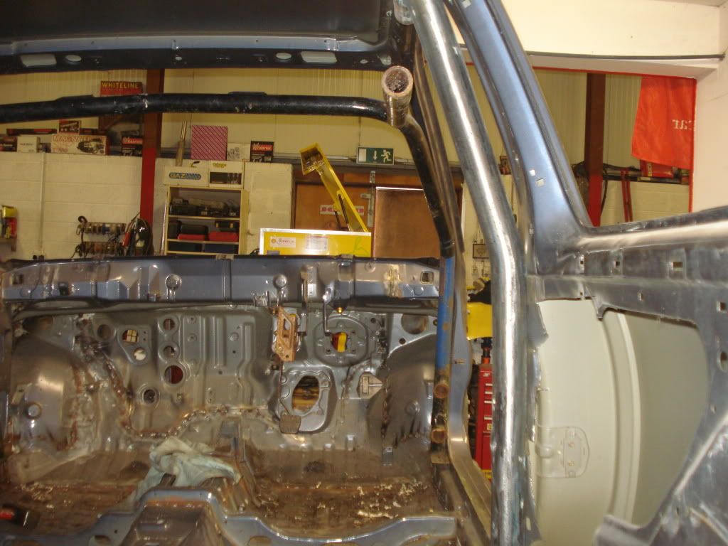

car is in for seam welding and a cage :)

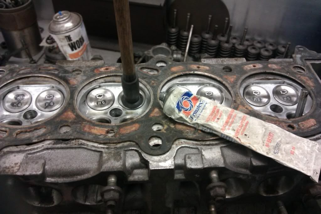

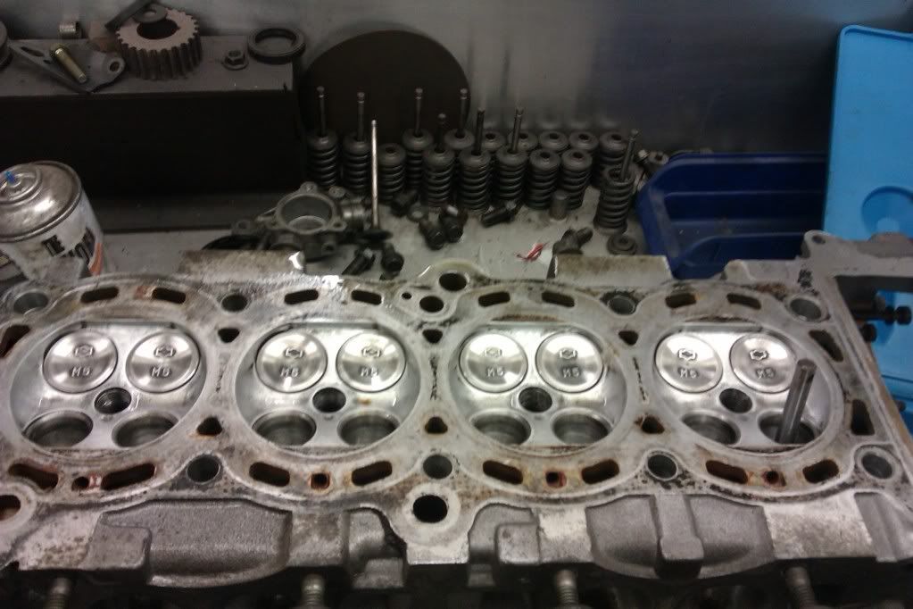

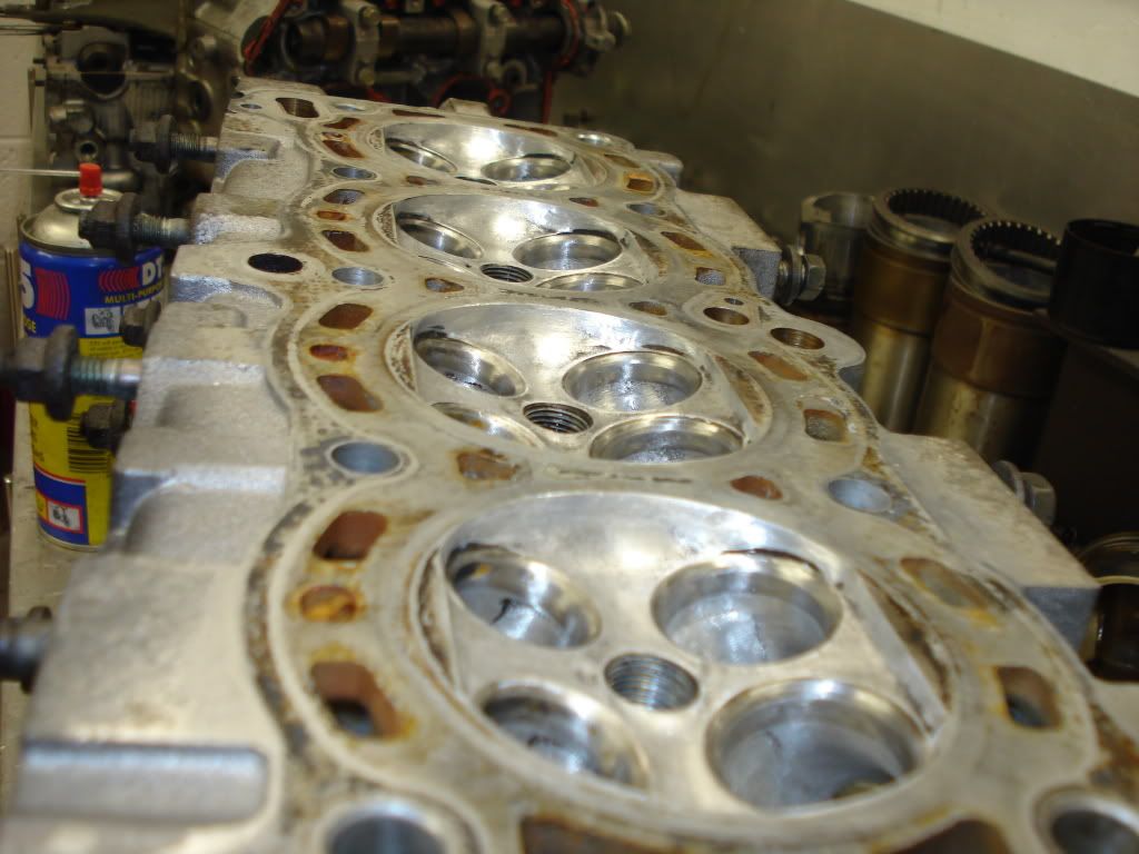

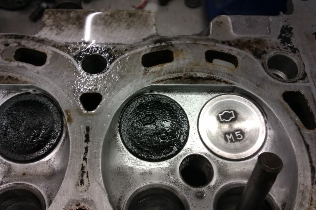

head work almost done except for valve stem seals
photos can talk there not in order but you get the idea :)

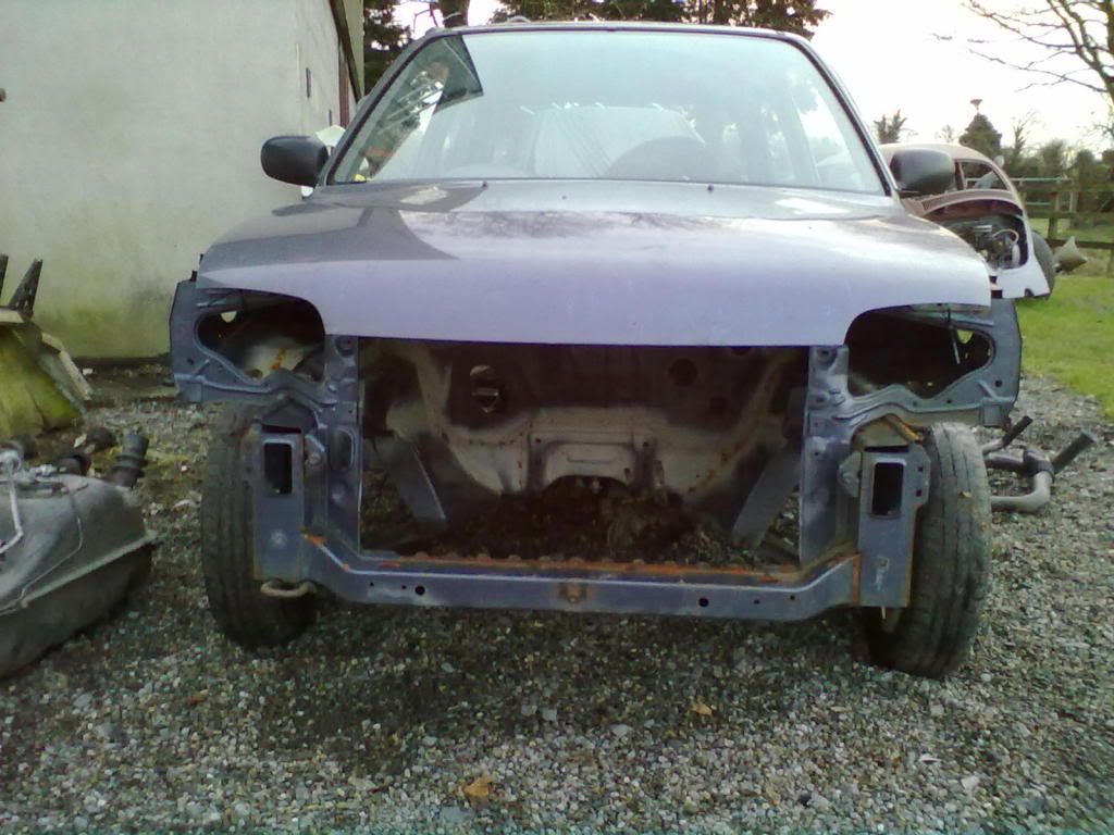

anyone want to guess the weight of the micra shell including doors bootlid and bonnet :) i have the exact weight :)
Still welding seams and doing some rust repair , has anyone on here done any wishbone mods too add castor ? and picking places to gut more weight out of the shell 750 odd kg target with the driver :)
