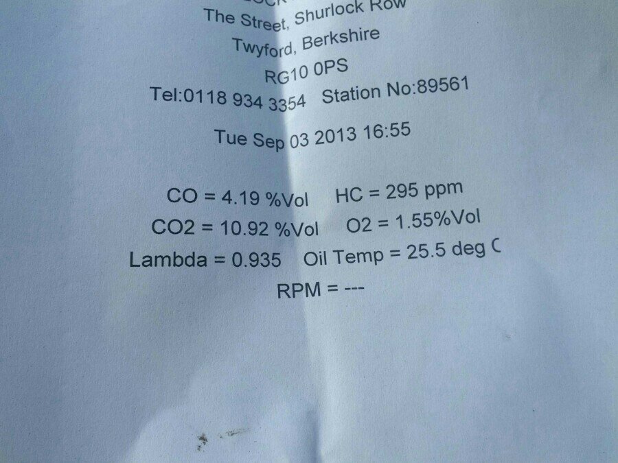

Are they top feed? Let's check25.5 degrees is too cold for a good reading, get it REALLY hot, say 90 degrees and it'll probably come down a smidge. Oversized injectors? Maybe it's worth borrowing the ones from your daily?

The cat is working fine. It's overfuelling"Fast Idle Test
Engine speed 2500 - 3000 rpm
CO level = 0.18% (min = n/a, max = 0.20)
HC level = 13ppm (min = n/a, max = 200)
Lambda = 1.00 (min = 0.97, max = 1.03)
Natural Idle Test
Engine speed 450 - 1500 rpm
CO level = 0.05% (min = n/a, max = 0.30)"

Good luck. Message me if you need an "MOT"Sooooo yeah ed... I didn't see that post I was off changing the lambda, I questioned it a while back and forgot and then maz /Scott told me to swap it out,,, well done ed and well done Scott.. Here is a glory photo... View attachment 25277
Well now to seal up the exhaust to get the HCarbons down and away we go. Mot tomorrow morning.

And @pollyp I just realised you told me to get data scan out and check the lambda... I didn't. If I had the issue would of been solved earlier. Sorry mate

ur O2 is really lazy n worn
it should be flicking bout twice per sec rather than once a sec
here's an old datalog but notice during closed-loop 2-3k rpm cruise my O2 oscillates and responds really fast
