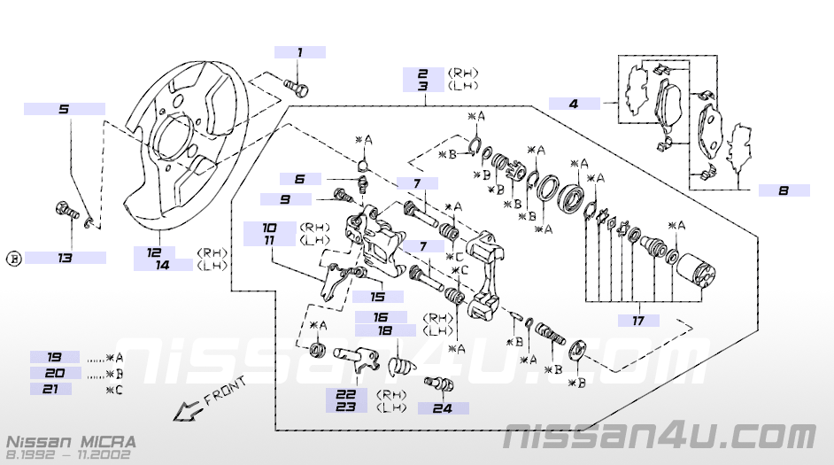

Wtf just bloody looked at the Haynes I am missing a circlip which is supposed to keep the keyplate, push rod and plunger. @pollyp do you have these. Not the circlip for the spring holder and spring.
This any help mate
I have no idea that's the issue. I just found a washer which fits the diameter on the spindal. Which was in the brake tray from the rebuild... Pissssss.
Now where the **** is this curclip and where the feck is it supposed to latch on? Hdhdnsidibehhskfjmfmsnesh gahhhrrr
Right I have looked at it all and I feel the spring holder and top circlip should do the job of the bottom c clip. Gunna just Wang it on and try again done it several times today and way. On more won't hurt ... Man I am getting good at this rear caliper assembly... If I put all the parts in. Took me about 2 days the first time lol
The washer holds below the spring returning the screw and making sure the score does not rotate when pushing the piston out by locking it to the key plate

chris this washer is what the coil spring pushes down on to retract the central shaft when the swingarm shaft is at "rest".
cos it wasn't there previously, the central shaft was simply allowed to extend one-way but couldn't retract back in cos the coil spring had nothing to push against so it did nothing.
with that washer back on, it should be able to retract back in.
and don't forget to align the 2 holes of that silver washer to the 2 notches in the end of the caliper bore cos that prevents the central shaft from spinning while it moves in/out.
Haha yeah I figured it out in the end ta Paul... The idiot finally got it over here pleb lol. Tried to do the suspense thing but you got in there lol. I have to admit with the correct tools and experience you can whip this apart in like 5 mins.

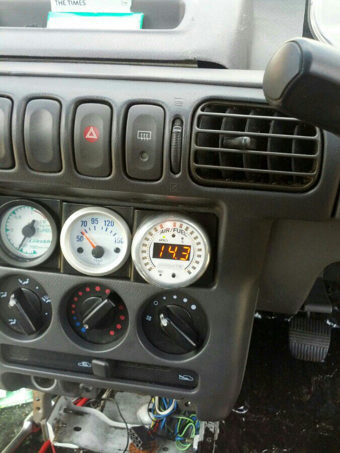

I forgot to replace the top two nuts on the intake Mani so she was loosing air on the way in did those up and now I have AFR 11-13 actually. Will that pass not :/
