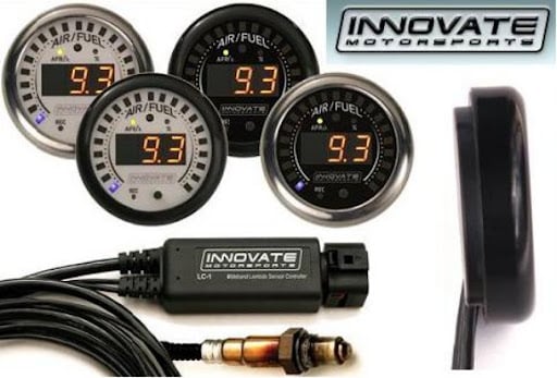

prob leave the tig weld out for now cos i should spend that amount towards a wideband sensor instead. a mate said he once had a complete SS system custom made by a garage for bout £250-300 so prob the best option for a one off.
