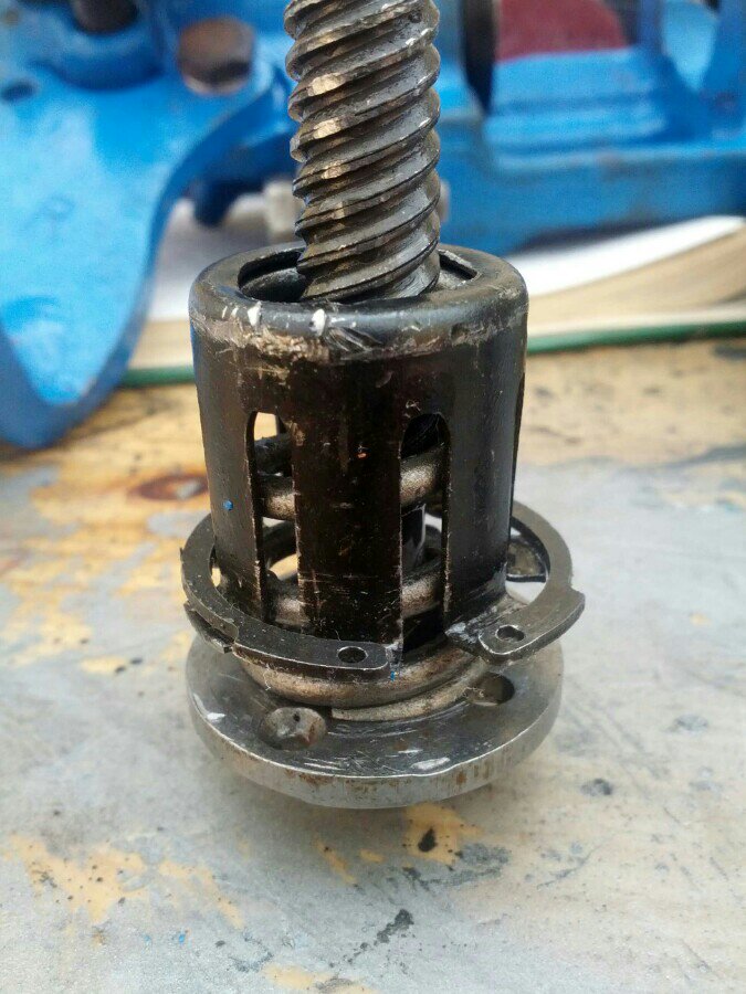

Ta mate just took the lot apart and took some lube out. Still.. Having issues gah
Going to take it all out and see if its all going in right will post pics
Would the spring not being sprung enough effect it? Possibly stretch it out?
