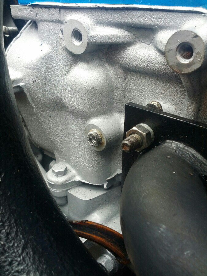

Yeah we used sealent on the fitting to the sump we had no choice. It doesn't seem to be spitting oil in the elbow to manifold where the faces are no doubt not meeting correctly/true. Ta mate yeah I will get there just like you always dohang in there chris. know how you feel, I've been through those emotions several times before when things go wrong but you just gotta keep on swimming forwards and diagnose the issue logically.

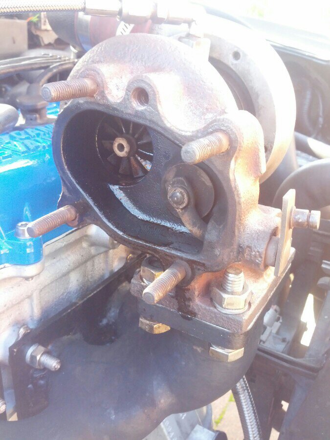

started clear from stone cold and then goes steamy then misty smokey plus leaking oil behind the turbine bit

so I'd suggest as guys said:
unplug the oil return,point into a container and check oil is flowing freely out the turbo (careful u don't run too low on oil), does it stop smoking while running a short while?
remove elbow n check for any oily stains in the turbine,
check the compressor outlet ain't leaking oily mist into the inlet,
open the butterfly throttle and check the inlet mani isn't flooded with oil from the PCV (slight oily dampness is norm),
remove the turbo mani and peak into the exhaust ports for any major oil stain drooling down the stems from worn stem seals,
fit a stock manifold and check if it stops smoking,
if all those are fine then the turbo prob needs a rebuild as a last resort

Yeah I feared the removal of things would be a good way to check. Can I not unbolt the turbo from the manifold and move aside to check the engine is running fine? That would be also good go to check if the turbo is leaking oil no?
