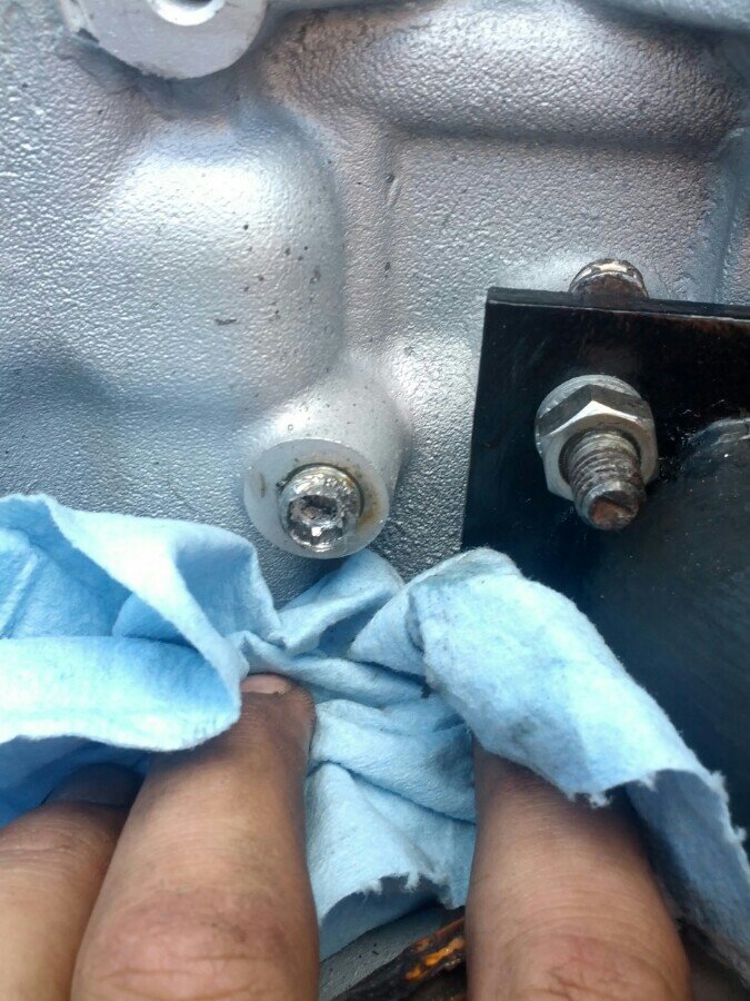

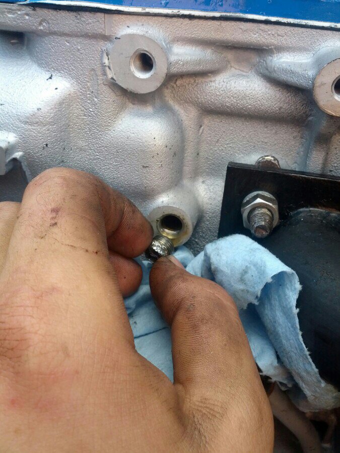

I think this means you got it out?Senior impact driver has bestowed the godly removal of grub screw. Plus on massively belted on star bit frank lol
Yes mate sorry didn't reply lolI think this means you got it out?

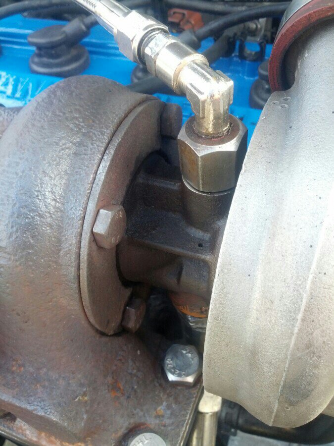

its maybe too much flow still ? i would do a flowtest mate (into a jug) it should flow about a quarter liter per min i guessNa plumbed the turbo to the head oil port.
Okay will do that thenits maybe too much flow still ? i would do a flowtest mate (into a jug) it should flow about a quarter liter per min i guess![]()

imo, yesSo a quarter litre a min idle sound about right eh?
Very true, I think cooling will be fine for me also. @enuo you agree with about a quarter a min? Me and andy @frank had a chat about the oil choice as well. I am using 5/50 oil full synthetic. Possibility that the turbo is actually leaking due to thin oil?imo, yesyou have to strike a balance between not starving the rest of the engine, and keeping the tubby lubed and cooled eh.
mine has a lot of fresh air blowing onto the turbo, but a scoob that has the turbo confined in the cramped engine bay probably needs more oilflow and water cooling too
That's a very good point mate what the hell am I doing ... Lol I have turned in to something disgustingthe thread has got really serious![]()
My vote is actually the gathered affects of oil viscosity x pressure x flow rate. frank you are a genous. I was debating a washer. Then drilled out.the oil viscosity will have some effect sure, but only marginally imo.
i think the flowrate will have far more effect personally, i have knocked the pin out of pop rivets and used the shell for a reducer to test flowrates in the past![]()
Is what I said, oil viscoscity will be the difference between a weep and no weep, but not pissing out and pissing out alot less
I would like to say that Enuo makes no set in stone suggestions. So he can not be made accountable for anything. Nor does he ever suggest anything lol. Ever.Is what I said, oil viscoscity will be the difference between a weep and no weep, but not pissing out and pissing out alot less
