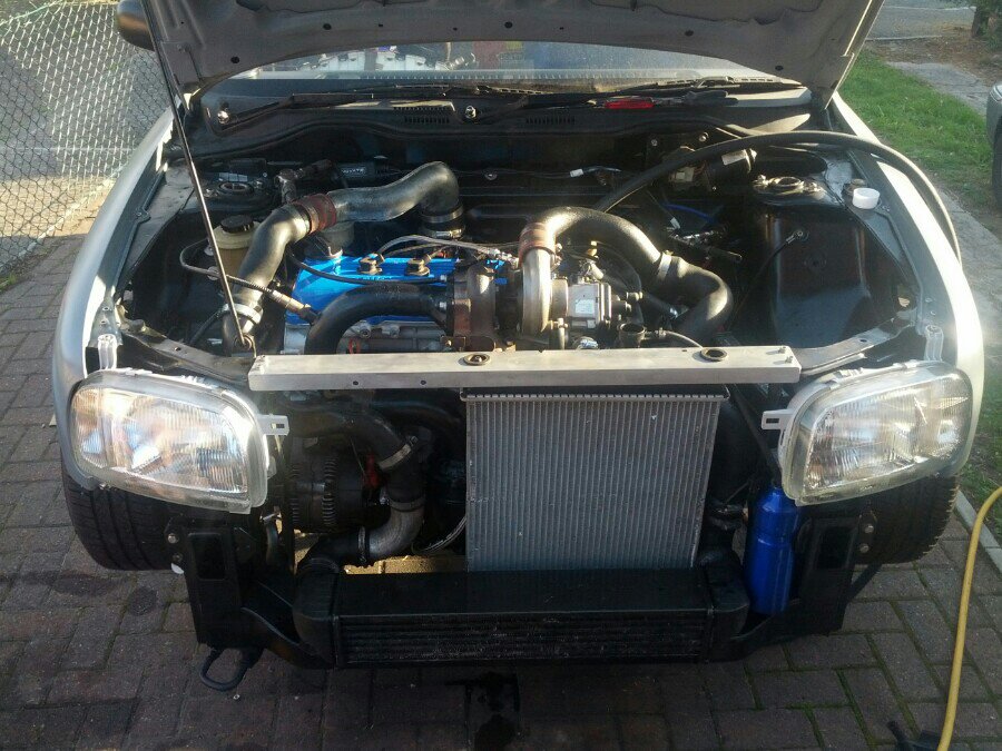

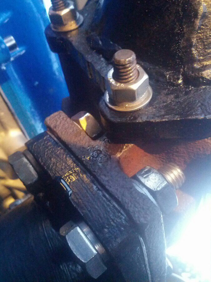

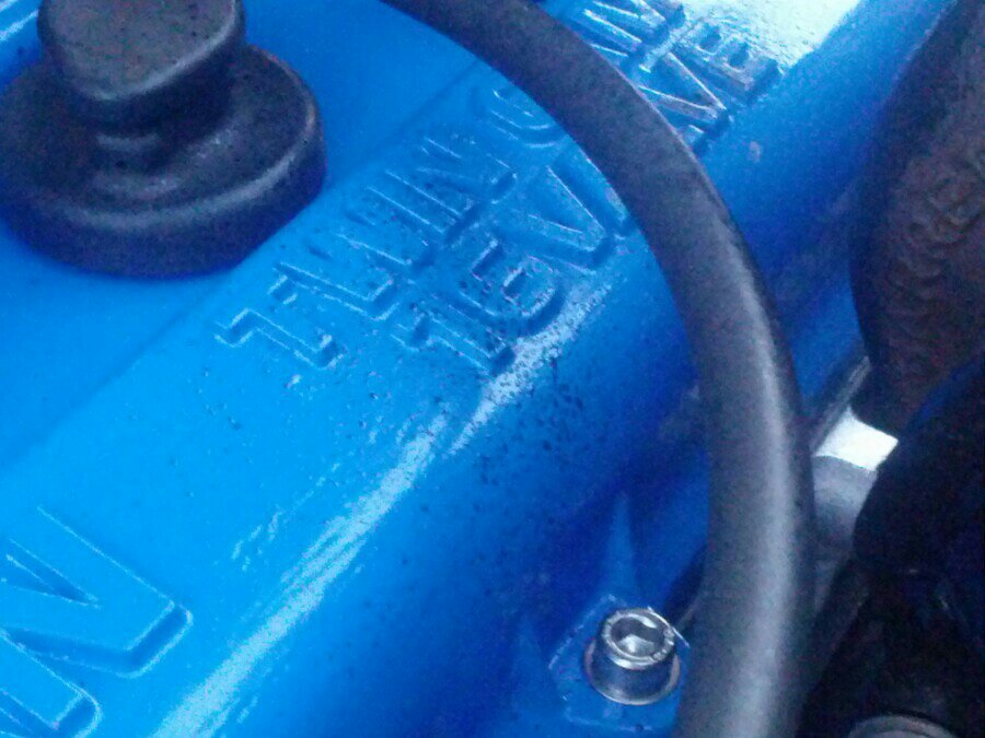

I had the same issue back in 2011 with the worn turbo seals n bearings.
started clear from stone cold and then goes steamy then misty smokey plus leaking oil behind the turbine bit
http://micra.org.uk/threads/pollymobiles-rebuild.35251/page-39#post-486647
normal turbine seals are like piston seals with a straight cut gap and gets worn with a bigger gap or starts to carbon up n stick.
I rebuilt it with new bearings and upgraded to a staggered/stepped turbine seal for a better seal especially with a decat, resolved the bad return pipe fitting and it never since leaked any oil or smoked and shaft is tight snug.
http://micra.org.uk/threads/pollymobiles-rebuild.35251/page-39#post-486823
