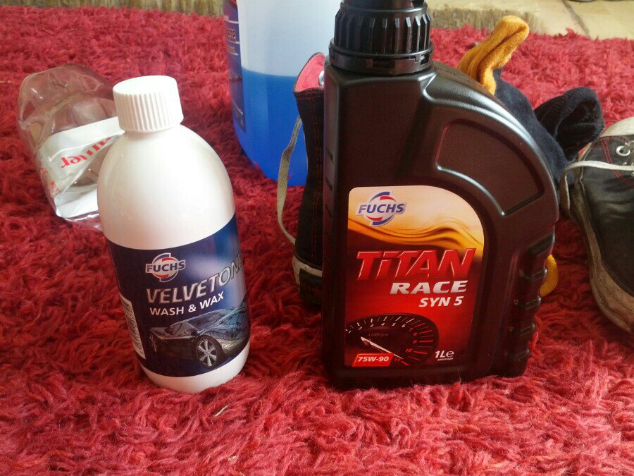

Right flow tested and all that injectors are on their way back. 90 quid later ffs. Lol. Fun fun. Need distilled water. Wheel inner arches.heat shielding. Water reservoir. Few other bits.
gearbox oil. Needs a litre more and the friction modifier still to come. And everything else. Go faster post service.
