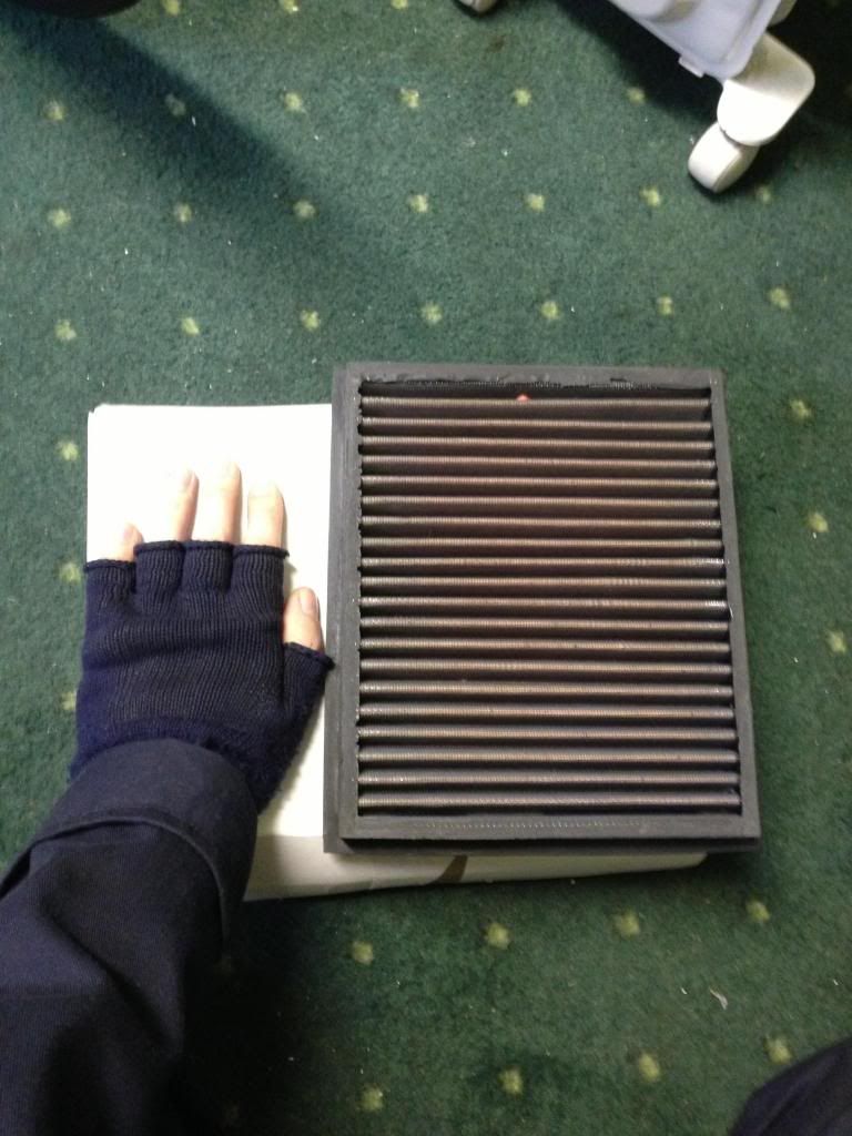

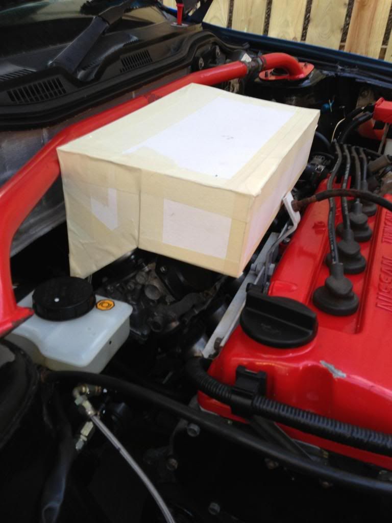

Spent most of the weekend with a sodding cold so i've been designing the air intake box with a few options & a rough card mock up.

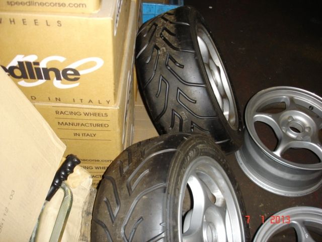

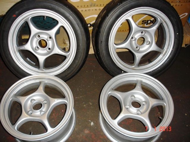

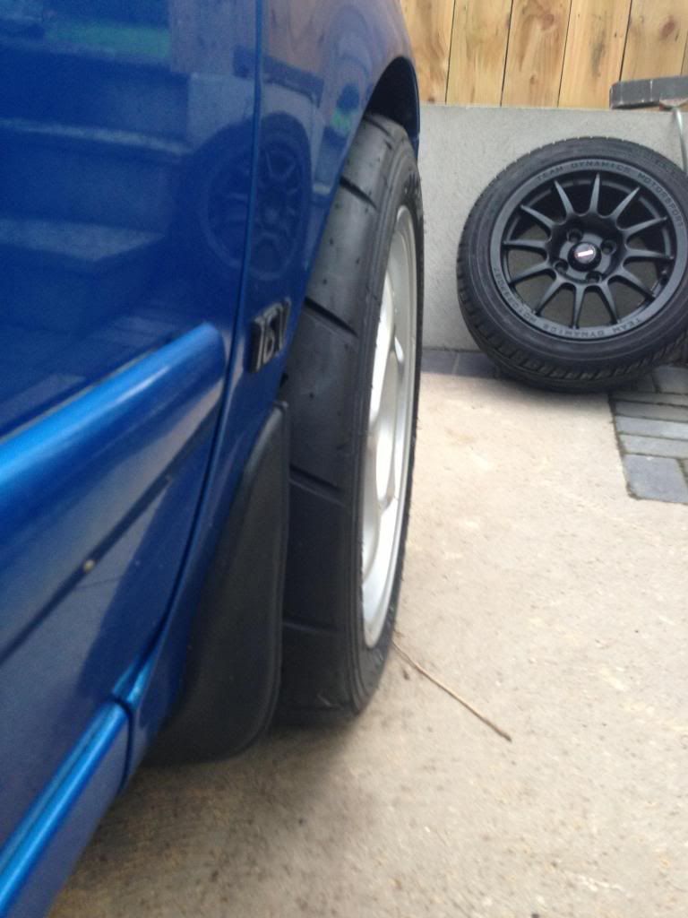

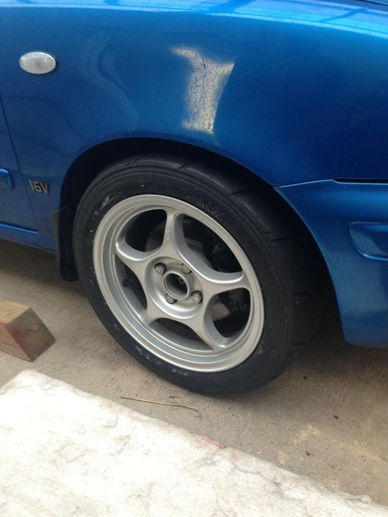

Well hopefully sorted some slightly larger wheels to help give a bit more top end speed (4-5mph per gear ish), also allows a better option of sprint/track tyres :)
They come with a nice sticky set of AO48R's as well, a nice little bargin!
Will be getting a coat of black at some point in the future as well.......

Are they mx5 enkei's by any chance? I was looking at getting a set but they command a pretty penny
Im 99% sure they are mate i saw a set on ebay that look identical, managed to get the wheels & brand new tyres for £500, was chuffed with that as the yoko's can be as much as £120 each per tyre:)
they are sex
wonder how heavy the yokos are, you checked the wheels on a scale yet?
my old 13" nissan alloys with 185/70/13 used to weigh 14.2kg
then i got the ultralight 6kg rotas but was surprised to find the 195/50/15 T1Rs were 7.6kg = 13.8kg total
so wasn't not much weight reduction to counteract the 10.6kg gtir brakes (stock is 6.8kg)

According to Yoko they are about 8kg (not had them weighed as i lost the feeling in my fingers with the weather!) suppose the reinforced sidewalls add a bit to that but should help keep the rim from the ground like in the picture in post #304
Not too worried about the weight as everything is at the moment i just needed that slight gearing change (the other bonnet should drop me a few KG in that department :) )
yea the T1R I have are renowned for having very soft walls unless pumped hard. I hope the RS-R 595 I'm gonna fit in summer is reinforced. don't mind the extra few kg of sidewall plates if it improves stiffness & response.

Well the Nissan consult cables arrived along with a nice big panel filter so the air box can come together at last!

Panel filter arrived, think its big enough :) will be mounted behind the front grill
Design for the air box is coming on ok, hopeful to get this first part (of 3) cut ready for welding over to coming weeks, any thoughts on size/design welcome
