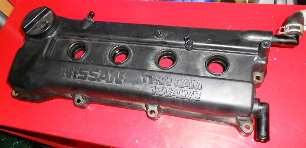

After hunting high & low finally got my hands on a plastic rocker cover :) Should help keep the temperature off the new airbox (when its built!)

throttle bod,s eh paul :cool: the plastic camcover rubber seal is a lot thinner btw eh :)

Hmmm didnt come with the gasket unfortunately, dam, modding the euro one an option you think?

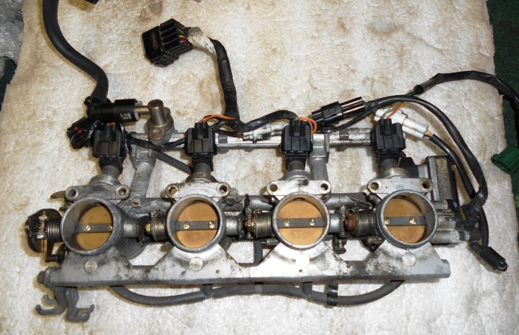

Look good what are the ITB's off? I'm planning on buying some gsxr ones. Will you be trying to get them to work with the Nissan ecu?
Thanks mate, they are from a GSXR600 managed to pick them at a bargain price!
If I could get them working on the factory Ecu it would be great with a maf through and air box though I'd have to try and alter the TPS to the same position as the factory one. Might just be easier to go mega jolt or emerald to be honest!

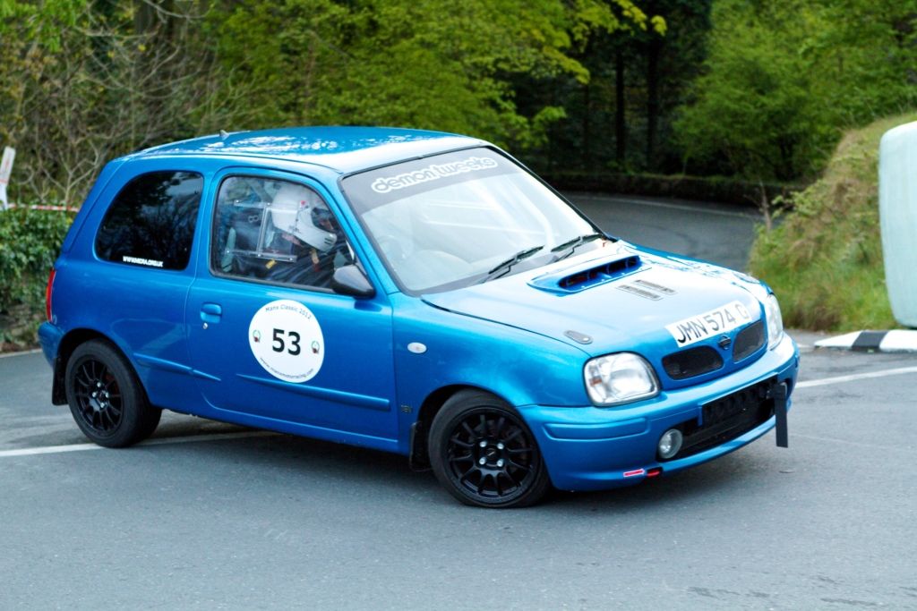

Came accross this pic from last year to inspire me to get on with the jobs before april being, pic below i've used before but its been taken at the same time so gives the two sides :) :

shweet pics.
dya think the front pressure needed increasing abit to stiffen the sidewall from folding under during peak load trail braking? literally riding on its precious rims there lol
btw I've wondered, whats that vertical black bar stuck on the front bumper?

Hi Paul Karl was spot on its a beam spliter for the timing :) after seeing it it could so with a bit more air though its a very low profile (45) so that didn't help, I'm hoping to change to 15" wheels for this year to give me slightly longer gearing
some ultra-light 4kg forged Rota's perhaps :p
mounting an onboard action cam on the sill pointed at the loaded tyre to see its deflection would be fascinating :)
