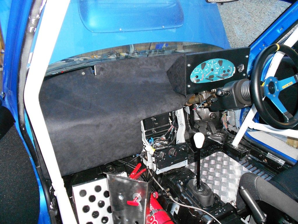

Good days work done on the car:
Exhaust fitted back up
Alternator / Starter / Looms back in
New dash in
New binacle in with oil pressure gage
Lost the light tonight to get pics but bar a few bits & pieces (fluids mainly) we should get her fired up by Saturday :)
Well everythings back on one piece :)
And the dash fits a treat, quite please with how it turned out...
Built the oil pressure up & the car fired up on the first go which is always a relief! Let everything come up to temp & all is well...
The new engine mounts are doing there job well, no engine movement at all (its all in the rest of the car instead lol)
A few tweaks with the timing & a new tax disc should see its first outing onto the road in around 4 months! Though im thinking ear defenders might be an option...
Very happy with how the revs pick up, 1/4 throttle and its up to 7k in a secound or two :)
