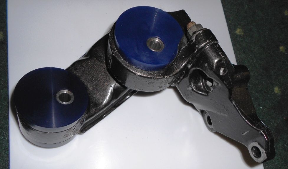

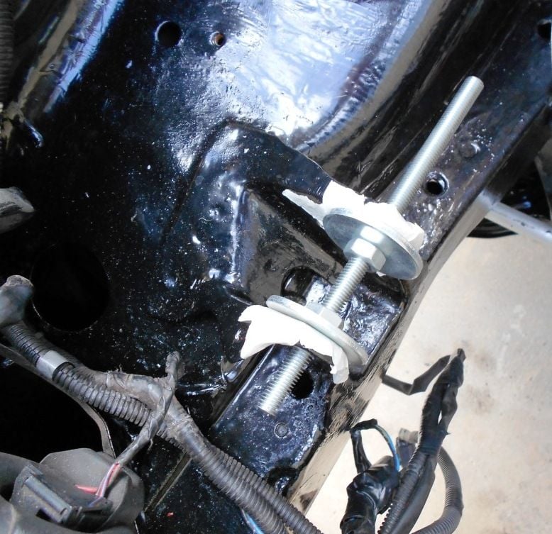

You & Karl are spot on mate, drivers side engine mount & passenger side gearbox mount :) going to have to open out the mounts on the chassis legs as they are a VERY! tight fit

Disadvantages Chris are alot more vibration from the engine is put back through the bodywork / me lol
Advantage, engine stays put under hard throttle & gearchanges are a little more posative as the engine/box will be held more firmley in placed:)

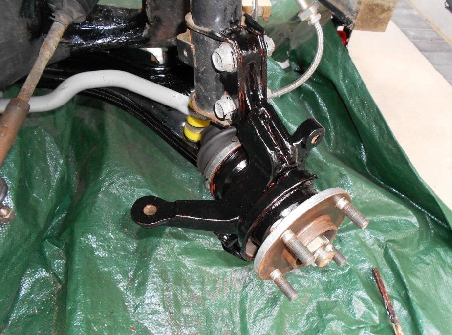

Hubs & wishbones were looking a little tatay so got a redoxide & a few coats of gloss.. (one coat still to do)

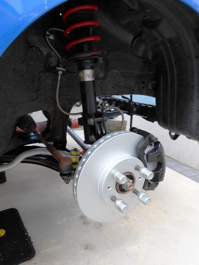

Gave me chance to strip the micra calipers/discs off and test fit the Gti brakes...... LOADS of room on 14's so im happy :) (forgive the grubby wheels)

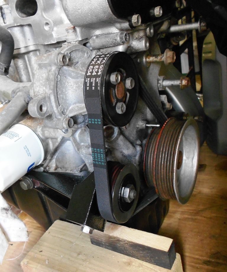

waterpump tensioner from Pollyp (ta again mate) gave a lick of paint & installed, no going back to powersteering now!
Brakes installed properly on front, fitted / greased & torqued up, carnt wait to use them in anger!
New polly mounts were a bit too snug so gave the engine mounts a tweek upon a few mill... incase anyone was wundering about the strength of the engine mounts the 10mm stainless bar bent before they did ;)
