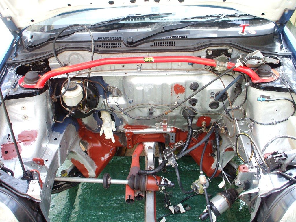

Engine bay is looking a bit messy again so that will be getting a fresh coat of paint over the next few weeks.

All powersteering ancilaries have been taken off the block & pipework from the engine bay..

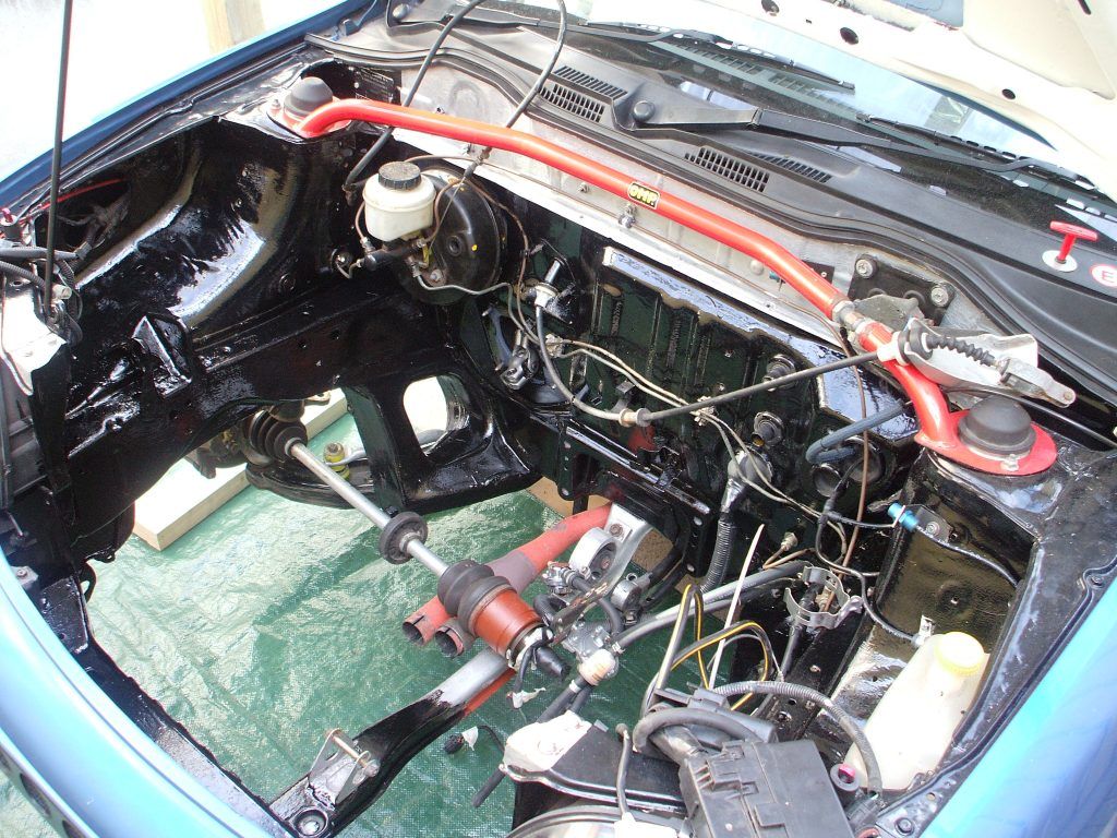

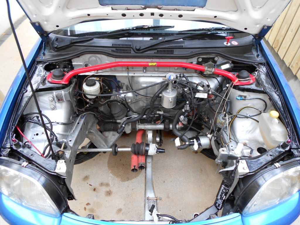

Saturday i set about unpicking the unused sensors from the engine bay loom as they arnt used whilst running carbs (but will be kept incase injection is used again)
Sunday was sorting the engine bay out removing any last bits of rust, oxiding them & sticking the 1st coat over them :
BEFORE
AFTER

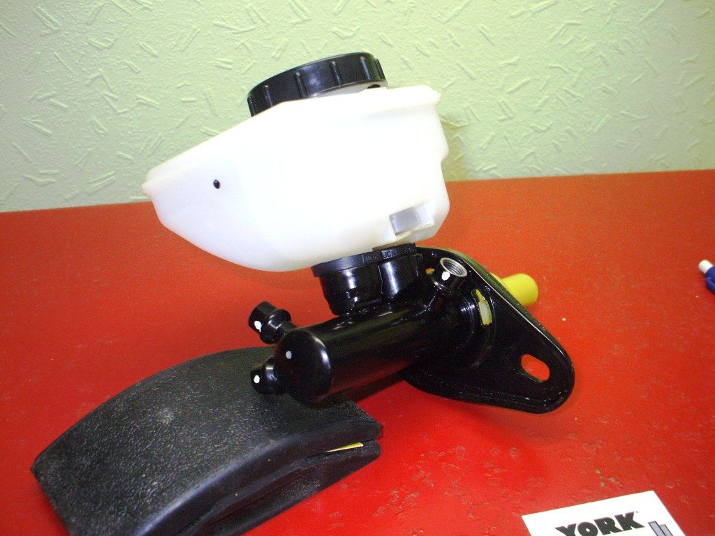

Uprated 23.8mm bore master cylinder (fast you go the quicker you need to stop!) as rust has set into the current factory unit

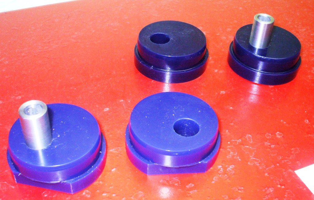

Same for the driver engine mount & passenger gearbox mount replaced by some lovely HOL poly units

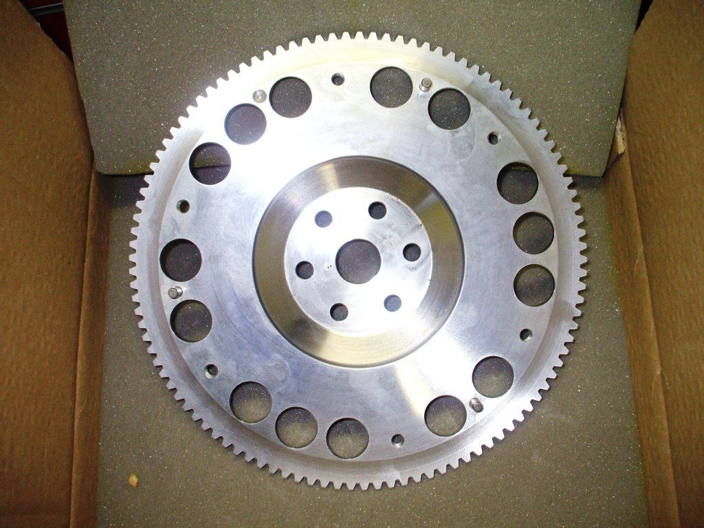

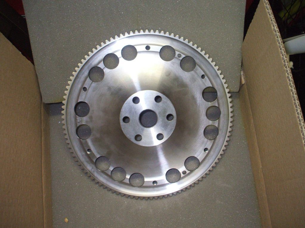

Since the engine & box are out a TTV Racing flywheel (2.8kg) will be replacing the slightly lightend factory F/W

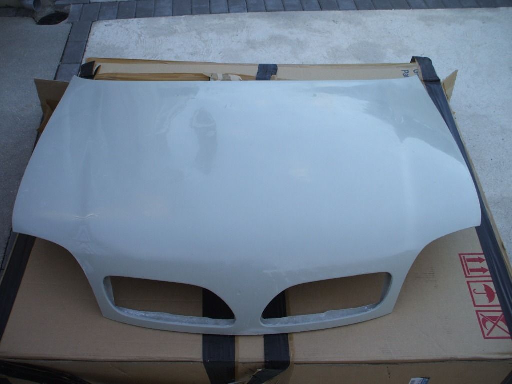

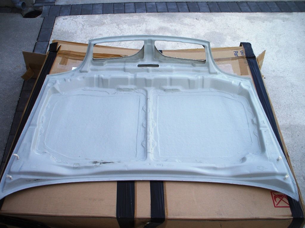

& last & by no means least a GRP Facelift bonnet to keep the cars diet plodding along at only 5kg ;)
So this weekend is set to be busy! Manual rack to refit along with the engine bay ancillaries ready for the engines return over the next few weeks......

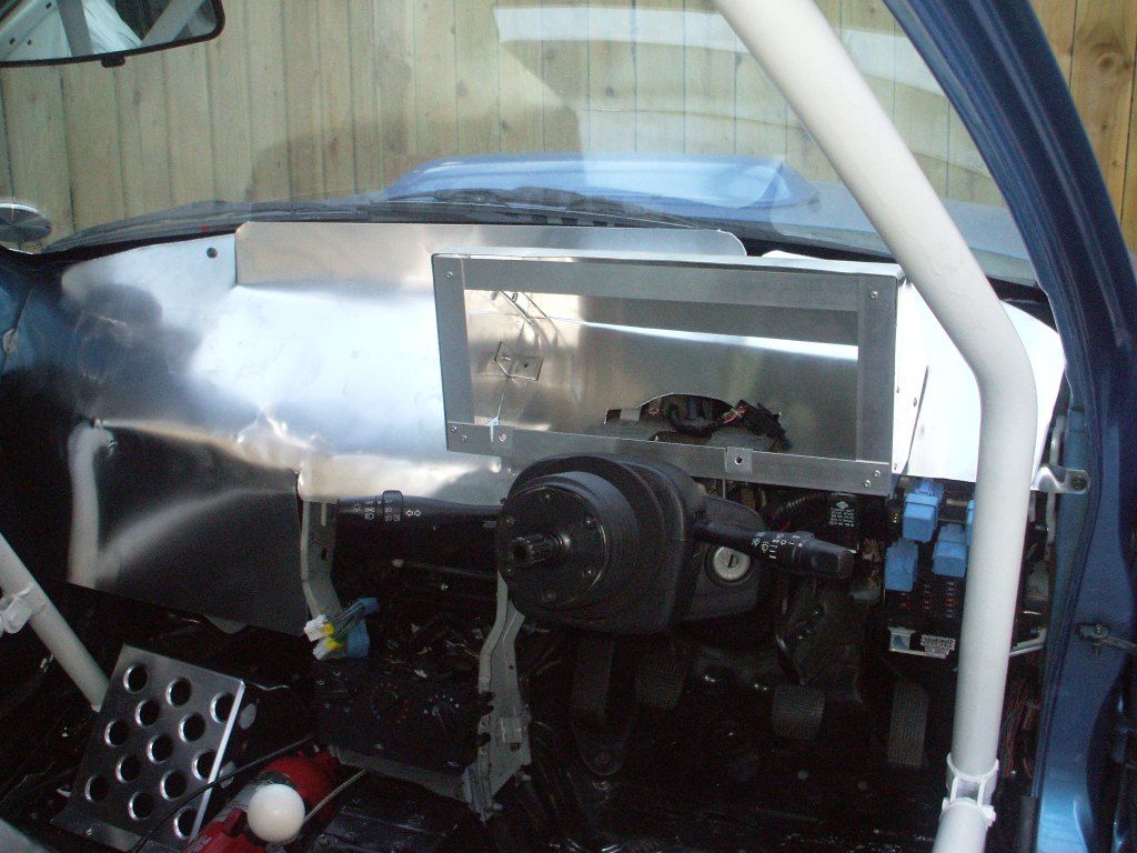

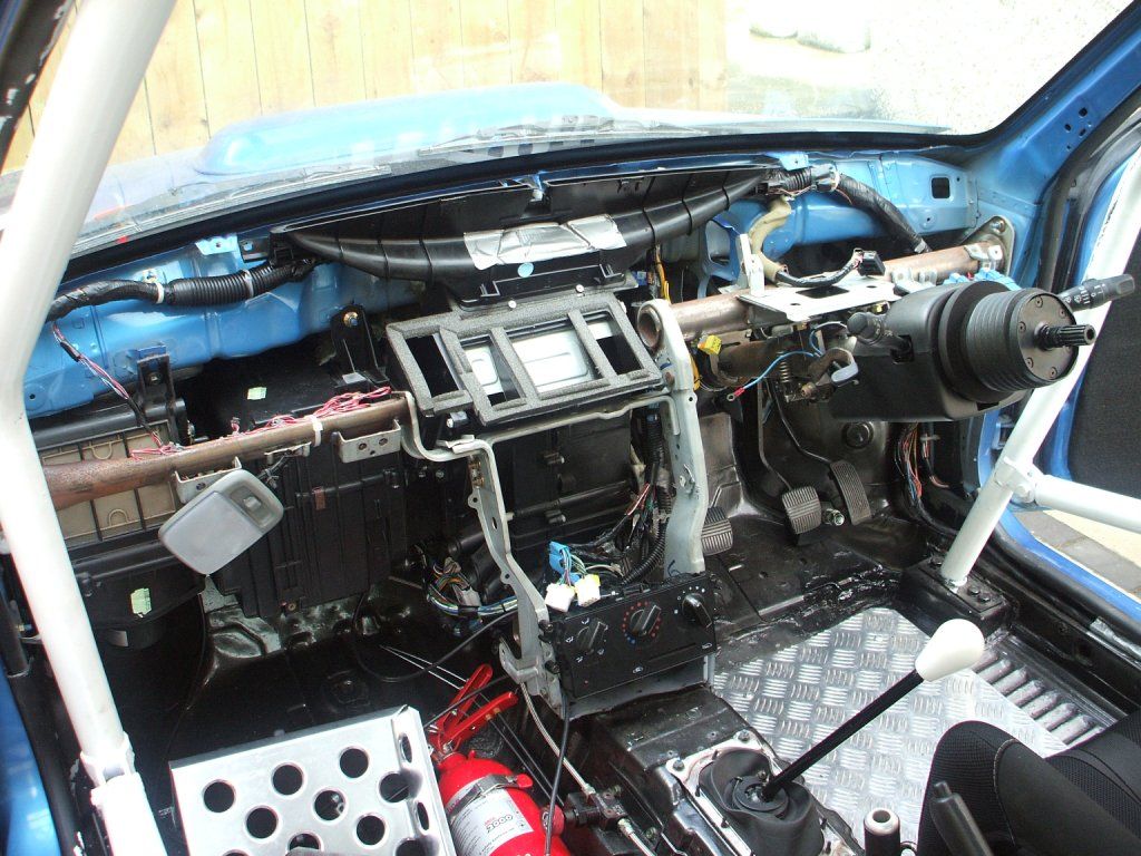

Dash was removed over the weekend & all wireing/ brackets/ fixings & sound deadening that was no longer needed was binned.... Factory dash will be replaced with an alloy one il be making up over the next week or so along with a new dash pod.. total weight to be saved? about 6- 7 kg :)
yes mate, shoved into the A pillar as far as i could, our preface ones dont have the steel frames on the nearside tho eh (so you can save yet more weight)
mine just had this offside steelwork

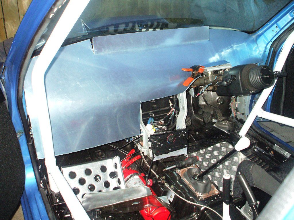

Sorted some 18 gauge ali today to make a start on the new dash.. please be kind its still in the "rough" phase:confused: but weighing in at only a few hundred grams im hoping to get the whole dash & binicle down to under 1.5KG in total:)

are these mounts hard to fit skinner?
I couldnt tell you yet mate still busy with the interior & engine etc
Shouldnt be too hard, cut out old bush & get a good surface for the new ones.. they will however allow very little movement so lining everything up well should save any headaches late on trying to get the engine & box in ;)

looking good though skinner...you get the bonnet from matt aswell ?
so you just take the rubbers out the centres? and how did you line up the bushes skinner? and did you fit the aero latches yourself?

Thanks fella thats not a bad idea hey!:) Yep the bonnets from Matt think it was his first batch of facelift ones to be made, only had a quick test fit but all looks good though!
For these the rubber and outer metal ring need to come out mate from measuring them up, il line them up as best as from the old bush & then bolt the mounts to the car half tight then to the engine & box when they are craned in... i think this should be easier than having them in situ :)
Yep i fitted the aero latches too bud, not hard but worth taking your time, measure twice & all that!
Any advice on fitting them?
Mount the bonnet pin at a rough height first
Put a blob of oil on top of the pin & lower down the bonnet to mark where the pin will need to go through
(any of the support structure thats above this mark will need to be cut back to allow the catch to be fitted later)
Where the oil mark is drill a hole a little larger than the pin
Now the bonnet should be able to be lowered shut with the pin sticking out of it
Now using the guide that comes with the pins masking tape up the bonnet & draw a cross instersecting the top of the pin.
This gives you exactly where to cut out the kidney shape of the catch & also where to drill holes for the mounting bolts.
Drill the mounting holes out first as once the catch hole is cut out the bonnet wil flex alot more.
Cut out bonnet catch hole (dremel will do a good job of this)
Then its just a case of bolting the catch on and adjusting the height of the pin to get the bonnet sitting flush, this is done with a rubber that sits over the pin you can cut to desired height.
A tip here is to cut it a little high as over time the rubber will settle with opening & shutting
job done
:D
Cheers skinner :) without sounding stupid does the latch bolt to tge metal from tge bonnet or is there nuts/ fixing plate goes underneath
Nothing stupid about that mate, yes it bolts to the bonnet itself with nuts bolts & washers tho you can get a fixing plate as well..... if you want any pics i can pop a few up no worries

Hi Guys well the dash & pod are done, pods front cover is a matt black persex sheet which will house the oil pressure gague as well to keep it in my eye line :)

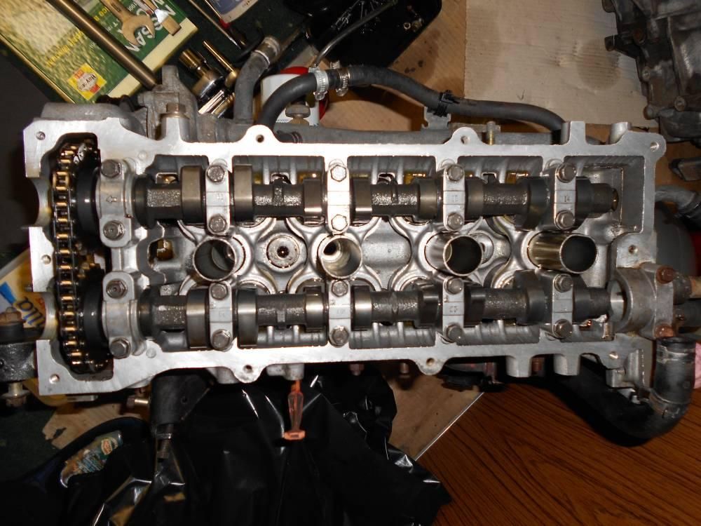

Shims for the group A cams & 6 flywheel bolts have arrived so hopefully the engine will be built over the next weekend.... this weeks plan is to try to get as far with the brakes as i can, also with a guide of how to make you own braided lines :)

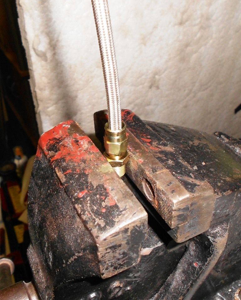

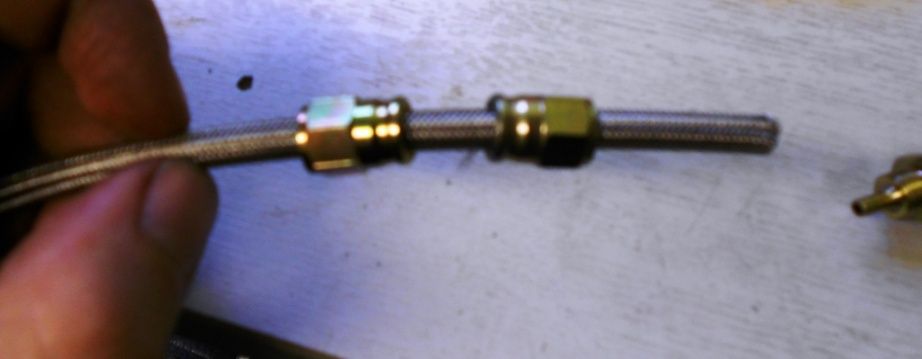

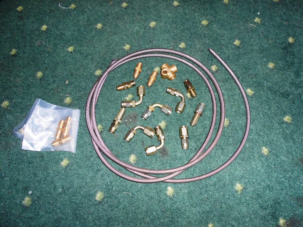

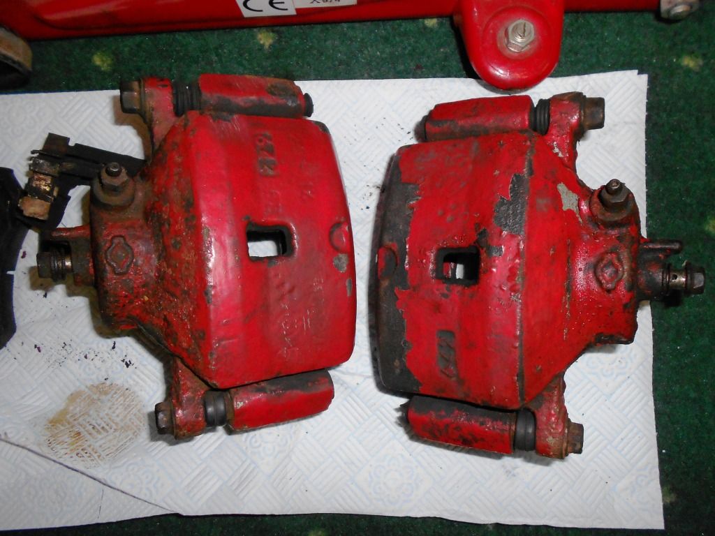

Well thanks to Karl these arrived the other day, made sense whilegetting a bigger master cylinder to get it something worth pushing so its going to be Gti up front ;)
Calipers & carriers were stripped bear, ground back & new seals, clips & dust boots fitted along with a coat or redoxide which is just going off at the moment, weather depending to get a nice coat of satin black & some VHT some time soon:

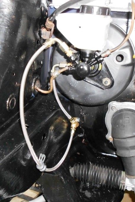

Since the engine bay is clear the bigger M/Cylinder went in today as well, though the old copper rear lines were routed as a best fit around the motor last time so in the bin they went & i cracked on with replacing them with stainless lines as below:

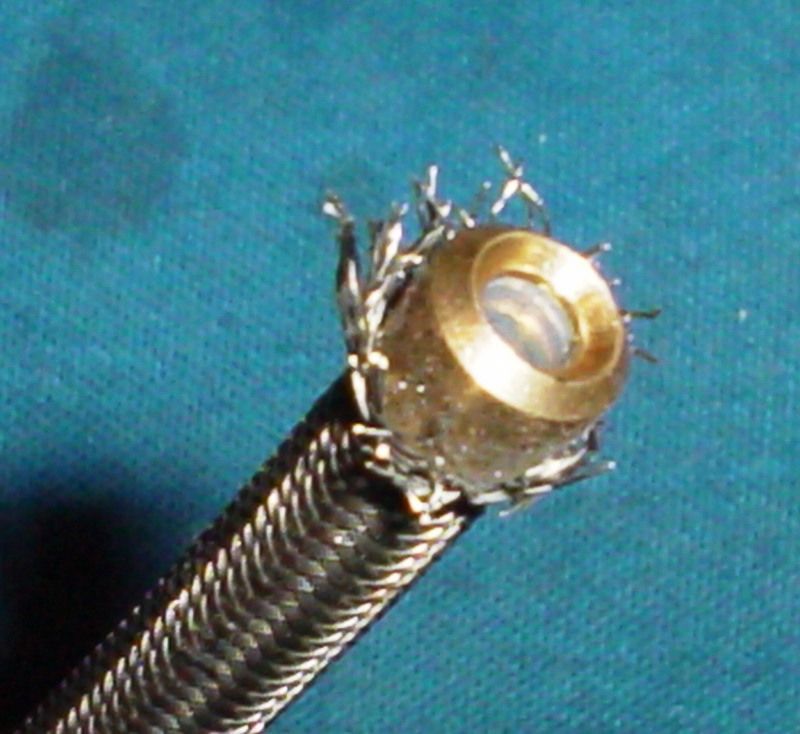

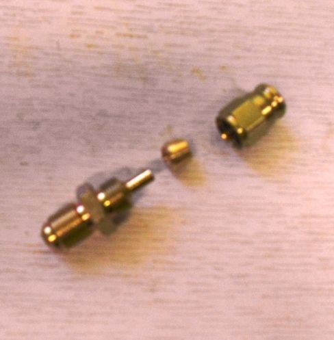

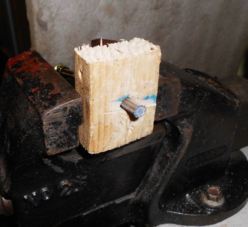

The fittings come in 3 parts with a crushable olive in the middle (this needs to be replaced each time the fitting is re used)

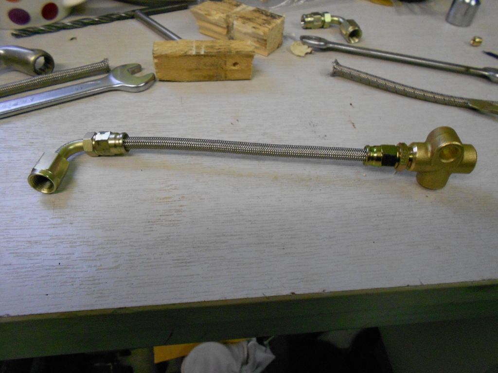

A T-piece was bolted on just below the brake servo where the 2 rear lines will be merged to one before the pipework runs to the rear. Then you will need to cut the line to size. I found the best (cheapest) way to be a 7mm hole in a split block of wood. Wrap some tape around the pipe to prevent fraying & use a fine blade saw:
Clear out any swarf with a flat screwdriver & slide both of the screw fitting for each connection over the pipe now (this make its alot easyer to slide them over as the next step makes it nearly impossible!)
Pry back the braiding to the depth of the olive being carefull not to fray it too much & press the olive over the pipe core (it should push flush against the pipe so it seats neat at the end)
Next up push your end fitting onto the pipe & clamp in a vice, now slide up the bottom fitting & tighten to crush the olive in place
Repeat for the other end of the pipe & job done :)
Two lines done & one to go
