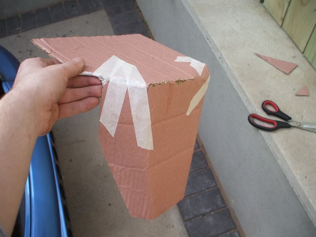

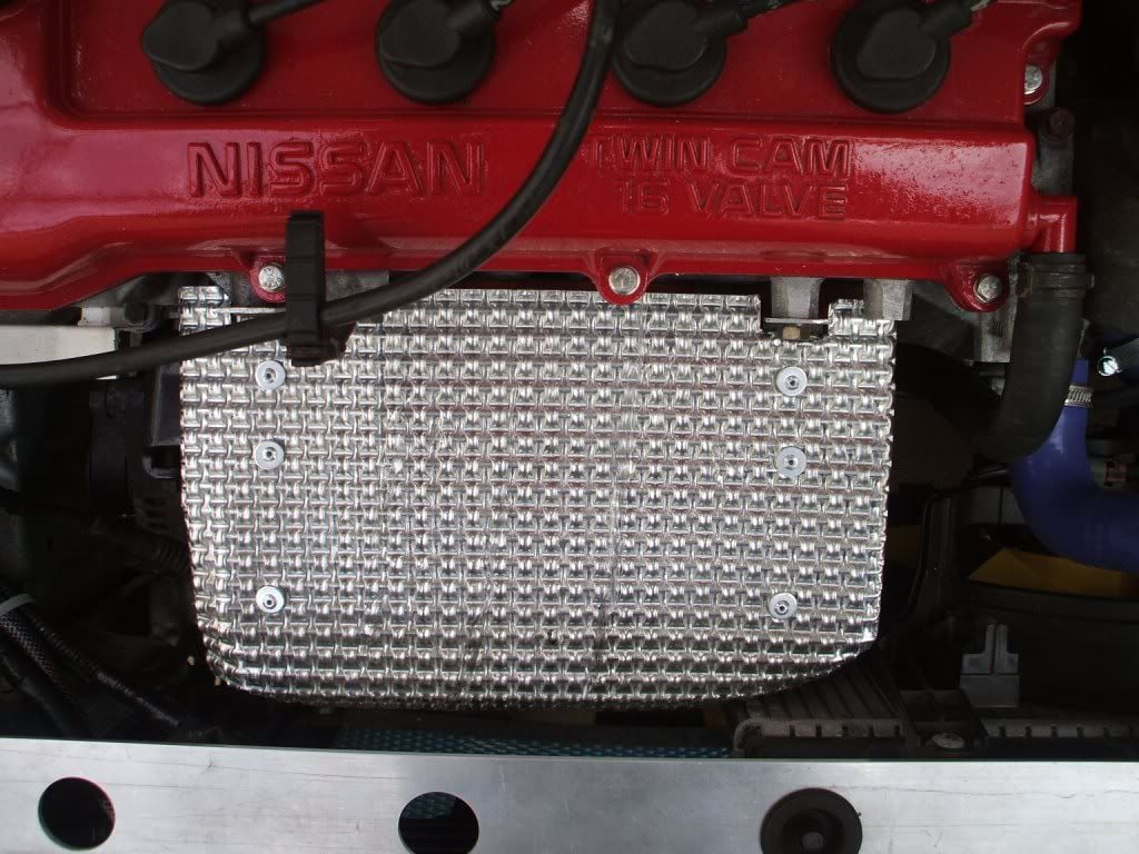

Nimbus Grill arrived so set too making an exhaust heat shield..... (not much room to play with fabricating the thing!
Mocked up with card first:
Then shaped/ test fit/ shaped/ test fit untill i was happy, bent a few sections of ali for mounting brackets & pop rivited it togeather, then added a bracket at the bottom which mounts to the exhaust to keep it all secure.. im quite pleased with the results:) after a test drive (10 minutes) you can put ur hand on the shield no problem. The issue of the powersteering cooler heat sink is *fingers* crossed solved. added bonus the radiator & alternator are also shielded from the heat so cooler underbonnet/intake charges should help out on warm days!

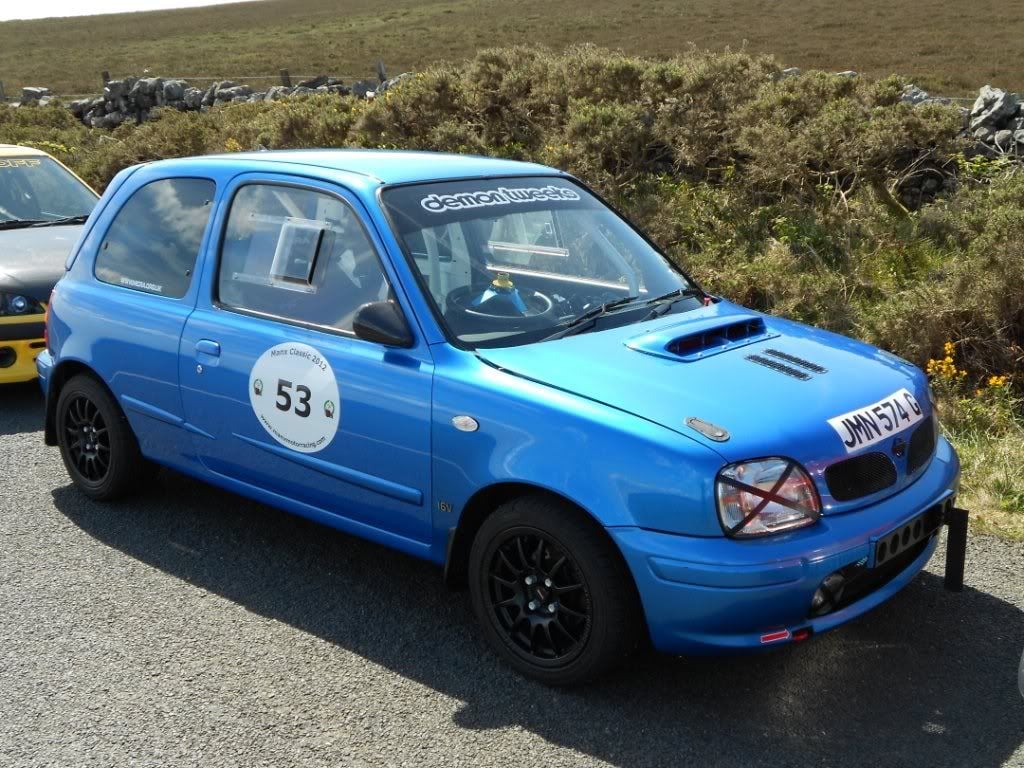

Well the Manx Classic 2012 went very well, appart from a very wet & windy Thursday! Managed to beat all 3 PB's i had for each day even taking 8 secounds off my last years time on the sloc coming in 39th of 68 cars (not bad for the 3rd smallest engine hey ;)
I should have used alot stickier tyres, looks like the budget might need to be streched a bit next year, as always the Micra didnt miss a beat, handled great, the only thing slowing it down was the driver :confused:

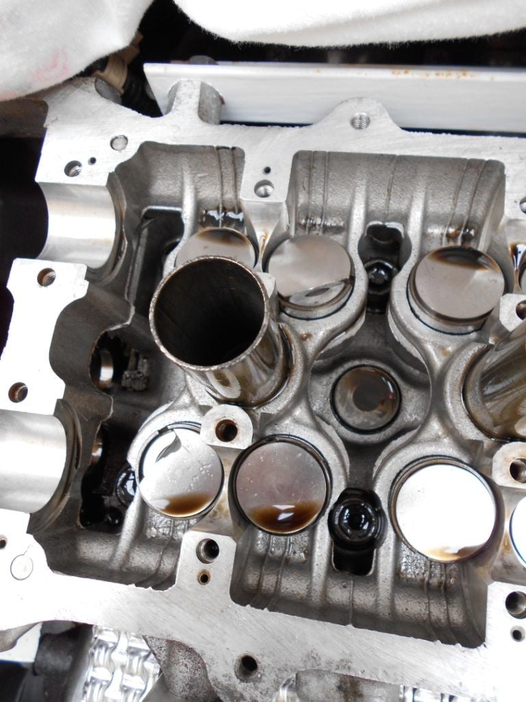

Well took the cams out thisafternoon to inspect the damage from last weeks drag racing, two nicely split shims on cylinder 1 :confused: found one piece but the other has long gone, engine out time i think (joys of motorsport!)
y'ouch
hows that happen? agressive cams? stiffer cam springs? reving too high for too long?
Not that agressive mate just piper fast road, happened on start up / idle when they were under the most load :confused: i've looked the shims over & theres a dark mark on them where they have split think its a flaw in the metal itself as its a clean break!! Just need to find the broken bits
