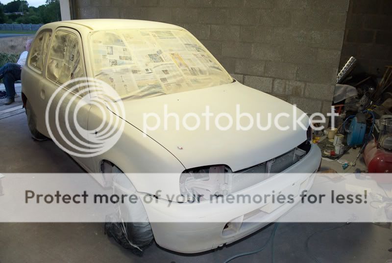

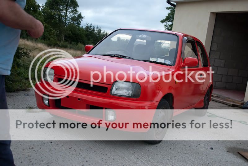

At the moment im working on smoothing in the little nismo kit that was on the car, should have taken pictures before i started.

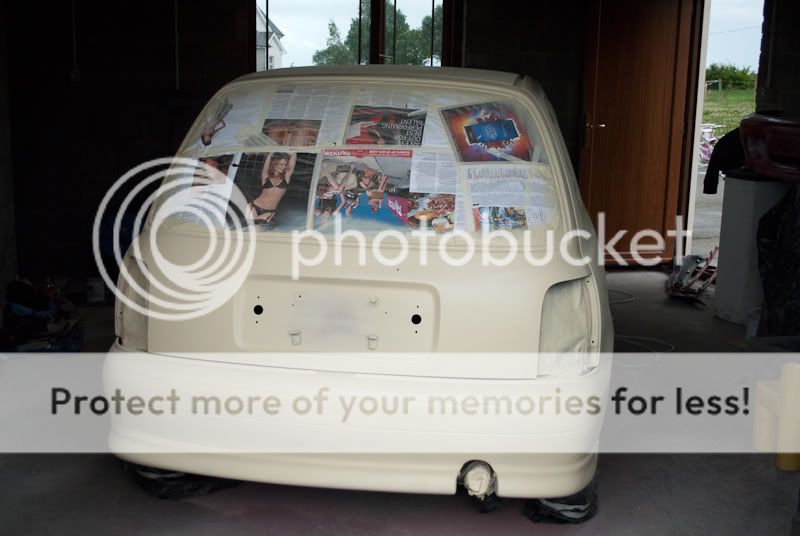

Tryin to get as much done in the next 2 - 3 weeks as i can cause i just got paint to do a respray and goin for a nice smoothed out look

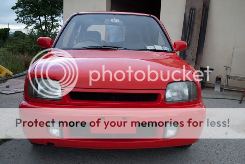

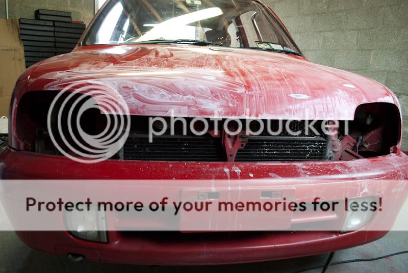

Open mouth grill
Got some more work done
startedby making an open mouth grill
Started by cutting out the centre
Fibreglass paste and some plastic cutouts to bridge the gap
Then some filler,making sure to build it in layers to help prevent any cracks
Now for some rip off mesh
End Result
i think it looks fairly good

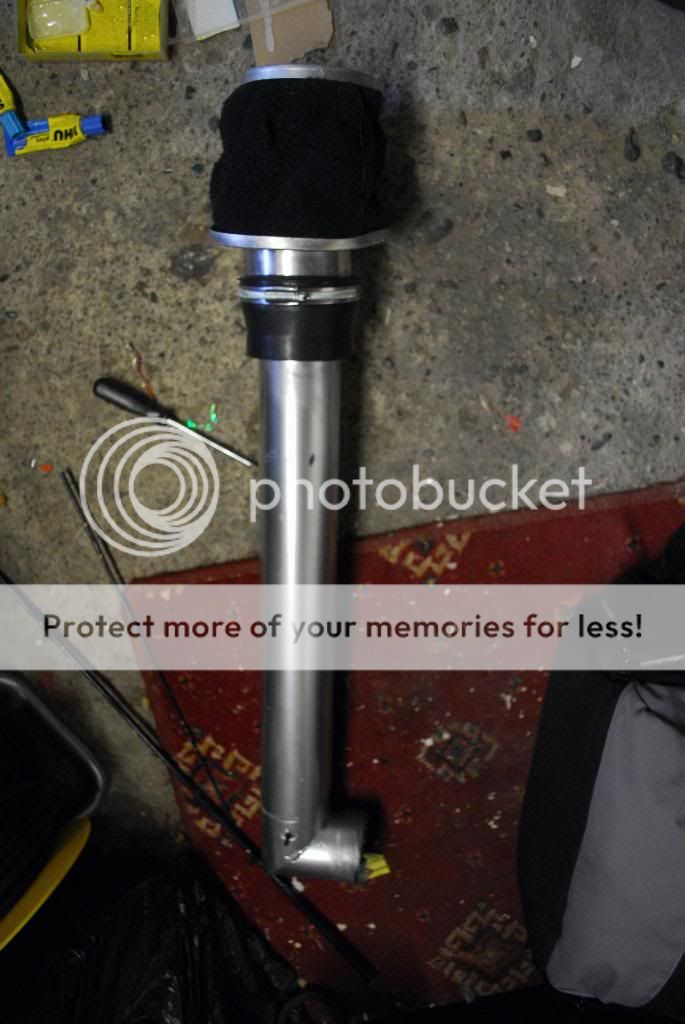

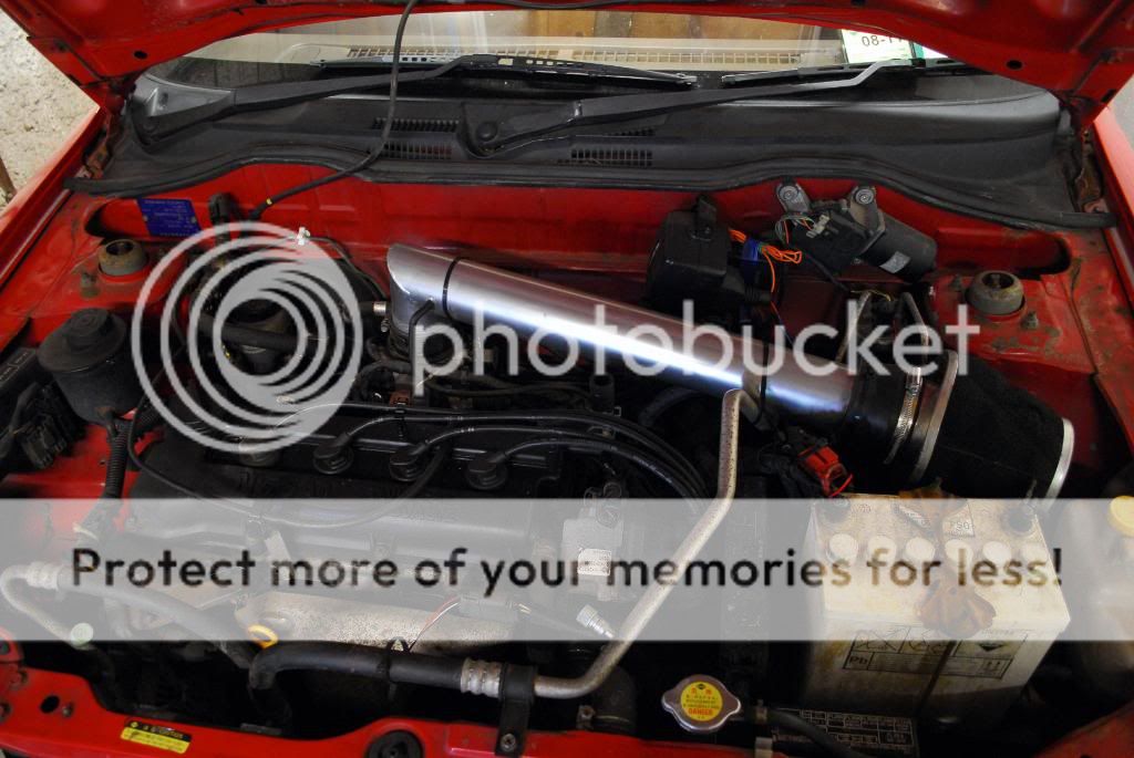

DIY Induction kit

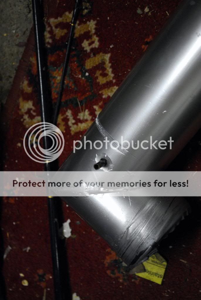

I decided i wanted an induction kit on it so i set about making one from an old
filter i had, some gutter pipe and a can of chrome spray paint
For the Pcm hose i cut a small length off an old fishing rod and put it in a hole i drilled in the pipe
all put back together
Cheap but effective

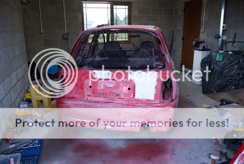

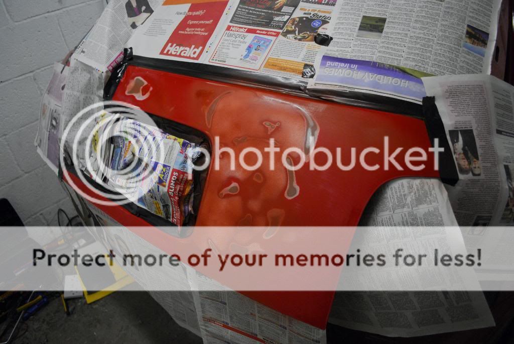

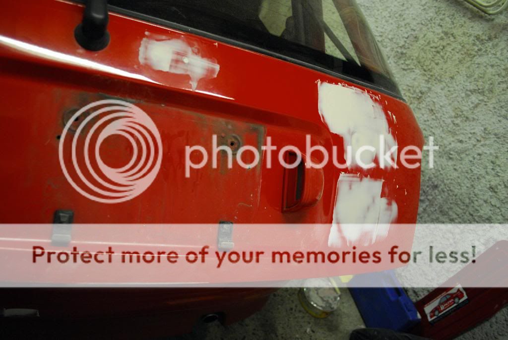

Smoothing the boot lid
Had a few bad dents that needed to go so while i was at it i thought id get rid of the keyhole and badge
Cleaned it off and got it outside
A lot more work to do before its ready for paint

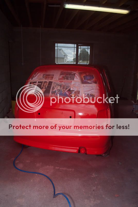

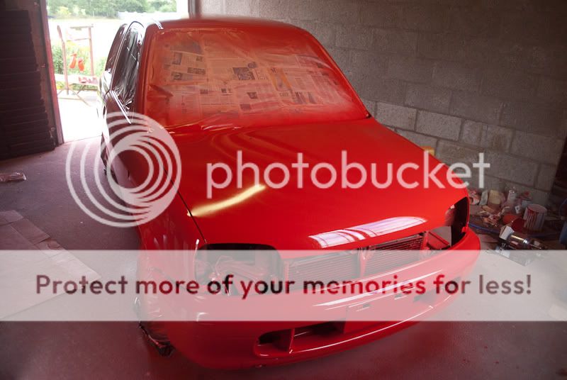

Not bad? It looks brand new - take it you've got your own compressor and guns?
I do but its the first time i used them for anything other than painting wall or garden furniture.
i had my first gun which was really bad when i put the primer on so i went to halfords and got a new one
and when i was spraying the bumper the paint pot fell off!
so i ended up finding a descent one in a motor factors for 70 euro
