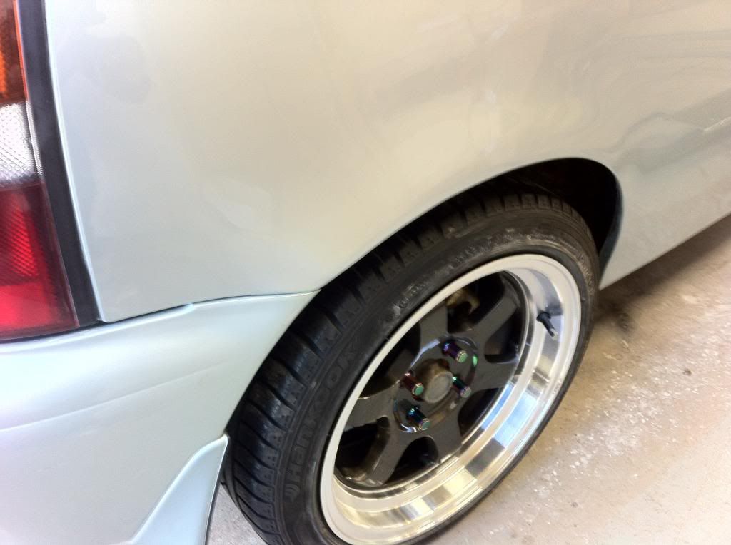

I was told by a technician/engineer that it was fine, providing it wasn't heated up a lot/for a long time and also it was safer than cutting another spring which would change the shape of it so much that it wouldn't seat properly. I've done about 400 miles+ on this so far and they've been completely fine, no noises/difficult ride or anything. It's still better than the way it was set up by a previous owner of it, which was extremely dangerous.

I did read up on it before doing it, and we did it in a way that won't/shouldn't affect the ride/strength of them.
But yes, I did think that was a bit harsh tbh :/ As soon as I get enough money I want to get proper Micra coilovers anyway

When you heat springs you ruin the pitch of them so I would of honestly went for different springs, coilovers or just cut them then use and angle grinder to make the tale the right shape. Heated is a no go in my opinion. I suppose if you only heated the end up and bent it down then that is most likely okay and the fact you kept the heat in a certain area. I suppose you let the spring cool down naturally?

I couldn't get any other springs as most only lower around 30ish mm (mine were 35mm), coilovers are out of my price range at the moment and I have already cut them (1 coil off the fronts). Yeah I think most people so far have assumed I heated the whole spring to lower it but I didn't, I only heated up the very end of the coil and bent it to get it the same flat shape it was before cutting.

I Presume thats how cutting a spring should go. I have seen people cut springs then heat the ends up to make them flat then if need they grind the ends flat. Obviously won't work if you have a pig tail spring. It would atleast get the spring sitting the best it can. Most lowering springs for K10s look as if the company bought some stock springs and cut them. My H&R ones sure did, they didn't even feel any stiffer.

Yeah that's what I did to mine, cut 1 coil off (as the top one is tightly wound and goes flat towards the top) and then heated the end of the spring and bent/flattened it down to make it the same shape as before and flat so that it sat properly in its cup. (I couldn't cut more than 1 off the front as the gap between the coils is a lot more and also i'd never get them to seat right/stay captive).
Mine now feel far better than before. They give really good firm handling, no body roll around corners but are also still comfy to drive on every day :)
Heating the springs will anneal the metal, losing the carefully aligned grain structure. It'll actually be softer so less likely to snap (as long as you didn't water or oil quench it), but it will sag over time more and have much reduced stiffness.

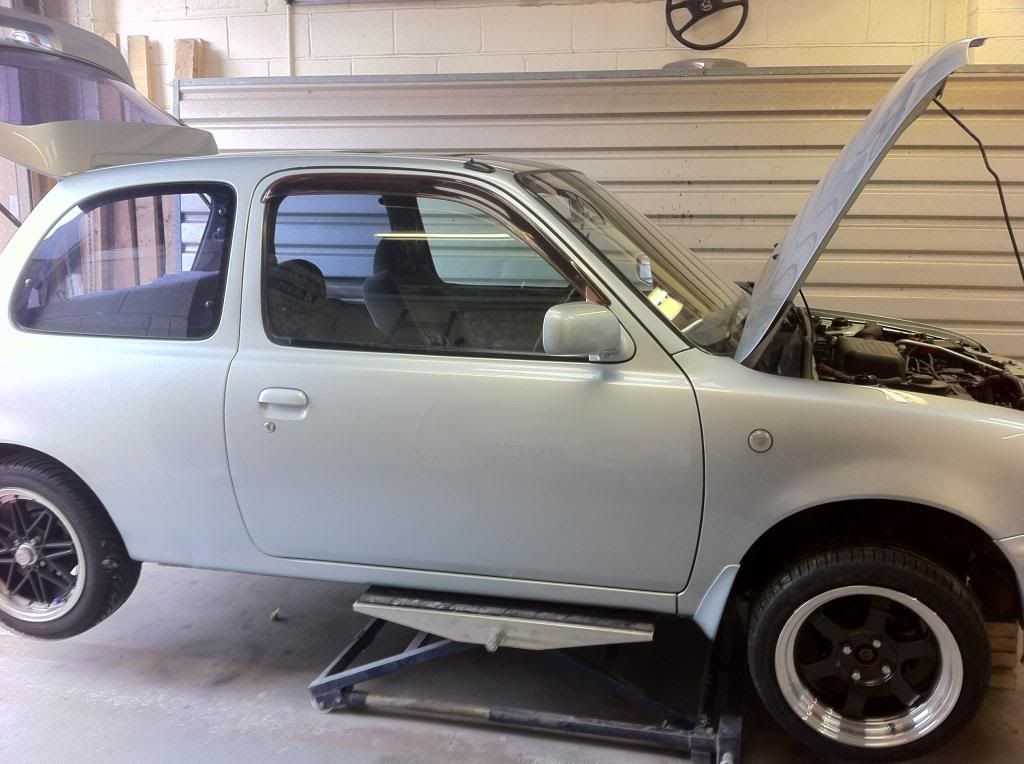

What is that stand the car is on? looks fair handy, how does it work?
It's like a big scissor type lift, it goes from flat to a bit higher than in the picture and you just wind up with a hand winder or just use a square socket bit in a drill. You can change the width of it too, for different size cars. I can't remember the exact name of it now, but i'll find out for you soon

the front of your car is supported by 4 bolts, and that'll take a hefty bump too. The thickness of 4 m12 bolts will take it easy. I could probably knock up some drawings for one in a day If I was asked very nicely and had some spare time.

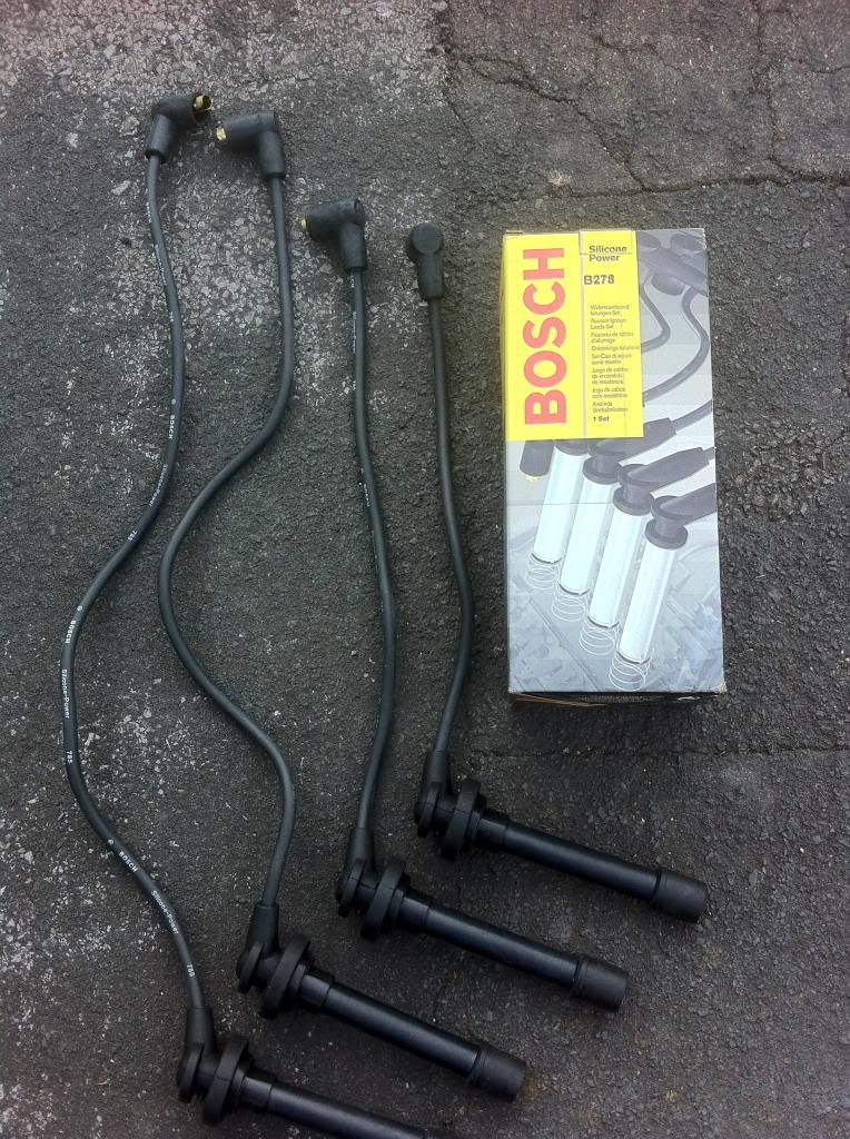

Firstly tried some new ht leads. Bish bash Bosch..
They've made a slight difference to starting but the main problem is still there so next up will be a new dizzy cap/rotor arm.
