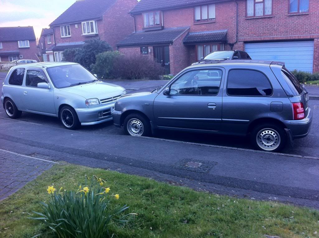

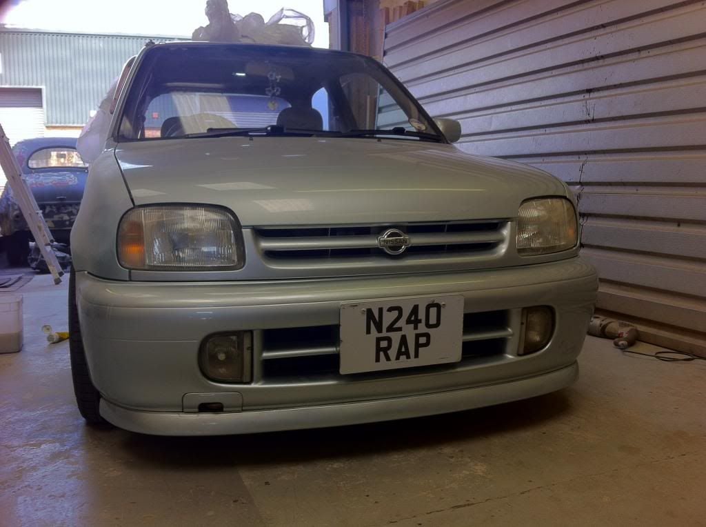

Did you used paint gun or rattle cans Sam?
Given the work shop and tools I would goes gun. Looks like a good job eh
Yeah looks neat! Confirming that if you want a proper job rattle can are only good for little parts

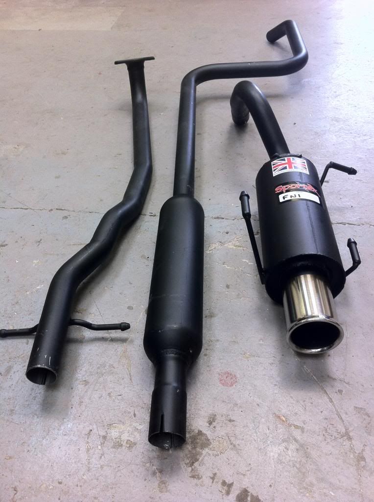

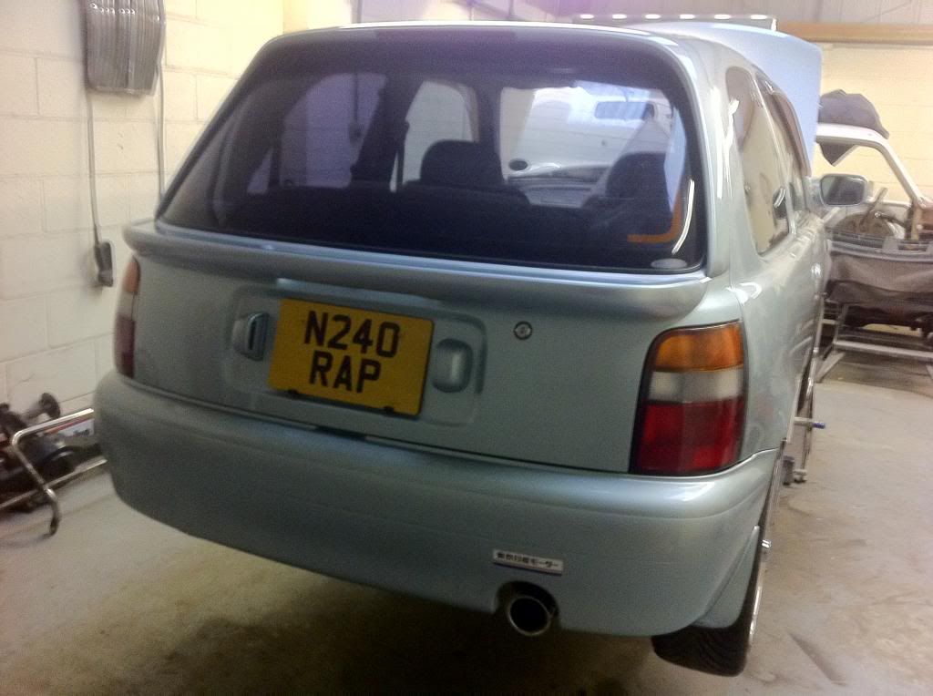

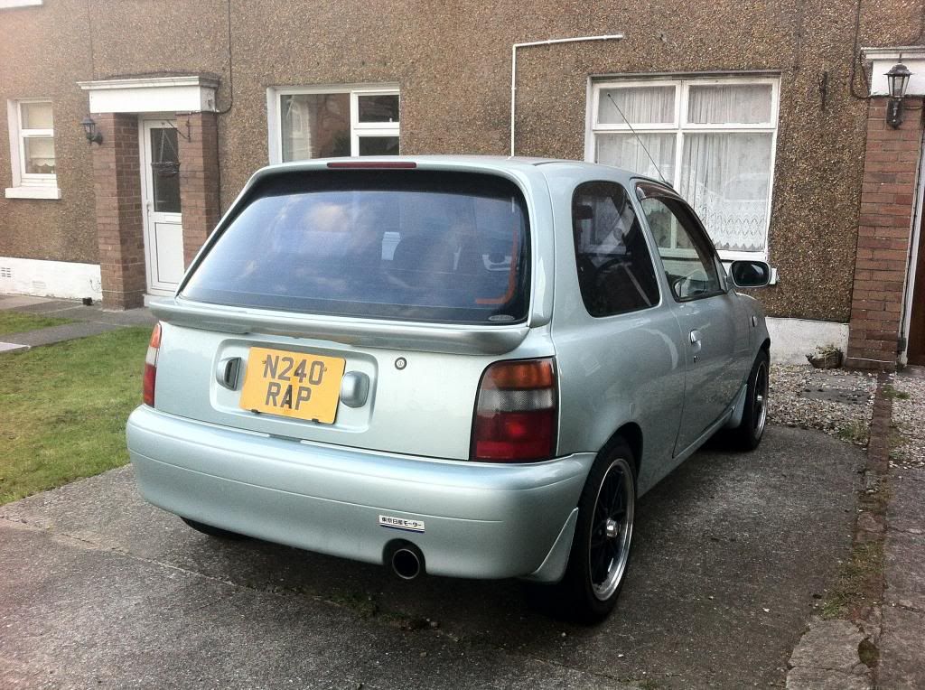

As the old exhaust was starting to wear away, and I wanted something better anyway I got a new Sportex cat-back system for it.
It was really easy to fit, went straight on with no problems and now it looks, sounds and goes so much better :)

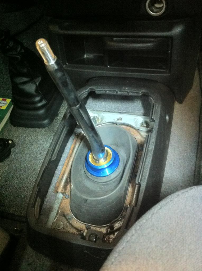

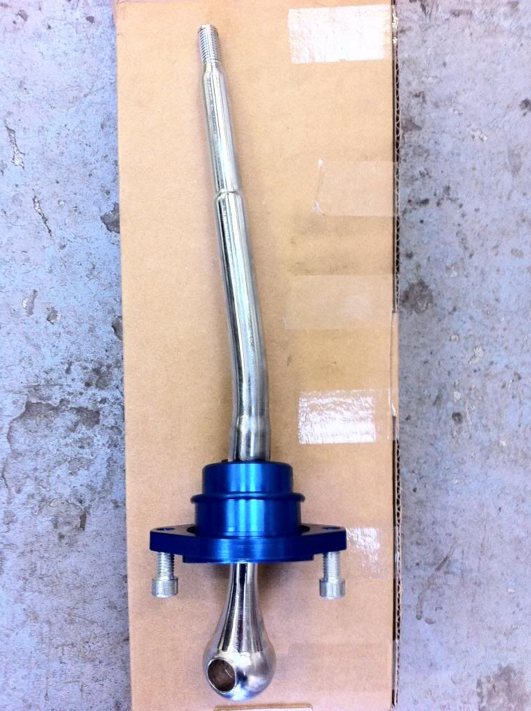

Since the manual gearbox has been in the car, the gearstick hasn't been quite right as it was cut down and the gearknob wouldn't stay on properly due to there being no thread on it, so I thought i'd get some new bits.
Nissan Pulsar short shifter.
Went in quite easily, and the travel between gears now is so much shorter.

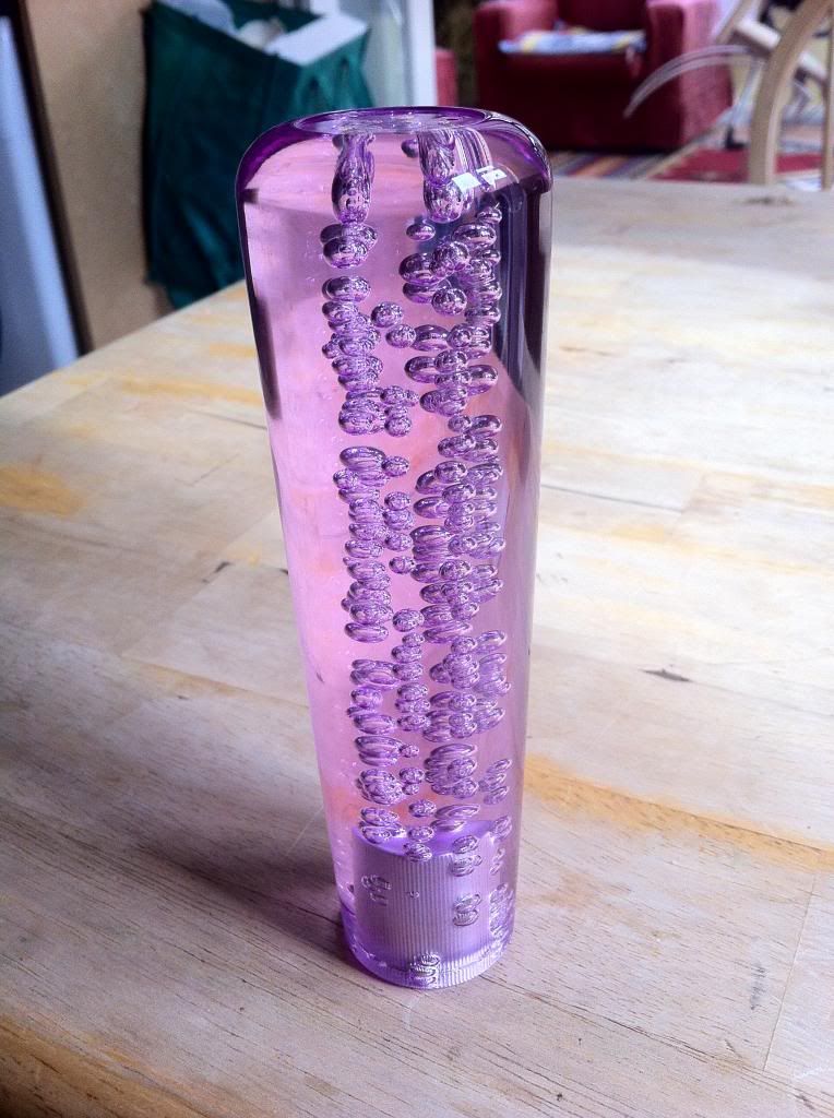

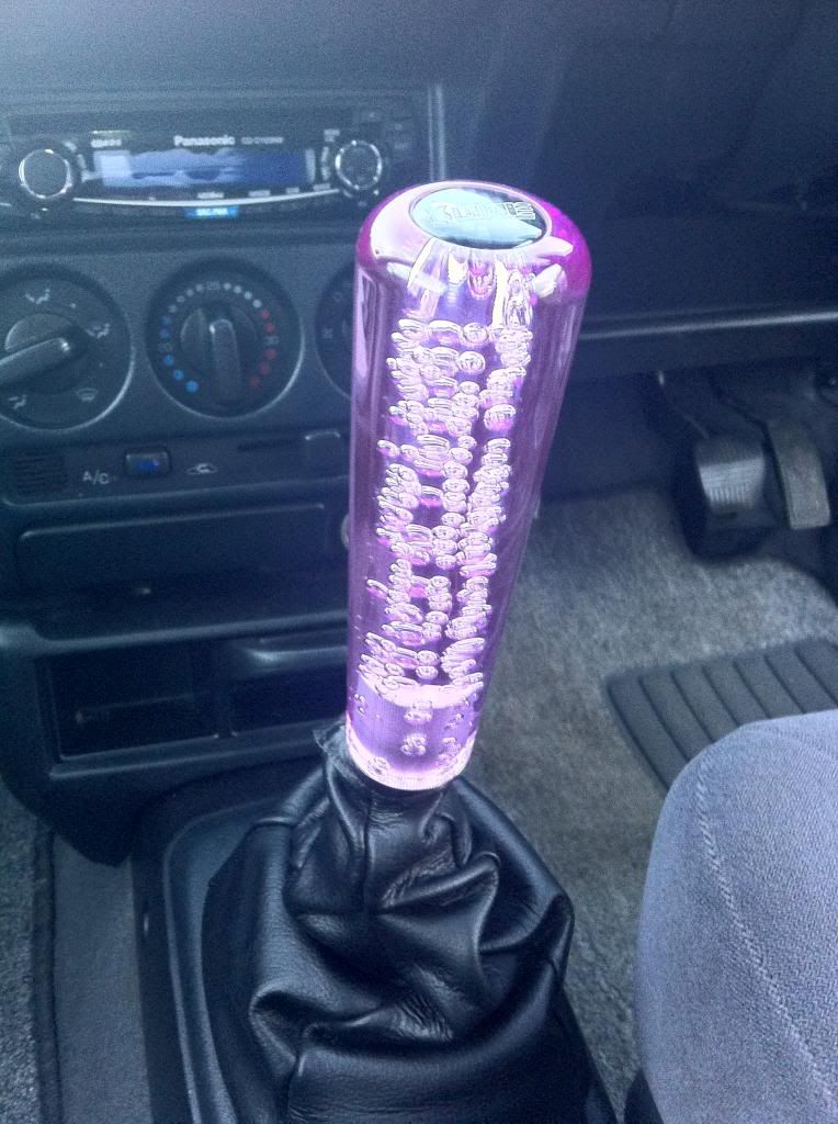

Also got myself a new bubble gearknob too. It looks pink in the photos but it's actually more purple, as this is the colour scheme I'm going for.
Changing gear now feels a lot better/smoother and I think it looks rather good too :p

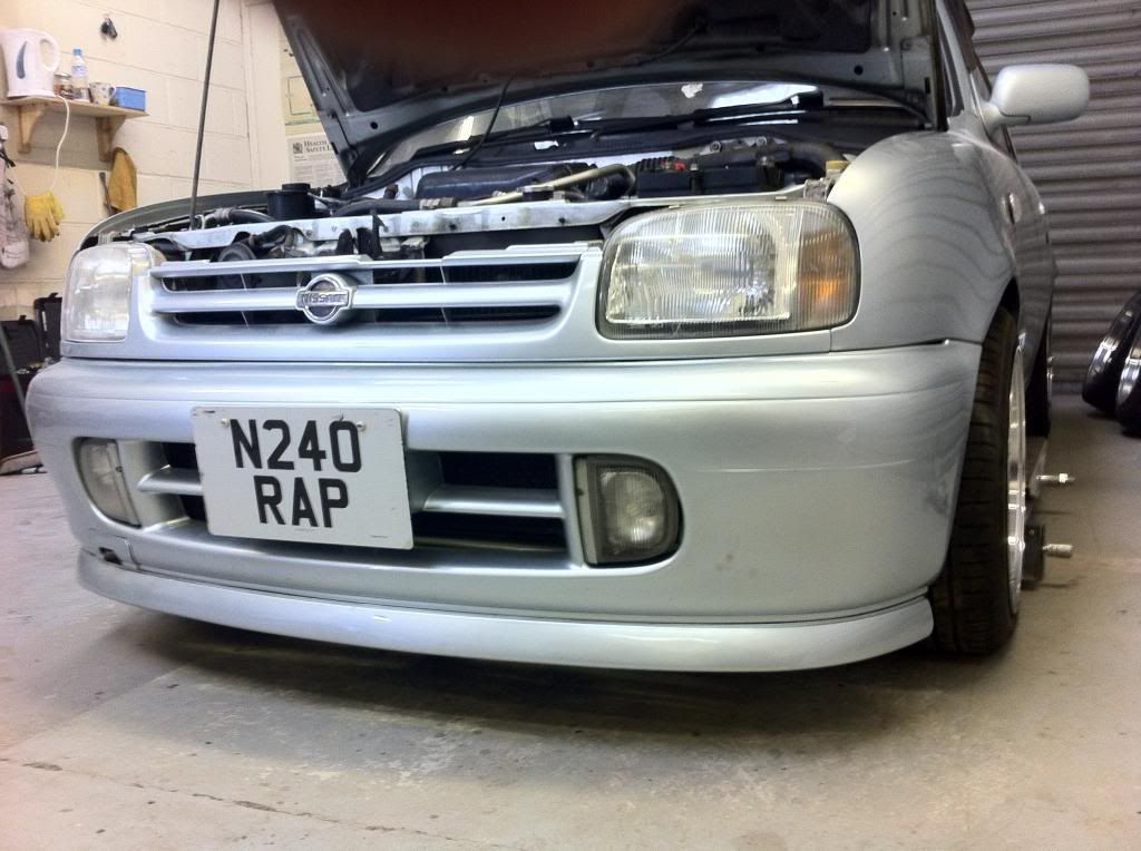

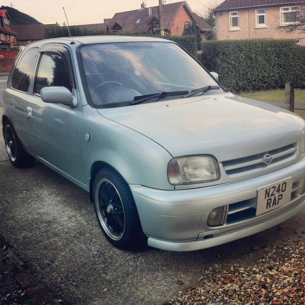

I wasn't sure about the splitter at first but I actually quite like it now, although i'd change it if I could get a Nismo style one from somewhere
Matt does a replica
I think i'll wait until the polo one starts to wear, or until the replica ones pop up on ebay again. I quite like the sideskirts on this one, but i've never seen anything like them anywhere
I think those skirts come with the "Nismo" kit...?
possibly...
Every Nismo kit i've seen for sale just has the side spat things in it, which I had before and didn't really like them. I can't seem to find anything like those sideskirts

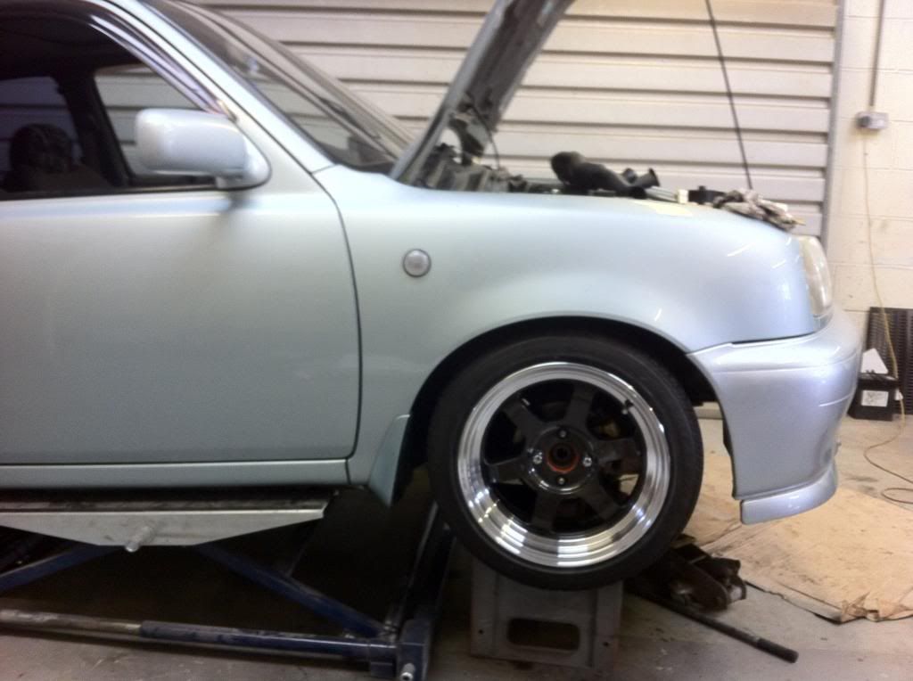

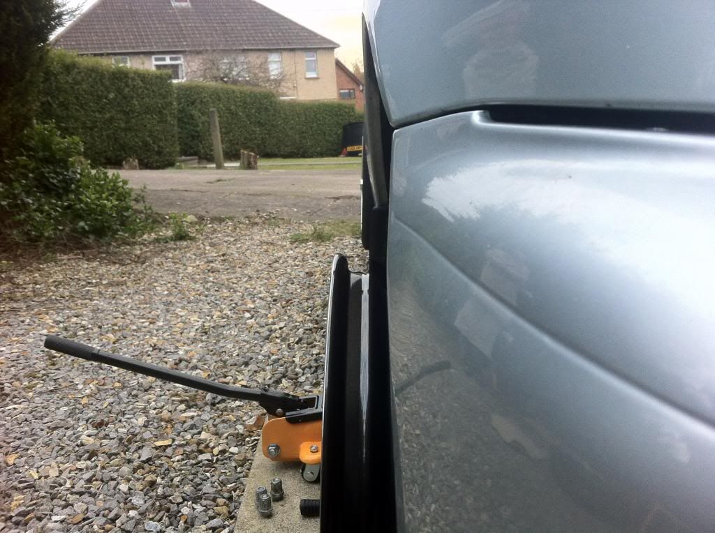

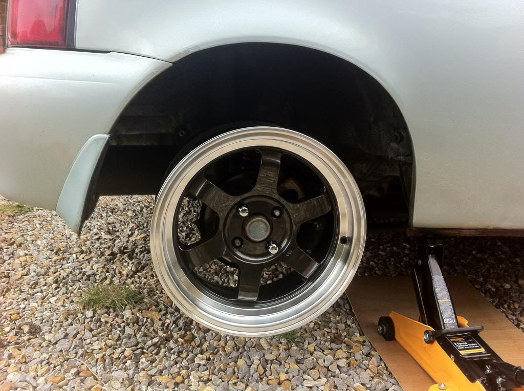

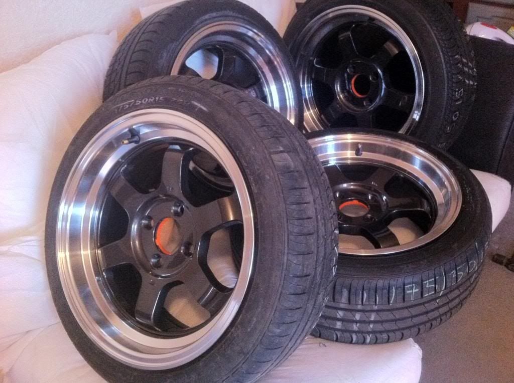

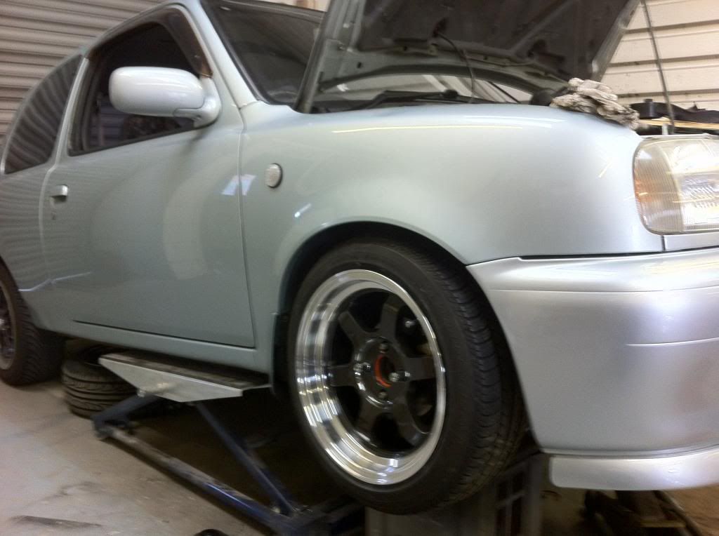

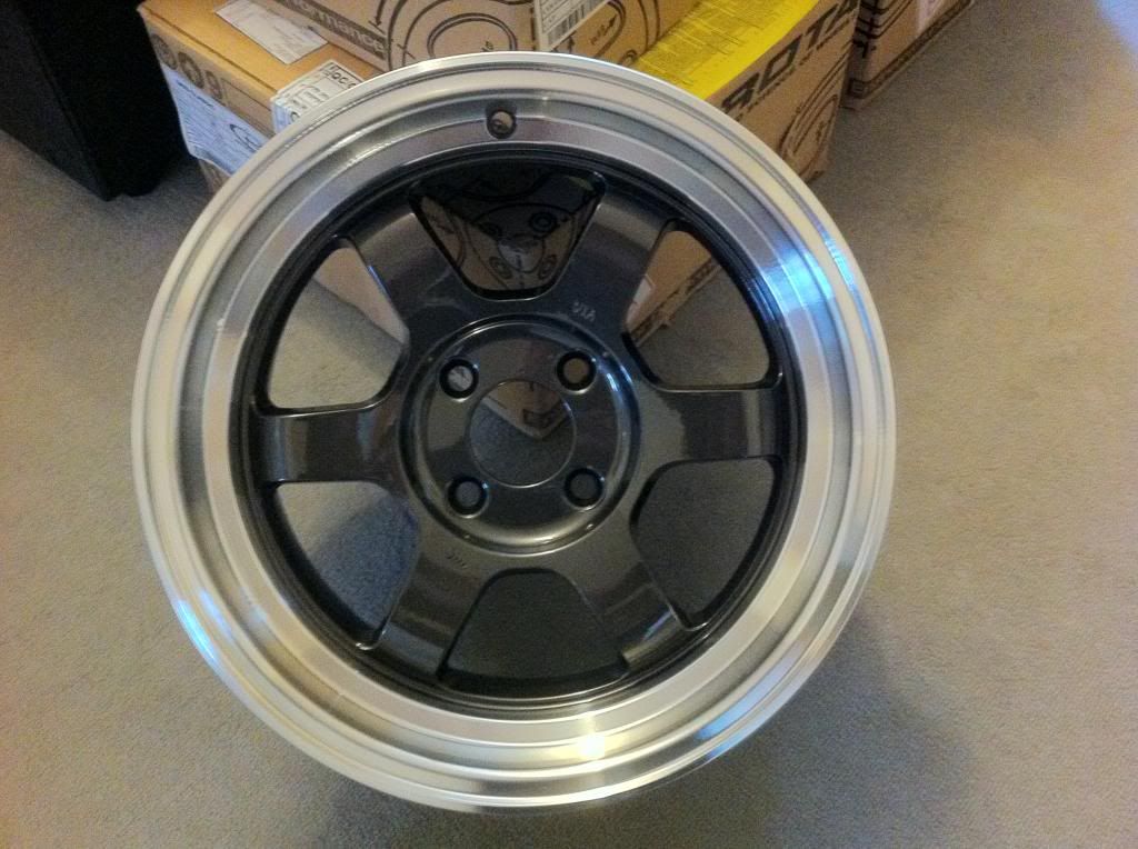

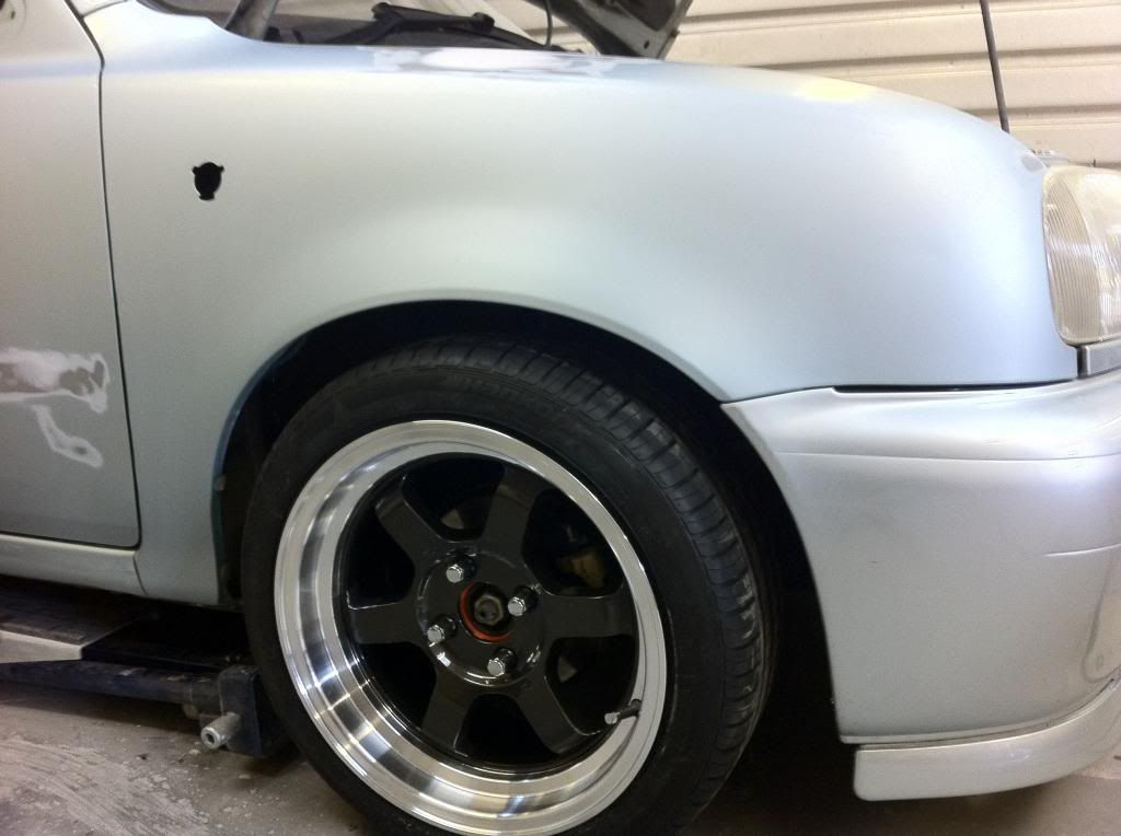

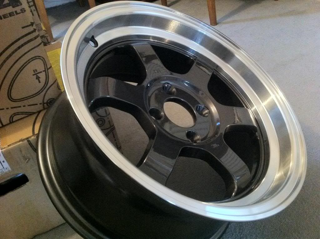

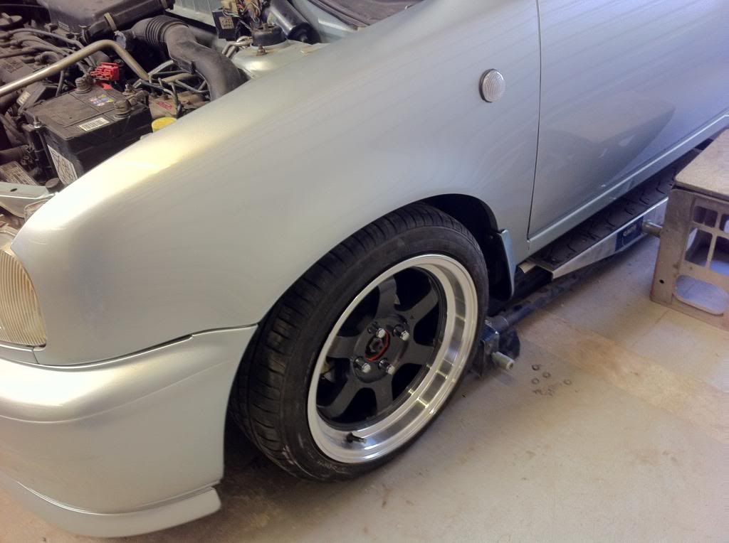

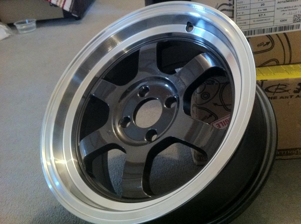

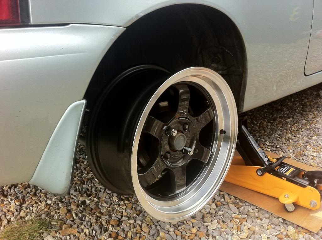

A few test fitting photos of the new wheels.
Rear:

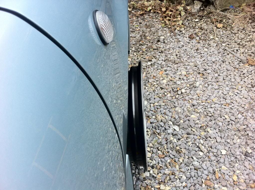

The rears fit pretty much flush with the arch, but may need a bit of spacing at some point.

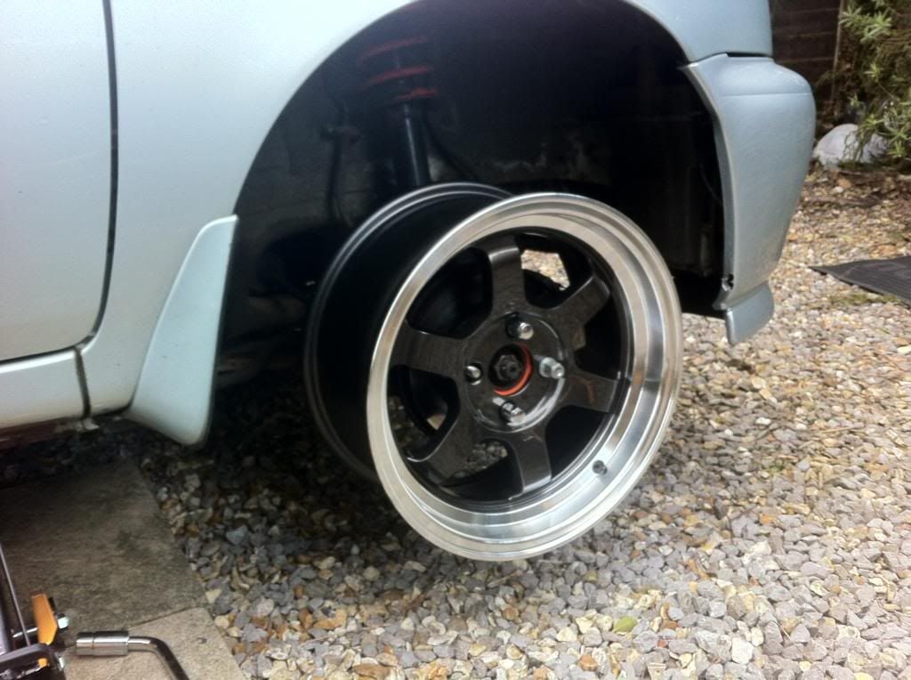

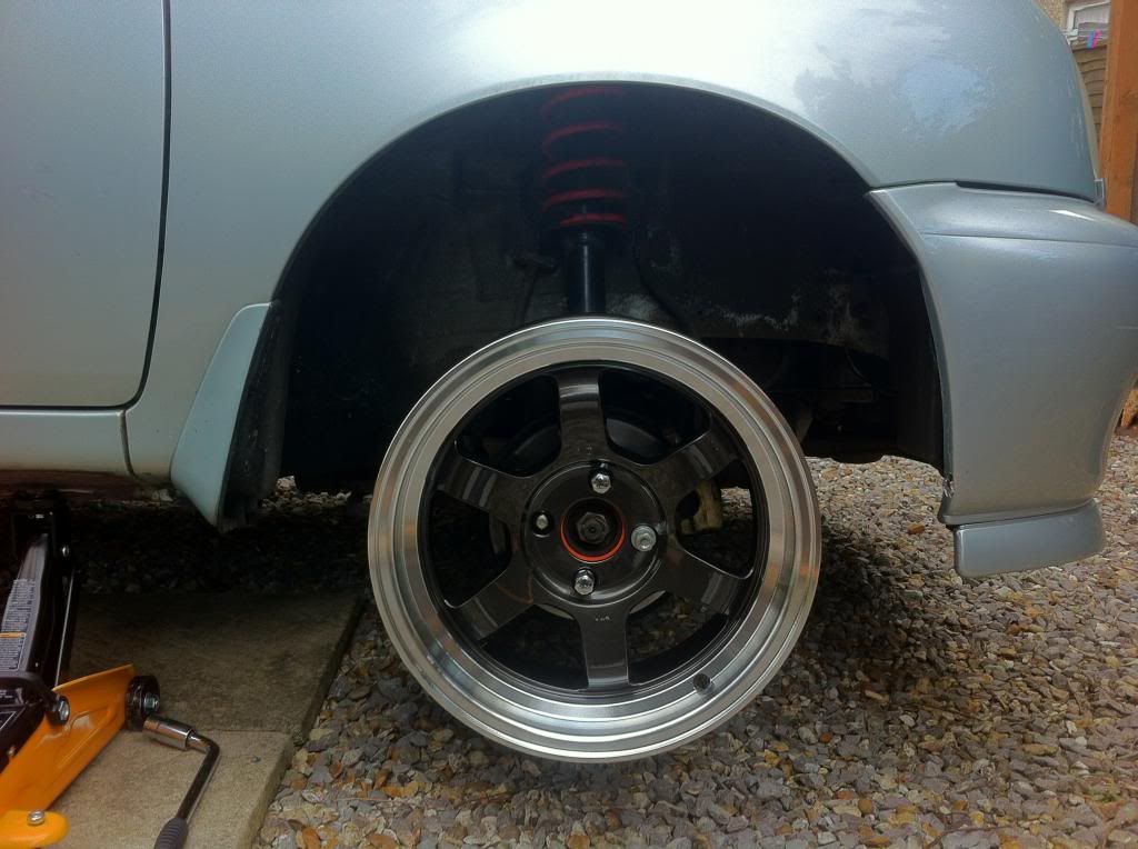

Front:
The fronts poke out a bit but will be fine with the right size tyres on them.

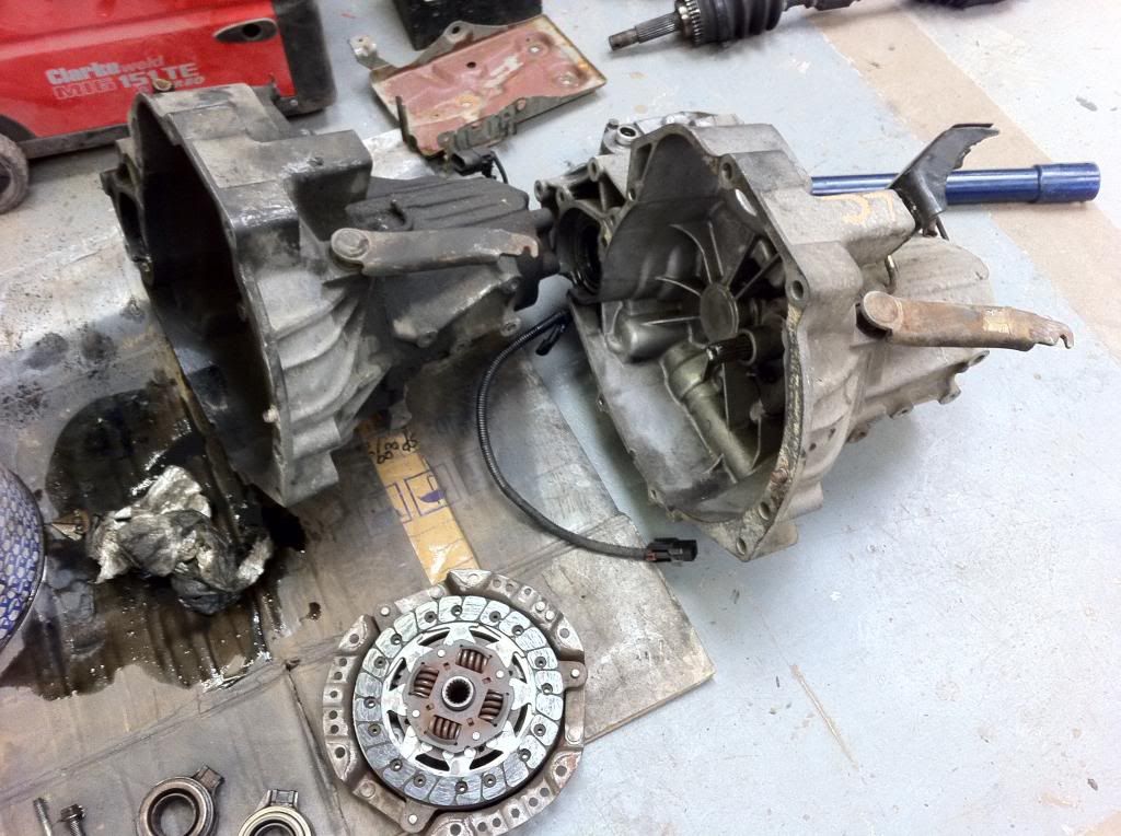

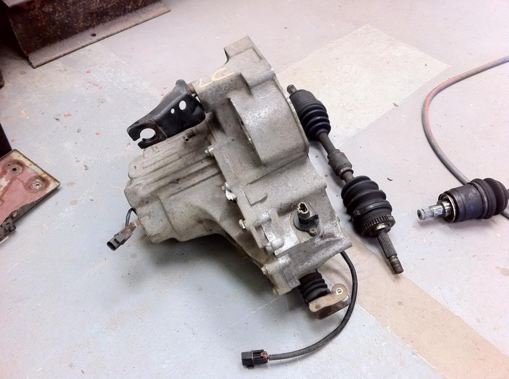

As the gearbox was having problems I got myself a new one and fitted that.
Old vs new.

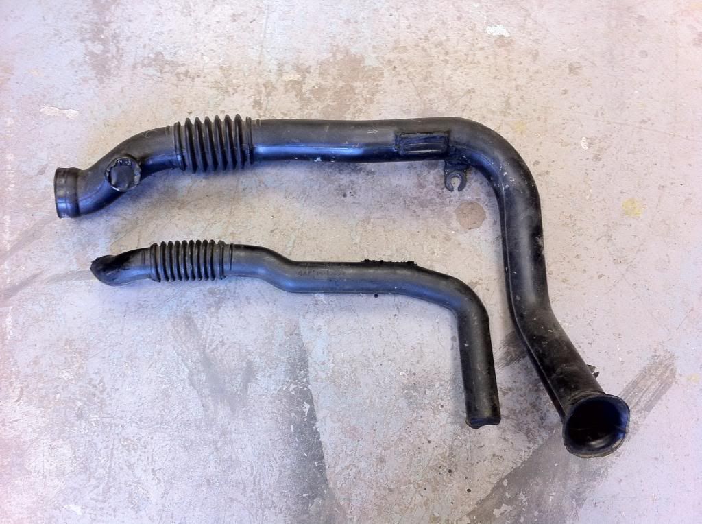

I also cut the resonator part of the air-pipe off and sealed the end up, which made a slight difference to the intake sound.

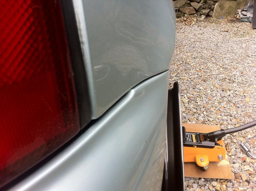

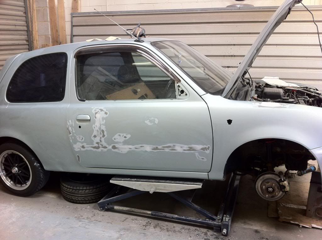

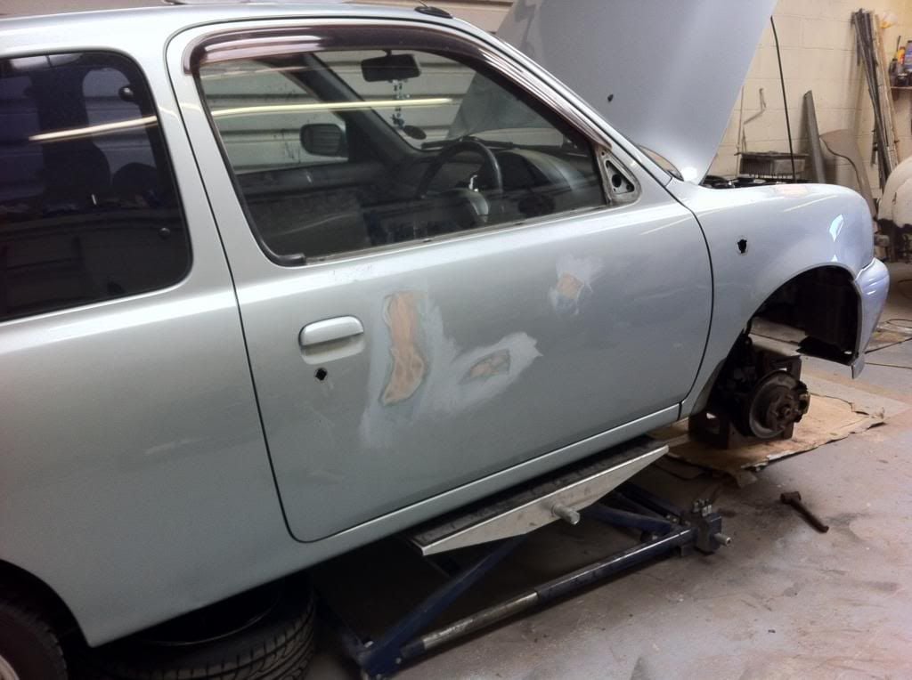

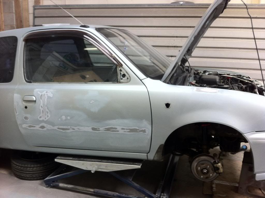

And got the marks/small dents repaired before having the side resprayed.
It's rather weird Sam, usually the intake/airbox are slightly different on japanese Marches, with no resonator.
Hmm that's strange, mine looks the same as the usual CG13 ones, and my engine has a black plastic top on the cam cover instead of it being plain
You can see the differences (closing mechanism)
(left is japanese one iirc)

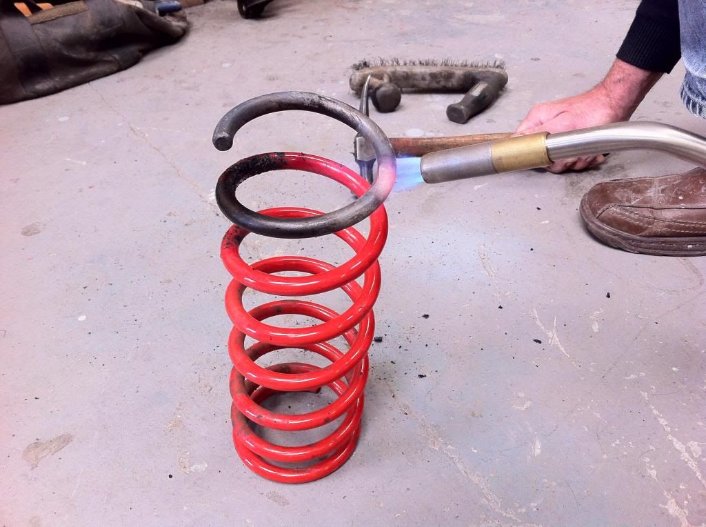

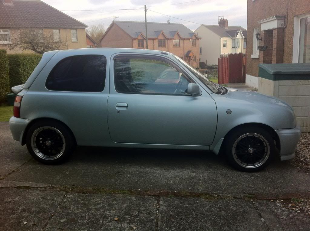

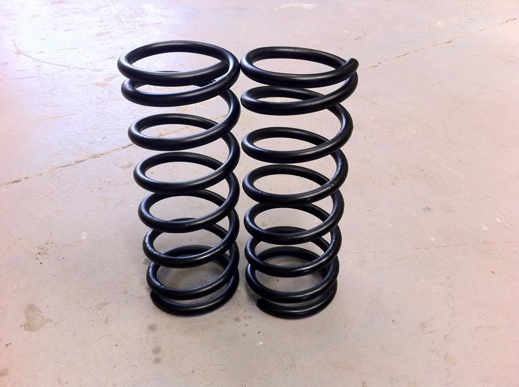

Lowering before, with 35mm lowering springs - 1 coil it went down to about 60mm.
It still wasn't quite low enough but instead of cutting another coil off we heated the spring and flattened the top down to make it lower and seat properly like it should.
A lick of paint and they're as good as new.
Fitted, they went down another 5 - 10mm so they're about a 65/70mm drop.
