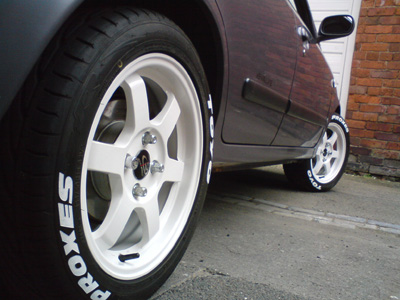

Toyo T1R 195 45 15 lower profile than before cant wait! now heres the question...
I dont suppose any of you nice people with these tyres can post a pic of the side wall I might be thinking about tyre paint... just want to get a quick look myself before I buy the markers

See this looks great but I think its because your wheels are white ill see what they look like when on maybe just a red R on t1r will see.painted toyos looked like this on mine
